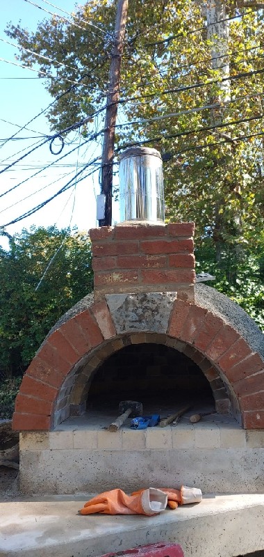

    Selkirk brand, 6 ".
    Leave a comment:

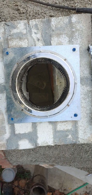

  • Chris inPA
    replied
    The chimney went up today. Still waiting on the cap.

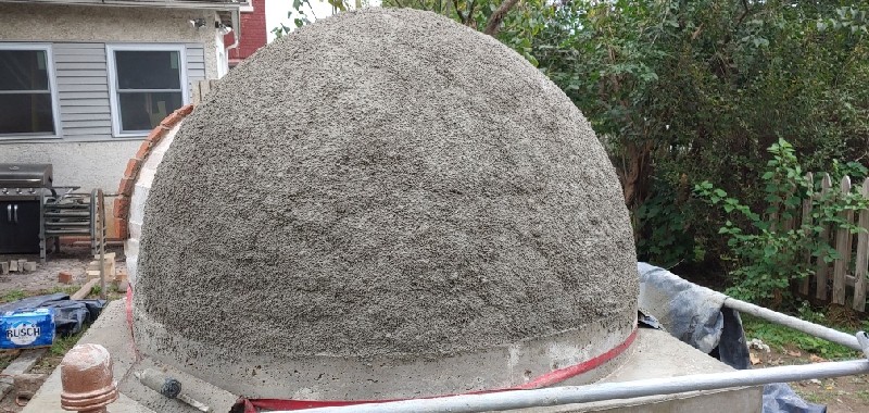

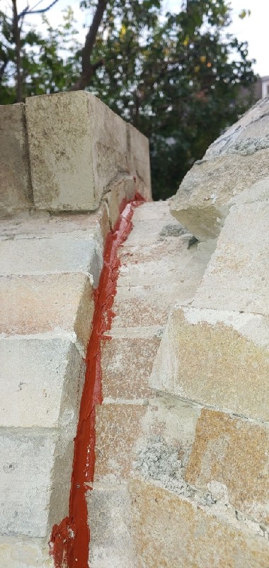

  • Chris inPA
    replied
    david s. Even if it does, it kept the insulation out of the gap.

    replied
    That position is too hot for the high temp silicon, but you may be lucky.

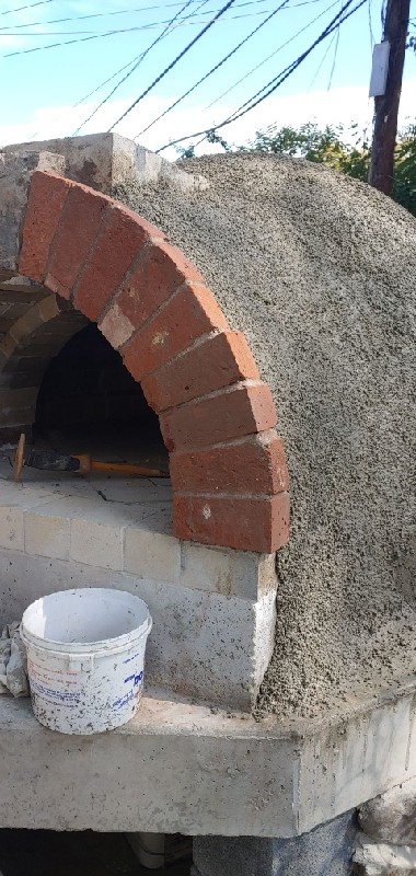

  • Chris inPA
    replied
    Insulation is complete

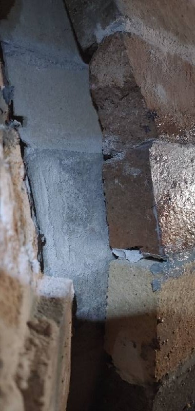

  • Chris inPA
    replied
    Laid a bead of high temperature silicone between the inner and outer arch before the p-crete insulation layer.

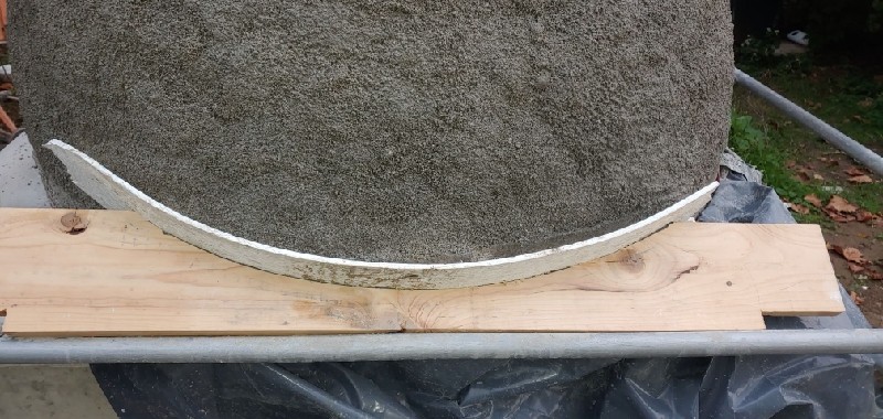

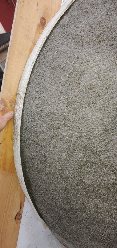

  • Chris inPA

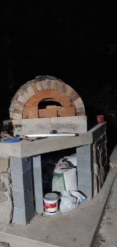

    replied
    I made a jig/form to help me keep the spherical shape
    Leave a comment:
  • Chris inPA
    replied
    Insulation installation began today... I'm trying hats to keep it spherical.

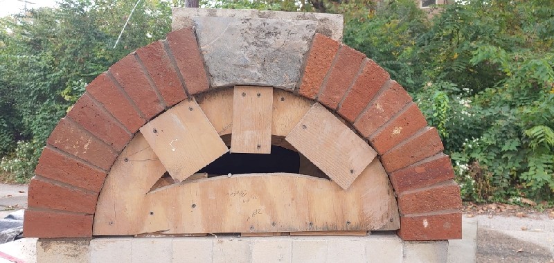

  • Chris inPA

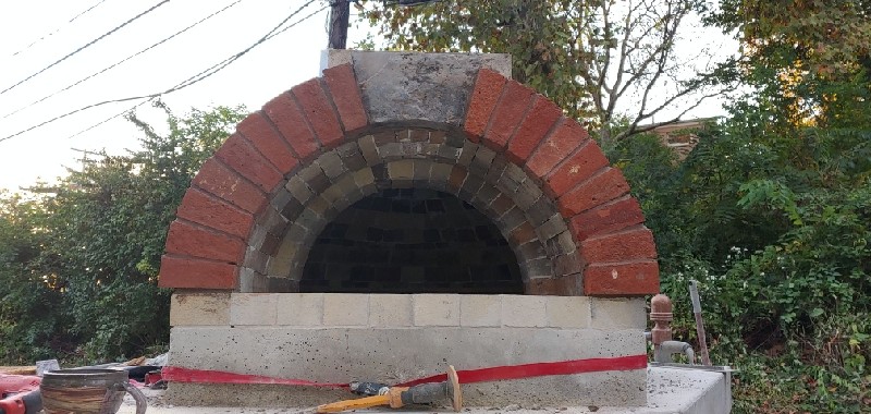

    replied

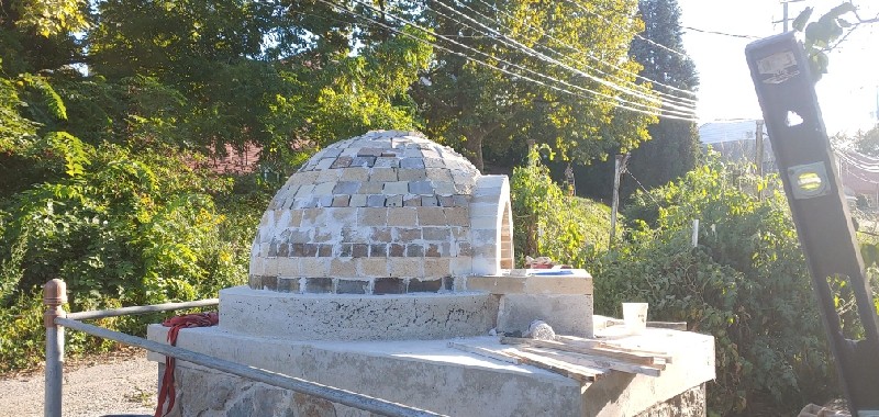

    Ope-dog it's a piece of Limestone that I shaped with the angle grinder. It's not brick
    Leave a comment:
  • Ope-dog
    replied
    That's looking great. Your off-color keystone also adds some nice variety. Did it just work out that way or did you scorch it or something to get that dark color?

  • Chris inPA
    replied
    Decorative arch complete as of today.
    If it doesn't rain I should have the p-crete insulation finished this week.

  • Hazidoc
    replied
    Great job Chris. You really got your dome done fast. I am impressed. Mine took 6 weeks. I really like the different color fire bricks. It looks really nice. Looks like we might be making pizza soon.

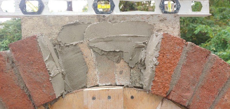

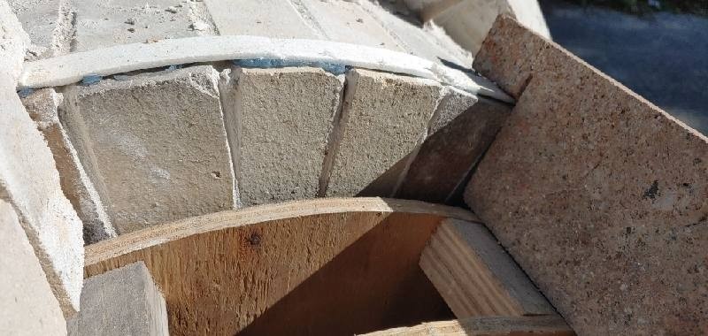

  • Chris inPA
    replied
    Here are the pictures of the transition from inner arch to outer. I notched the bricks and lined it with a strip of ceramic blanket. An expansion joint that isn't mortared.

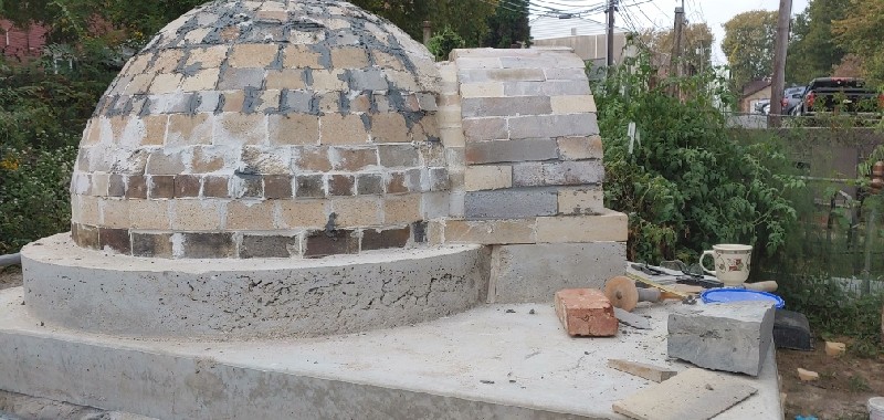

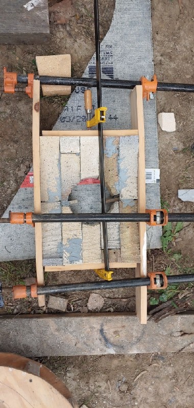

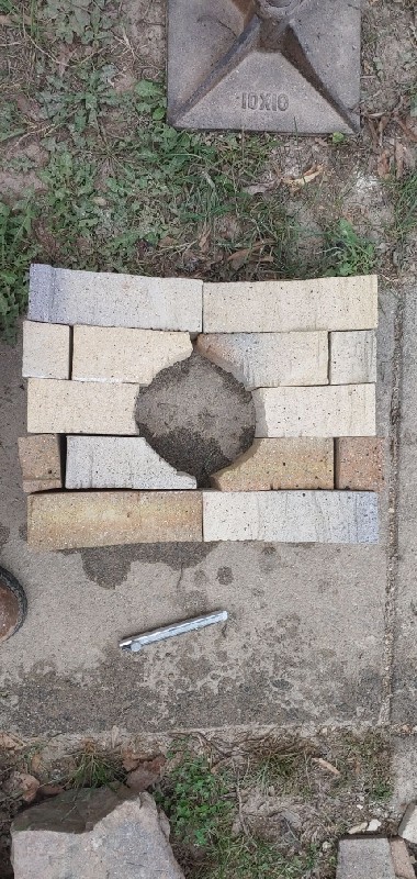

  • Chris inPA
    replied
    I started building the base for the chimney. The bricks are beveled to sit on the arch.

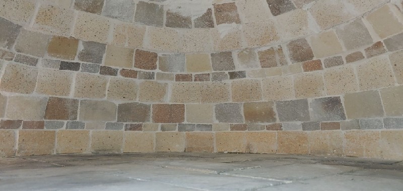

  • Chris inPA
    replied
    I finished the brick work on the dome Sunday.
