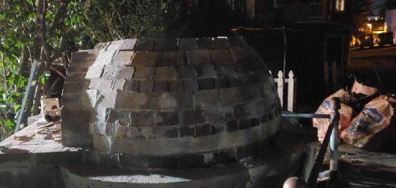

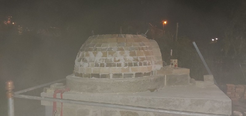

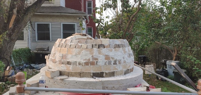

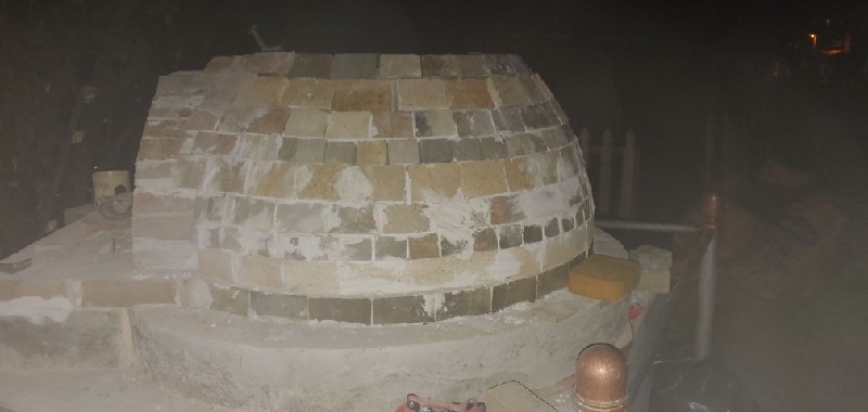

    Ope-dog No, I don't let that cat outside. He's strictly indoors. There's too much car traffic where I live. Been there, done that, hate to tell the kids that it happened.
    I did the Pcrete mix for the base. I figured it'd be a lot cheaper than using the CaSi board. It wasn't. If I would ever build another oven it's going to be with the board as the base.
    The 1st several courses have a taper/bevel on 3 of the 4 long sides. My idea was the more exact I cut the bricks, the less gap I'd have between them and thus to use a lot less mortar. It worked that way. I'm this far into the build and have only used 1.25 bags of mortar where a lot of other builders have used 3+ bags for their build. The b.... here is how much time it took to make all of those extra cuts. For time management sake, it's better to just use more mortar. I'd be finished with the dome by now if I did. The last few courses I've laid don't have the bevel cut on the top. Just the sides that touch the adjacent brick in the same course.. The increase in the gap between the rear of the bricks is easy to see in the picture if you look for it.

    Hi Chris... thanks for the pics of your build. It's really coming together and looking great!!! Your insulation hearth looks robust... I believe you said you did a 5:1 Pcrete pour for that? I'm also a little curious about your courses.. it appears that you use some "skinny" cuts every 2 or 3 courses. Is this for aesthetics, a way to use up brick cuts, or some other reason? I'm just curious as I haven't seen this on other ovens, but I do think it looks pretty cool! (I'm sure the wives are saying.. "who cares.. who will be looking in the oven anyway?" And the husbands are replying... " the whole point of brick is TO LOOK inside the oven!! Haha)
    Keep this pics coming.. I love your "supervisor" in the first pic of your saw. Has he/she been out to jump up and inspect your hard work? :-)

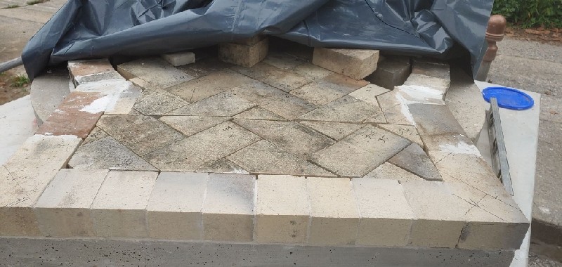

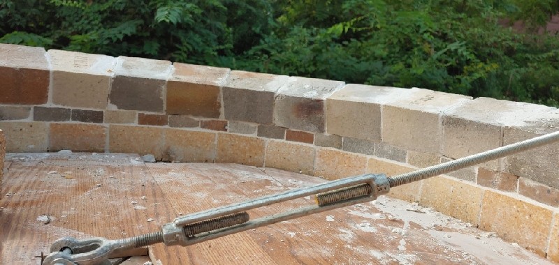

    I had a few scraps of laminate flooring from my daughters room. I laid them on the cooking floor to keep it clean. Notice: the seams run parallel to the opening so that I can get it out when I'm done.

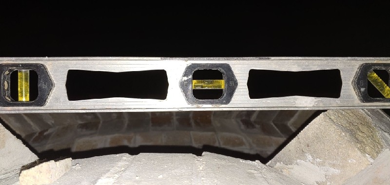

    This is the last row that the inner arch intersects.

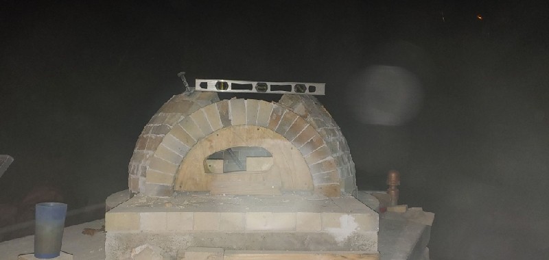

    I used a 2" piece of polystyrene for my arch form. As soon as I placed the last brick I took it out to clean up the joints... i don't advise doing this.

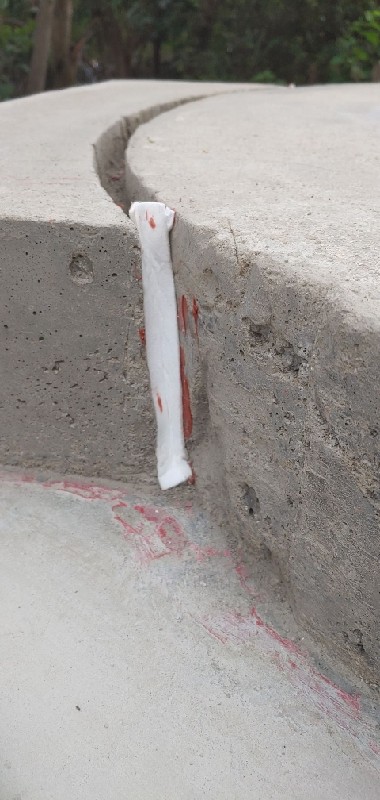

    I put an expansion joint/heat break in the hearth. It's filled with crushed up low density fire bricks and the ends are filled in with Kaowool tape "glued" in with rtv sealant.

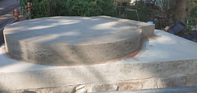

    I stripped the forms off of the insulating hearth this morning at 7 AM and worked all day.

    I haven't uploaded anything in a while. Today I mixed mortar for bricks for the 1st time. I mortared the 1st course and started cutting the inner arch tapers.

    replied
    Originally posted by Chris inPA
    Chach Perfect. Thank you again. How deep was your inner arch form?
    Like 5" or so I think that part doesn't matter as you need it just to hold the brick a little when assembling and putting the arch together it will stick to the brick next and hold it the form is just that to keep the form your shooting for and provide some support. Russell is correct you want to shim that form off the ground so you're not beating the form out. My picture does not show this part as I did not do it until later. Here is my picture showing this.
    Ricky
    Leave a comment:
    replied
    Pic 1 incorrect, pic 2 correct. Be sure leave a release under your arch form, at least 1/2" so you can drop form out without disturbing the arch.
    Chalch's placement of the arch is correct. Your arch template width is fine, you don't want it too wide.
