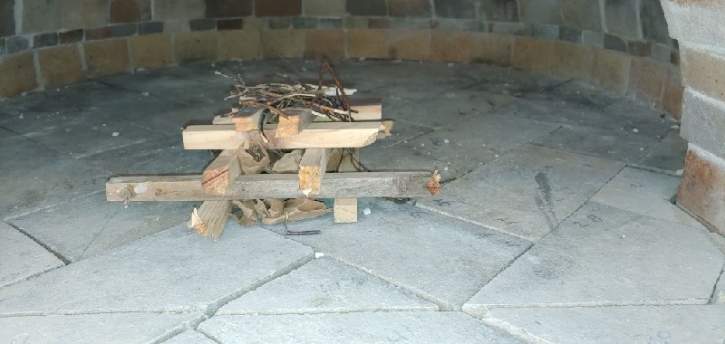

          Curing fires are next.

            Here goes!!!!

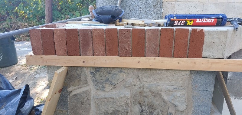

                      I couldn't find a tile that I really liked. So, I'm covering the face of my slab with thin bricks.

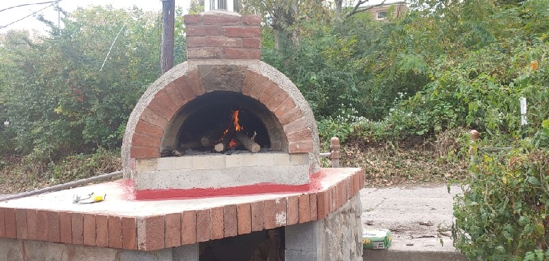

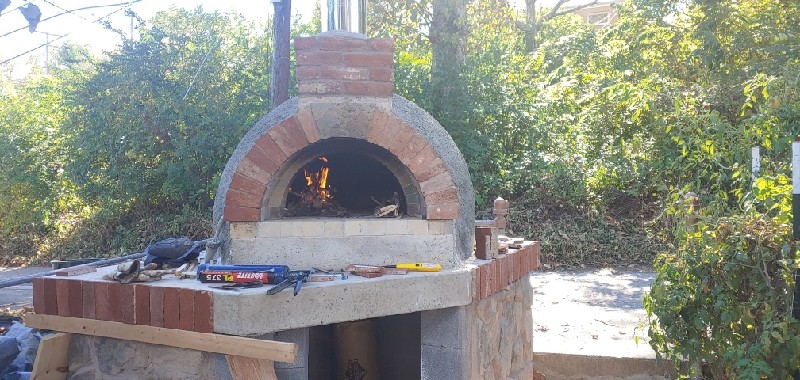

                        Curing fires continue

                          I couldn't find a tile that I really liked for the face of the hearth. So, I cut down bricks and did a facade

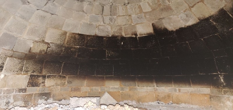

                              I finally got the bricks to start clearing. I've been doing curing fires almost daily since 10/03. There was a whole lot more moisture in the p-crete than I has imagined. With that said, the Wall is still jet black. The whole dome looked like this as of 2 days ago. UtahBeehiver do you think this is still too much moisture left over before I put on the outer render? If so, I'll do a few more days of cures.

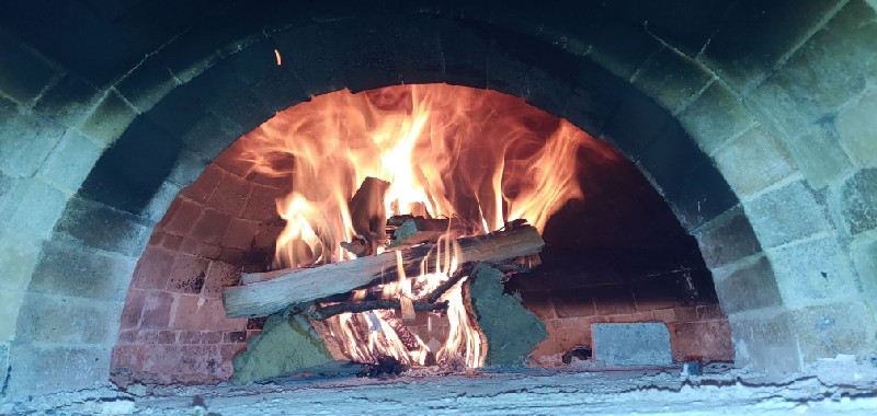

                                The fires are now full sized. No longer little twigs.
