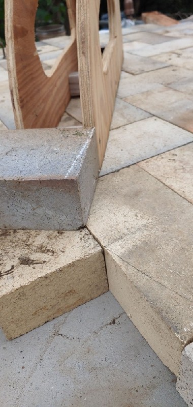

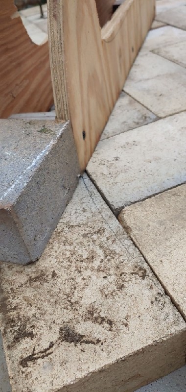

        Question in placement of the inner arch:
        I believe that the outermost edge of the inner arch should touch the edge of the line which indicates the circumference. Is that correct? Or is it the innermost edge that should touch?

        • #64
          Here us a picture of where the inside of the arch should be set. The inside of the arch should touch the ovens inside circumference. note my picture looks like the arch is away from the inner circumference but that is because I cut the floor about 1/8"-3/16" shorter for expansion.

            • #66
              Pic 1 incorrect, pic 2 correct. Be sure leave a release under your arch form, at least 1/2" so you can drop form out without disturbing the arch.
              Chalch's placement of the arch is correct. Your arch template width is fine, you don't want it too wide.

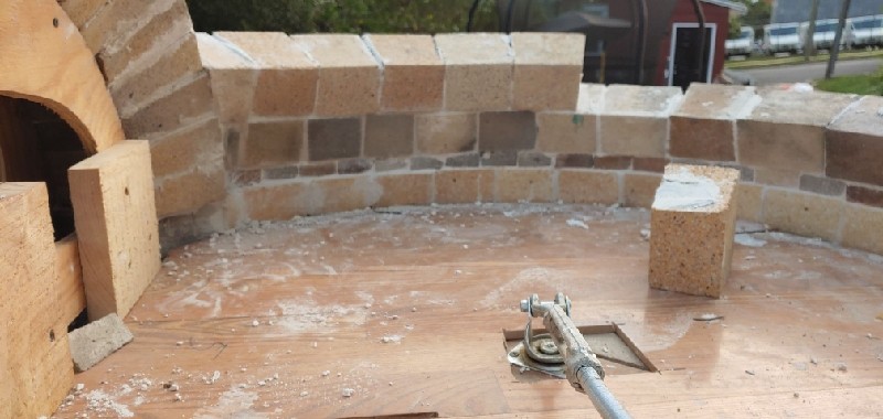

                • #68
                  I haven't uploaded anything in a while. Today I mixed mortar for bricks for the 1st time. I mortared the 1st course and started cutting the inner arch tapers.

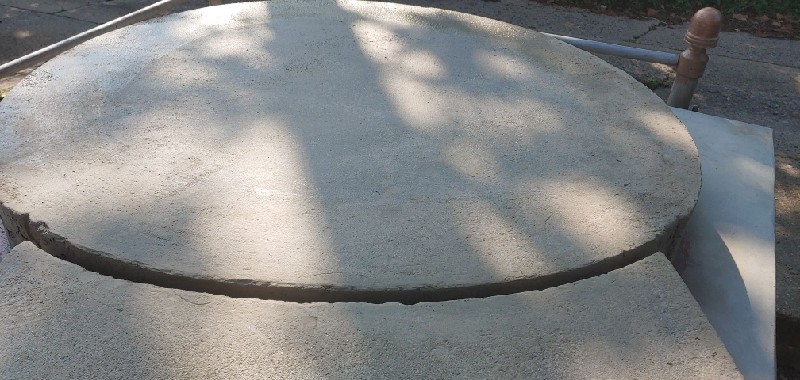

                    • #70
                      I put an expansion joint/heat break in the hearth. It's filled with crushed up low density fire bricks and the ends are filled in with Kaowool tape "glued" in with rtv sealant.

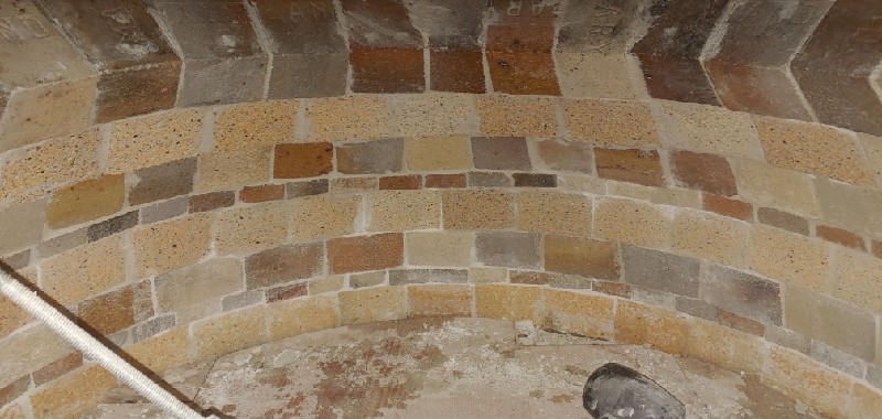

                        • #72
                          This is the last row that the inner arch intersects.

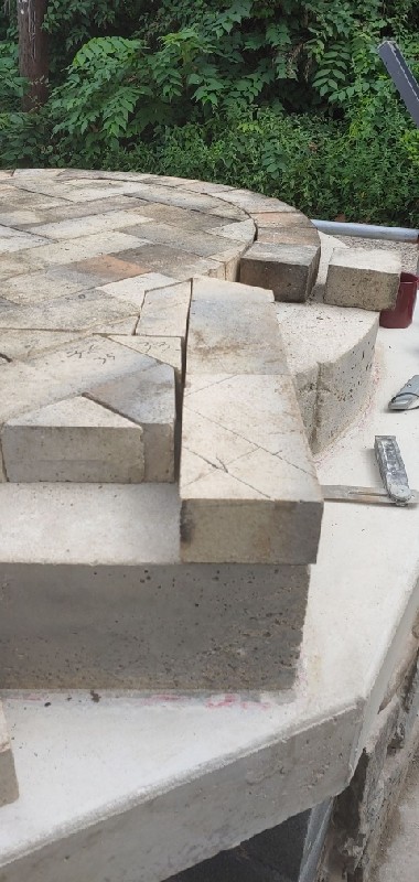

                          • #73
                            More pictures as I haven't posted in a while.
                            What comes easy won't last long, and what lasts long won't be easy.
                            • #74
                              More pictures
