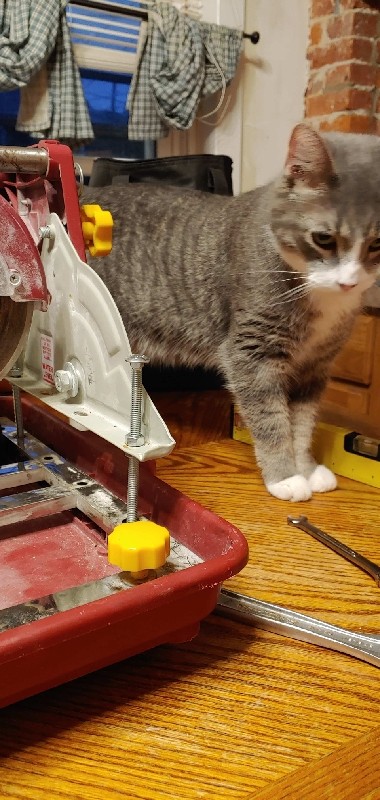

            Lots of rain this week. So, I couldn't start on my cinder block base for the hearth.
            I built my I T.
            I modified the wet saw to allow bricks to fit under the motor housing.
            I started building my brick cutting jig.
            But, I still haven't figured out how to resize my photos.
              I built my I T.
              HA! You'll get there. From my phone I use and app called "photo and picture resizer". Pick the photo and shrink it by 50%. Works easy enough for me.

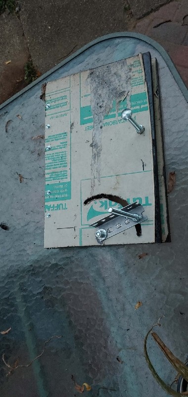

                  #23
                  This is my jig for cutting bricks with the wet saw.
                  What comes easy won't last long, and what lasts long won't be easy.

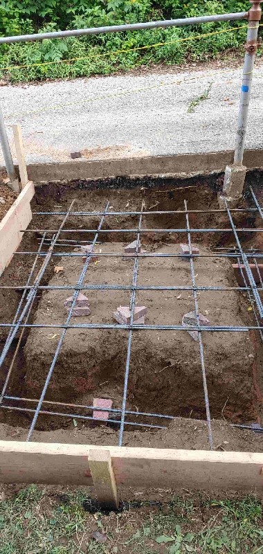

                    #24
                    26 inches deep under the footprint of where my block will sit. 2.5 yards of concrete, 2 layers of rebar for reinforcing it.

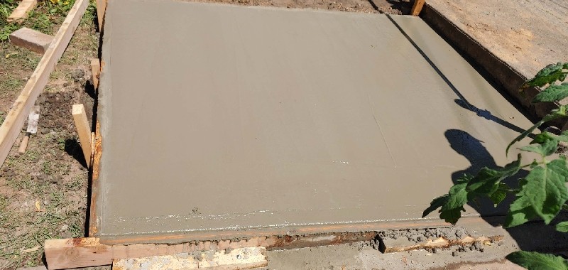

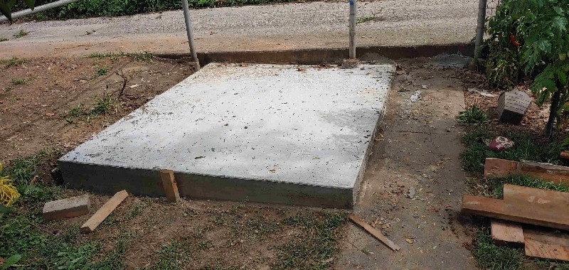

                      #25
                      My slab wet and after I stripped the forms.

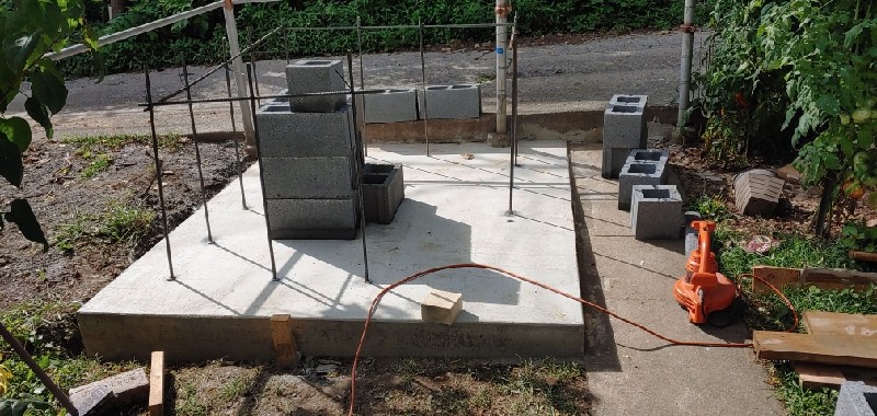

                        #26
                        Rebar is epoxy set into the slab. Waiting for a dry day to set the blocks.
                        • Chris inPA
                          • Jul 2020
                          • 104
                          #27
                          The horizontal bars in the picture are just tied in to allow me to keep the vertical bars level. Of course they're coming off to allow the blocks to slide over them.
                          • Chris inPA
                            • Jul 2020
                            • 104
                            #28
                            It's a 7" wet saw. So, it won't cut through a brick in 1 stroke. I'll need to flip the brick to cut the remainder. I have it raised high enough to allow it to pass over my jig without cutting into it.
                              • 9213
                              #29
                              The normal procedure is to have short starter bars hooked over, then lay the blocks, then hooking the longer bar onto the starter bars just before filling the cores. This avoids having to thread the blocks over each bar.
                              It doesn’t make much difference, doing it your way eliminates bending the hooks. But it would be a pain building blocks 3m high that way.
                              • Chris inPA
                                • Jul 2020
                                • 104
                                #30
                                David S, I don;t have a bender. And I'm only going 3 courses high.
