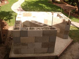

        The FB plans do have a few inconsistent dimensions that have been there from day one. It is best you sketch or in you are computer literate use Sketch-up to lay your project out. I did a 42" corner build and when completed the finished edge was at the edge of the hearth base. It is better to have more than less.

          Thanks Russell. Your photos are fantastic! I plan on using mortar on my CMUs rather than just dry stacking. I'll still fill with concrete but I feel that the mortar will just add more strength which can't be a bad thing - can it? I have room to be a full 5 blocks long but not 5.5 so with mortar I should have good space for the oven and a landing out front.
