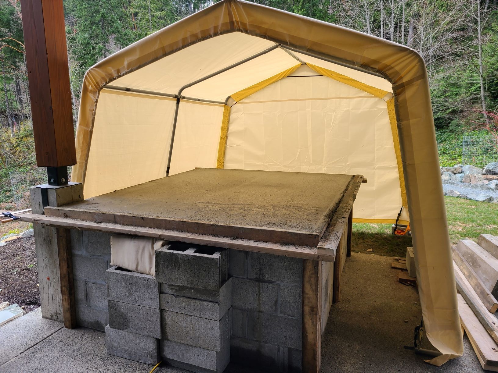

      Pad is done. Ended up about 5.5" thick using 2x6 framing material.
      I had leftover fiber-mesh reinforcing material from a concrete countertop project. This is about 1.5" below the concrete surface. In addition to the plentiful rebar, I think it should be quite solid! The weather here is dipping below freezing overnight so I had the tent/cover sealed off overnight with a heater inside. I've now got the heater in the storage area under the pad and the front entry closed off. Concrete is not getting to freezing temps.
      Placed my order for firebrick etc today so hopefully will be able to start the fun part of the project in a few days!

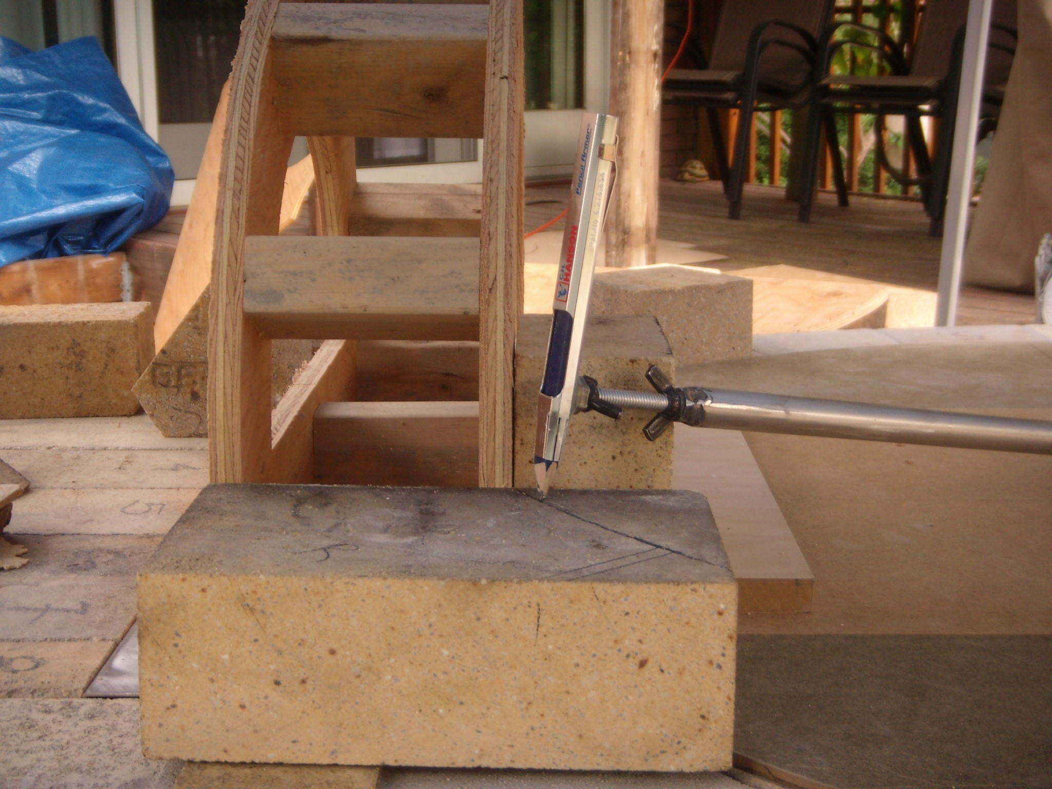

                Blairt a couple of things. You might want to consider making your arch forms narrower front to back, as arch bricks for most builds are shorter at the bottom (not full length) and longer at the top. having a shorter form with parallel arches front and back will give you the best chance of indexing the bricks at the proper location and angle. This worked for my arch and if you look at the first link below you can see how a deeper form would not have allowed me to use the rear part to locate my bricks.
                Secondly, the arch needs to intersect the dome both at the bottom and the top, so at this point in the build some folks already have an IT built and are using it to make sure a brick sitting on top of the arch will mate properly. I verified mine both using a cad program (see capture in second link). I also included two pics to show the arch form locating shorter arch bricks and how I used my IT, arch form, and a couple of bricks to make sure the arch placement was correct.

ID:	436104 I disagree with Mark. The placement of the bottom inside is correct for a tapered inner arch. I do agree with JR that the form is too wide. For a tapered inner arch, a full length brick is used and cut back with the longest being the top dead center brick. See attached on how the IT is used to determine the various angles.

                      From my experience, the only important "datums" (control surfaces) on the arch form are the forward edge for indexing the arch bricks fore/aft (the rear edge is useless as brick length varies) and the front and back edges of the radius that sets the arch height and makes the bricks perpendicular to the vent arch. That said, the placement of the arch form should not be looked at relative to the inner rear edge.
