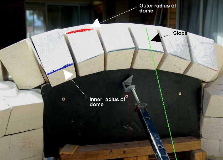

                    I went to the therapist today and I've been diagnosed with "arch anxiety". I'm at course #4/5 and everytime I read JRPizza or UtahBeehiver's posts after searching for "arch", I think I understand what to do, but then I walk outside and keep second guessing myself. Is there any chance somebody could do a 5 minute facetime with me and my arch to set me straight?
                    One issue I'm having is I don't understand how a pencil helps me. I also don't understand how all of the arch bricks look they have two perpendicular cuts to the vertical. How is that not a compound miter? Maybe the keystone brick would be two 90 degree cuts because it's straight up and down, but all of the arch bricks have an angle. Thanks guys!

                          Here is pic from Mr. Chipster on a tapered inner arch similar to yours. Click image for larger version

                            • Kvanbael
                              • Feb 2020
                              • 157
                              #15
                              Here is something that took me a while to realize: About IT and pencil:
