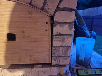

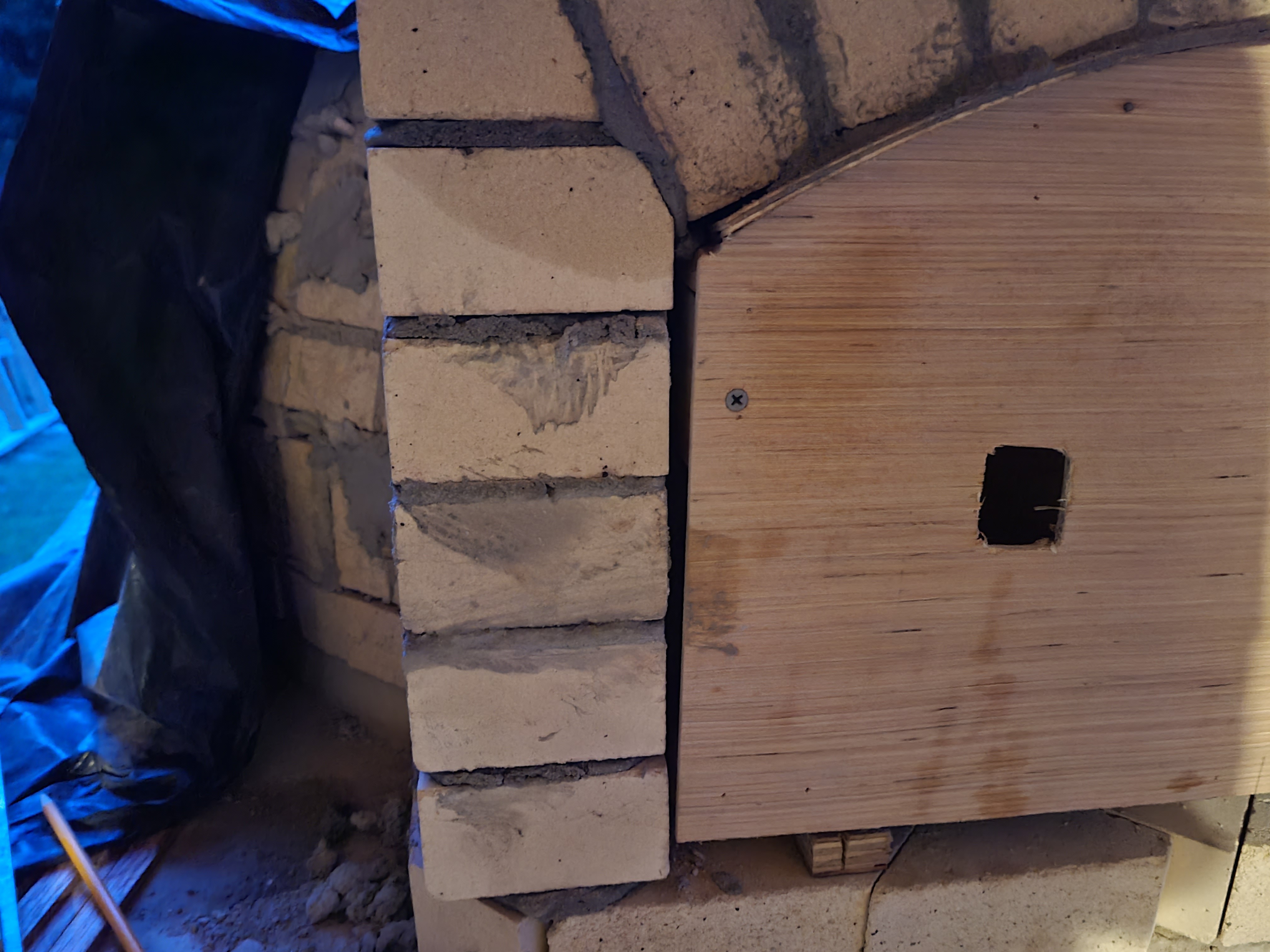

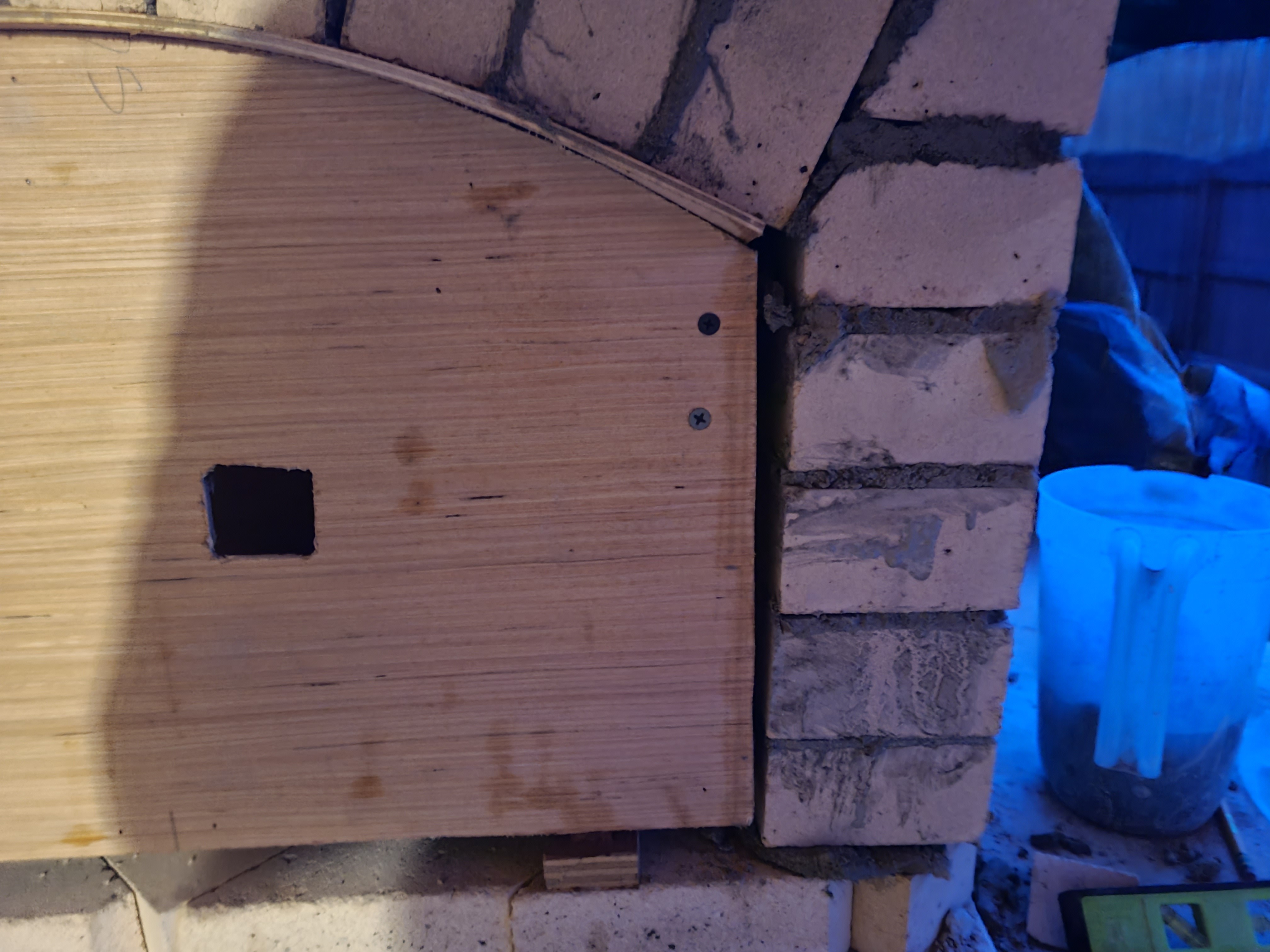

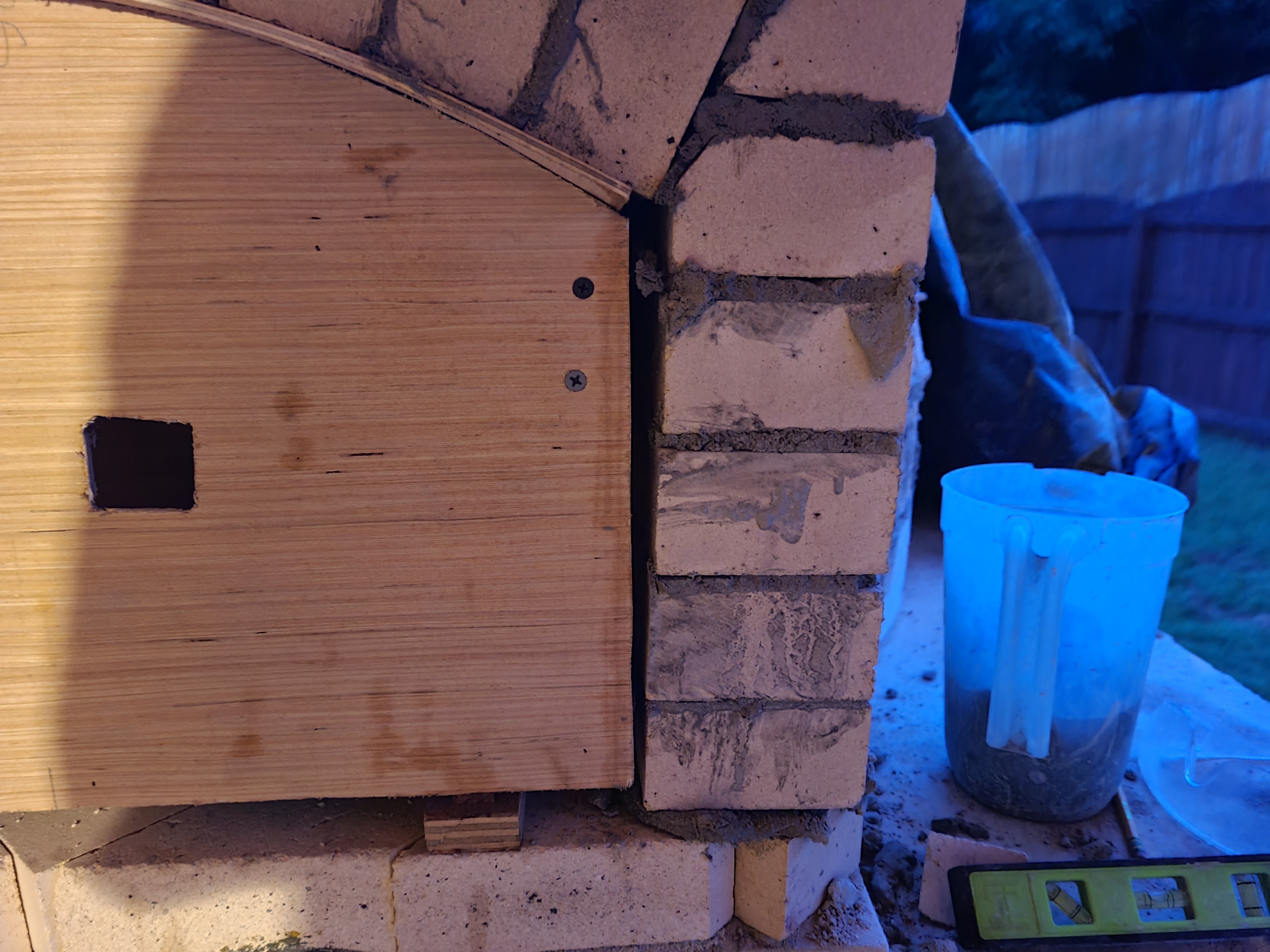

      OK. New problem. Again, I'm an idiot. I tried to squeeze the final arch block in with my dead blow hammer and this happened. It pushed the arch support bricks out which looks like it bent my arch out. My ego will recover. My entire dome/oven will be enclosed in a "doghouse", so my question is how do I reinforce the arch supports so it holds with no issue? Or do I need to start from scratch here?

        Are there any cracks in the mortar or do the sides only lean out?

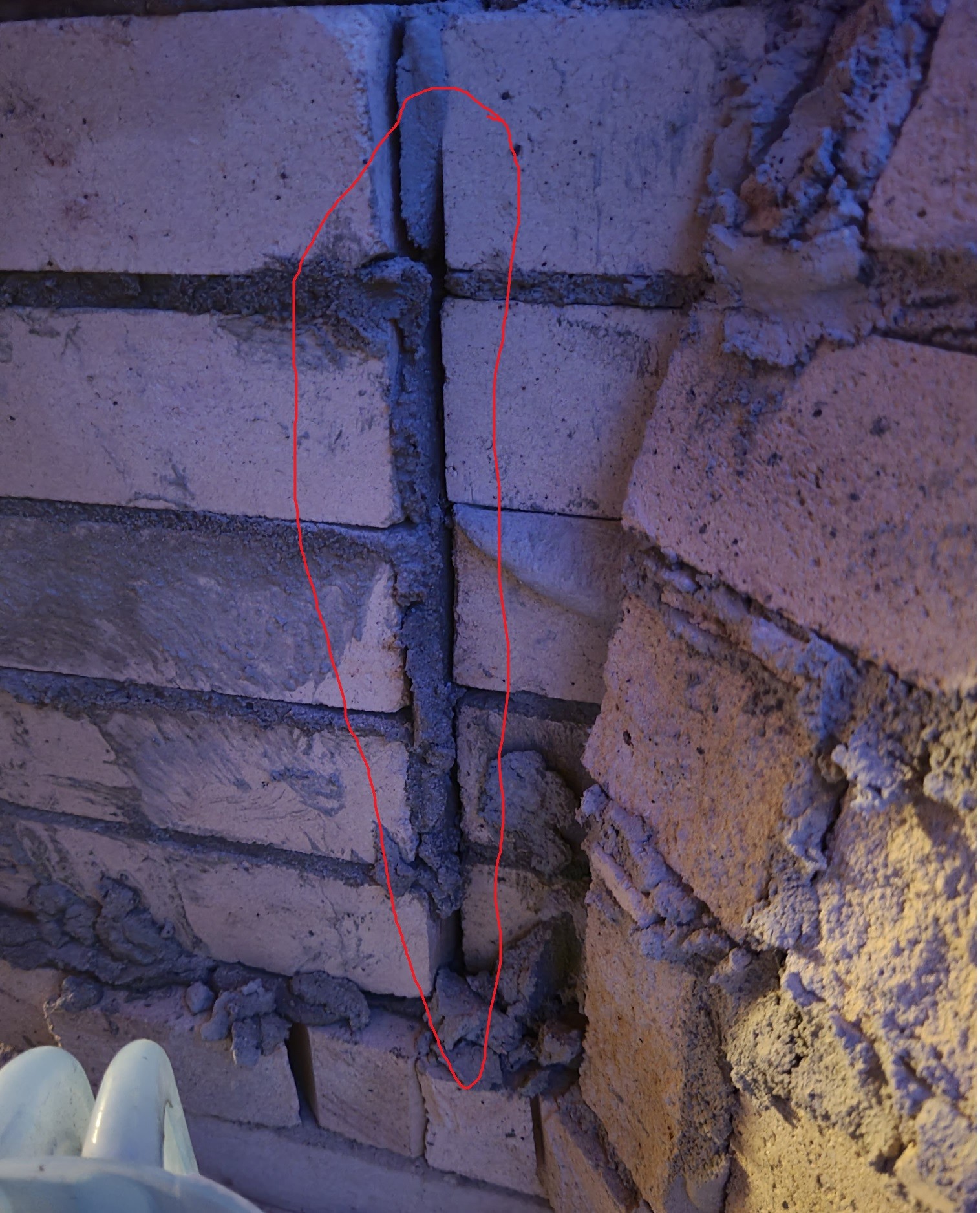

          Only where the outer arch joins the inner arch. Any ideas for buttressing the outer arch? Is it necessary? The only additional load on the outer arch will be my duravent vent stack that will be about 12 feet above the top of the fireplace and the masonry required to make a flat surface for the vent stack anchor plate.

            (Sorry for you) I would: If it is still fresh, clean the bricks and re-do the arc and sides. Skip mortaring it to the dome. Leave 5-10 mm expansion gap for the dome and gallery to move independently if eachother.

                    Welcome, Since the sides started to lean outwards, there is a great risk that the bottom mortar joint has failed. So it's better to re-do it. Sorry, I live in Sweden and have no idéa if they are sold there. It may be called glass fiber rope. It is used to seal stove doors for example. try to get some 3/8-1/2" thick.
