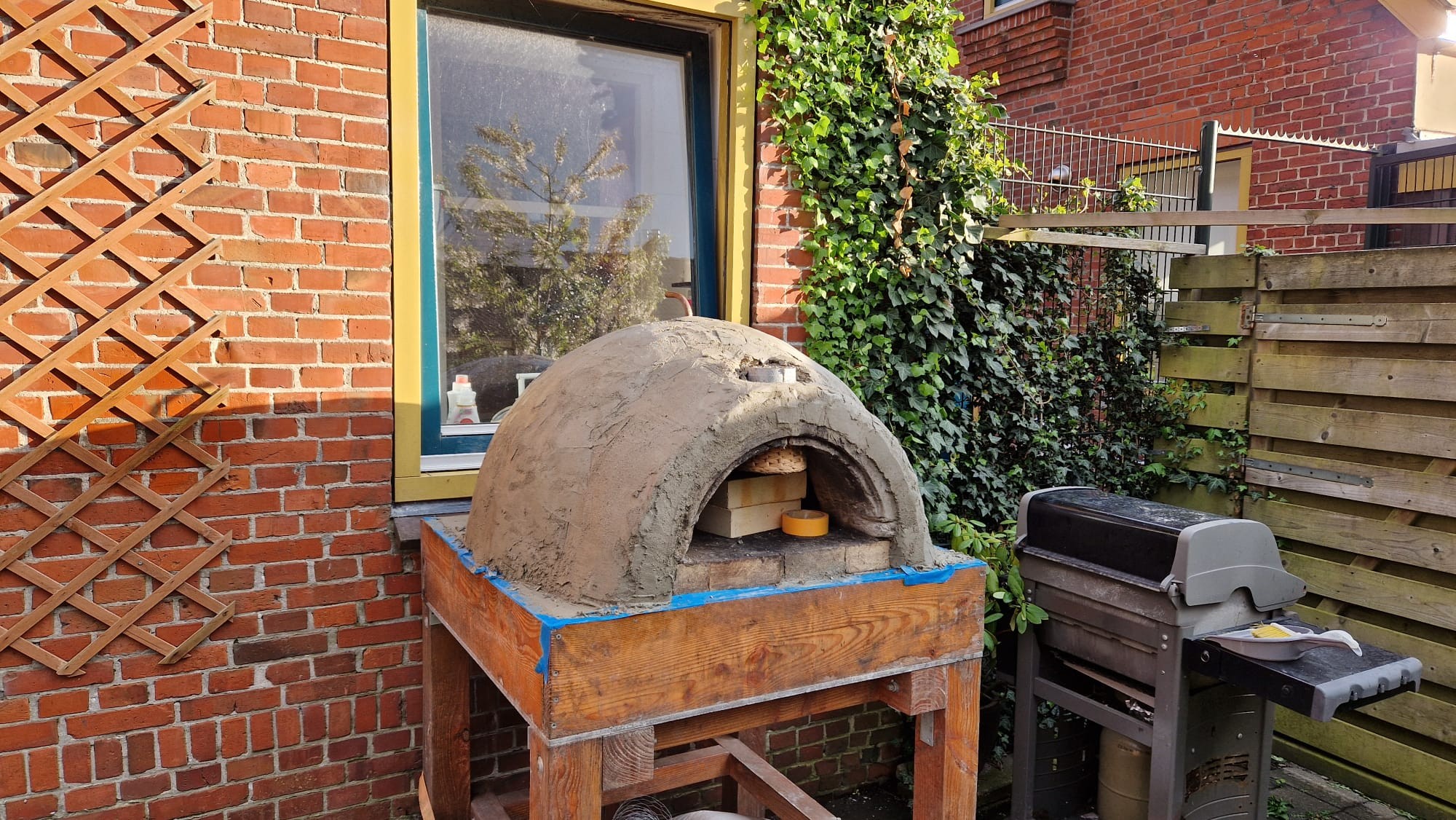

          Update 3 years later..
          So I didn't do much to my oven in the last years. I used it a couple of times but it was quite a lot of work getting it on temperature en not smoking out the whol neigbourhood..
          This year I decided I wanted to finish my oven:
          1. Remove the chimney from the cast
          2. Reattach it on top of the cast
          3. Put on render so I can paint the oven
          4. Add reinforcement to the wooden stand under the oven
          So I'm almost done with point 1 and 3.

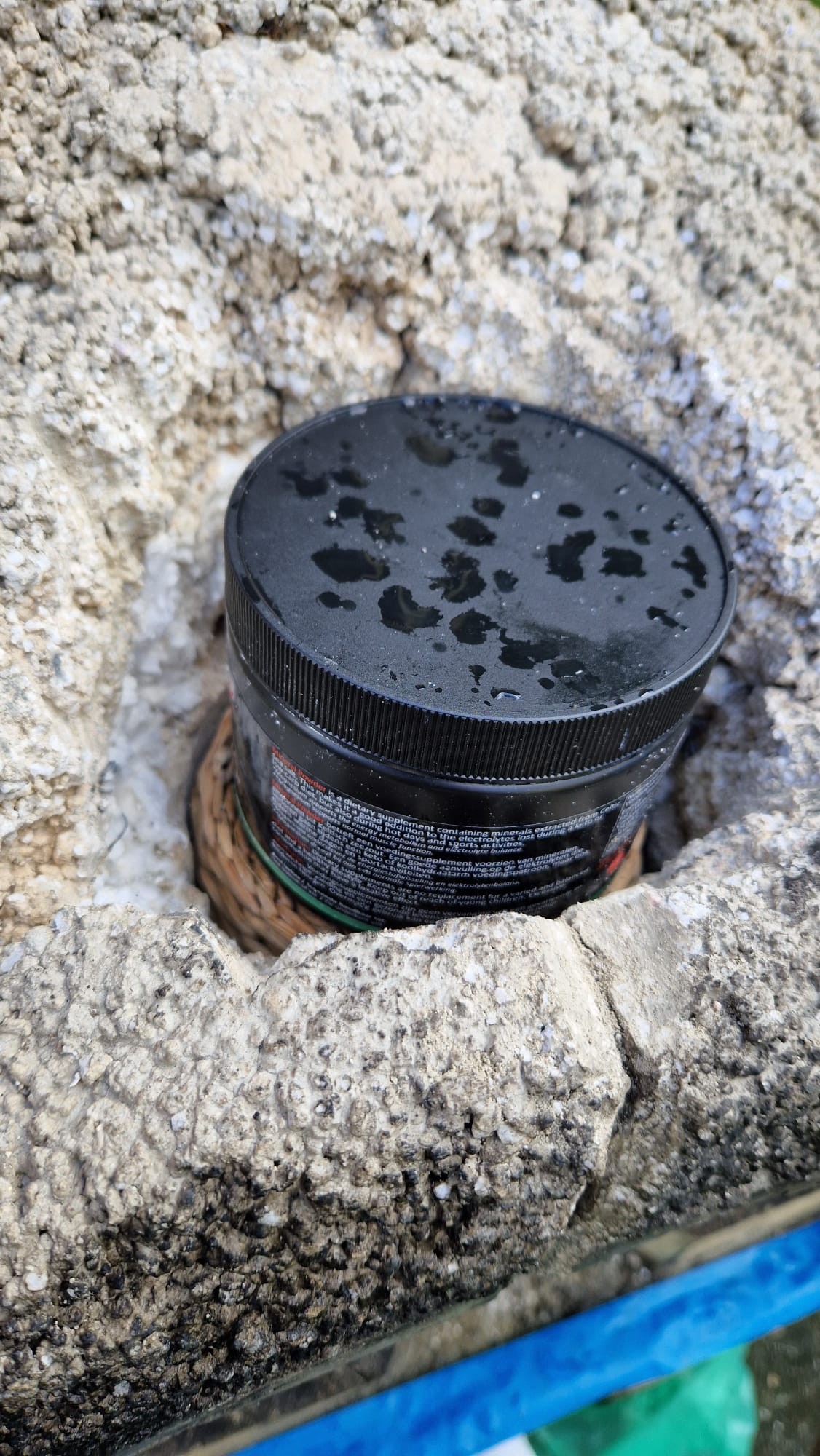

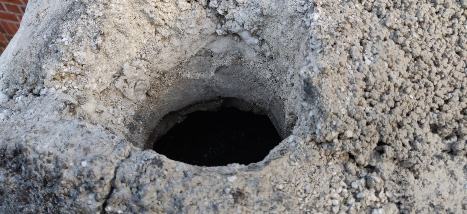

          I removed the flue:
          Click image for larger version  Name:	IMG-20240424-WA0021.jpg Views:	0 Size:	313.8 KB ID:	458443
          Made a cast for the flue. Its a bit more narrow than the flue itself. I will grind it down once the new flue is on top:
          Click image for larger version  Name:	IMG-20240424-WA0014.jpg Views:	0 Size:	493.0 KB ID:	458442 Click image for larger version  Name:	IMG-20240424-WA0018.jpg Views:	0 Size:	465.8 KB ID:	458444

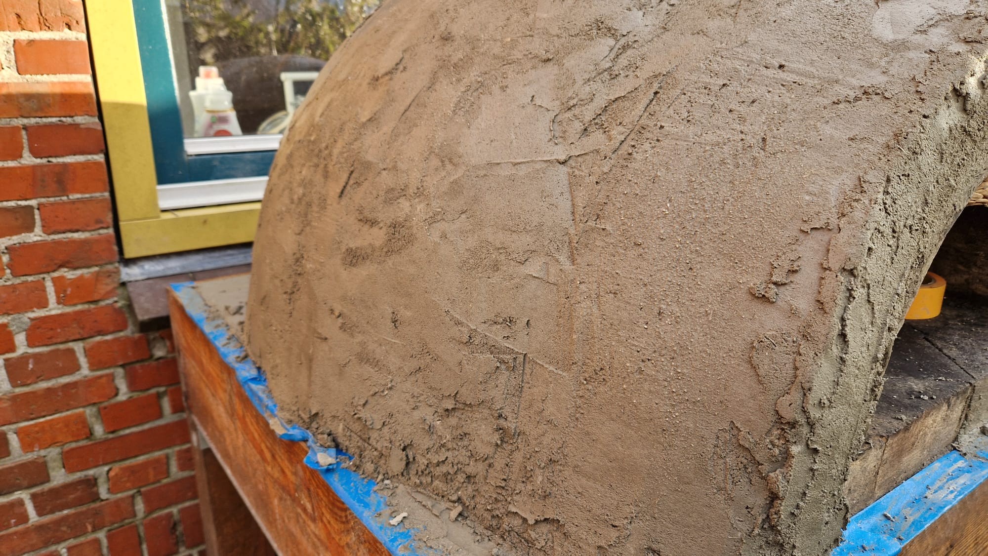

          I put render on the dome of the oven. It turned out a bit rough. But I will sand it down and fill some of the rough patches:
          Click image for larger version  Name:	IMG-20240424-WA0016.jpg Views:	0 Size:	615.9 KB ID:	458441 Click image for larger version  Name:	IMG-20240424-WA0015.jpg Views:	0 Size:	696.8 KB ID:	458440

          I have a question. I just went for filling up the flue gallery (right term?), like you see in the picture. Now I didnt really think this out on how I put the new flue on top and make a joint. Would you have any recommendations?
          I can't put it on top and just use a heat resistent adhesive kit. That wouldn't be strong enough..
          I though about making a cast on top, just a bit wider then the flue. Then put it in and fill it up with heat resistant kit.
          Advice would be much appreciated!
          Best,
          Mark
