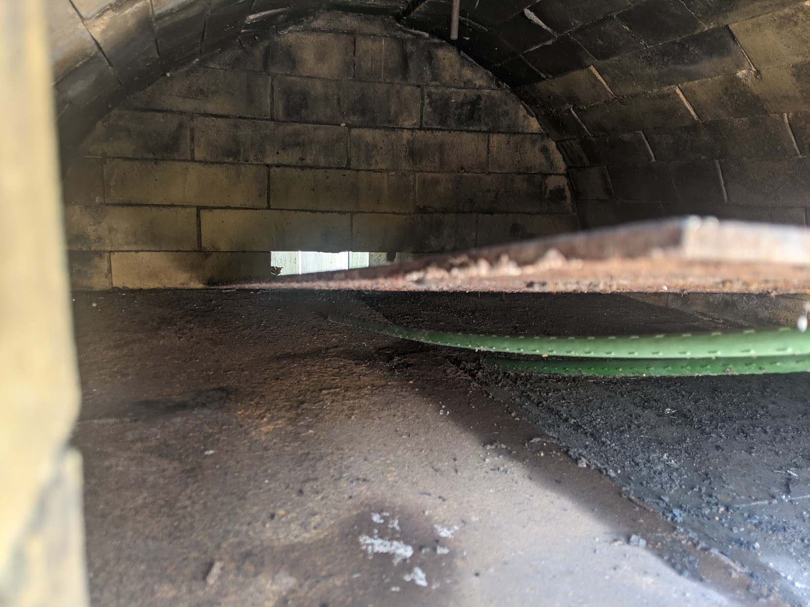

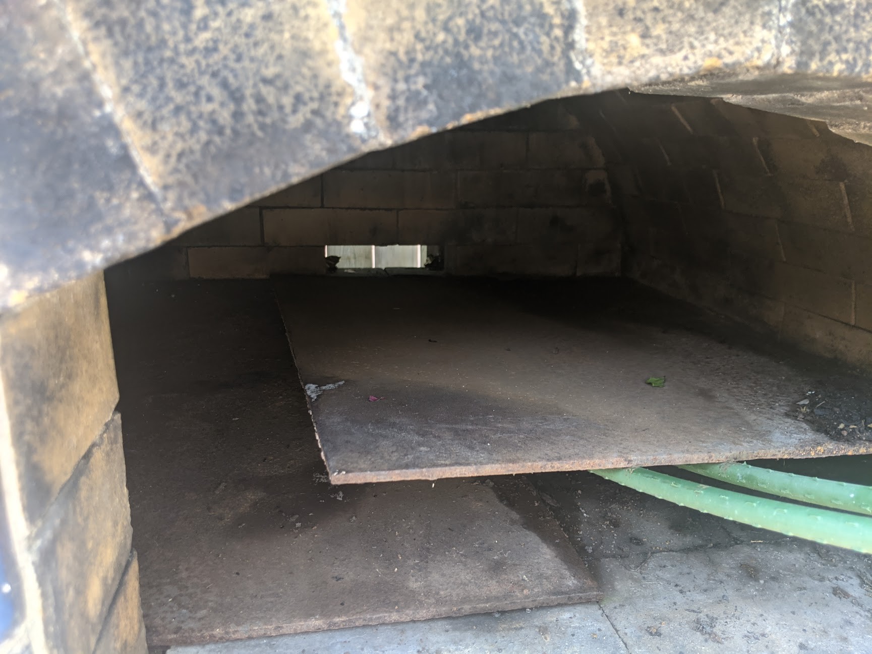

    I moved into a house that already has a pizza oven, i know nothing about them and i have a couple of questions i hope someone here can help with:
    - inside at the bottom there are two metal (rusty) slabs laying on top of the bricks... what's the function of these slabs? can i just remove them?
    - the oven does have a "chimney" in the middle (not sure about the word), at the back tho there is a missing brick, not sure if it was done for ventilation or if it "fell out" at some point .. can i close that space inside with a brick to keep the heat in?

    Welcome to the forum.
    I don't know why they would have used steel in there. I would remove those.
    When you say "chimney in the middle" I'm guessing you mean in the top of the arched roof? Most of the dome ovens have the chimney outside the door opening, but your setup can work too.
    I'm not sure why they would have chosen to add a ventilation hole at the back. I don't think it serves a useful purpose so I would close it if I was you.
    Yes, most of us cook directly on the floor of the oven.

      Well your oven looks more like a bread making barrel oven that a domed pizza oven?
      Can you post a few more pictures showing it from a distance .
