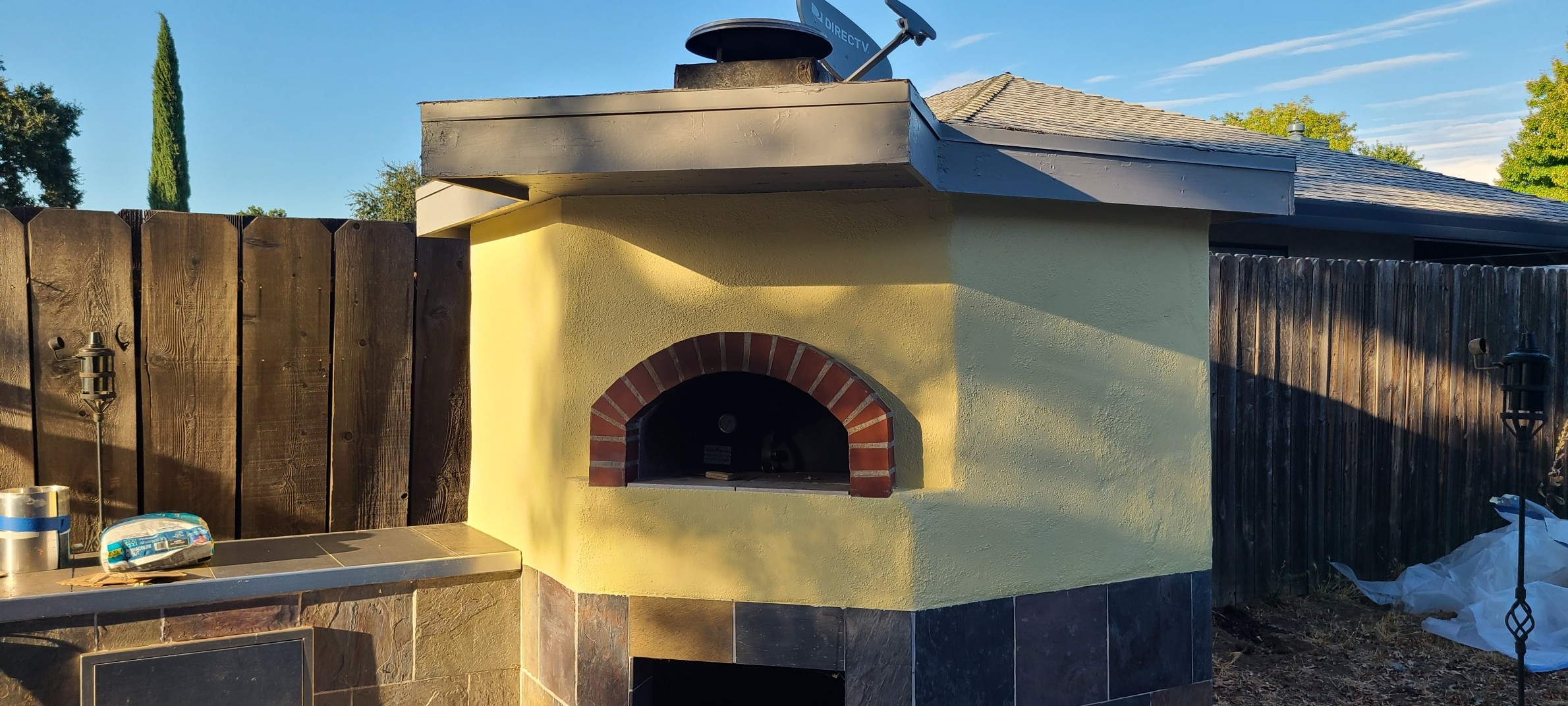

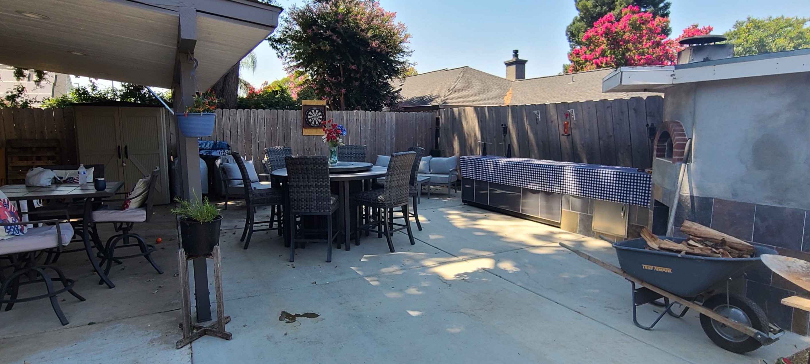

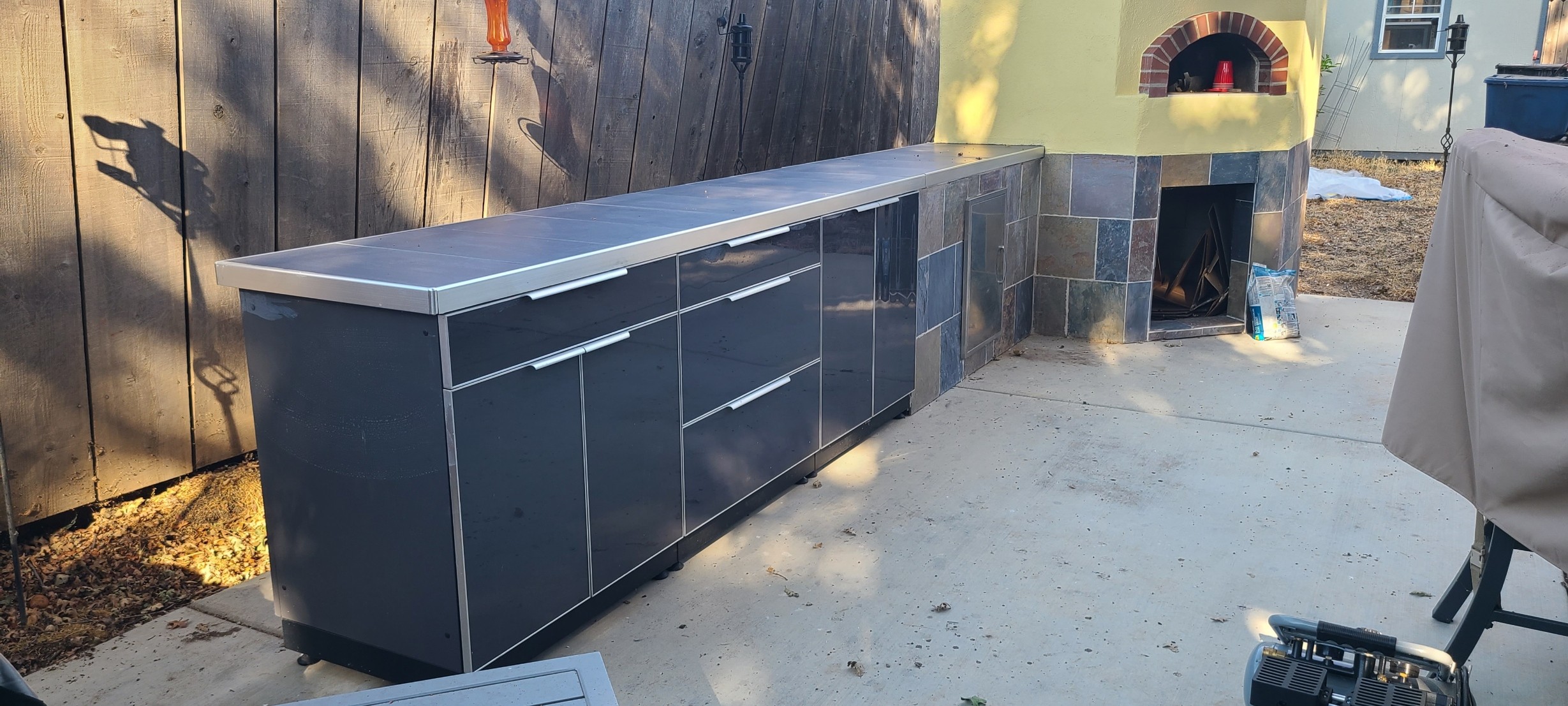

          Been a while since posting here but I thought I would wrap up the thread. Here are some images of the final product. Pizza Party Palace!

            It turned out nice - looks like a great place for a party!

              Nice work! Really like all the prep/work surface. I think a lot of builders wish they had more space for that. Also great that you have space for covered and uncovered entertaining. Many years of fun ahead.
              And, I'll bet you're the only guy who's added a sat dish to your oven...sorry, couldn't resist .

                Yeah, the Sat Dish is awesome LOL. It's actually on the house behind my property.
                The prep table is awesome too. It's 13' long. We were putting fold up tables there for parties until I finished it.
