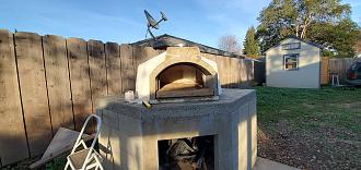

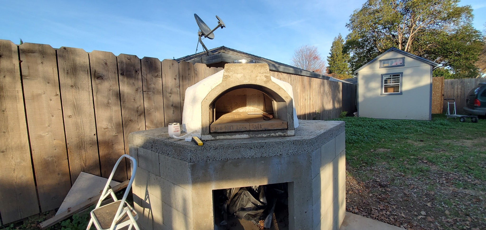

                      • Progress so far
                        • I got the hearth poured. I drilled holes for drainage. No tile though
                        • I set the FB Board and the floor. I tried to float the floor on sand but I could not get that to work to my satisfaction. The floor has small "ears" on both sides and they would not stay flat plus I was pretty sure I was going to end up with sandy pizza. I put the dome on with the floor embedded in sand and I was absolutely not happy with it so i took it all apart and started over again using the refractory mortar that comes with the kit. I was afraid I would not have enough to do the floor and seal the joints but it was perfect. I had to mix the mortar pretty wet because the board soaked up moisture. I finally got a spray bottle and wet the FB down. I also kept the ffoor wet for a couple of days while the mortar set.
                        • Set the dome
                        • Trimmed off the FB Board.
                        • Sealed the dome joints with refractory mortar
                        • Wrapped the dome in fire blanket today. They say they provide enough for three inches of insulation but there is enough for four
                        • Had to stop because it got dark and a big pacific storm is coming and will dump 6' (1.8m) of snow in the high elevations over the next three days. Hunkering down
                        • Covered it with a tarp.
                        • Came inside and poured myself a glass of bourbon. I'm too old to stack wood LOL
                      Bought a cord of almond wood today and stacked it. My daughter Abbey helped me. Lots of splitting in my future...

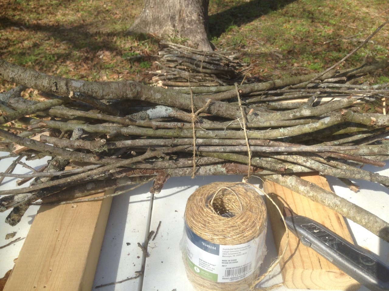

                              hillscp , Beautiful pics of the almond blooms. That orchard is awesome in full bloom. For the past few years, dead fall limbs have been my primary oven source for fuel. It has already dried while still on the tree and burns fast without lots of smoke. If it has been a couple of weeks since the last rain, it is ready for the oven. If I gather it right after a storm, I will place it under one of my sheds for about a month before using. I always keep back a firing or two of dry wood for emergencies: power outages etc. Mixed in with what they call seasoned wood (which is not totally dry) it works great. The dead fall in the below pic is of dead fall pecan. Like oak, as long as there is a little snap when it breaks, it's good wood. I'm guessing that almond wood is similar. The smaller stuff, I bundle with natural fiber string. That makes it easier to move and handle later. With the natural fiber string, a whole bundle can be placed in the oven.
                              I think that you will be rewarded by getting with the land owner or the caretaker to find out when the older trees were being thinned and if it was ok to gather dead fall. Not many folks down here pass up my offers for cleanup
