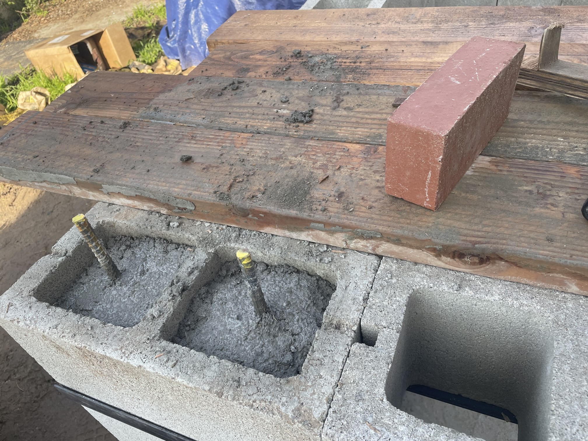

    Currently in the build process for my new oven. Ordered a Premio2G 120 and picked it up at the Forno Bravo factory.
    I have the slab done and the block stand is almost ready for the top slab. I'm filling every other core with rebar and concrete. The holes that are not filled with concrete.. what do you guys block those with so that when the slab is poured it doesn't go down the holes? I was thinking about using squares of wood or rigid insulation to block them up.

      A lot of folks have just used the empty concrete bags to fill the alternate block holes, but really anything will work...got some empty plastic jugs? The Styrofoam pieces would do just fine as well or just lay some thin plywood pieces over the holes without rebar. Also I'd strongly advise you to put some weep holes under the oven's future footprint. Before you pour, drill 5 or so 1/2" holes through your bottom form and push pieces of 1/2" plastic pipe up to close to where the top of your poured hearth will be. (Yes, you could drill the weep holes in the green concrete, but if your luck is like mine, you'll hit rebar 4 out of 5 times. ) After the concrete has set, run a drill up the plastic pipe from the bottom. It will pop out a small crater at the surface of your hearth...providing an excellent little well for any excess water that gets in under the oven perimeter to collect and find an exit through the weep hole. A little insect screen material placed over the base of the hole with silicone will keep any bugs from finding a new "home".
      Once that top slab (with rebar) has been poured and screed, you'll want to cover it with plastic to keep it from drying out for at least a week but better ten days. At that point it will have achieved pretty much maximum strength and there won't be any problems with the oven's weight.
      Before you place your oven's ceramic insulation board on the hearth, we strongly advise to put some broken porcelain tiles on top of the hearth (I like to see the use of 1' ft squares of mosaic tiles used here...flipped upside down so the mesh backing is on top.) The channels between the tiles provide excess water a path to the weep holes and the tiles keep the insulation board from getting wet .)
