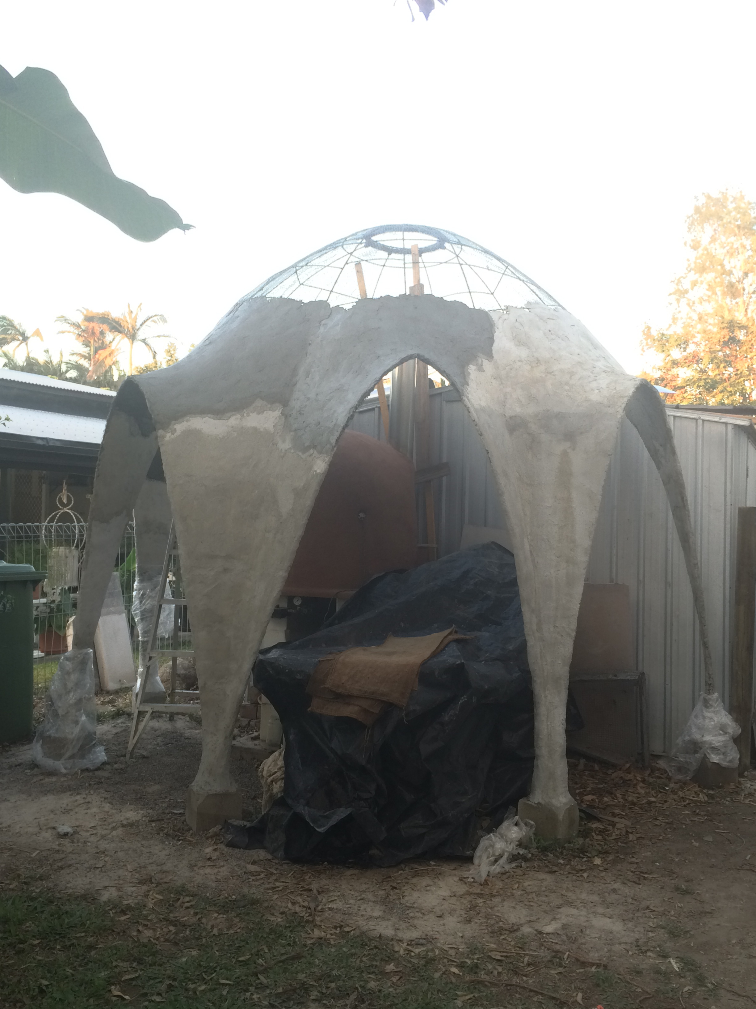

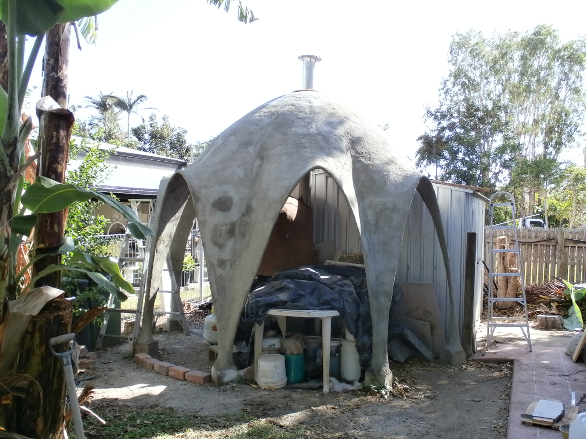

                              I've closed the dome at the top, but still have about the top 1/3 to render from the inside, plus do the floor. This thing is incredibly strong and is around one inch thick.
