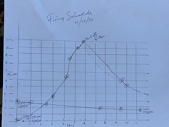

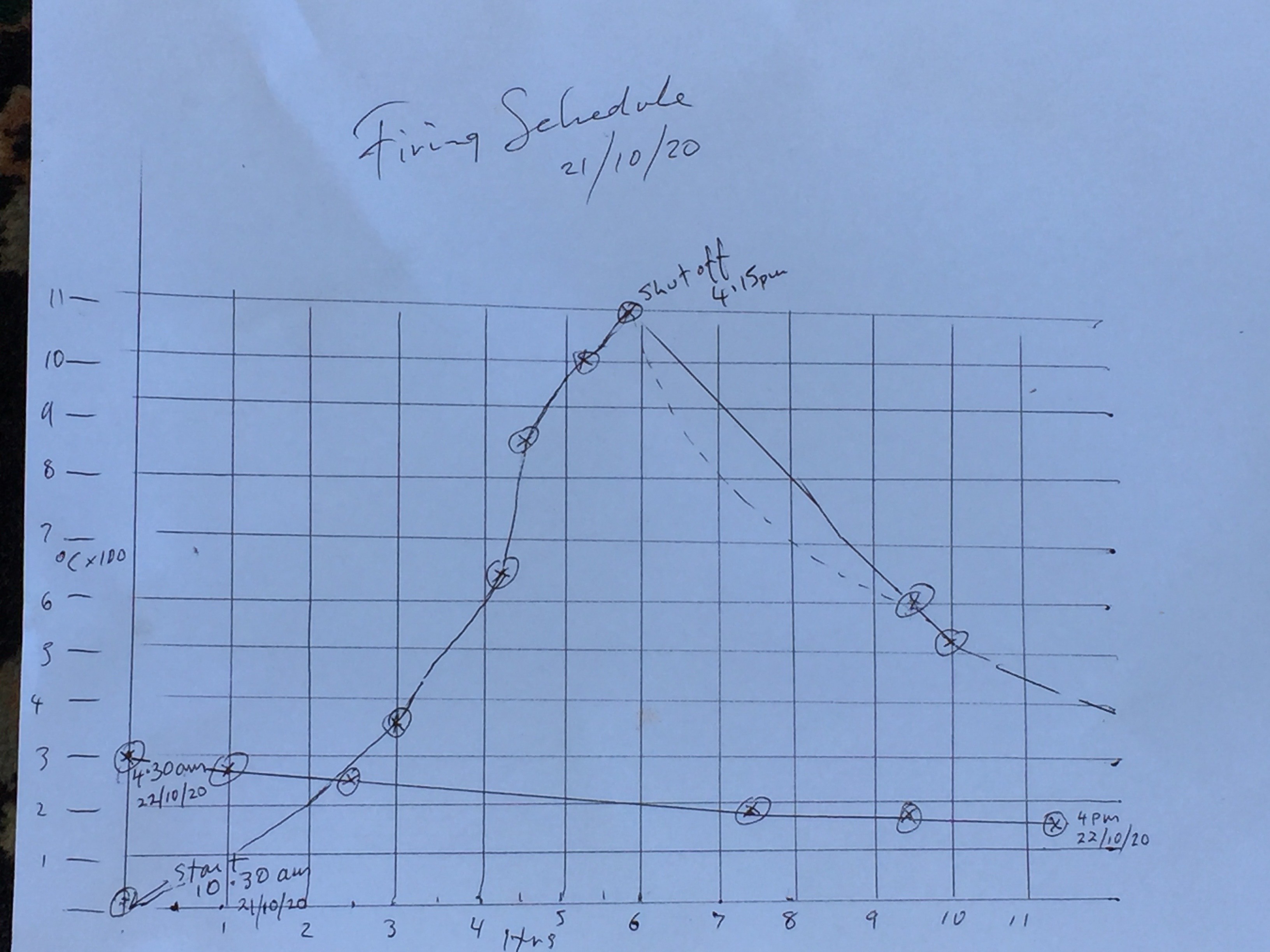

                    As there's been a bit of talk about firing
                    , I thought some members may be interested in the firing schedule of my kiln yesterday. The graph also shows cool down. Fired to 1100C (2012F) in 6 hrs with fuel consumption of around 5Kg LPG. and 200C (392F) 24 hrs later.

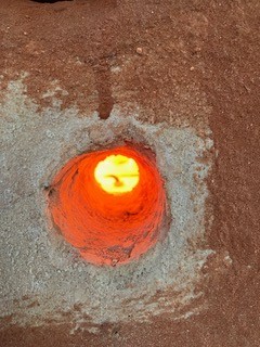

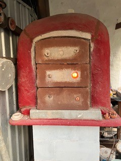

                        Click image for larger version  Name:	IMG_0013 2.jpeg Views:	0 Size:	25.0 KB ID:	446610 Fired the kiln again today 1120 C. The second pic shows the pyrometric cone squatting through the spy hole. .

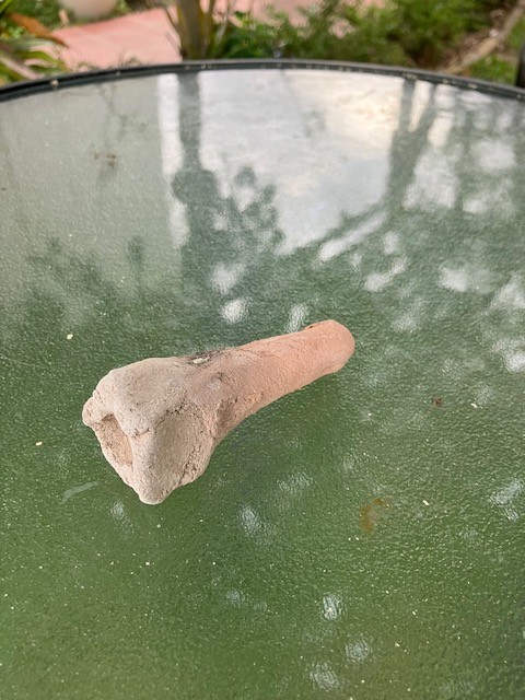

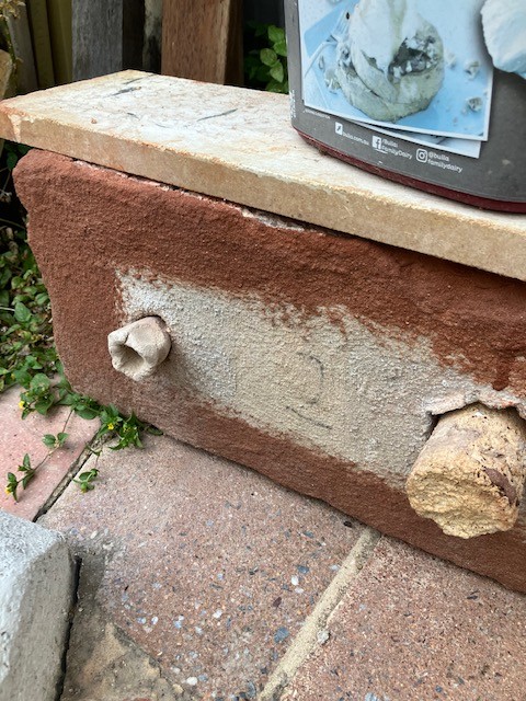

                                Spy hole bung. Note the fired shank in the insulating door panel, while the knob, exposed to ambient air remains unfired.Kiln fired to 1120C
