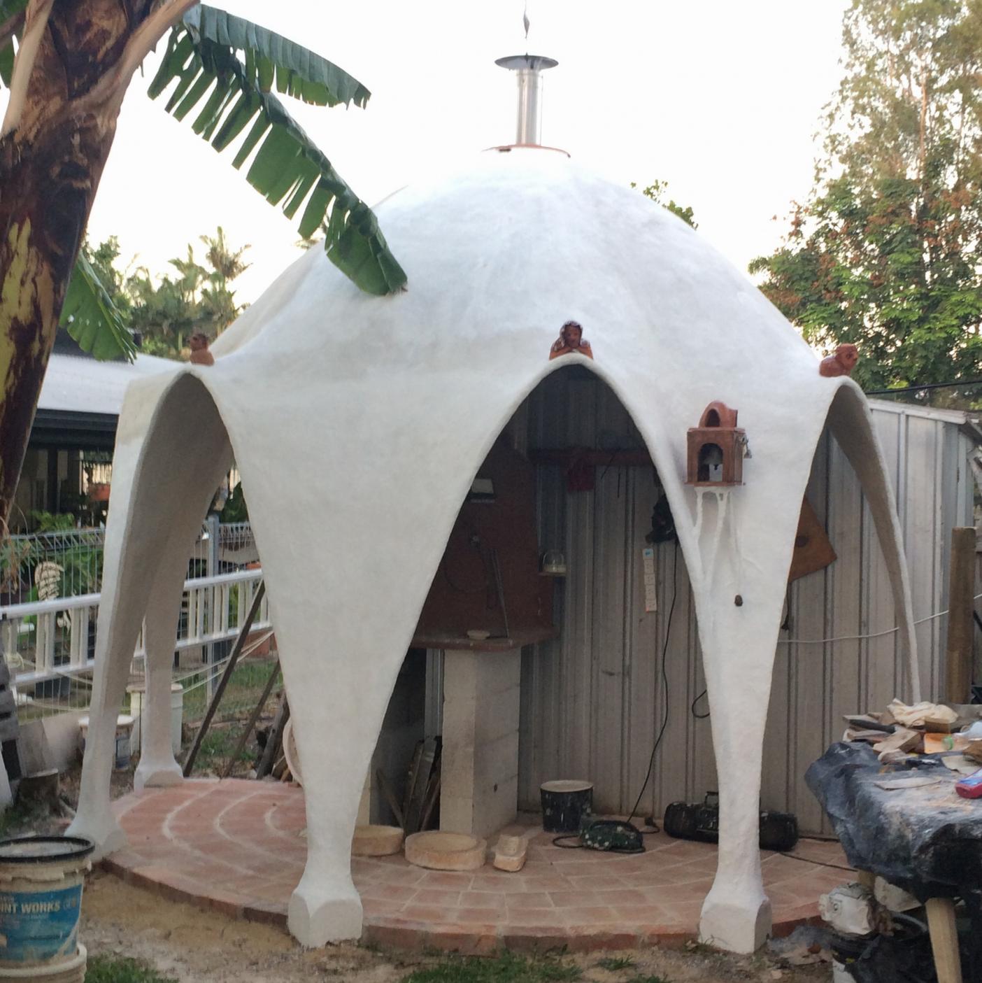

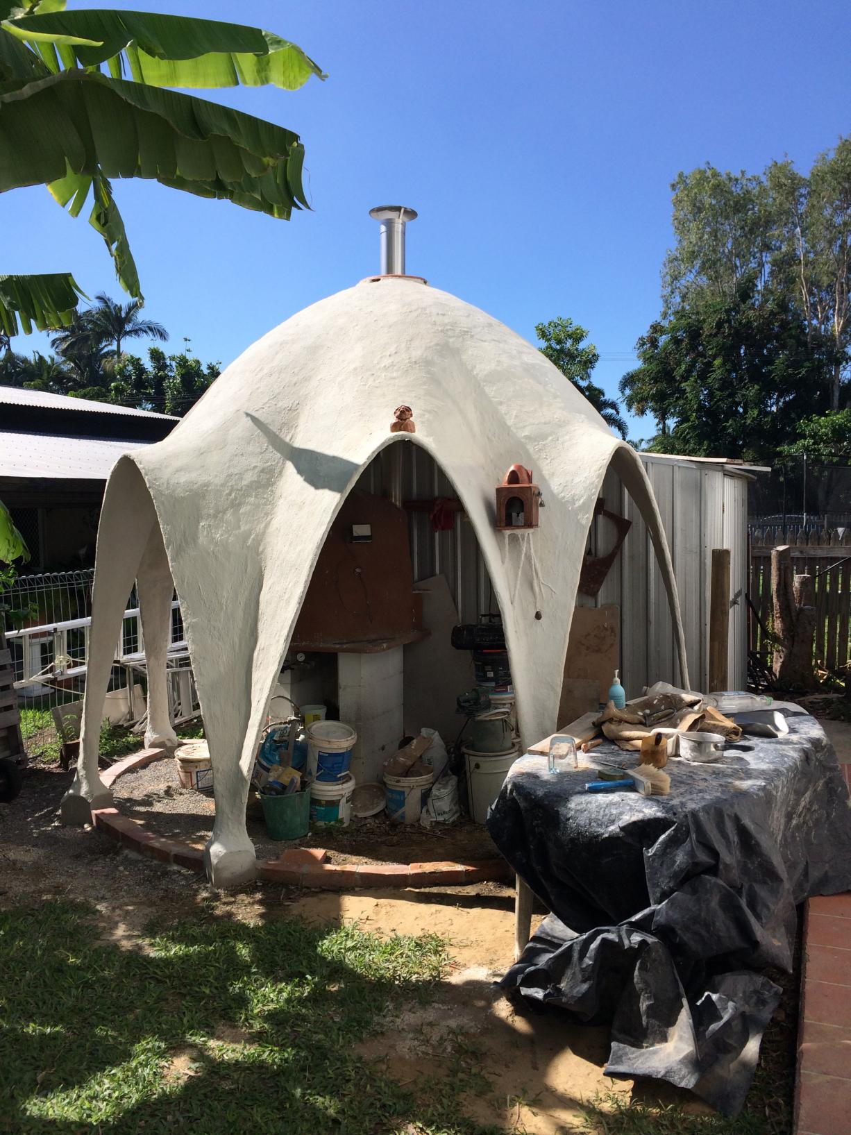

              I'm somewhat embarrassed by how long this project is taking. But as usual once it has achieved its primary objective, sheltering the kiln then it slips down the list of priorities.
              Here is its present state, I still need to do the floor.

                Nice little accent to your build. Assuming this is your ceramic work.

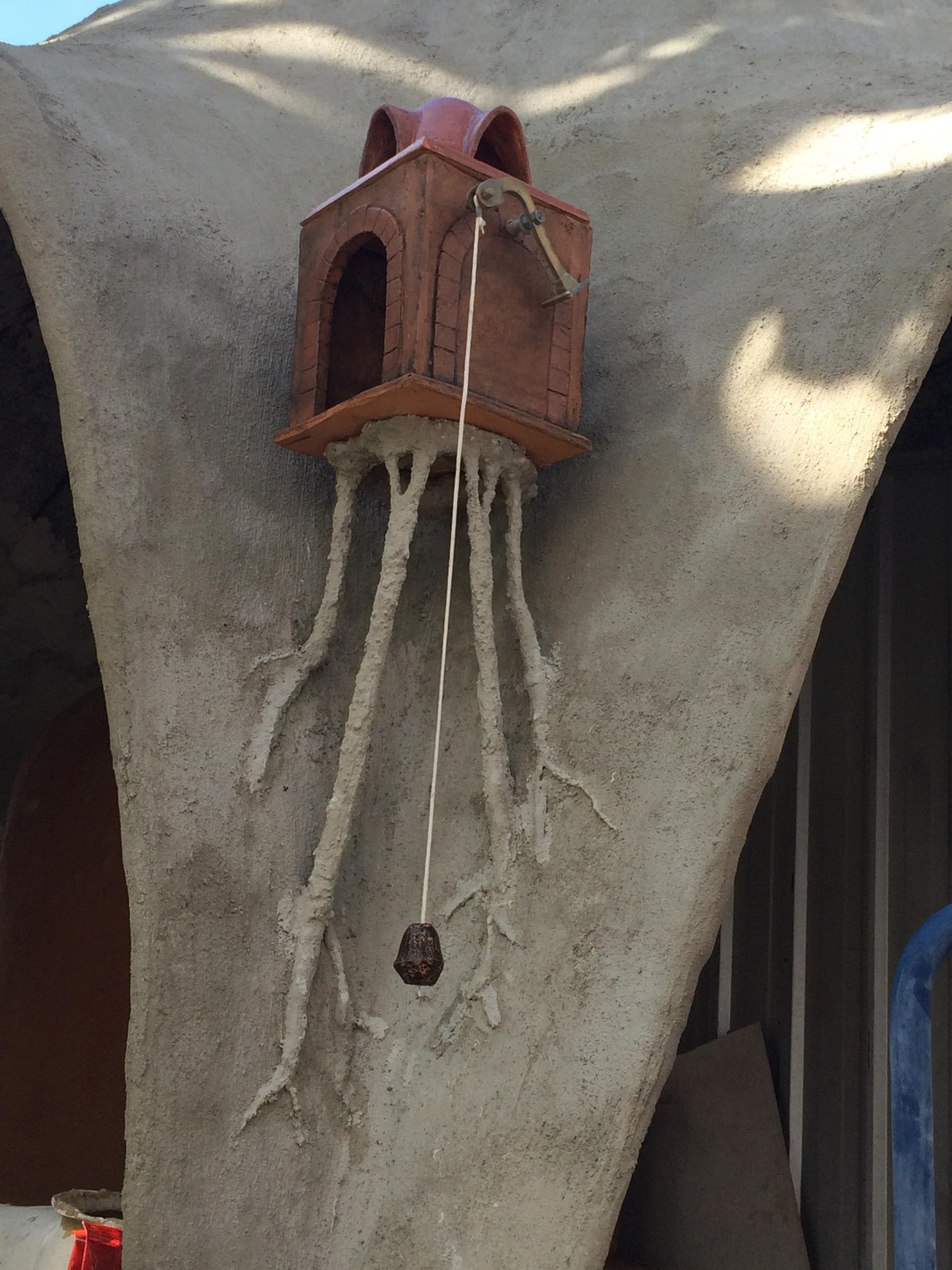

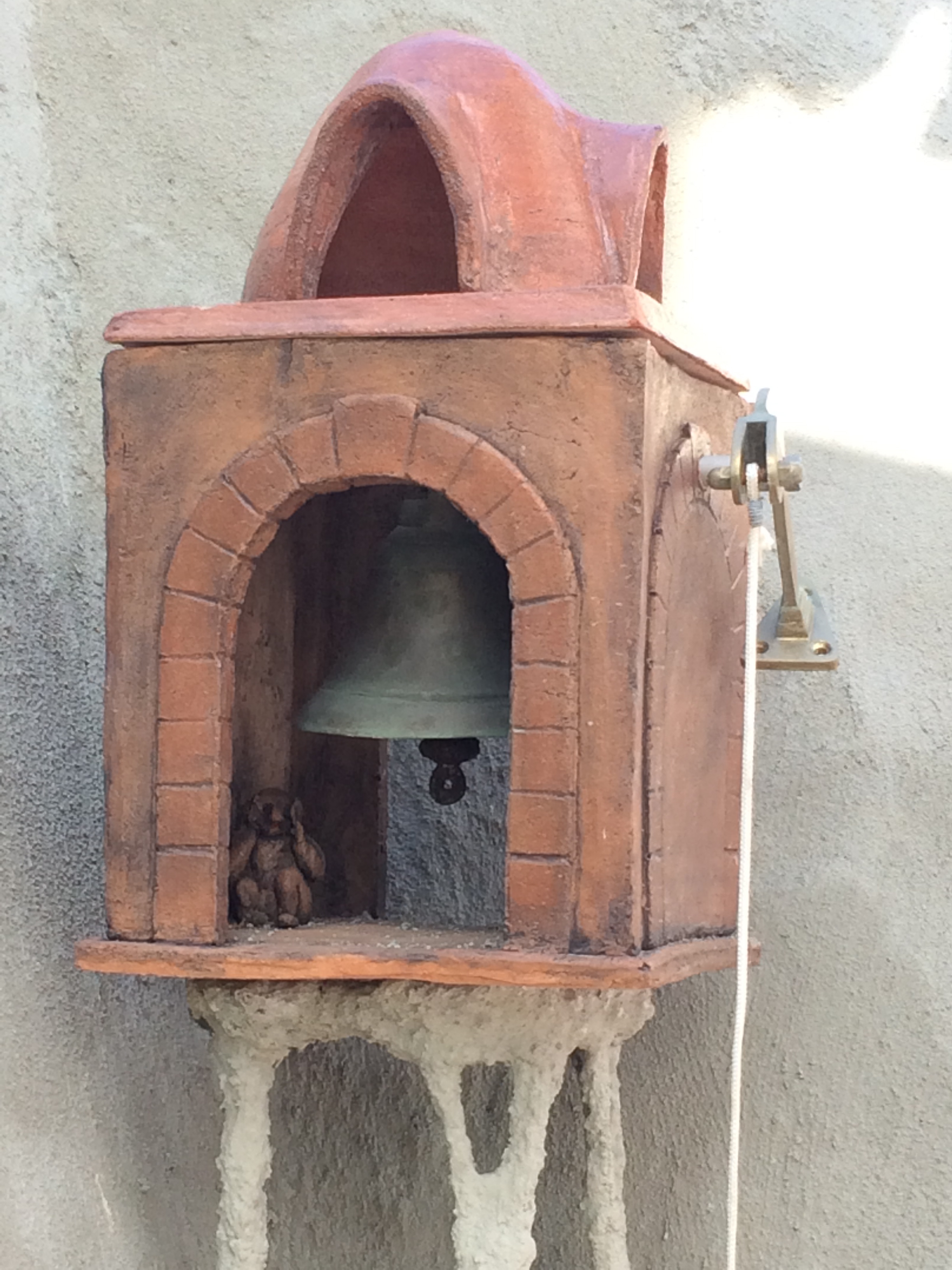

                      You shouldn't be embarrassed how long this amazing project is taking, you've put a lot of thought into that. Thats one cool canopy and I love the roots holding the little oven/house. When you pull the cord, does a bell ring? Awesome work.
                        #56
                        Yes, I cannibalised a brass bell and bracket so it can be rung with the cord. Cosimoto is in the bell tower holding his ears.

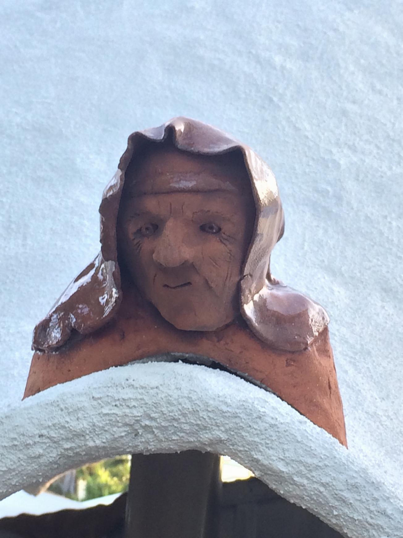

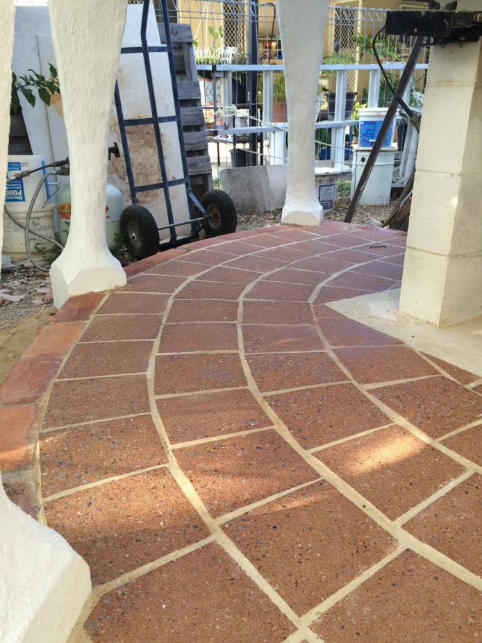

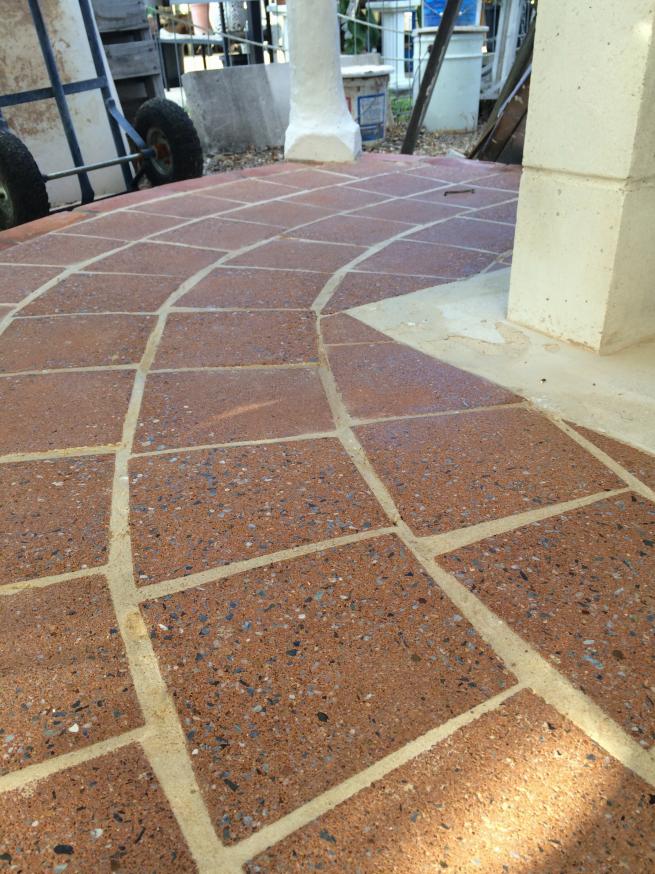

                          My folly aka kiln temple aka intergalactic explorer is finally finished. I used concrete pavers for the floor, but because they're in a radial pattern i had to cut both sides off each one to get a nice fit. I decided to wet grout them and because they're so porous it was impossible to clean the mortar out properly. My solution was to grind them back a bit and then hit hem with the concrete polisher. I was very pleased with the result. Because this is a workshop area I didn't go too far with the polishing, but a couple of coats of sealer has made quite an attractive floor I think. That gargoyle is Mother Teresa by the way. The other two are cardinal Pell and Pope FrancisClick image for larger version

                            David that is an amazing piece of art true craftsmanship hats off to you. you could of got away with the polishing if you would of sealed the pavers before you grouted them to make them non pourus, then you could just grout them like wall tiles easy clean up, but to be honest them pavers look better for the polishing like marble well worth it! roughthly how long did the polishing take just by interest?

                              After grinding back half a dozen high spots I polished the whole lot with a #50 which took around an hour all up and wore out one pad.
                              i hadn't thought to seal the pavers first, that probably would have worked well, I'll keep that in mind

                                On a side note, Lee is right about sealing the pavers. I applied the floor splits to my dome and then later pointed them. A carefully rolled on layer of sealer to the exposed faces, before pointing, made the cleanup a lot easier.
