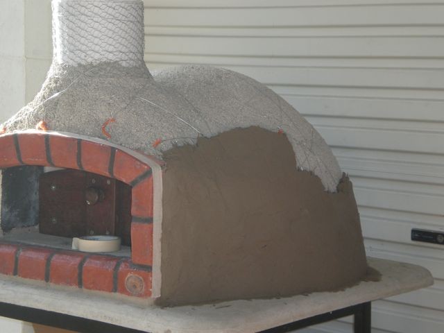

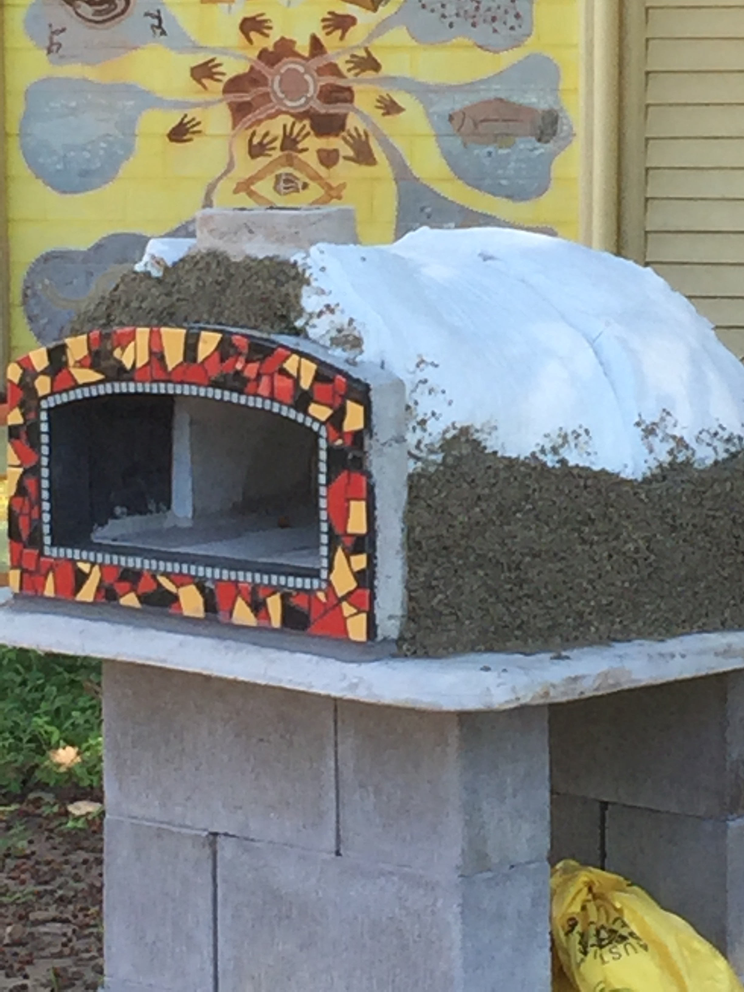

          1. The perlcrete mix Ben uses is way denser, thicker and stickier than what I use. The 10:1 mix is far crumblier and harder to apply, but is far more insulative (see table)
          I Then use a much stronger render to apply over the perlcrete in a thinner layer. Notice I don't use any chicken wire over the blanket as it's way too time consuming.
          2. Often a crack can develop where the outer dome shell meets the supporting slab. My solution is to coat the whole dome and the supporting slab with a flexible waterproof acrylic layer around at least 1mm thick. I use flexible pointing diluted 20% with water so it can be painted on.

              Adding sand or cement to the mix simply makes it denser and therefore a poorer insulator (see table). Skip the sand and lime, keep the cement proportion as low as possible and add powdered clay to make it more workable. Even a 10:1 mix has more mass from the cement as from the perlite. A 50/50 mix of perlite and vermiculite seems to work better than either of the two alone.
              Flexible Pointing was developed in the 80’s to coat the mortar on tiled ridge caps on houses. As the root is continually expanding and contracting the mortar would often crack resulting in roof leaks the roofers often had to repoint. Since the invention of flexible pointing, an extremely flexible acryli, containing fine sand for high build, the roofers never have to do that job any more. As it is more flexible and cheaper than an acrylic render and it contains plenty of UV resistance it is ideal for our use. It is designed to be troweled on but I find it easier to apply by diluting it 20% with water so it can be painted. 3 heavy coats result in around a 1-2 mm thick layer.
