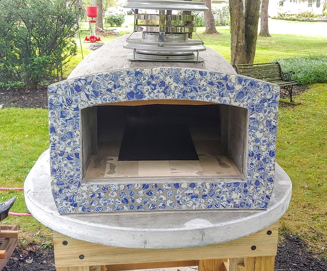

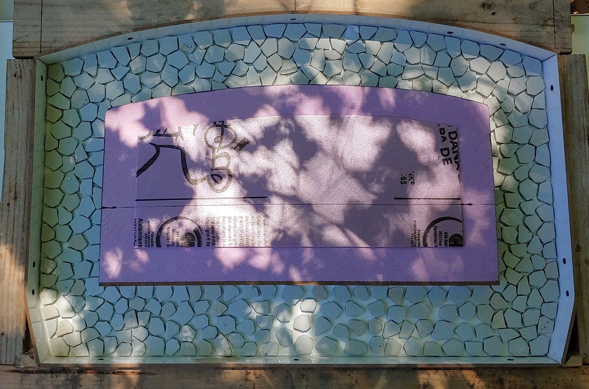

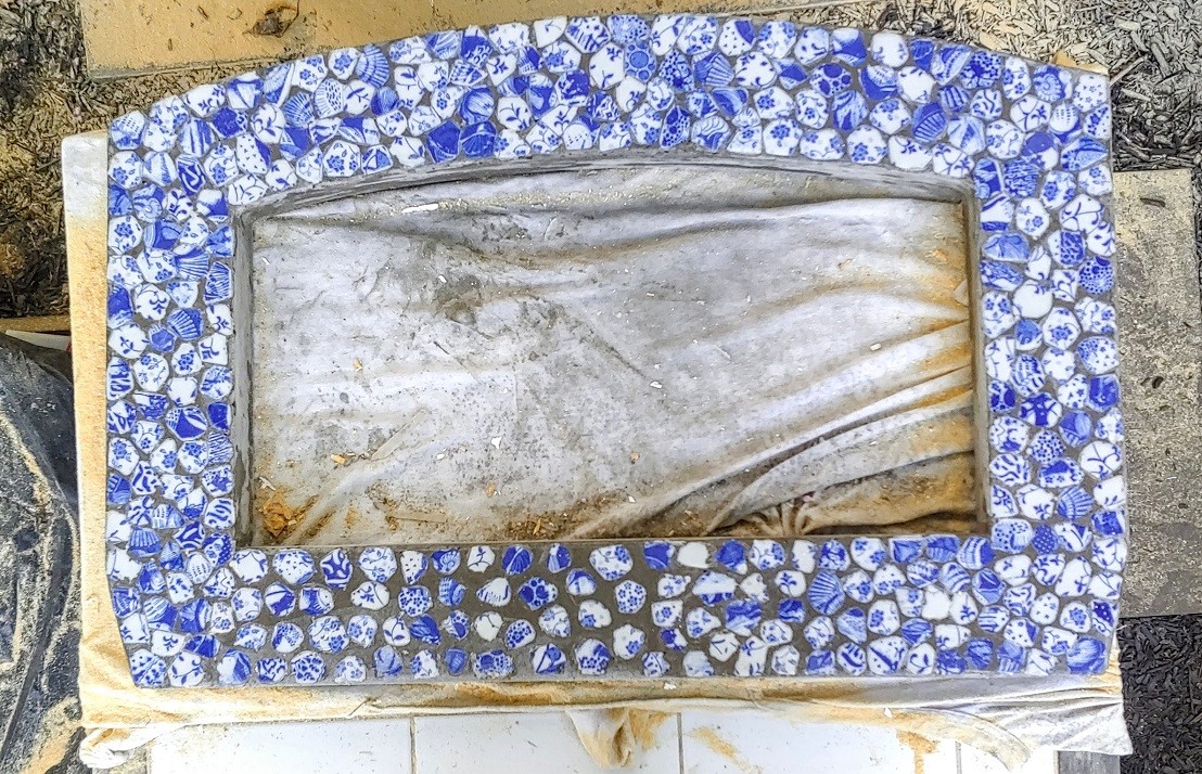

            #65
            Done with the facade. Glued the tiles to the bottom of the form with silicone. I will need to figure out how to get the silicone of the tiles. I should have used something else. Do I love the look? I think it is decent and hopefully will get better when dry, clean of silicone and framed with the outer layer.

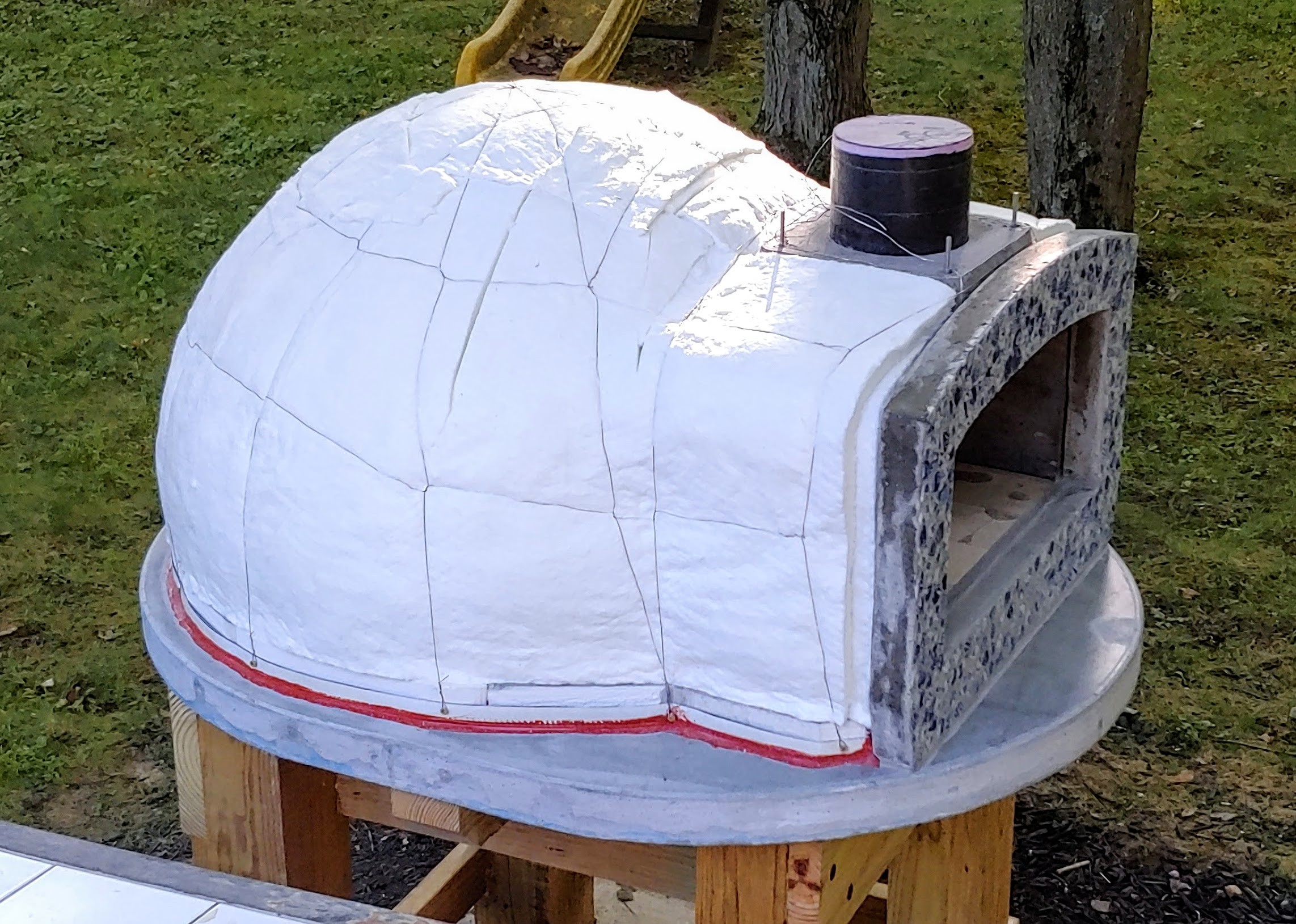

              #66
              How does this look? I think the wire holds it down well enough.
              Shall I start the curing fires or wait till the outer layer is in place? Thanks!Click image for larger version
              • Mullster
                • Apr 2020
                • 193
                #67
                Shall I start the curing fires or wait till the outer layer is in place? Thanks!Click image for larger version  Name:	20200912_170032_HDR.jpg Views:	0 Size:	795.7 KB ID:	430028
                If you mean putting the flue in place first and then firing I think it could be ok - personally I also got the vermicrete layer on top of the blanket too before starting.
                My cast oven build thread
                https://community.fornobravo.com/for...-castable-dome
                  #68
                  The outer arch looks nice. I’d attack the silicon with a stiff scrubbing brush then grout the tiles with a black grout.
                  most builders use a 10:1 vermicrete or perlcrete over the blanket to restore perfect hemisphere and to provide a firmer substrate to render onto for the final outer shell. I like to drive out excess water after vermicrete layer but before outer tendered shell.
