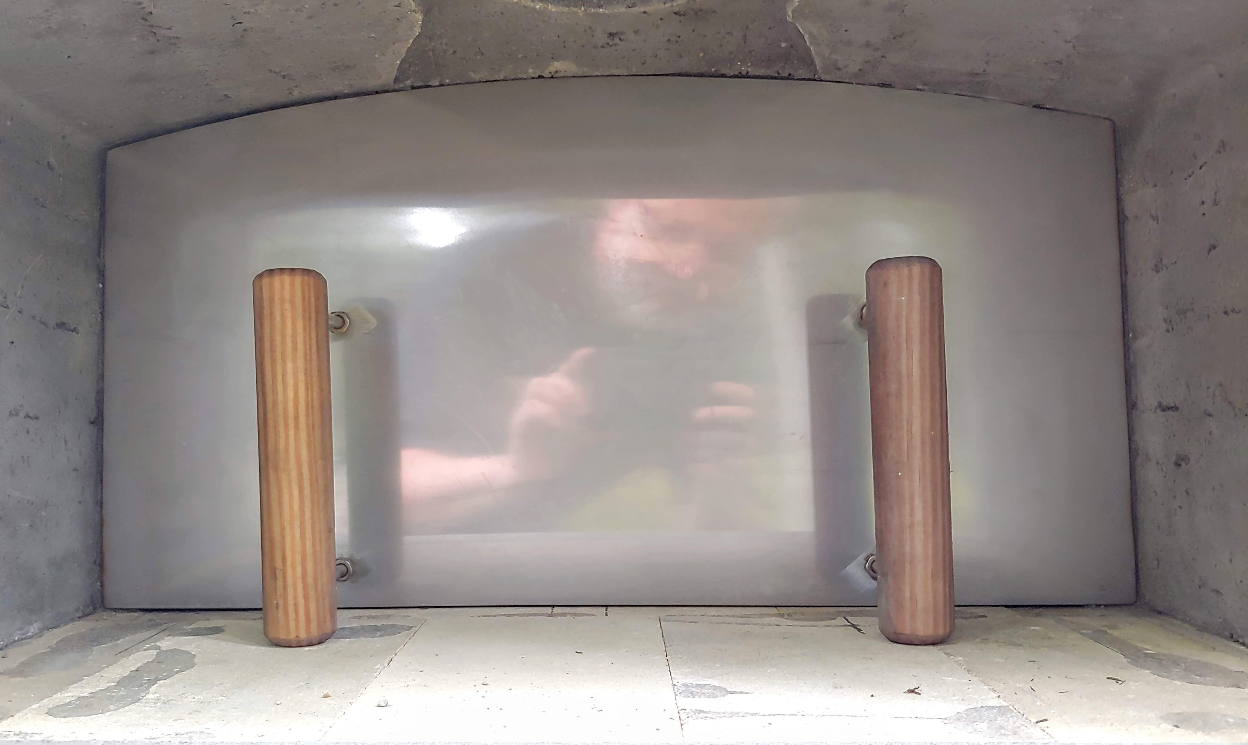

            Watching perlite concrete dry is so exciting... So I made a (semi)shiny door. I think the fit is pretty decent and it should be able to extinguish the fire when shut.

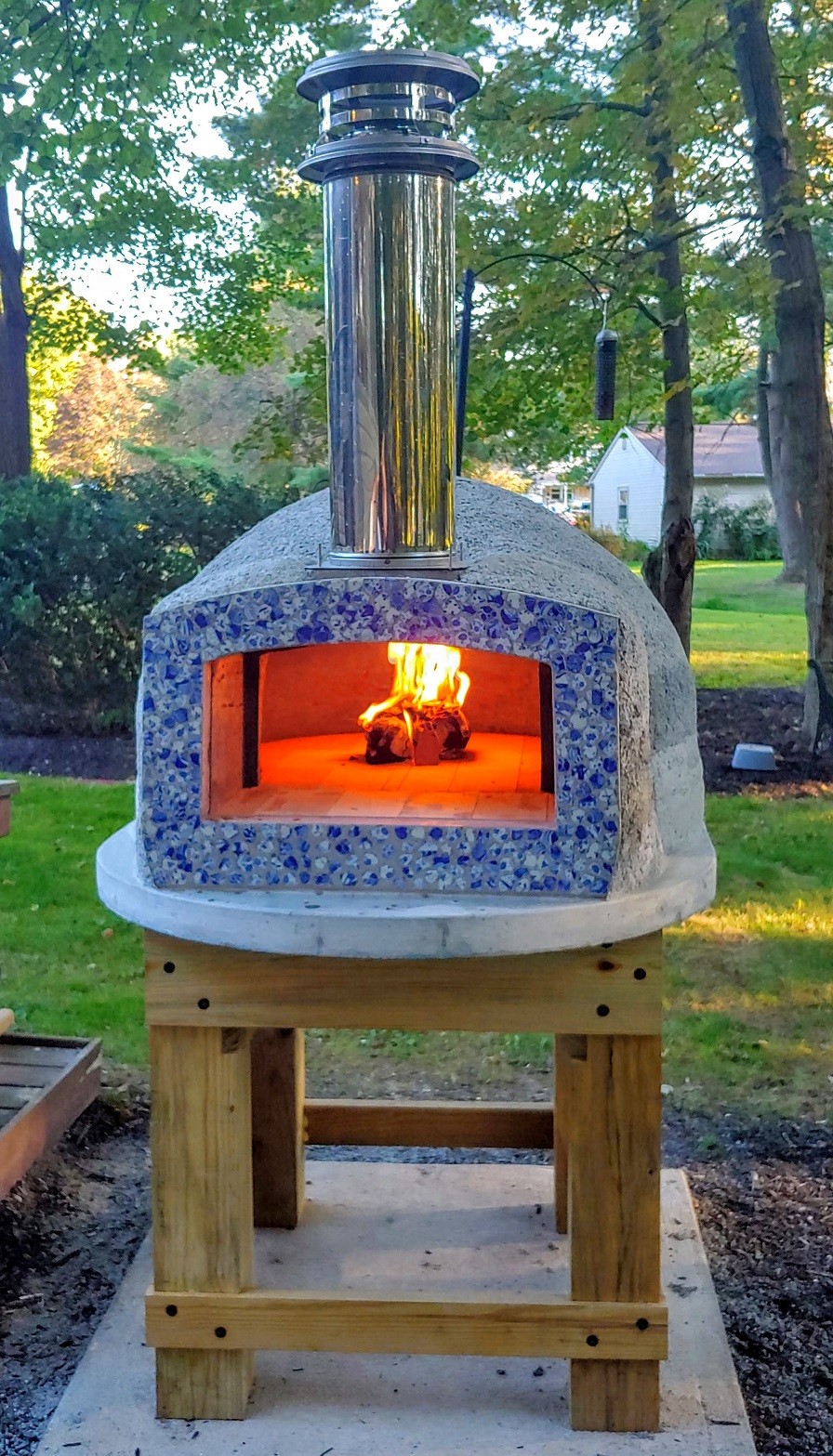

                  I have to admit - the first fire is a sight to behold! Enjoyed it a lot!
