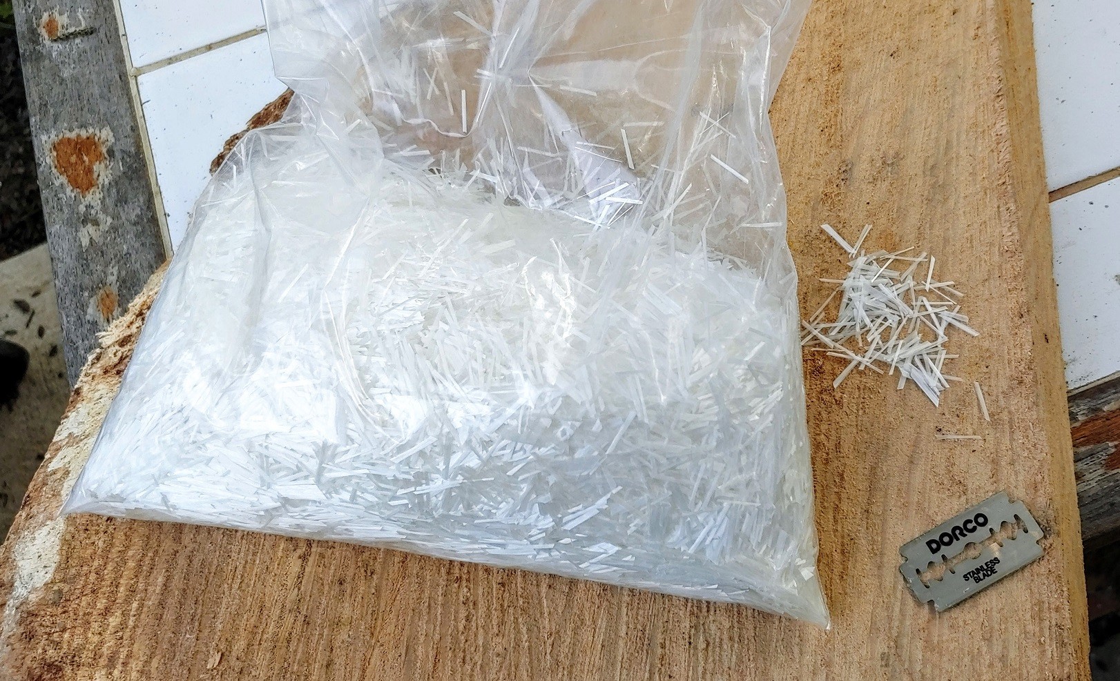

    I did say 700 ml (not grams) for every 10 litres dry render mix. The fibres are pretty light.
    I also said keep covered for a week to damp cure. Depending on how thick you make your render layer it will still require drying. Even at 10 mm that will take more than a few days. Forget pizza for now, I know it’s hard, but you wouldn’t jump in a brand new car and yes it’s top speed on delivery. Be content with roasting some chickens or pork roasts for a few firings before going for pizza temperature.

      Are we talking about AR fiberglass fibers? The stuff in the picture below? That's what I got and I was surprised of how heavy they were for the volume.
      Googled 1 liter of dry concrete = 5.3 lbs (LOTS of stuff on the Internets!). So 80 lbs need about 1 liter of fibers. I think one pound is about right for a 80-lb of dry stucco. Thanks!
      Will wait, roast something else at 400-500F. Not the worst hobby I had in terms of waiting. Homebrewing was the hardest! I can do it! Chicken wings will sooth the pain! Thanks, David!!!

        Those fibres look like mine and I’d say 1 lb/80lb dry render sounds about right. The roast chicken should go well with the .

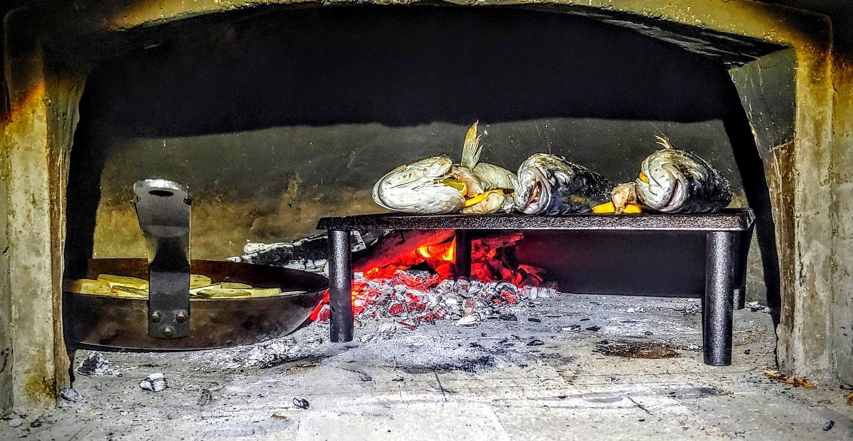

              On my last curing fire, followed David's advice and roasted some fish. Turned out quite nice, especially for the first time! Need to tailor my cookware to the oven. 30" is somewhat of a tight fit but it will work.

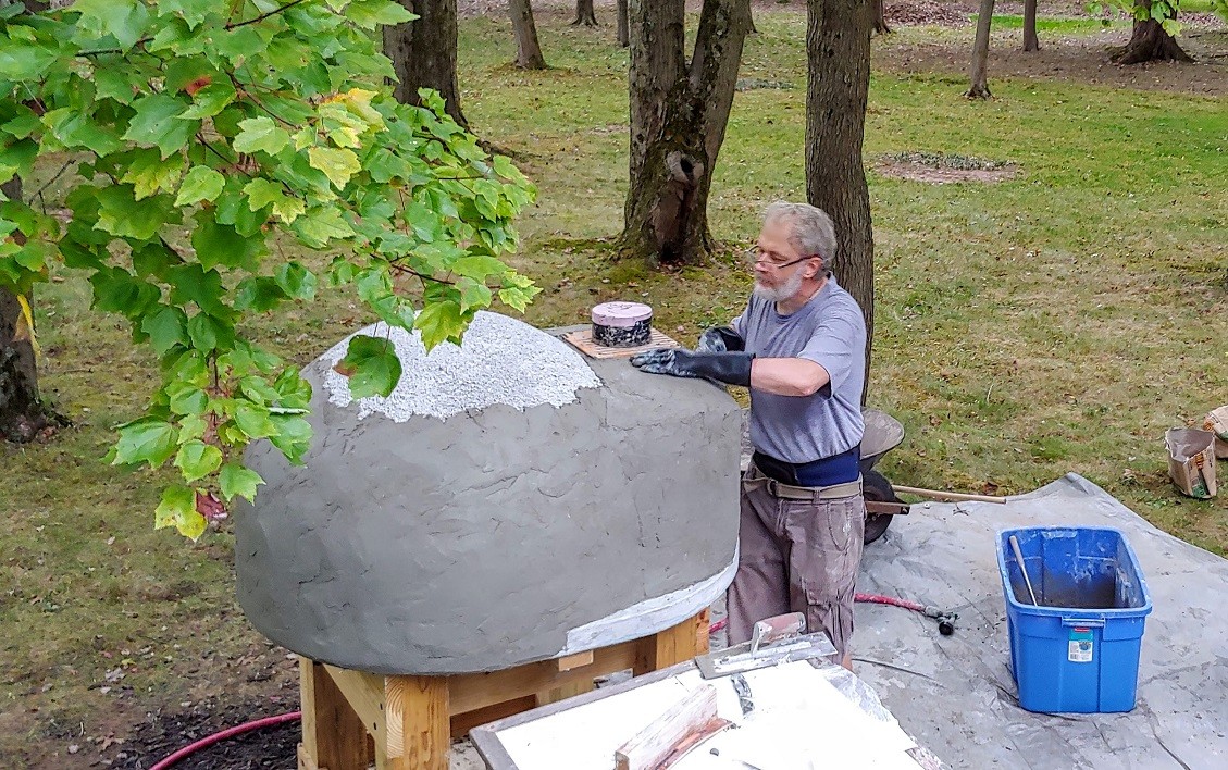

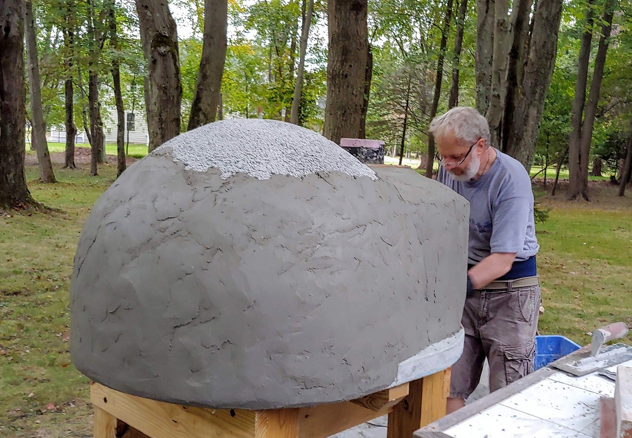

                        Will do all that, David! Thank you! I made a float from polystyrene foam with the same radius as the dome. If using that with water doesn't smooth out the surface I will use a sponge. It's just scary to do this for the first time though I have watched a bunch of videos.
                        • sergetania
                          • Jun 2020
                          • 209
                          #117
                          Originally posted by david s
                          You should be fine
                          No, David, it will take a few days before I feel fine again! My computer hands will feel this for a while! It looks easy in YouTube videos! It's HARD work!
                          Again, lots of respect for people who do this for living! I think if I do it again the result will be better. By the time I was done with it the render on the bottom got too hard to smooth out all gouges. I guess it will give the oven a character. I will feel bad about it but I really don't want to do another layer. I hope I am done. Covered with plastic wrap and plastic cover, it is curing. It is what it is...
                          Oh, btw, it is hairy in a few spots because of the glass fibers. It's especially bad around the facade. I need to shave it somehow

                            #118
                            Use sandpaper to knock back any fibres sticking out.

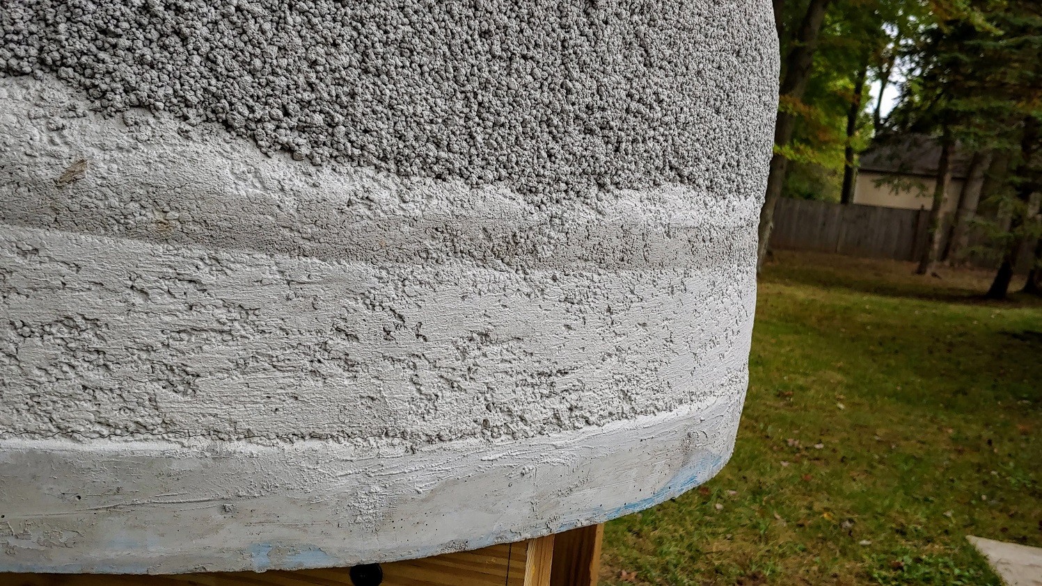

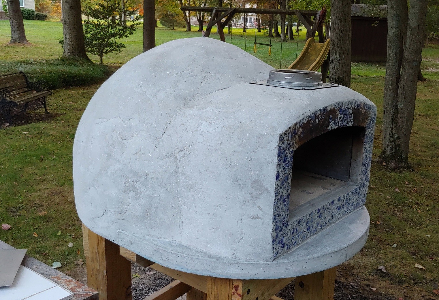

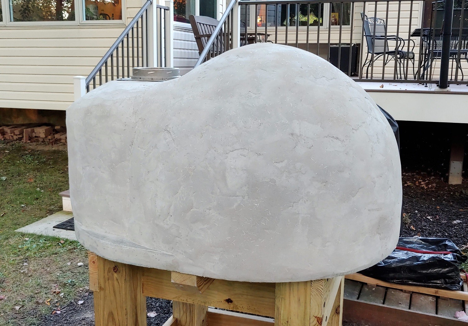

                                7 days have passed and here it is. If I ever do stucco again it will be smoother. At least this one seems to be strong. I will cover it with flashing sealant and hope it will make it look better.
