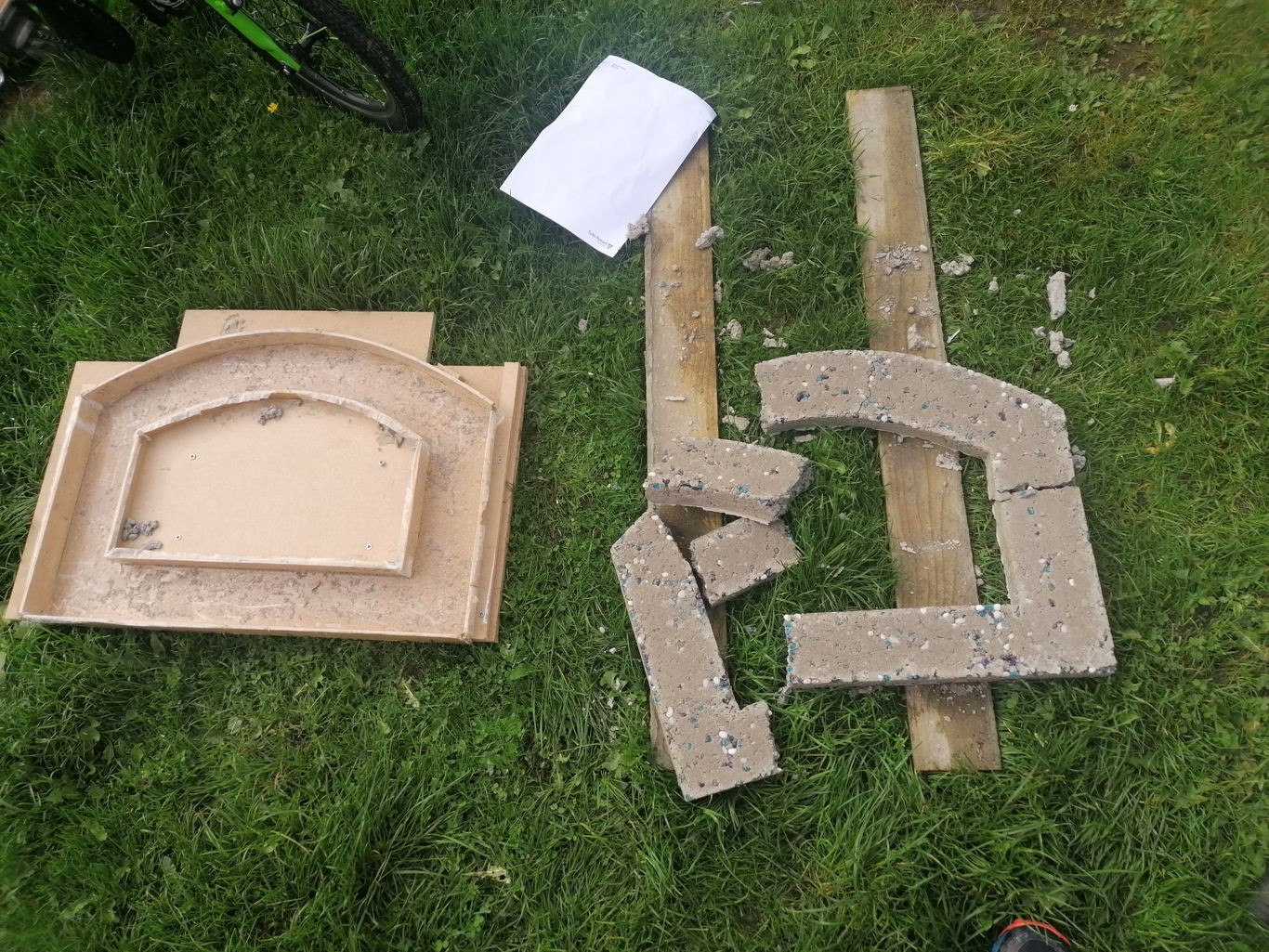

        Ah gutted, even left my arch for a couple of days longer just in case. I think the problem is I used my decorative glass as my gravel for the mix, it's really smooth stuff so I don't think it binded. My mix was 1 cement:2sand:3gravel(decorative aggregate). Has anyone had anything like this, or should I have put rebar through it?

          So sorry to see that mate - perhaps it was the aggregate like you said. At least you can make another one though.
          I used some reinforcement in mine and just put the decorative on the very front (set in) and used normal pea gravel in the mix.

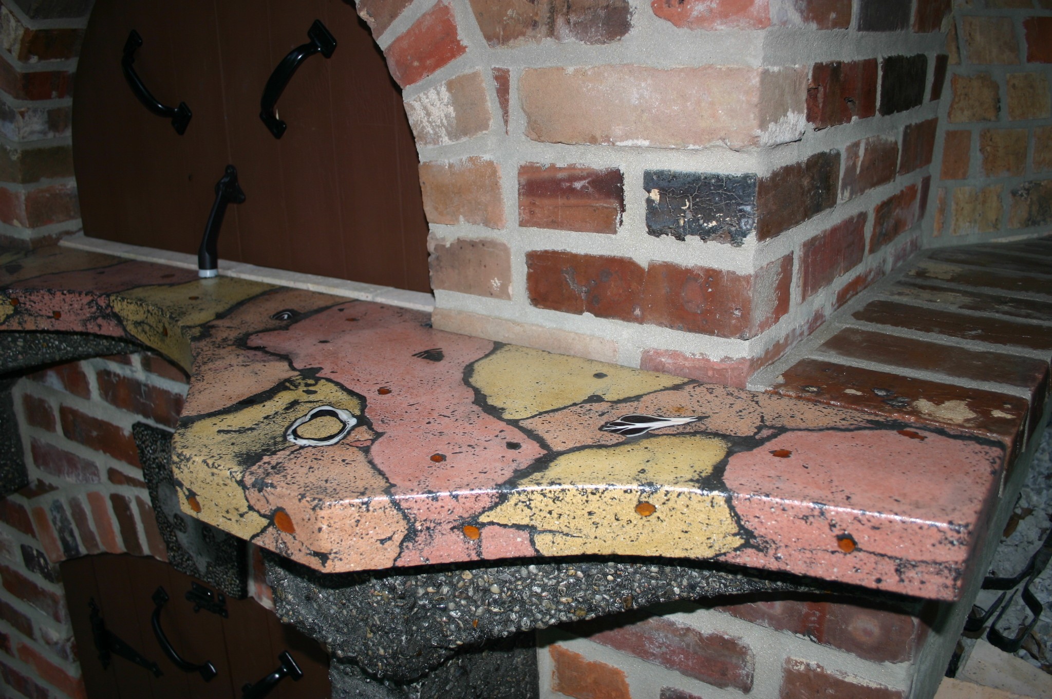

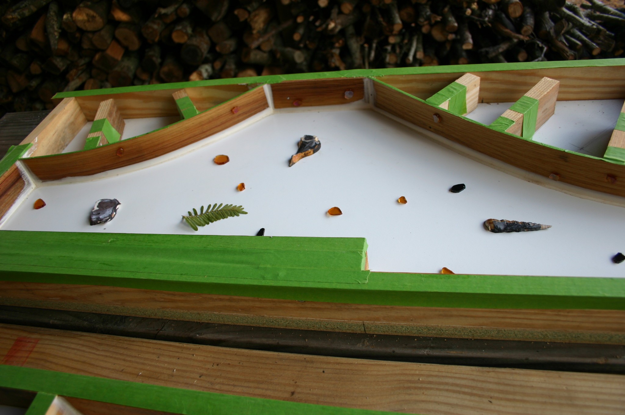

            +1 on the reinforcement. I think that you really need it. I'm not sure if the aggregate was the problem. But, for a reverse concrete form you can make the bottom of the form the front. Placing already smooth surfaces toward the bottom will make polishing the face much easier. I broke and used the smooth side of some already broken colored glass panels that I got free from a glass company. I placed (glued) them in the form where wanted. With that you can use what ever type conrcete and aggregate you want for strength.

              That’s a pity. 3:2:1 not all that strong, especially for a tin casting, add a bit more cement or some thin (5 mm) steel bar and some AR glass fibres.
              Also wrap the casting up for a week to damp cure.
              you only need the fancy aggregate in the surface you are polishing. Also the aggregate size should not exceed 1/3 of the casting thickness.

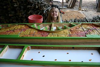

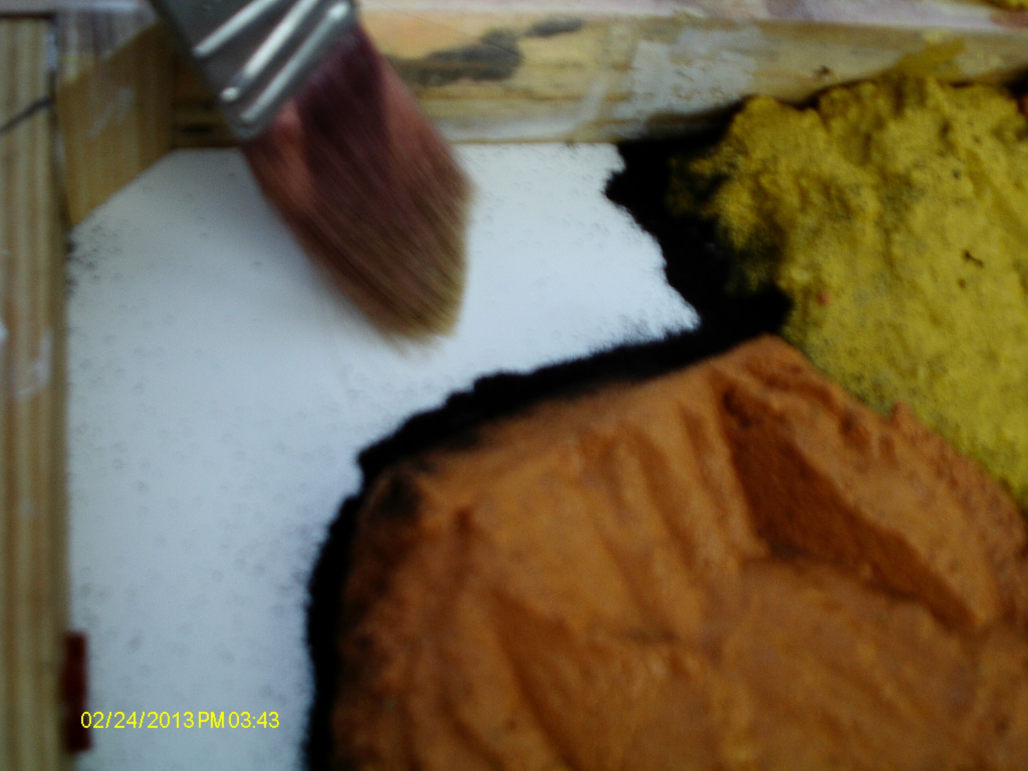

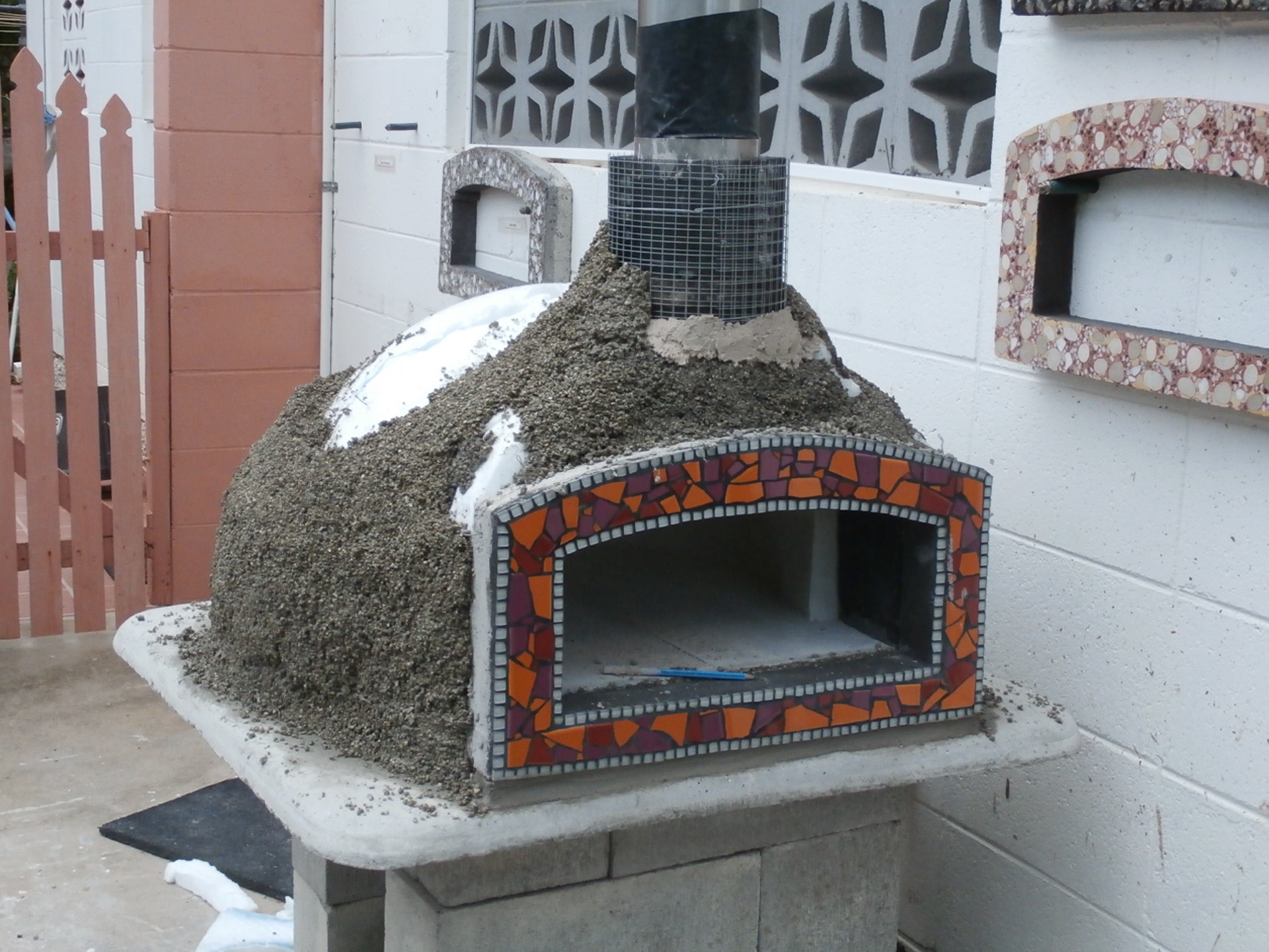

                I'm curious how you created the coloured marbling effect in the concrete. It looks really effective.
                Google Photo Album 60cm https://photos.app.goo.gl/PJYoSDg9kdWfFfjb9
                Google Photo Album 65cm https://photos.app.goo.gl/UPZv23BiQW4qhjVy7
                • #38

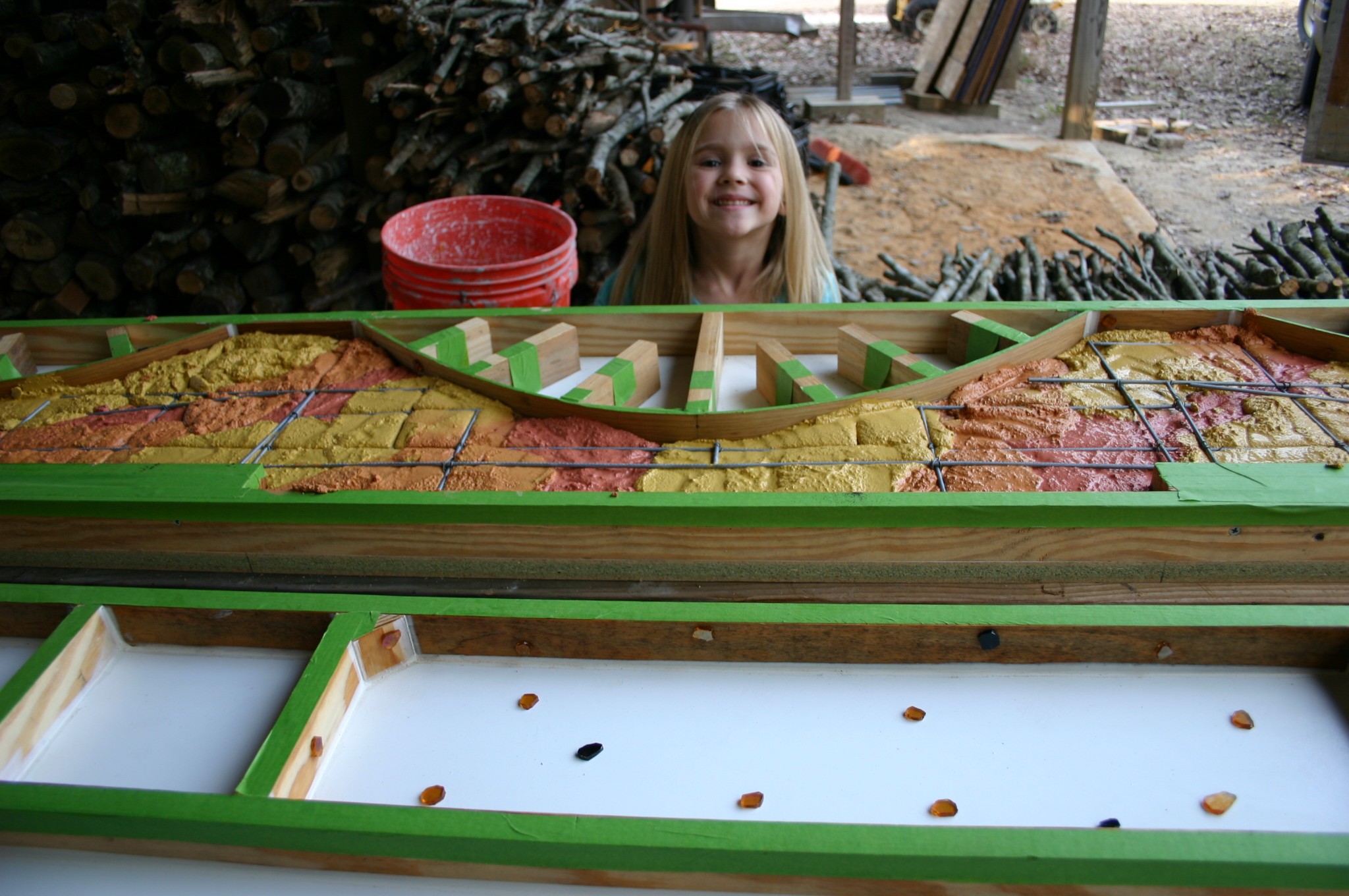

                  Thank you very much. Note that the form is upside down. I mixed 3 colors of concrete pressing them in to the form randomly. I placed a small ridge of loose black sand into all borders before adding the next color. (The trial run in the first pic is looks a little thick) I just wanted to create a very slight void between the colors at the very surface. The last pic is after the piece has been removed from the form and cleaned. Most of the loose black sand has been removed from the borders creating thin tapered voids. These voids along with all the other purpose made and natural occurring voids are later filled with a charcoal colored slurry before polishing.
                  I hope that I am not hijacking the thread but, the middle pic does show ladder wire reinforcement....... and my beautiful helper..... She is almost as tall as me nowadays

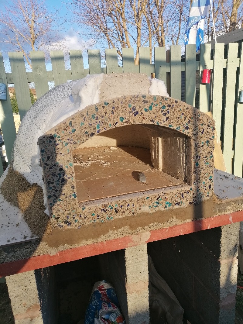

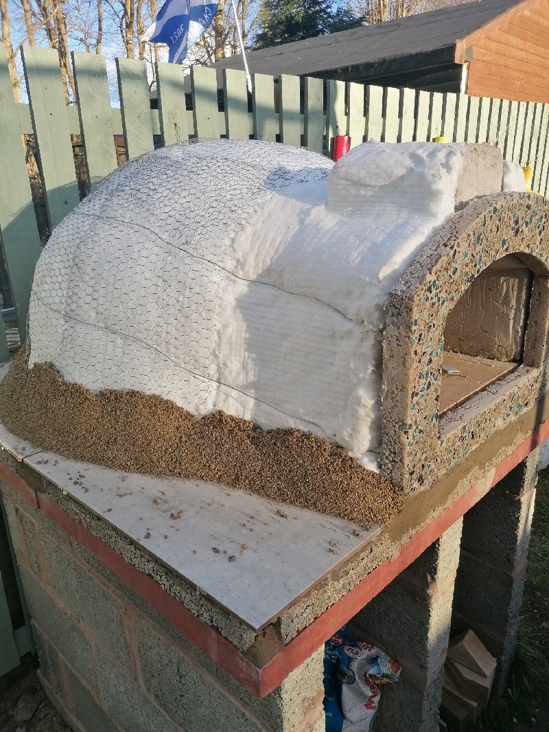

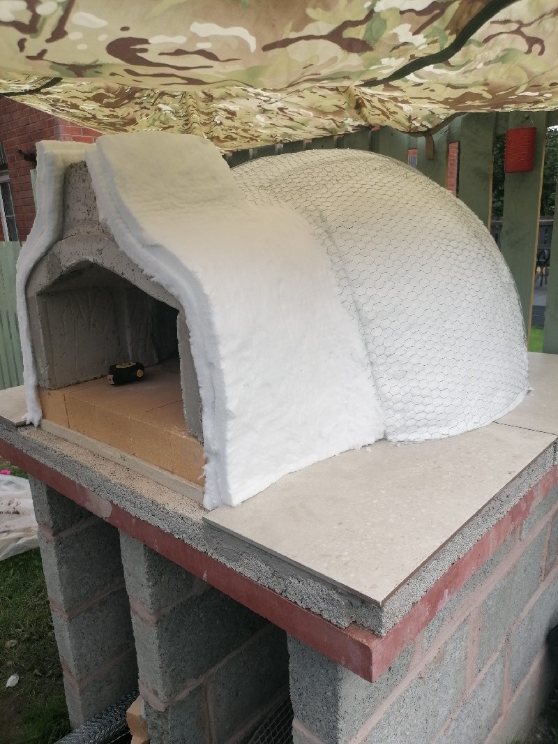

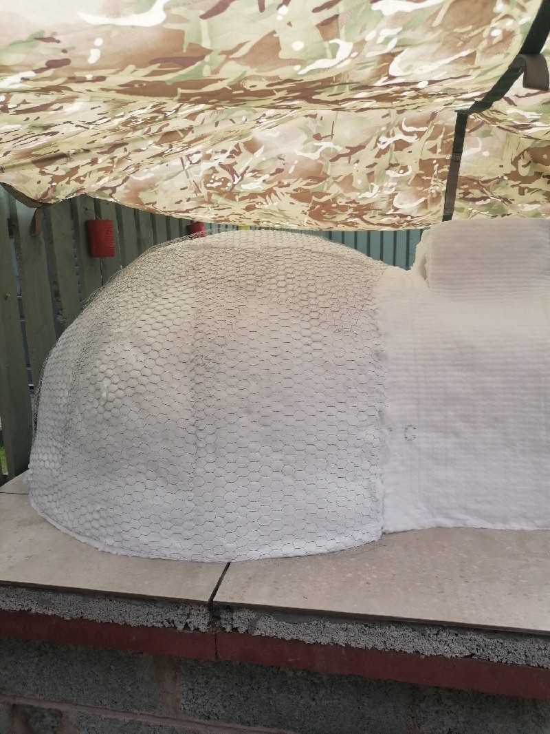

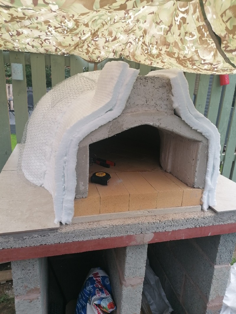

                    So I'm back after a long winter and crazy work time, I inspected the oven over the winter and it's held well but had been kept well covered. I've now added the ceramic blanket and covered in chicken wire. Click image for larger version

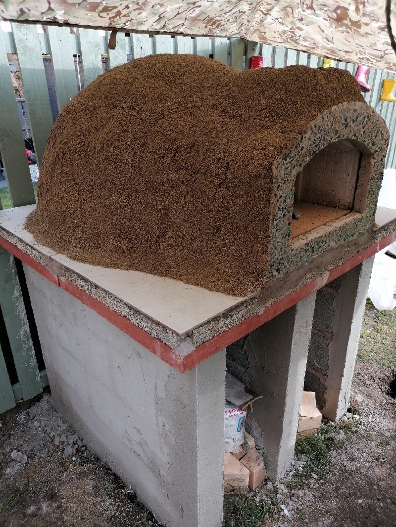

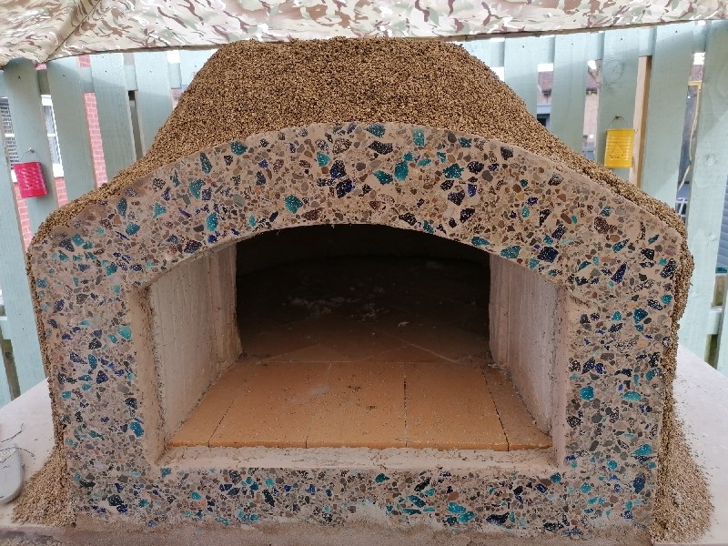

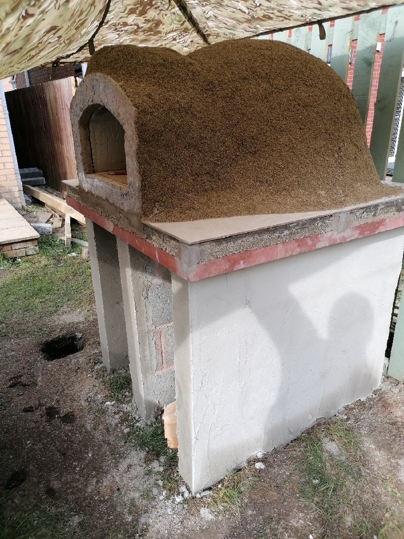

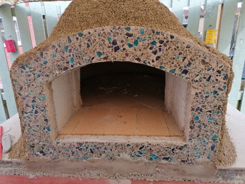

ID:	437146 Also completed the polished arch (adding rebar, a few bits of SS needles and a bit more cement strengthened it) completed the vermiculite layer and rendered the stand. Click image for larger version

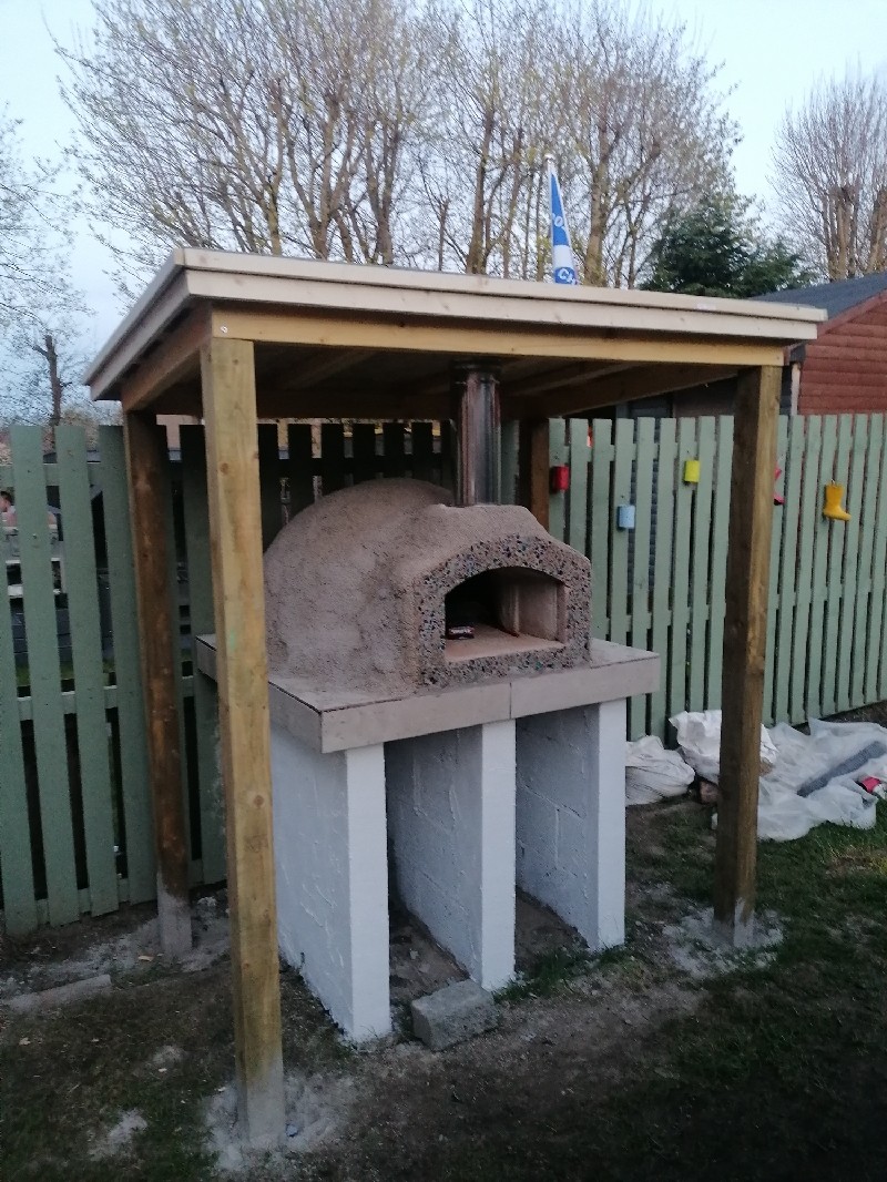

                              sergetania cheers, aye not too far off, just put up the pizza cover so going to start the 7 days of fires as suggested by david s in his previous posts. I've read your posts and the build looks amazing, did you render straight after the curing fires?
                              • #45

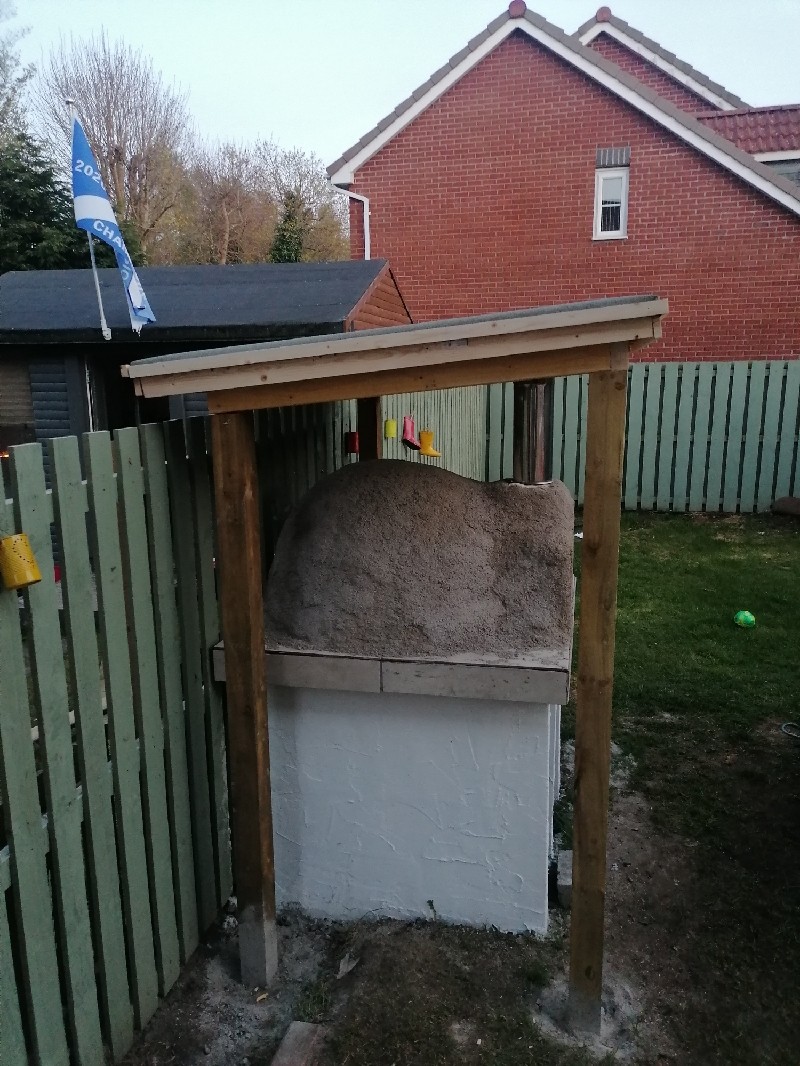

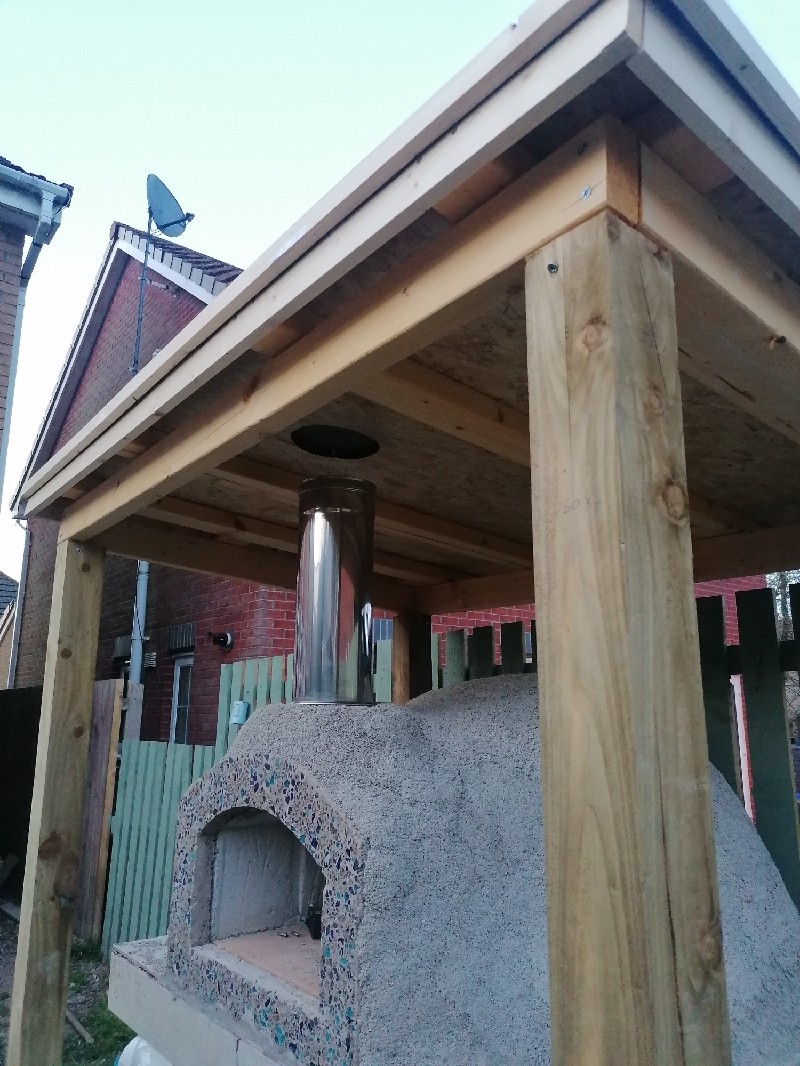

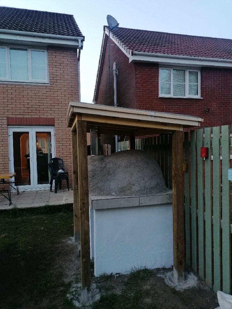

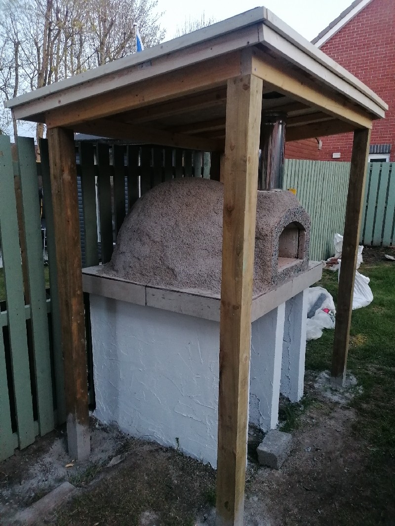

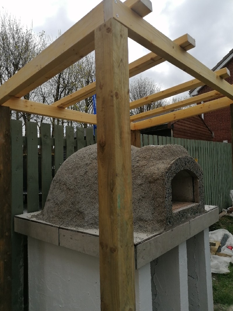

                                Pizza cover done, time for the curing fires starting tomorrow once the flue is extended above the roof Click image for larger version
