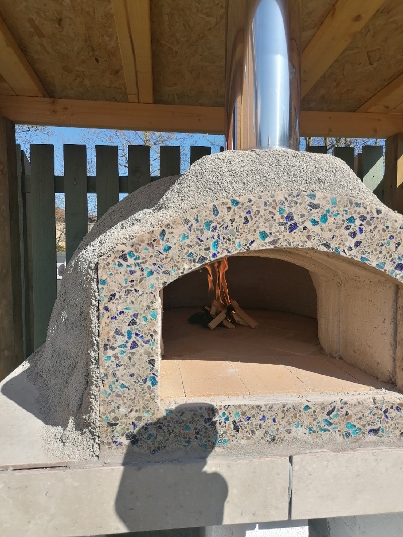

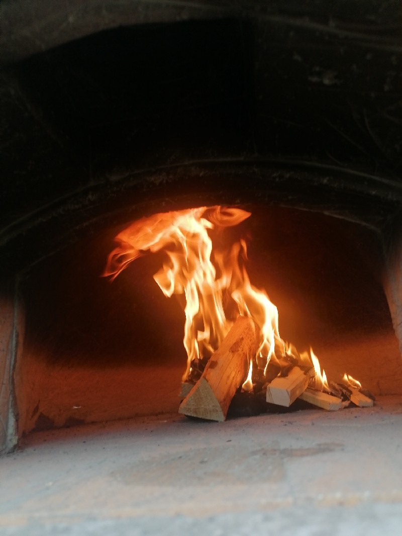

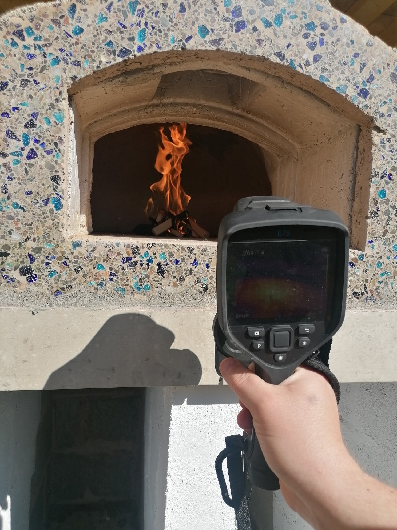

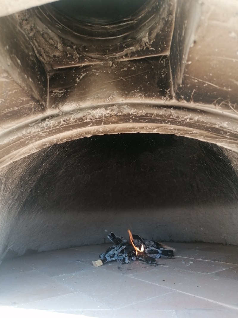

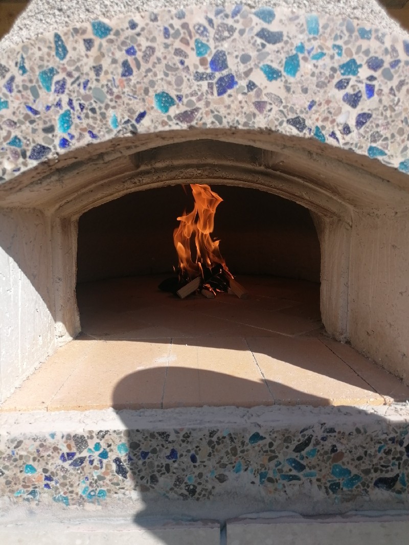

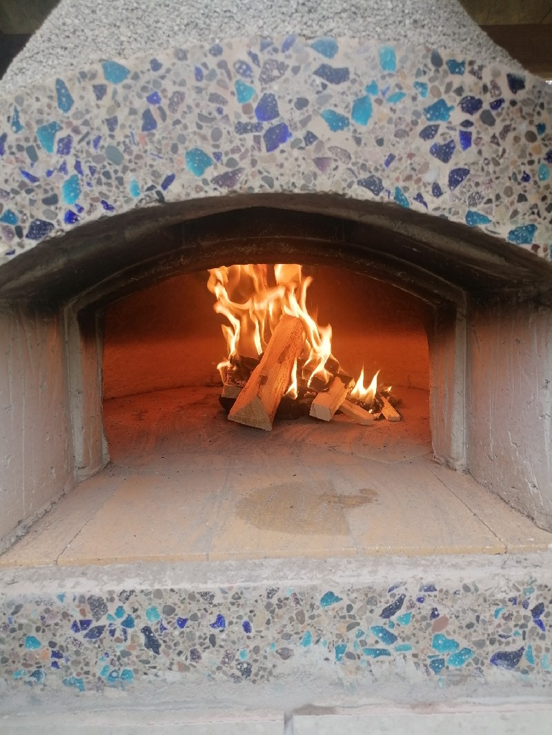

          First fire yesterday, 1 newspaper sheet, a firlighter, handful of beads and about 6-7 tinder sticks, big event, next door neigbours and family round think they expected more than a wee 5 minute flame, but internally the oven has no cracks and all good on the outer. My friend brought his super expensive structural engineering thermal imaging camera round and reckon it got to around 230-250 degrees celcius at the top of the dome. Flue worked well and happy, just gutted my pristine smooth round grey internal is now black and carbon
          Do most people use a normal thermometer when cooking or is it OK to presume once it clears at the top from smoke your ready to cook?
          Also with doors, has anyone had any issues or pointers, I'm thinking a cement board backer with a moulded homebrew mix secured to it and some fire rope on the lip to ensure good contact and insulation?
          Angain any advice greatly appreciated.
          Cheers
          Dave

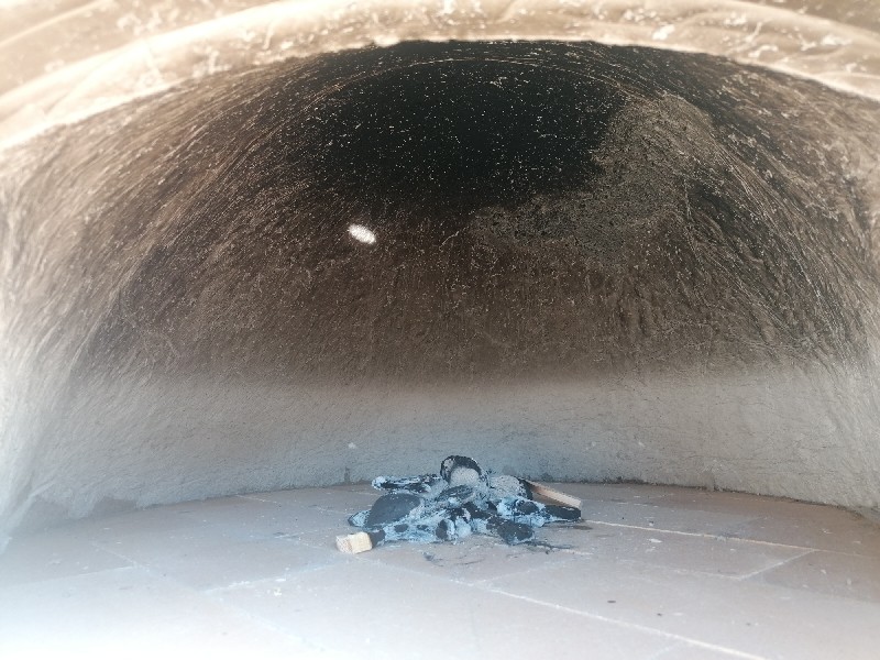

                    So 5th fire going well, small hairline cracks here and there but nothing major to report thankfully. In terms of fires can I ask everyone how people are setting up their fire? I've managed to get kiln dried oak for a few favours so going to try those, but in terms of setting the fire, are people doing the criss Cross method with kindling and then adding logs once the fire is going? And I take it the charcoal is only added for the curing fires or are people using it to get the fire going also when cooking pizza?
                    Any advice again greatly appreciated, cheers.

                    • #55
                      Two not-too-small logs parallel to each other on the entrance floor, crumpled paper and kindlings in between (a small fire starter here won't hurt either), then two small logs perpendicular to the first two on top of them, then another layer perpendicular again (like building a log cabin), the size of logs increasing. Build it as high as you can, push into the oven and, if you have room, add another layer of big logs on top, two or three. Fire, make sure it does not die down. Pretty simple. This is for only when your oven is cured, fast and hot.
                      • #56
                        Do a search for "top down fire". It is the only method I use (since I read about it here) as you can light it and walk away for a short time instead of having to stand by and feed the flames till it gets going. You will see some examples of really large top down stacks but I usually keep the pieces at the bottom around 2" round or square and progressively smaller on top.

                          Thanks sergetania and JRPizza, super informative and I'll get on that after the last curing fire. The 6th fire last night saw damp patches over the top of the dome and what I thought was smoke coming through, I thought the dome has cracked but turned out it was actually steam!
                          With regard to the door, I take it the door is only used to retain the heat of the oven once your finished cooking pizza?
                          Cheers again
                          ​​​​​​​Dave
                          • #58
                            If you you see steam, you are heating too hot too fast. David S suggest placing a piece of plastic over the oven dome and watch for condensation this indicates that there is still water in the dome.
                            • #59
                              Re door - you are right if you are thinking of high temp cooking like pizza, grilling, etc. However, cooking at lower temps requires a door whether you want to bake or slow roast a leg of lamb or a pork shoulder.
                              Just be careful - don't fully close the oven with live fire and then open it a few minutes later. It may backdraft.
                              • #60
                                Cheers UtahBeehiver ,ive reduced the heat and being a little more consistent, paying off as less and less condensation, no steam. Managed some cheese and toast, amazing to see the fruits of your labour. Cheers sergetania, making the door this week at some point.
