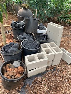

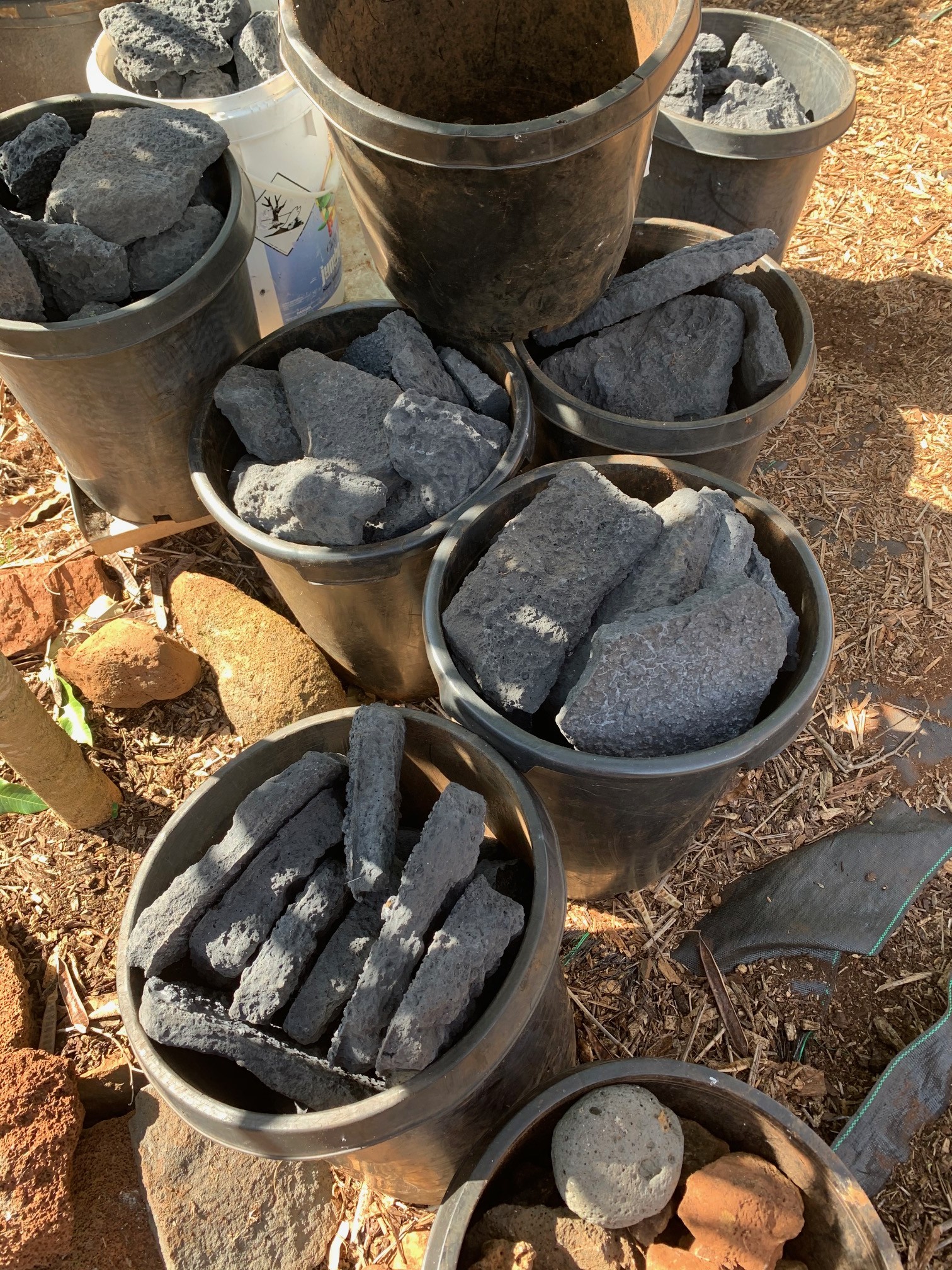

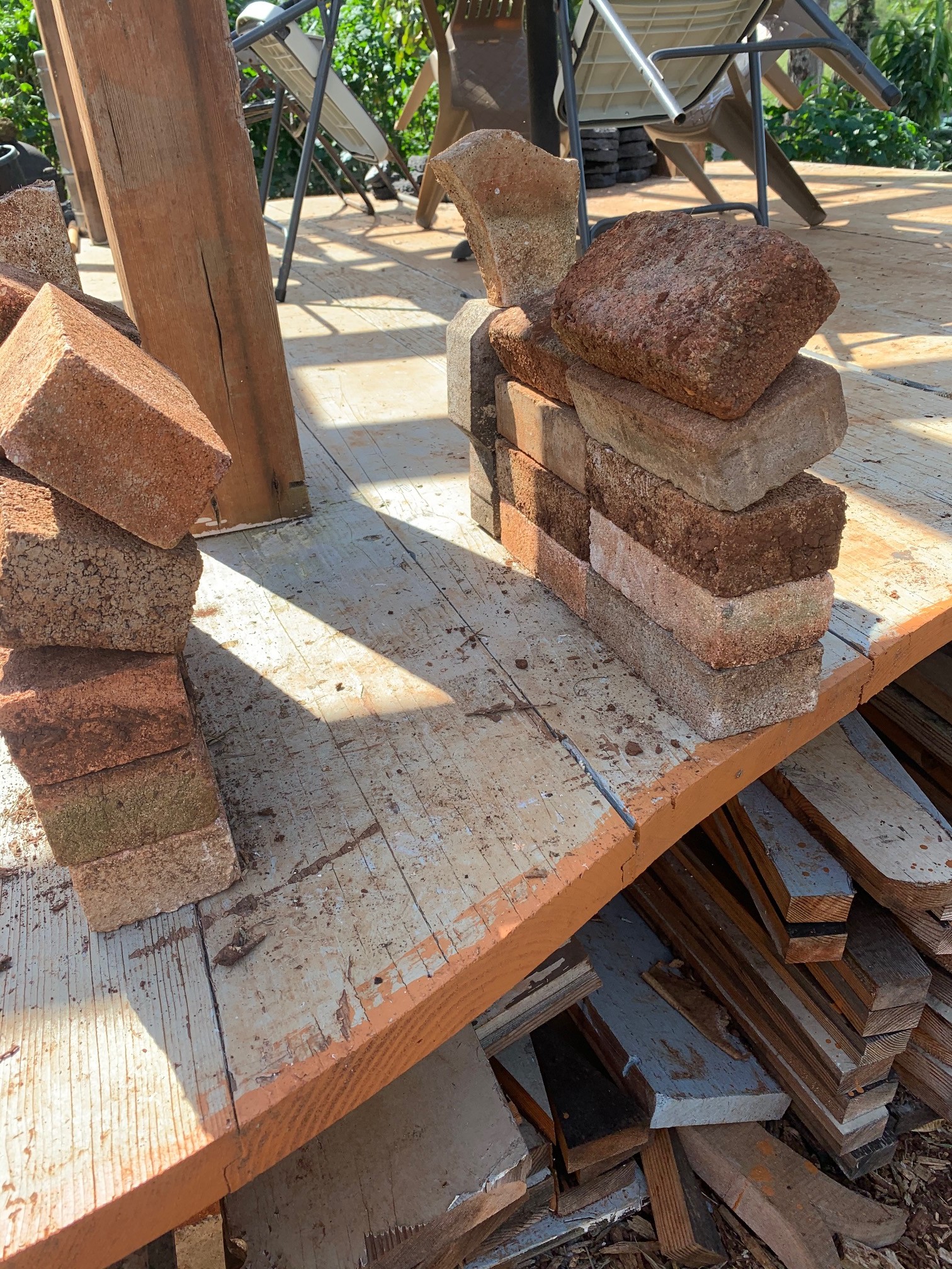

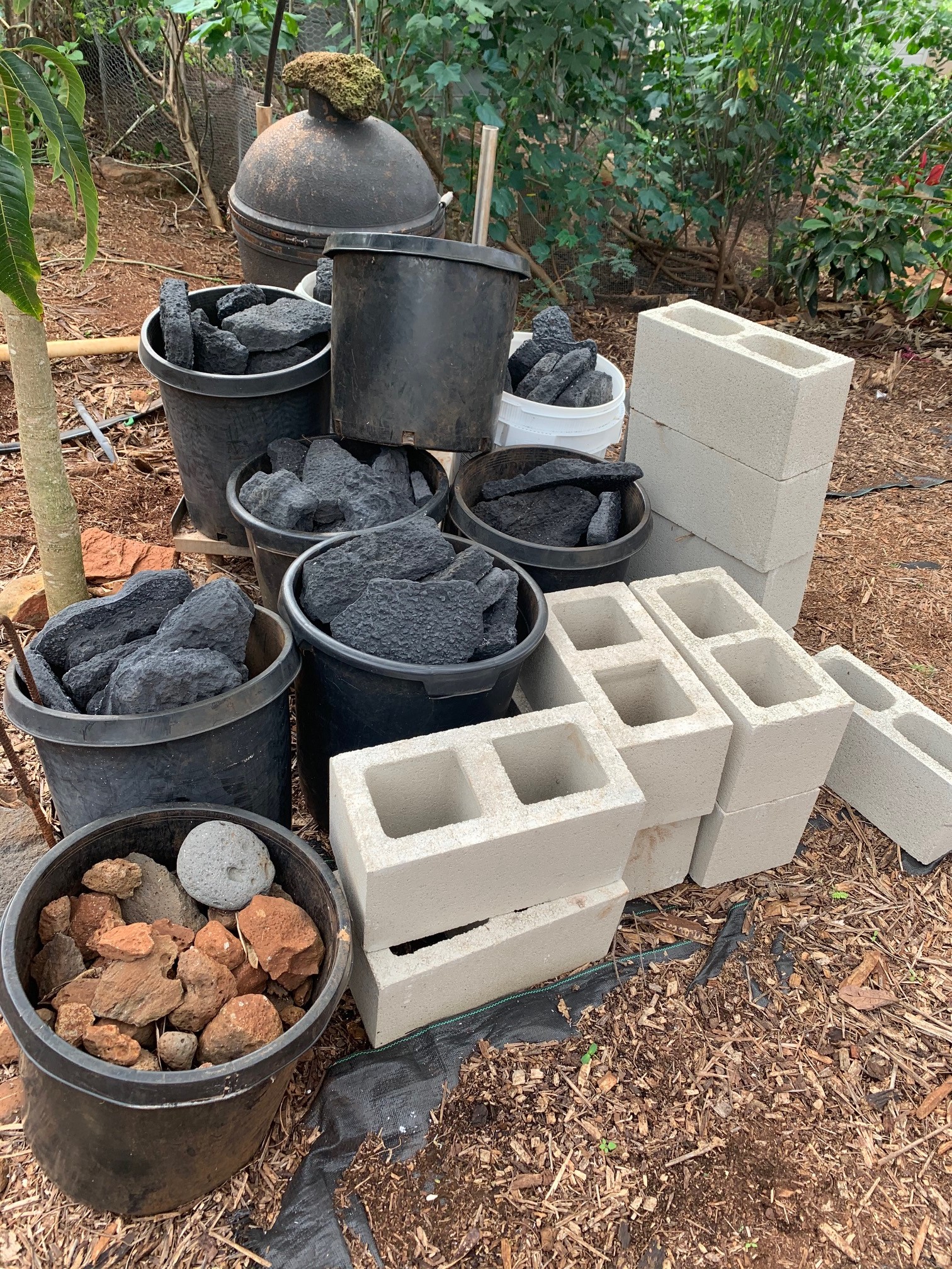

            Some of the building stuff I am getting ready Click image for larger version
ID:	434432 Click image for larger version
ID:	434433 Click image for larger version
ID:	434434 Click image for larger version

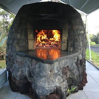

                this is a lava rock oven in Kona... I really like the finished look of this oven... we have a lot of lava rocks and in the pictures you can see we have a lot of faux lava rock pavers to cover the cmu base... I also have access to a bunch of free granite... so this is the look I am going for on the entire out door kitchen... very earthy looking... like we are cooking in a natural cave in the ground and used all lava rocks to build the kitchen....

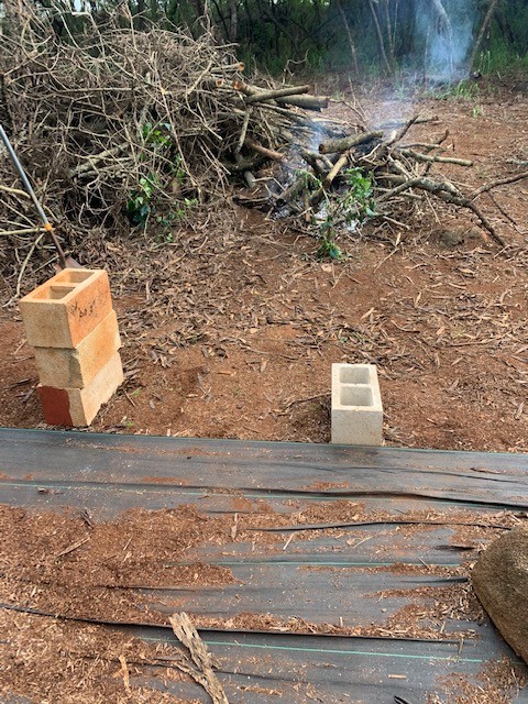

                  But for now, and until the rain stops this is my very humble beginnings... Click image for larger version
                  My build:: https://community.fornobravo.com/for...nch-wfo-hawaii

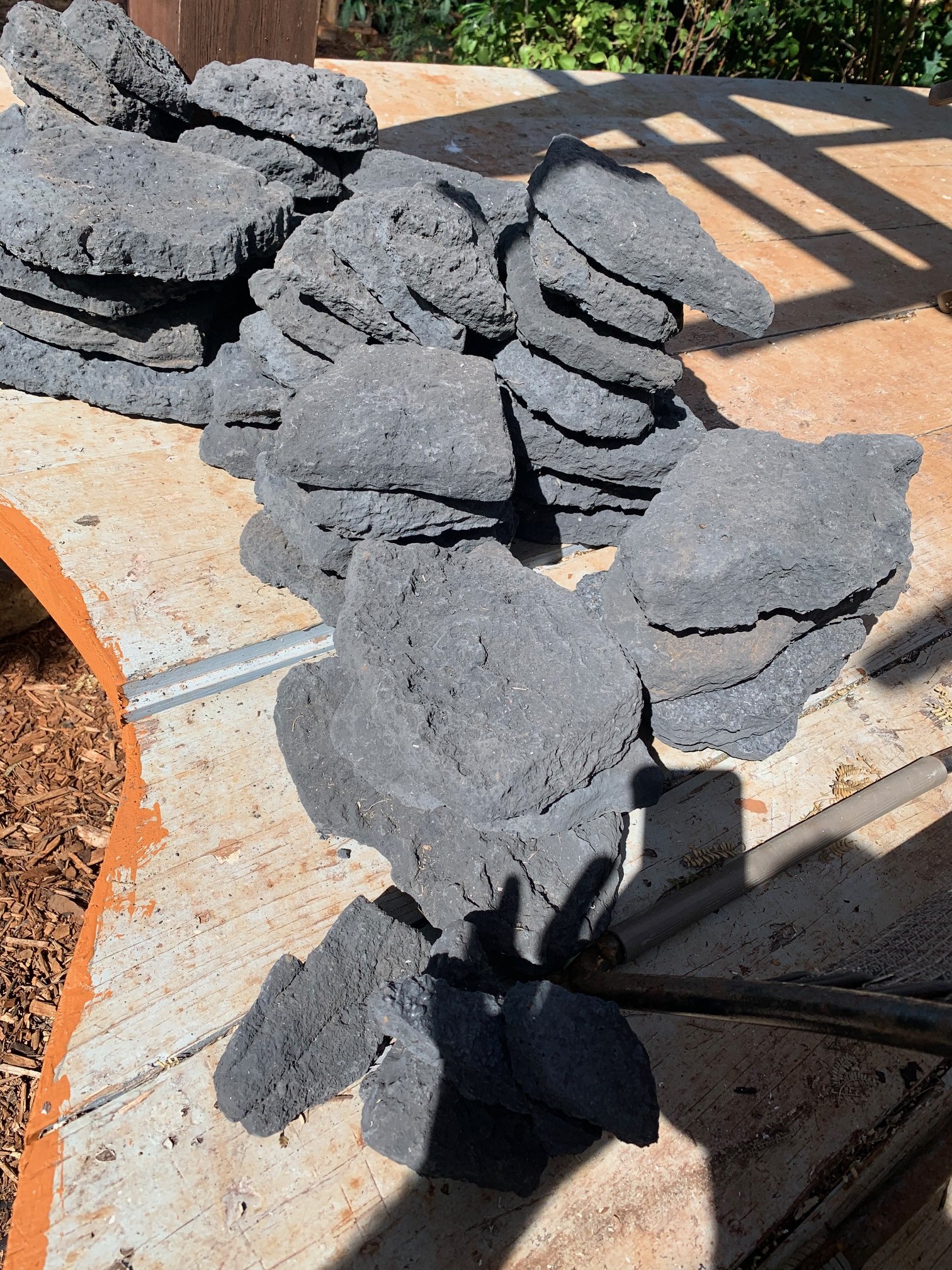

                              ​ Today stopped raining enough to burn the huge rubbish pile of halekoa trees behind the build site, as well as collect more lava rock, start laying out the cmu footers, and even made my scribe tool and marked out a piece of plywood with the layout... so in the end settling on a 33 1/2 inch radius... gives me an oven height of 16 3/4 inch ... it good to see the layout.. it should be just enough room for us... I snapped a few pics before dark... just need to adjust the rear footers deeper down.. then should be ready to form up the table.. a long way to go but making ​ ​ progress and Plastered mailed out the CalSil blocks...
