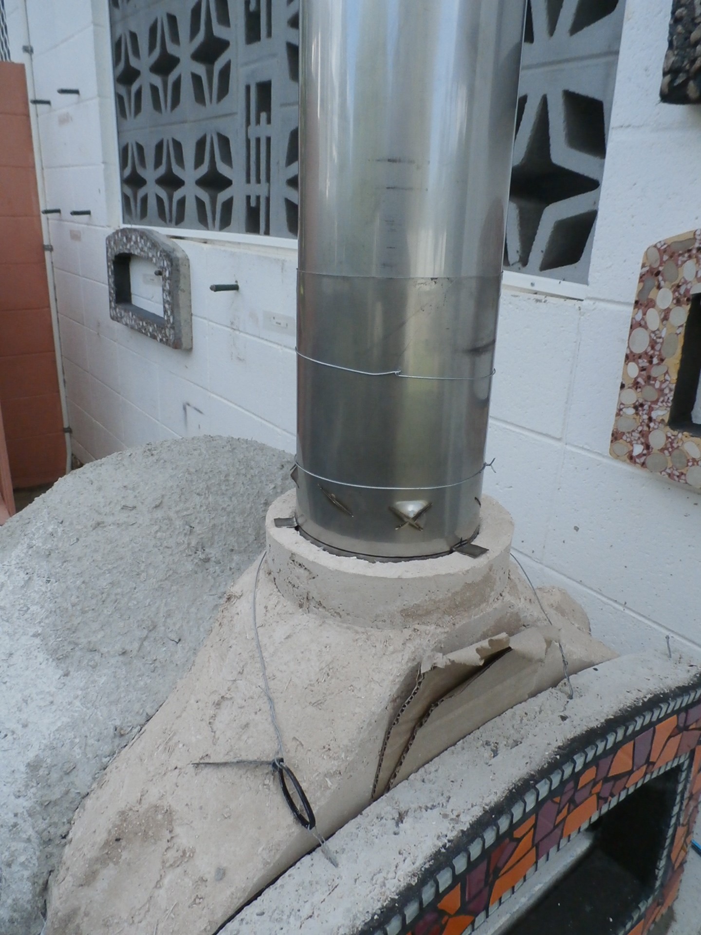

                  • #69
                    I' ve built a few ovens with removable flues and have successfully made sleeves for the pipe to insert into. You could cut some tabs in your pipe similar to the ones I cut in the sleeve. Click image for larger version
                    • #70
                      No problem to ream it out. Now it fits just fine, and hopefully it's enough room for heat expansion. It feels like the heels is strong enough to hold the flue. It's pretty light.
                      David, my plan was to cut some tabs but I figured it needed more support if it's windy. So I made the chimney a bit taller for more support and made the heels. Hopefully it will work.
