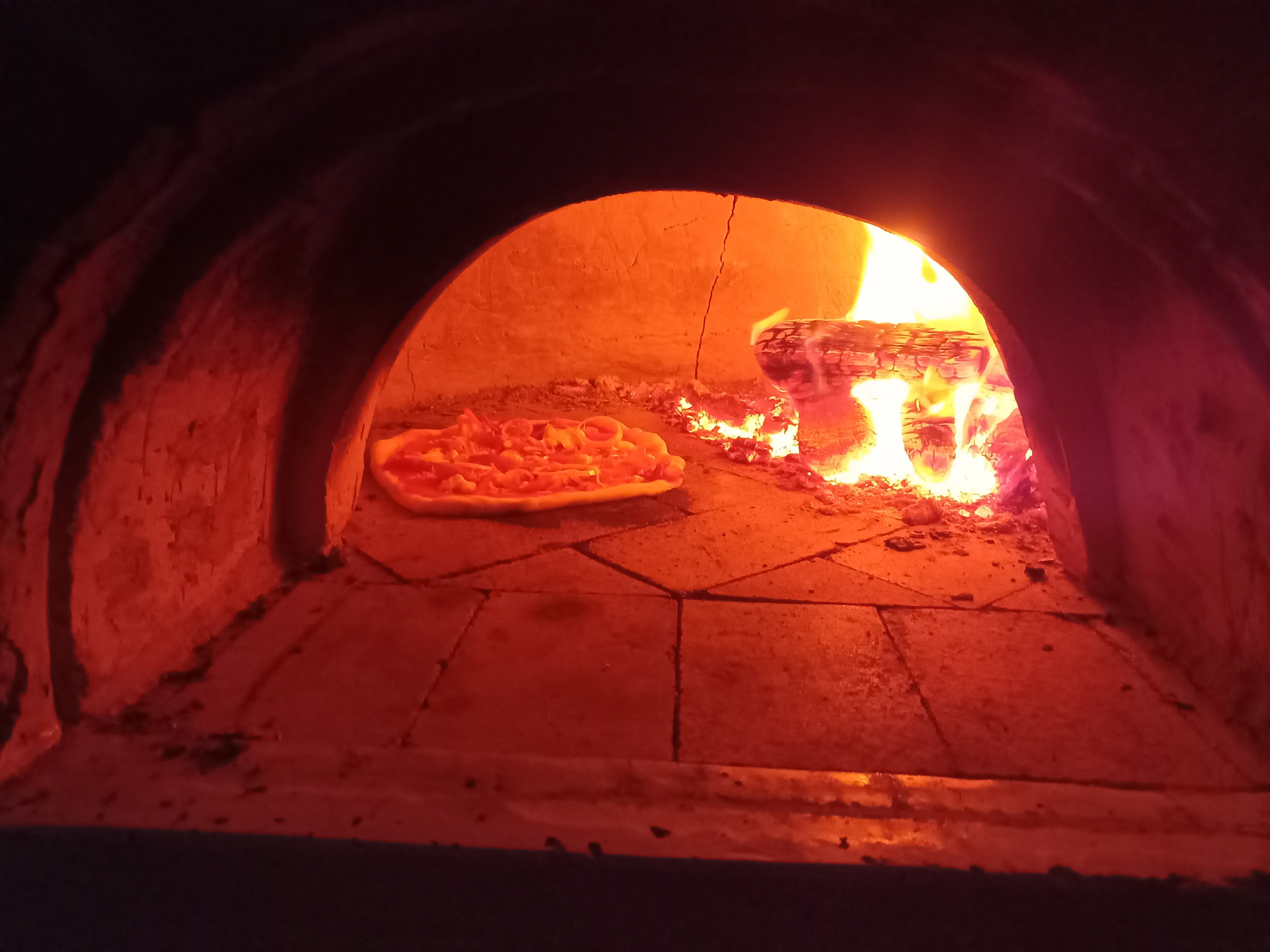

      Your oven looks huuuuge compared to mine ... and no cracks!
      Any idea how long it took to heat it up?

      • Thanks,
        it took only 30 minutes for the dome to start clearing. I think it's because the oven was still at 200F from the firing the day before.
        It was clear except for a small ring at the bottom after about an hour.
        i started it 2 hrs before our friends arrived, so it was nice and evenly heated.
        At the moment i only have a piece of steel as the door, no insulation. The next morning the oven was still at 350 -400F, around noon it was at 280-300F, and after 24 he's it was a bit above 200F.

        • BTW, the pizza you see in the photo is tiny, probably 5-6 inches.

          • As far as cracks, i think I may have a hairline crack around the bottom of the dome, but not sure, so I'm not really worried about it. In some places I thought I had small cracks but I think it's just the uneven walls from casting the homebrew.
            So far so good, I'll have to keep my fingers crossed it stays that way.

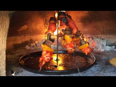

                    • I would use the biggest one that will fit through the door.
                      you might like a kebab cooker
                      or a chicken cooker….
