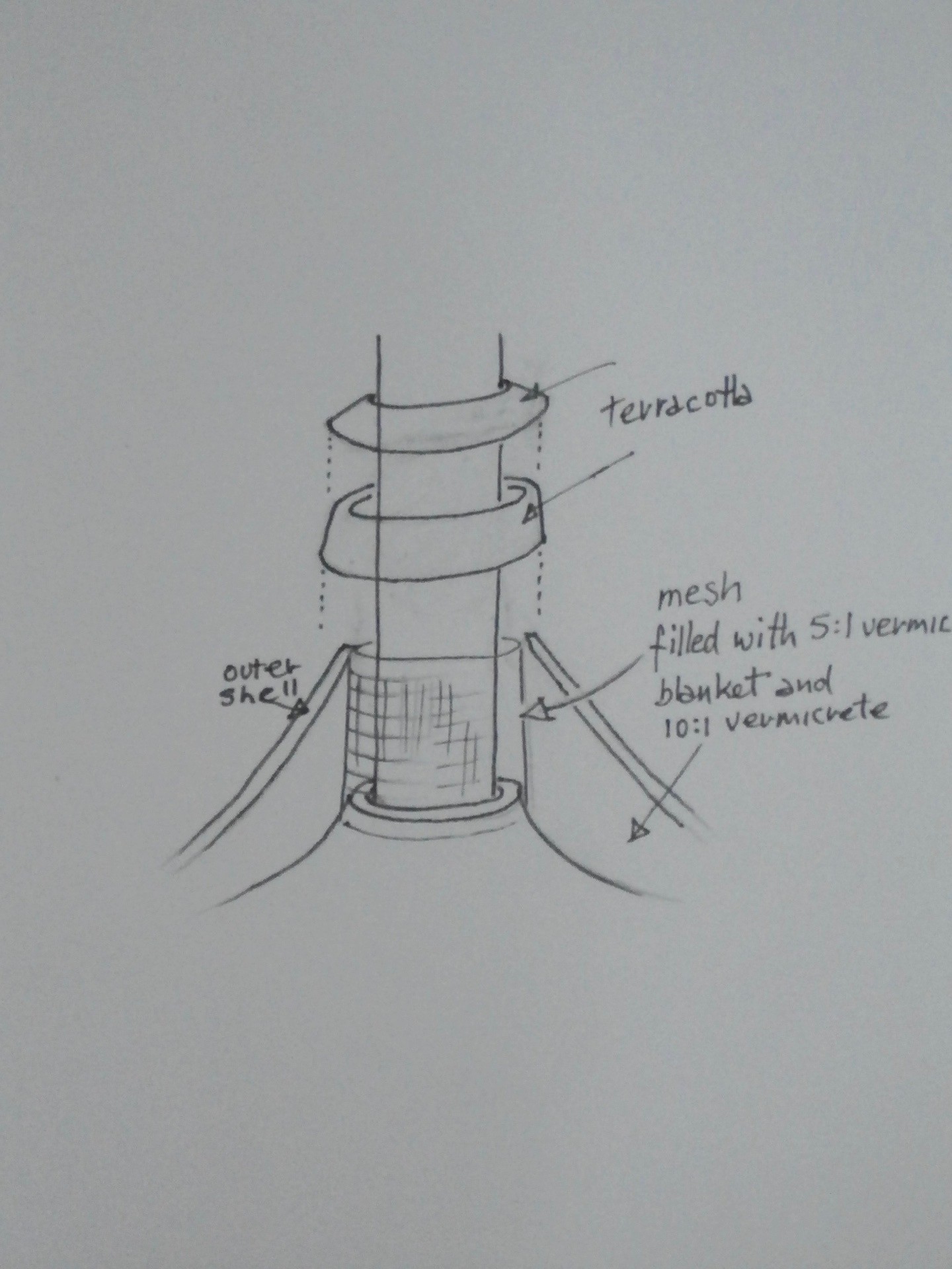

                        • Question on the stucco around the chimney
                          I am thinking of only putting stucco on the vertical walls around the chimney, leaving the top (right around the pipe) uncovered. Then sliding the collar down and sealing the collar around the pipe.
                          This way any moisture that finds it way through the stucco (I will use a sealer on top of the stucco) has another path to escape (other than the center breather vent).
                          I am a bit worried about being able to seal the flashing to the chimney. I only have a double walled, uninsulated chimney, and especially when I start the fire and the flames are big, it get quite hot.
                          Any thoughts? I think I have seen something similar in one of David's responses or threads, but I can't find it anymore.
                          My oven build thread https://community.fornobravo.com/for...y-32-cast-oven

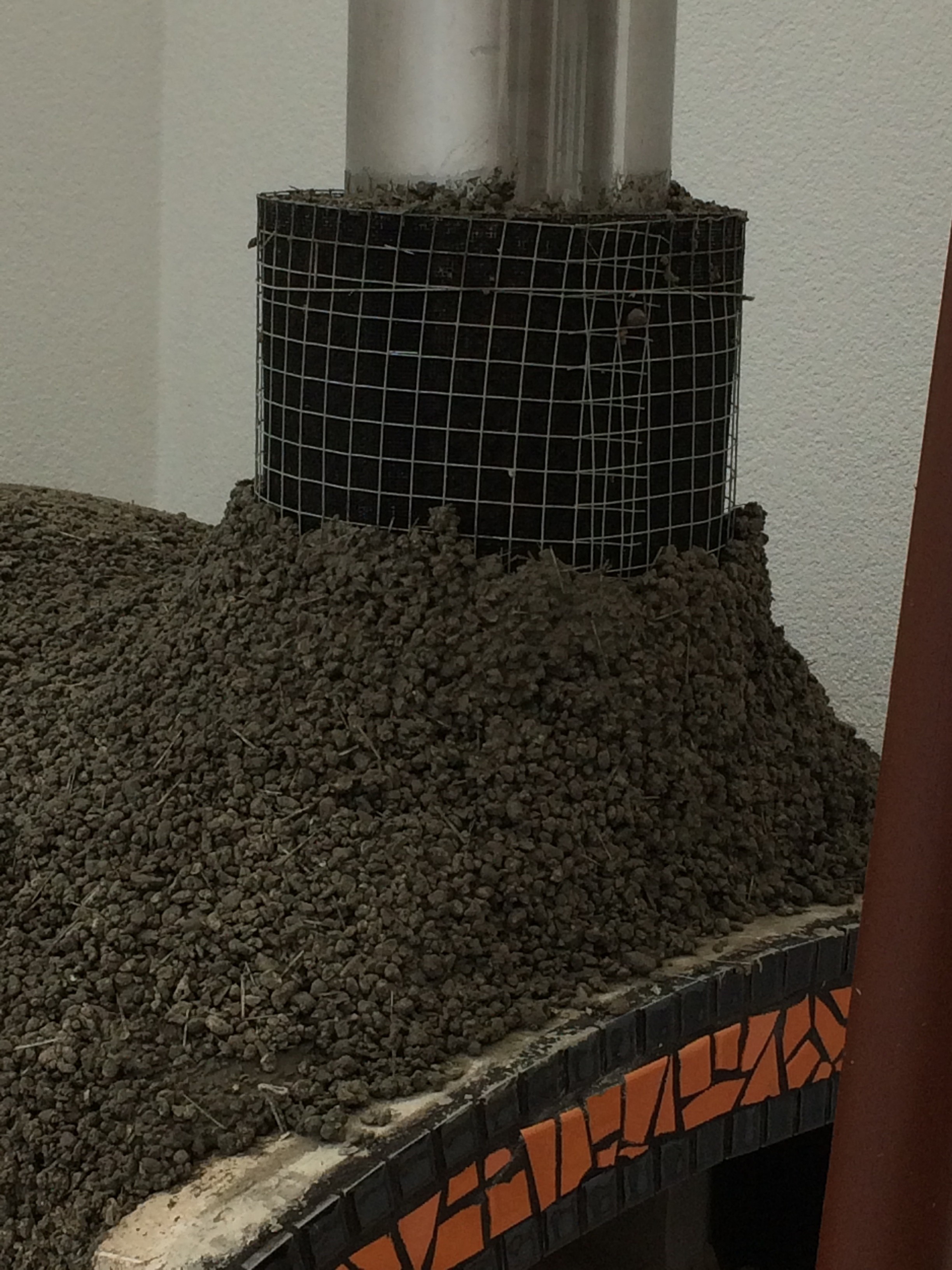

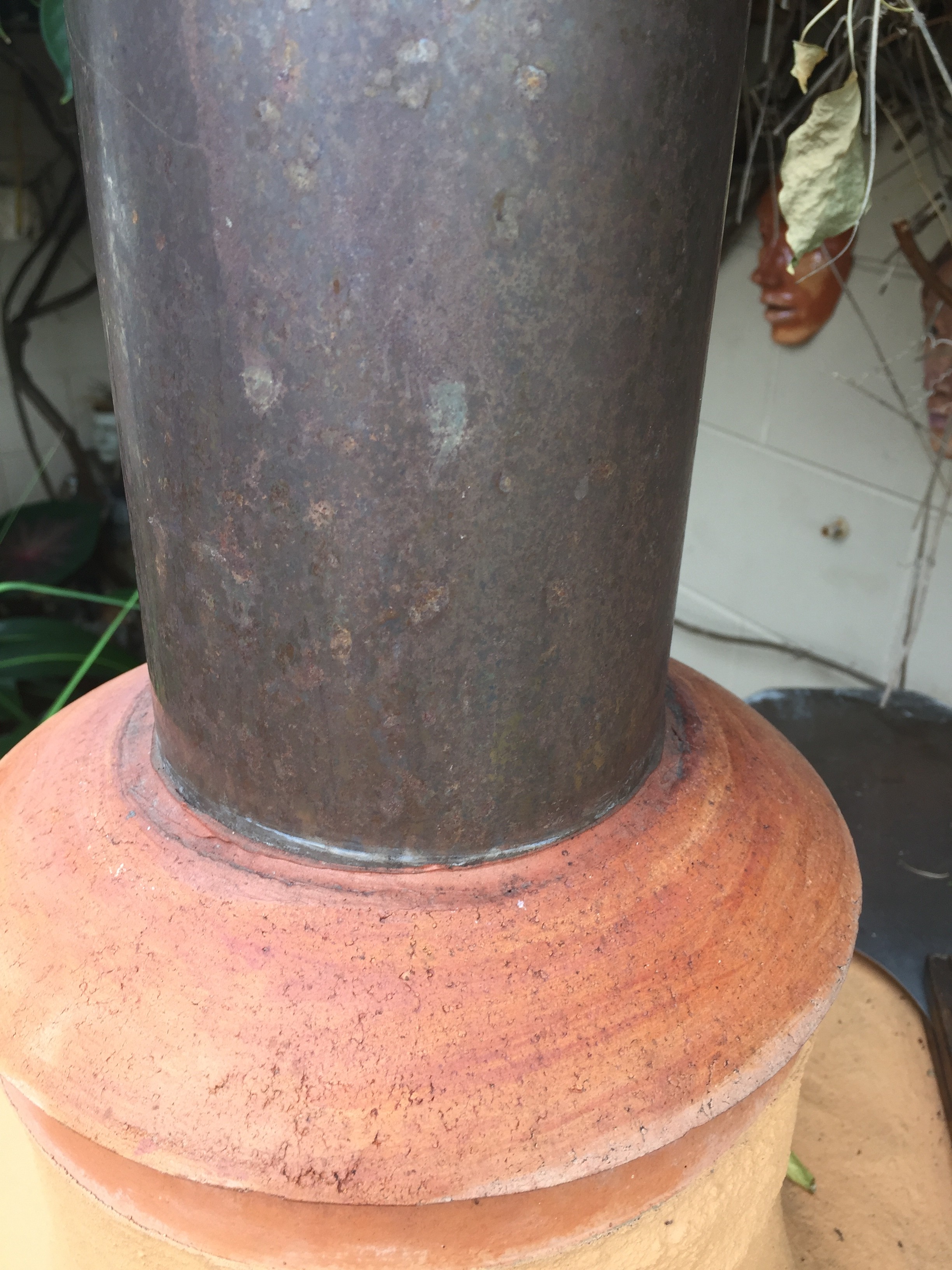

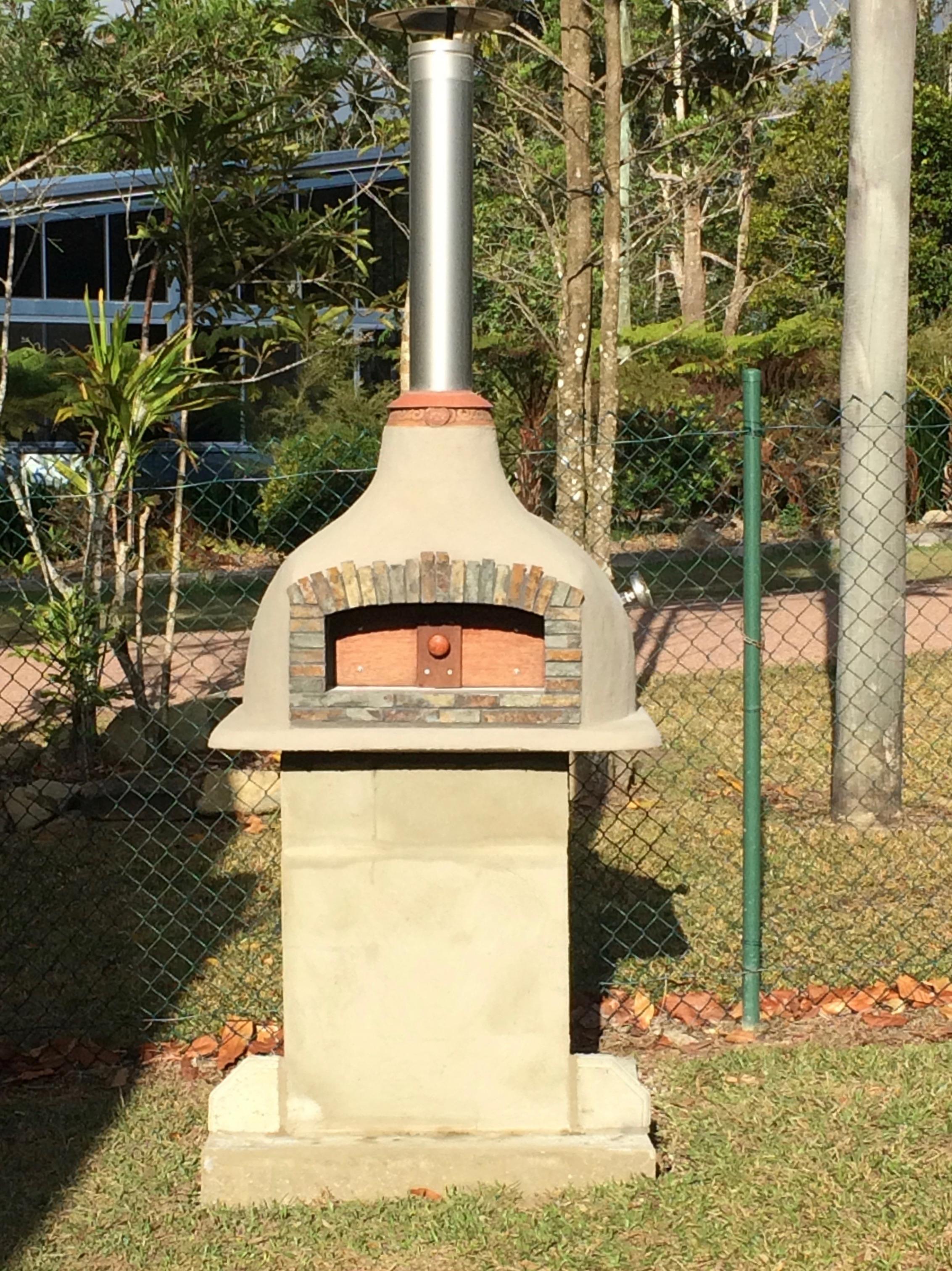

                          • I use a similar system so moisture in the insulating layers can find its way around the flue pipe. The attached pic tells the story. The moisture finds its way out between the two terra cotta collars, the lower one having a larger inner diameter than the top one. I seal the top collar to the pipe with high temp silicone.
                            Be careful of rendering directly against the pipe or its expansion will crack the render (seen lots of that). if you wrap the pipe with some cardboard around 5mm thick, render up to it, then remove it when the render has set, the space can be filled with high temperature silicone, provided it is high enough not to be affected by flame up the pipe.

                            • David,
                              Thanks so much, that was what I remembered seeing.
                              I assume you fabricate the terracotta parts yourself?
                              Does the upper terracotta collar sit right up against the vent pipe or are you also using high temp silicone for that part? I assume silicone?
                              Thanks again for your help.
                              • Click image for larger version

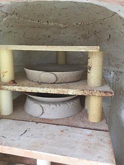

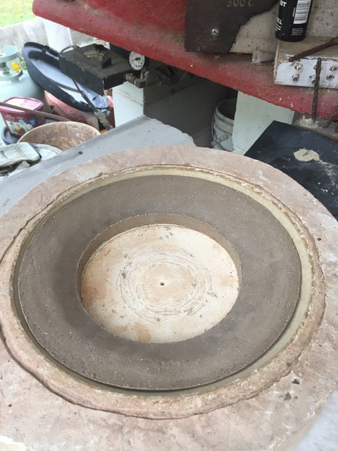

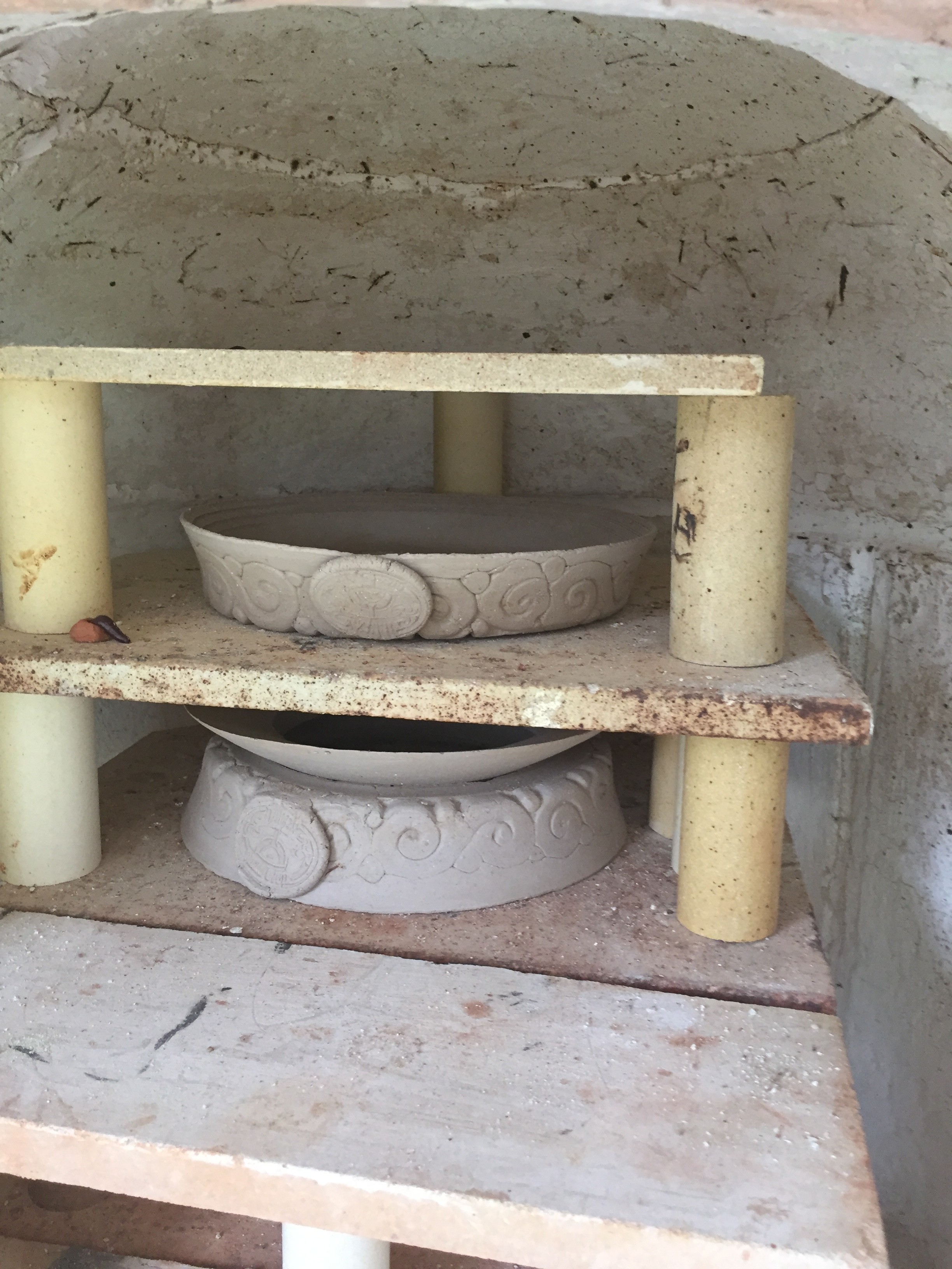

ID:	443704 Yes I make them myself using a press moulding technique and firing them to 1150C in the Intergalactic Explorer see here.
                                https://community.fornobravo.com/for...kiln#post14564
                                The top collar is sealed to the stainless pipe with high temp silicone.
                                Click image for larger version  Name:	IMG_1980.jpg Views:	0 Size:	1.34 MB ID:	443702 Click image for larger version  Name:	IMG_1981.jpg Views:	0 Size:	1.39 MB ID:	443703
