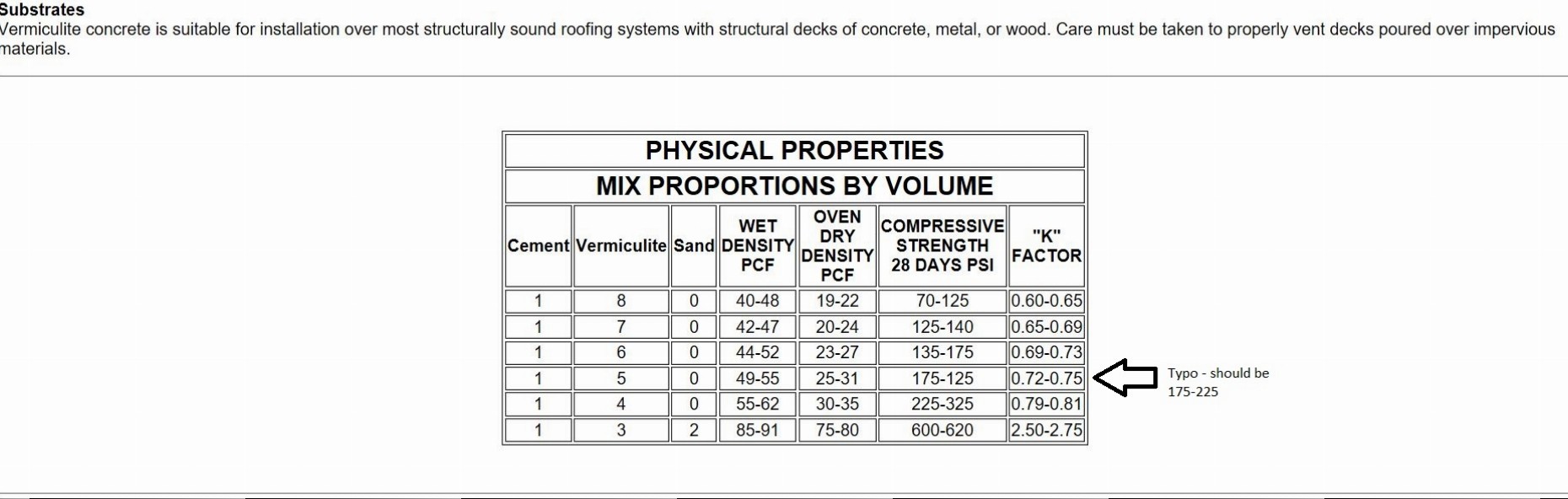

    This will affect the performance of the oven. If you are spending the time and money to build a WFO do it correctly. It won't be "some" BTUs it could be significant. But I will let others chime in. We iterate often on the blog that the oven dome and floor need to be isolated from the concrete hearth. A possible option would be to pour a 5 to 1 p/vcrete ring around the base of the dome to insulate from the hearth.

              5:1 is ok, 10: is not.

                I may go 4:1 for added strength. And the mix is straight Portland cement with perlite/vermicrete, or what else in the mix?
                  #53
                  The more cement you add, the less insulating the casting will be. (see attached table for explanation).
                  Adding a little (a handful for every litre of cement in the mix) powdered clay helps to get the cement to cover the grains. But this is usually only required for a lean (10:1) brew. Too much water will wash the cement off the grains so adding the correct amount is vital. add water and mix gently in a barrow (not a mixer) until the water pools a little in the bottom of the barrow.Allow plenty of time for it to dry out before building over it. (See attached experiment)
