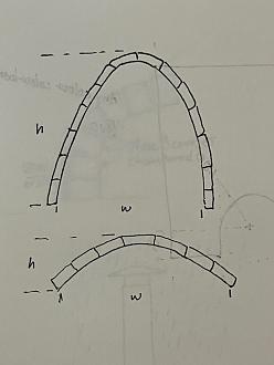

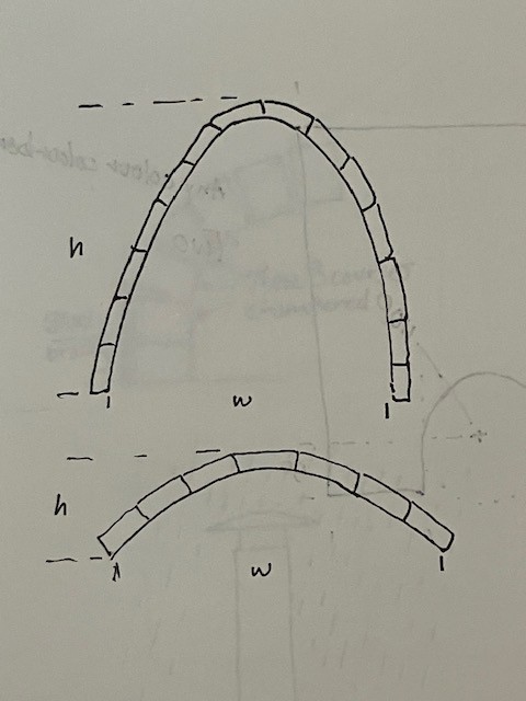

            Catenary arches (the arc described by a hanging chain and then inverted) are the most structurally sound arches, so much so that they do not require bracing or buttressing. Unfortunately they are not suitable for ovens because once the height becomes less than the width, the angle at the base creates an angle producing unusable space.(see attached drawing)
            I actually love catenary arches, see my structure starting here. (Jump to #32 to get to the catenary part)

              Thanks again, as always, for your depth of responses. That's an interesting point that cast ovens might heat up faster do to lower density than brick. I could see that going both ways actually: less thermal mass is literally fewer molecules to heat up, so that would go faster, but lower density would have less efficient heat convection through the wall before achieving equilibrium, so that would go slower -- but if you say the tradeoff tilts in favor of the less dense material, I understand your point.
              I was not one of those under the impression that small ovens heat up faster. It made perfect sense to me that the relationship between the thermal mass you are trying to heat up and the size of the heat source you can build to heat it up operate in tandem. But thanks for restating it. I get it.
              Okay, so the reason cast ovens can withstand thinner walls isn't that they contain the catenary within their arch (as, surely, they don't!) but because the weakness of a brick dome is at the gaps between the bricks. A cast dome is, to some extent, one gigantic brick (or a very small number of giant bricks merged along a few long expansion joints between sections). I guess I understand that. It's disappointing that this is as strike against thin brick ovens, but I see what you are describing.
              Not that I think the following idea could be achieved with a conventional tile saw, but I wonder if one could cut bricks with a tongue-and-groove shape so that each course "locks" to the course below it, such that the gap between them can't so easily "fold" outwards with a resulting buckling and collapse. A square tongue-and-groove would be very hard to cut. The tongue would be feasible (four simple cuts), as would be the two sides of the groove, but the final cut along the bottom of the groove would be nearly impossible to achieve. One could approximate a tongue-and-groove by cutting V-shaped tongues and grooves instead of squares (so that one edge is V shaped and the other A shaped). It wouldn't have the angular resistance to buckling of a square tongue-and-groove, but it would be much better then the flat-faced join of simply mortaring bricks together course over course. Anyway, that's kinda crazy, but it's an idea that crossed my mind.
              I agree with you on the elegance of catenaries. I've always been fascinated by arches. Romans discovered hemispheres, which are pretty self-supporting especially when loaded from above, such as when incorporated into a wall, but my other ancient culture of fascination, the Mayans, never discovered self-support arches. The best the Mayans came up with is a corbeled arch (https://en.wikipedia.org/wiki/Labna). So I'm pretty aware of both the theory and the history of arches. And yes, I recognize that unfortunately, the thermodynamic properties of ovens and baking are in conflict with the purest catenary arch forms.
              Anyway, I'll consider my options.
              Why is this less problematic with segmental entry arches? Lots of ovens are designed with barely-curved arches that land on vertical walls at the sides. Why isn't the risk of such arches collapsing of much concern, especially with the flue pressing down on it? No one worries about this issue with entry arches and yet it is practically a prohibition on domes. What's the difference?
                "cast ovens might heat up faster do to lower density than brick." no, re-read my post, I said brick and refractory have the same thermal conductivity. The higher the conductivity the faster the heat up, as in stainless ovens. The density of any given material will lead to an increase of its thermal conductivity.
                Regarding the tongue and groove joints, which would be almost impossible to achieve between bricks cut with a saw, most cast ovens go with half lap joins at the junction between sections. In my builds I employ a tongue and groove join idown the middle in the two piece floor sections that leave only one join which has proved sufficient to provide for thermal expansion while only leaving one join to catch a peel on.
                The reason the outer arches are less problematic is because they are at a lower temperature being further away from the fire. I have seen enough cracked outer decorative arches to convince me that an expansion joint between the dome and gallery or gallery and dome is important to eliminate stresses from hotter expanding inner oven parts on to the cooler oven parts.

                  My question about outer arches wasn't about cracking, it was about dome collapse. You have emphasized that a shallow catenary pushes outward at the base of the dome (which would conceptually "slip out" and collapse). Why don't segmental entry arches have the exact same problem?
                    Originally posted by kebwi
                    Oh I see. I did misread it.
                    But, my frustration from above is unresolved. I felt that my perusal of the forums revealed people's experience with cast ovens as heating up in two hours, give or take. Mathematically, cast ovens should clear in literally 44% the time of brick ovens (2" vs. 4.5"). If brick ovens require 2-3 hours, cast ovens should be ready in 50-80 minutes. But my point is that I don't see reports like that in the forums. Did I miss the relevant messages and posts where builders of cast ovens actually did acknowledge that their 2" cast ovens were clear and hot in an hour?
                    Theoretically they do. The reason Roman arches remain stable is that they are buttressed at their sides by another arch or massive buttresses at the sides. Check out the Colleseum which has a collapsed arch at the back so the arch closest to the damage is no longer buttressed by an adjacent arch. Slowly a chain reaction takes place with the arches collapsing like dominos. There is now massive repair on the ends with reinforced concrete to support the ends. I think most oven arches get away without the buttressing or bracing because they are small, but there are reports of failing arches where extra weight of brick chimneys is placed on top of them. Regarding dome collapse, because the dome is three dimensional rather than an arch which is two dimensional there is far more support and the dome cannot therefore collapse. The outer arches of the gallery and outer decorative arch are far more vulnerable being two dimensional.
                    The temperature at the inner face will always be greater than that of the outer face and the thicker the walls the bigger the difference. Therefore thin walls will reach a heat saturation point faster than thick ones. Operators firing regimes will also vary considerably so comparisons on time taken to pizza temperature are difficult. Also other factors like ambient temperatures, quality and amount of insulation, moisture content in the oven and insulation layers as well as the moisture and type of wood used make comparisons even more difficult.
