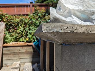

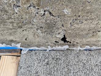

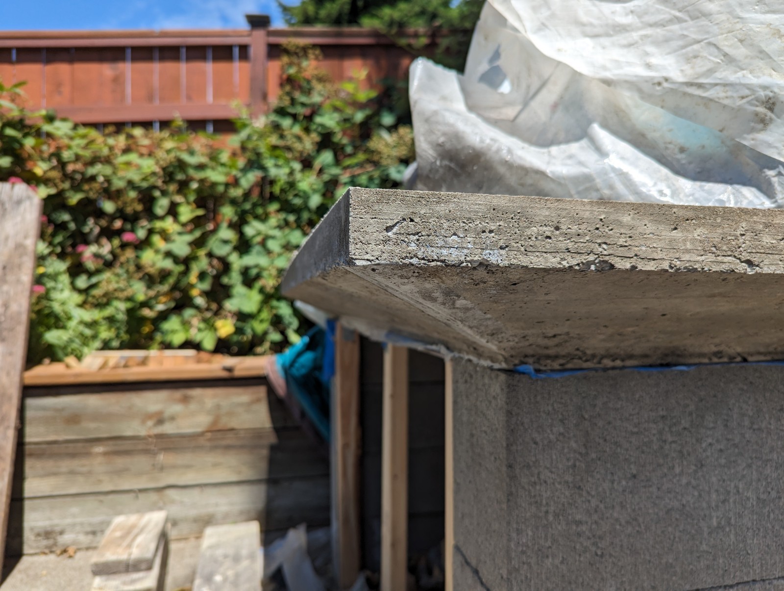

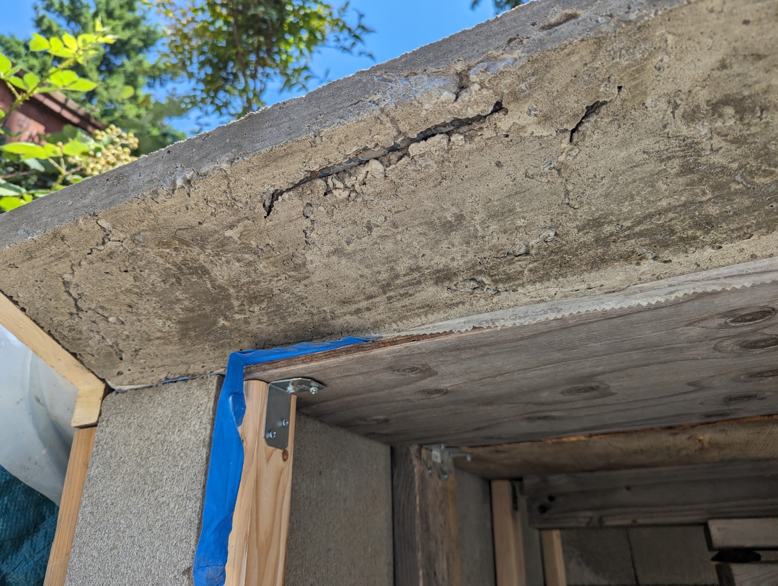

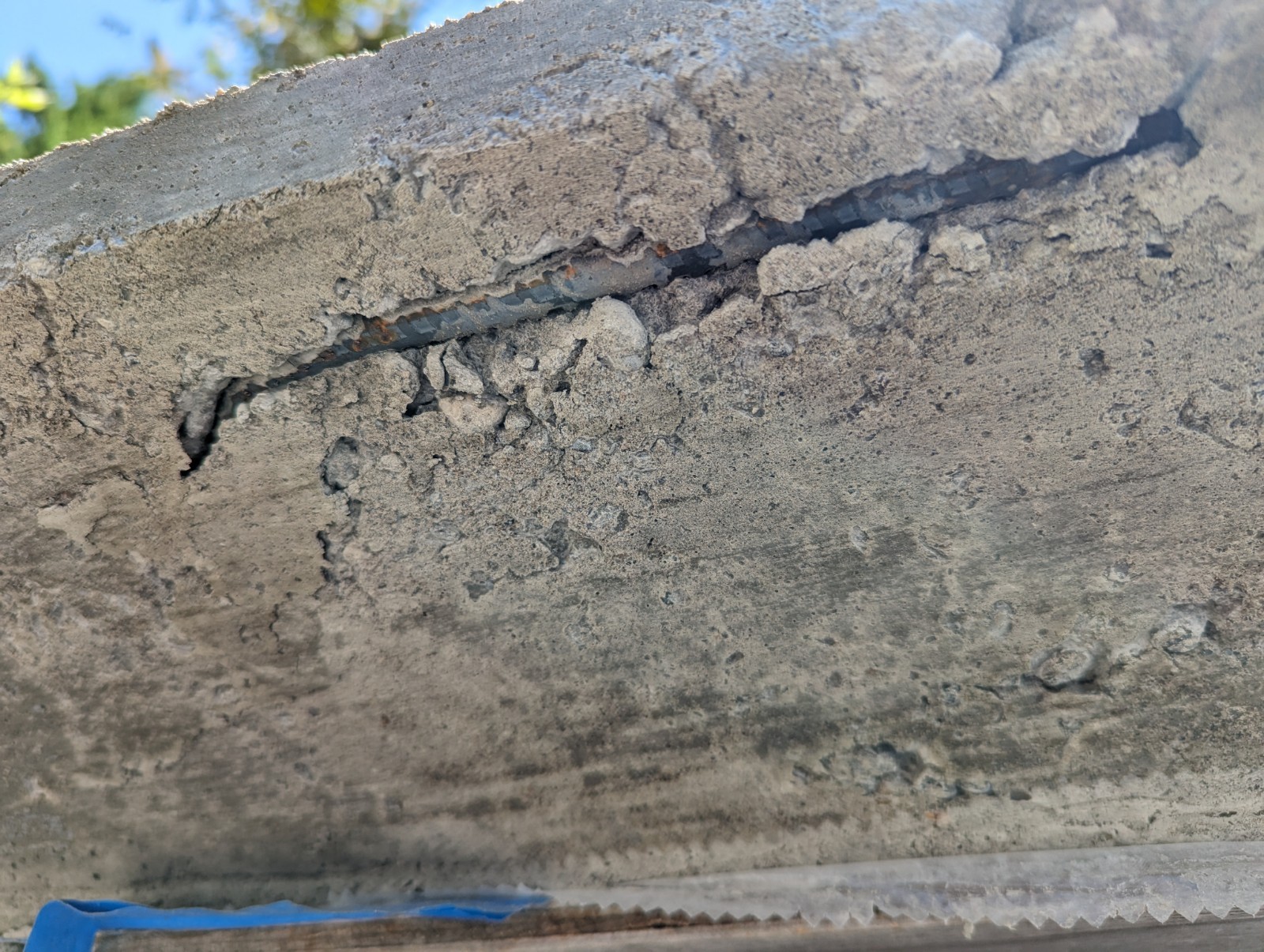

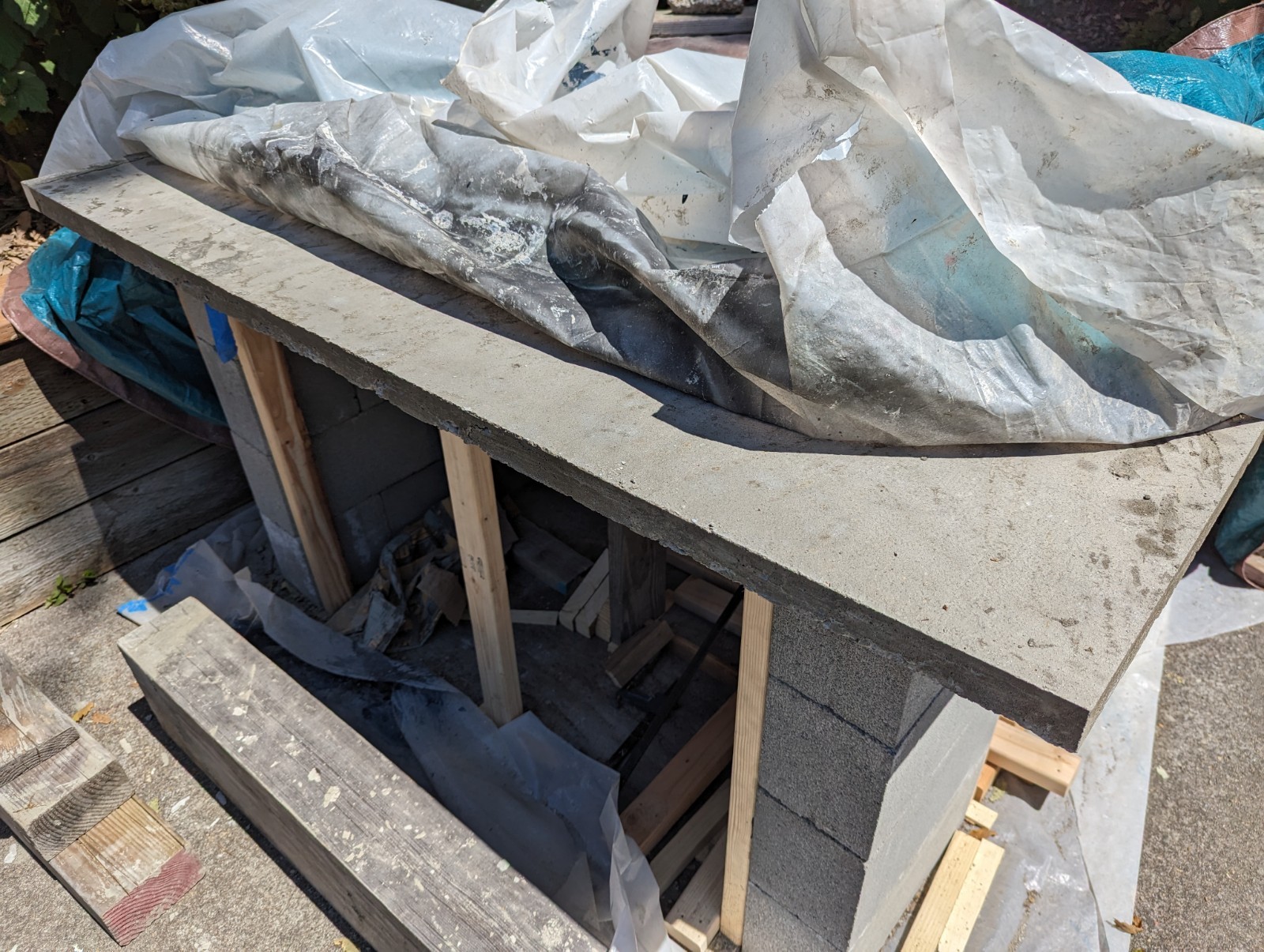

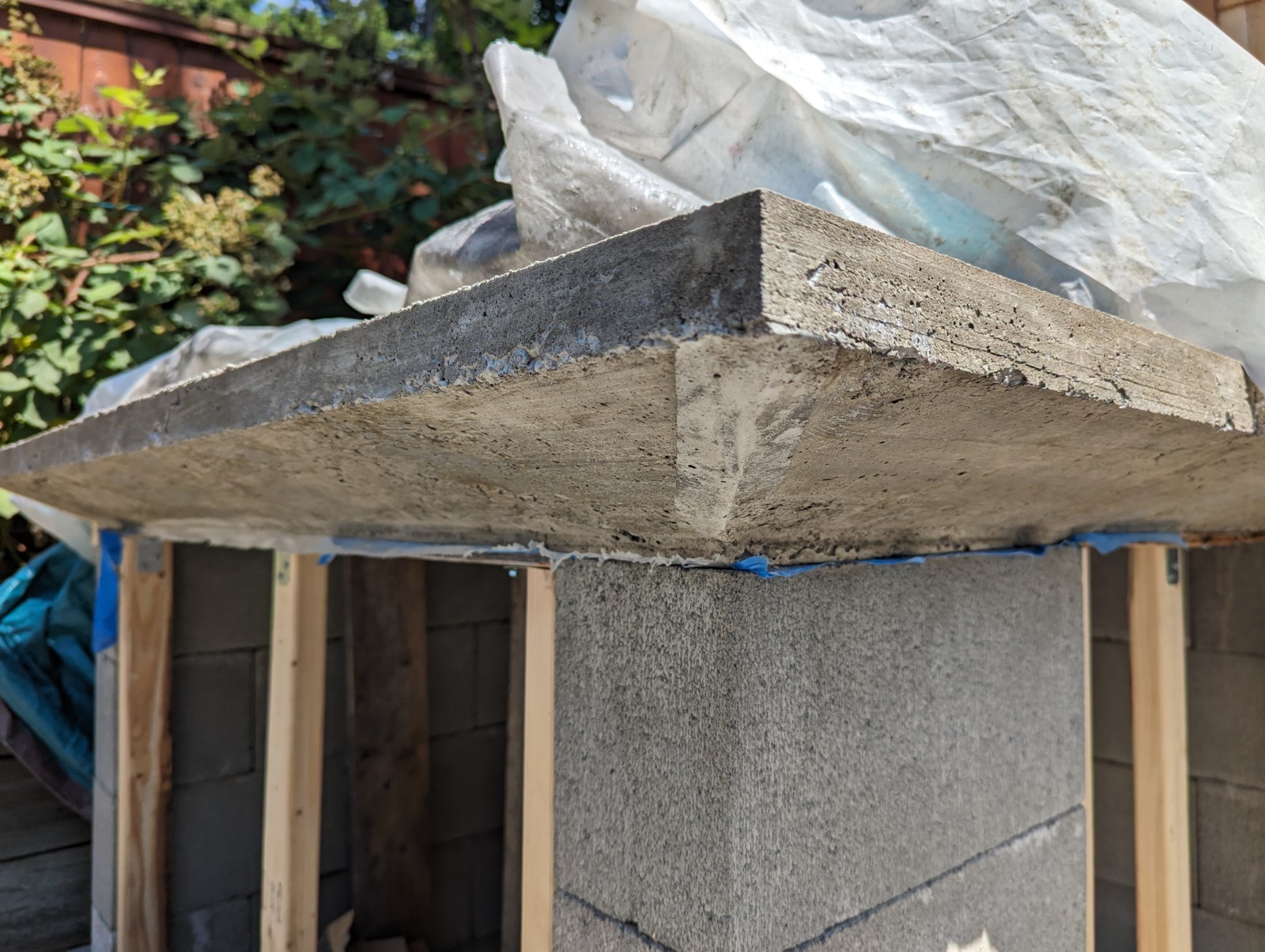

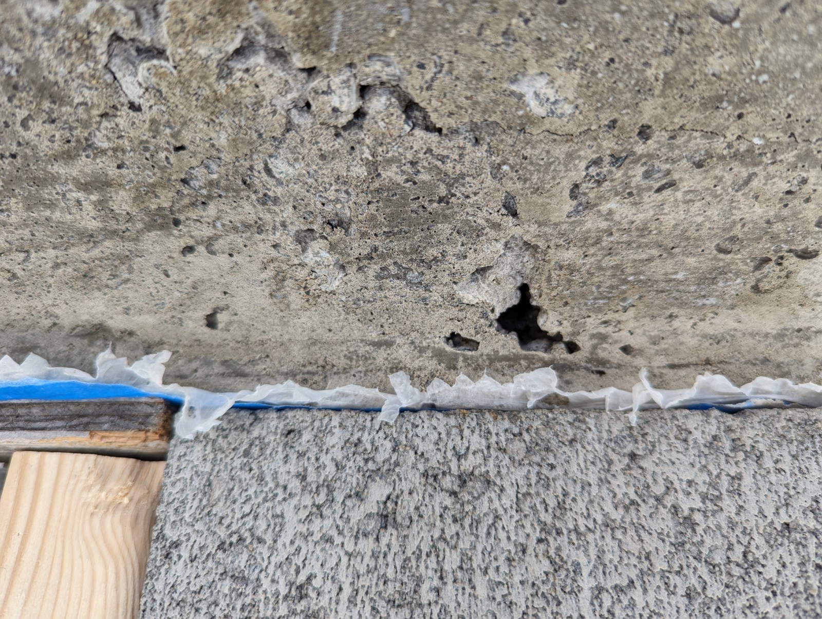

      Well, the good news is that the concrete didn't bond to the wood at all. The instant I released the screws holding the wood sections on, they simply fell away. The bad news is that despite my best efforts, I got some pretty bad air pockets in my concrete. The worst section runs along the underside of a piece of rebar where the concrete obviously never flowed. The rebar is actually exposed in that section, as you can see in a few photos. How do I best fill in or parge this? I don't want to buy a 100lb bag of portland cement to mix up a cup or two of parging mix. I guess I could buy an entire 60lb bag of concrete, sift out the larger aggregate, use a tiny amount of it, and essentially throw 55.9lbs of concrete away, since it only costs about $4 a bag. I mean, I could keep the leftover as long as possible for future use, but humidity will slowly cure and ruin the bag.

        You can buy vinyl concrete patch in small quantities. It's easy to work with and can fill voids up to 2" and can be feathered.
        You posted your rebar layout photos the same time as those from your finished pour so there wasn't an opportunity to comment. It's best to keep rebar about 3" from any surface of the finished slab. Not doing that increases the chance of the rebar rusting over time. Doing that may have also helped to prevent the voids you experienced.

            Voids are caused by the mix being too dry and or insufficient vibration. Too late now, you’ll just have to patch it up.
            • #96
              Yeah, I know. I think I mixed it pretty wet (mixing too dry is a mistake I've made in the past), but I didn't have a good vibration mechanism. You can see in a photo from an earlier post how I used a 4x6, end-on, to pound the concrete a bit, but it obviously was an imperfect process, given the results. I'll just fill the gaps in with some concrete with the larger aggregate filtered out. Hopefully it'll be okay.

                kebwi Sorry for the panic. Should have been more precise. Rebar 3" from all edge surfaces. 1.5" from the top and bottom of the slab. Lot's of guys do a 4" slab. You'll be fine.
                David is correct about too dry a mix and vibration. My limited experience tells me that vibration is the ticket. I did my slabs using delivered redi-mix and the consistency (slump) was perfect. I really worked the concrete into the forms and between the rebar. I used a reciprocating saw without blade to vibrate the forms and still ended up with some voids on the edge. I feel the only thing I could have done differently was to rent a submersible vibrating rod.

                  Thanks for all your input. Regarding concrete in general, yeah, it's trickier than it looks. :-D I filled the really bad sections yesterday. It looks better now. I'm sure it added nothing to the structural strength, but it should help the rebar from rusting and will fill the deep voids where plant roots and deep moss might otherwise take residence. That's good enough to get me through to next stages. I might seal the concrete to keep rain from soaking in too much.

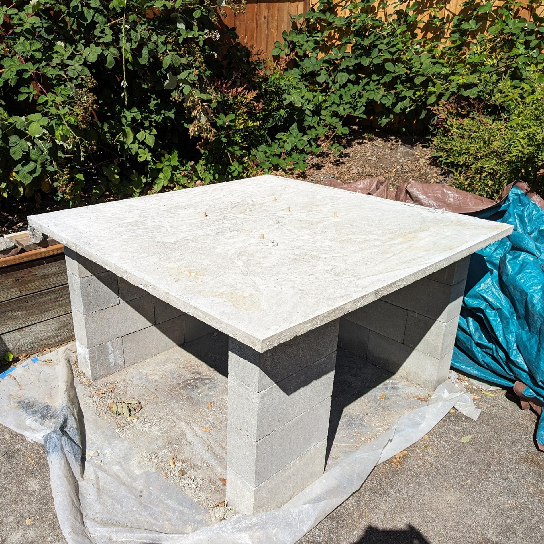

                    So I poured the hearth on Sunday and have mostly left it under a layer of plastic covered by a layer of tarp ever since. I folded the sides up a few times, briefly, to remove the side forms (I was worried the wood would bond to the concrete, but it didn't at all; the forms fell right off) and to do a little parging work on the worst voids, but have otherwise left it covered the entire time. So it has been curing under plastic about six and a half days. It has been very hot and very dry this entire time, so I'm glad I did that, but at this point, it has been nearly a week. I'm wondering if there is any practical value in leaving it covered for another week or two. Would uncovering it this weekend undermine the final cured strength in any realistic way? I realize that, chemically speaking, it will still be curing for many weeks, but does it make a real difference whether it is left under plastic to trap condensation underneath for several weeks, or is most of the first week sufficient?
                    Thanks!
                    • Slabs built on grade (sitting on the ground) only have the top surface to lose moisture if formwork is left in place, but suspended slabs will lose moisture from the top, sides and bottom, so keeping them completely sealed is prudent.When house slabs are laid they are rarely covered because it requires revisiting the site after the initial set because covering with plastic immediately is going to leave crease marks in the freshly finished surface. Therefore the slabs are usually just left, even in strong sun and windy conditions. This probably results in a mx strength of 30mpa which is an industry standard, but if you want max strength keep it covered for 28 days. The accompanying chart explains it.

                      • I took the forms off today.
