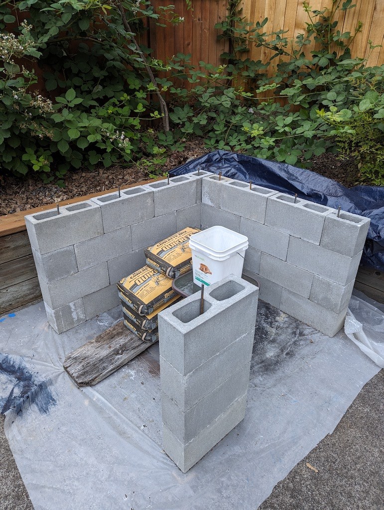

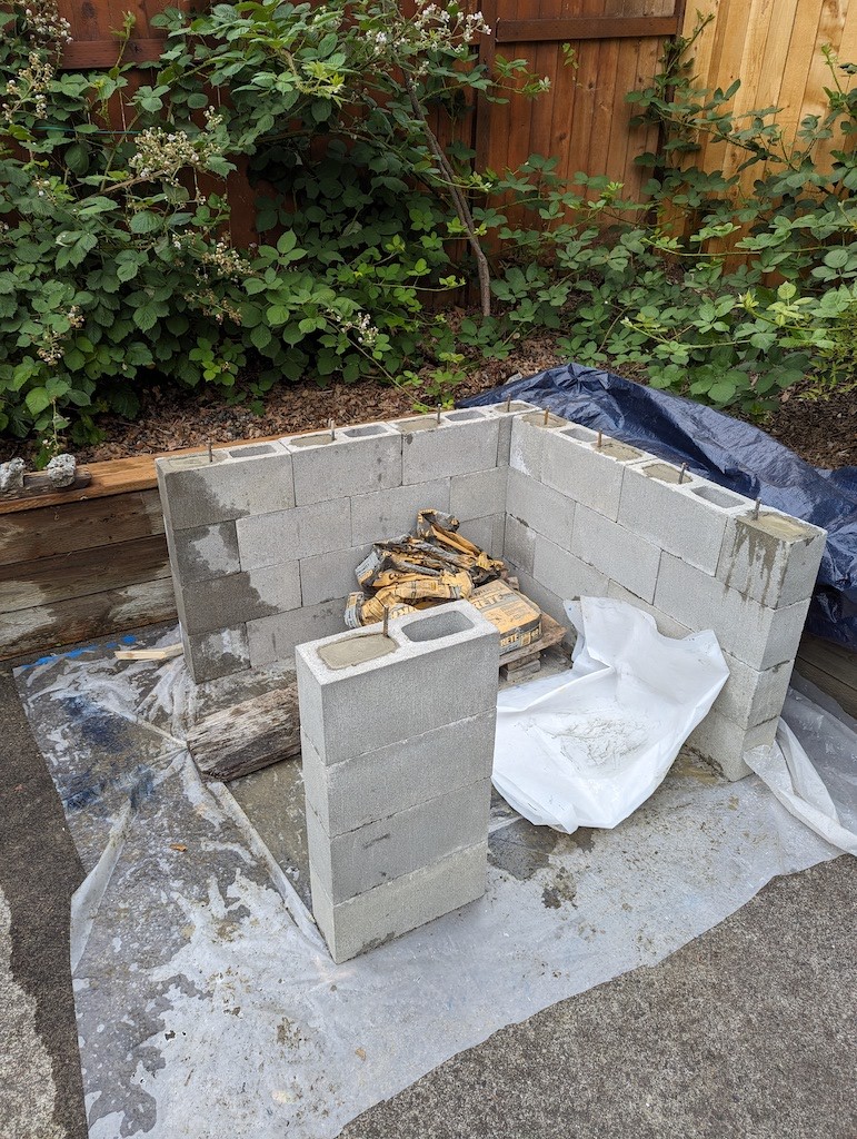

                        Well, I'm committed now. Once concrete gets poured, things become permanent really fast. After all my efforts to find or build a metal cart or frame, possibly with casters, that would facilitate either local relocation around the patio or distant relocation to a new site, and after considering timber framing to at least assist with eventual demolition (much easier to deconstruct that rebar-concrete), I just plain gave up and went with a concrete design instead. I'm not thrilled about the decision but I couldn't figure out another way to make it work.
                        As you can see, I placed plastic on the patio under the blocks before stacking and filling the cores so they won't bond to (or even mess up) the patio (I'll cut all the plastic away at the end, leaving only the footprint under the walls, separating the walls from the patio). The two long walls aren't interlocked or in other way bonded to one another at the corner, which might vaguely assist demolition someday, but ultimately, this structure is going to be pretty stuck for a long time now. Obviously, it would have been stronger to interlock them at the corner, and even stronger to fill the corner core interlocked, but I am trying to make this thing somewhat deconstructable someday. The hearth, with the rebar pins shown, should provide protection against sheering failures in either direction. I suppose I could put some corner braces on it if I feel like it.

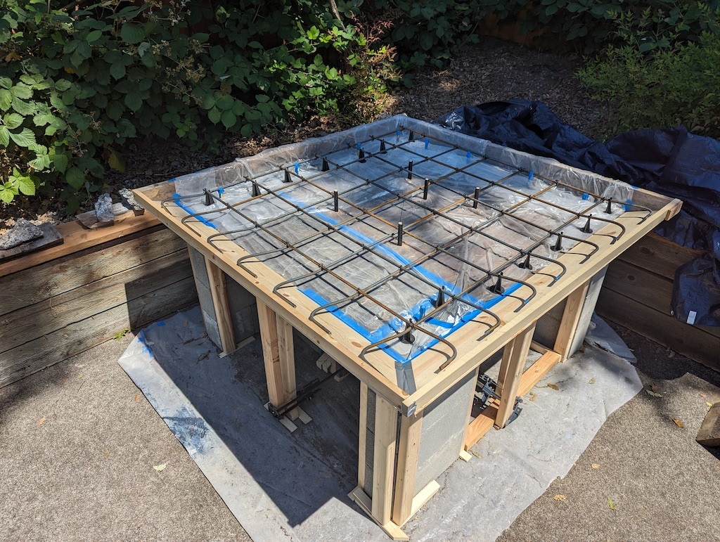

                        As shown, I followed david s 's design of projecting rebar "pins" straight up out of the cores that the poured hearth will anchor against. I used 3/8" rebar since the 1/2" rebar I used for my first oven was unnecessarily difficult to work with. I will use 3/8" rebar for the hearth as well. Not shown in the photos is that each filled core actually has two pieces of rebar in it, the second one not long enough to protrude out the top of the core.
                        I will cover the top of the wall in plastic before pouring the hearth so they don't bond to each other. Likewise, I will wrap the rebar pins in corrugated cardboard or thin, flexible sheet-like styrofoam, such that the pins don't permanently lock to the poured hearth. Again, the intent is that in the far flung future, one will be able to palette-jack, forklift, or crane the hearth (with oven) straight up off the walls, either for transport to a new site or just for easier final demolition.
                        It turns out that nine cores of six-inch concrete block, four blocks tall, uses precisely six 60lb bags of concrete. That was approximately what I had calculated in advance, but it was still neat to hit the mark so perfectly.

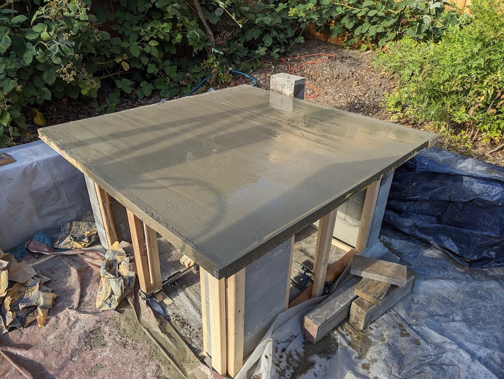

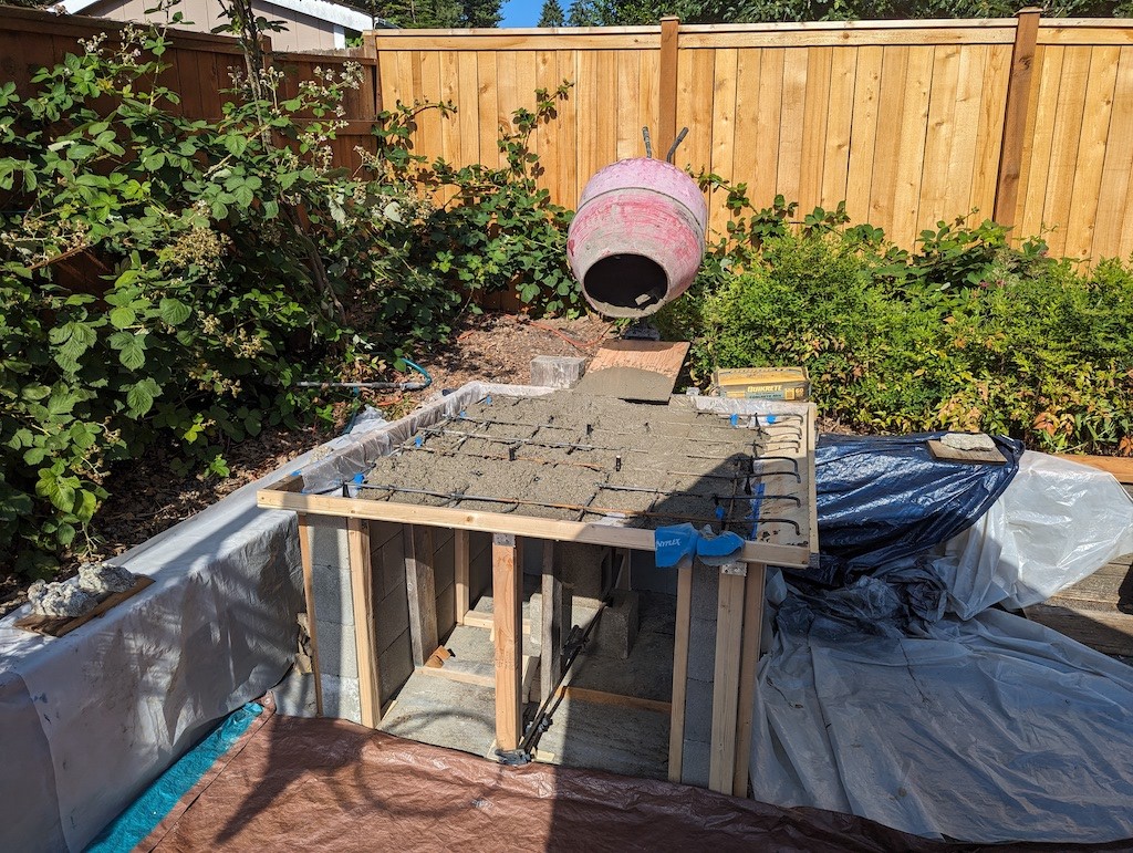

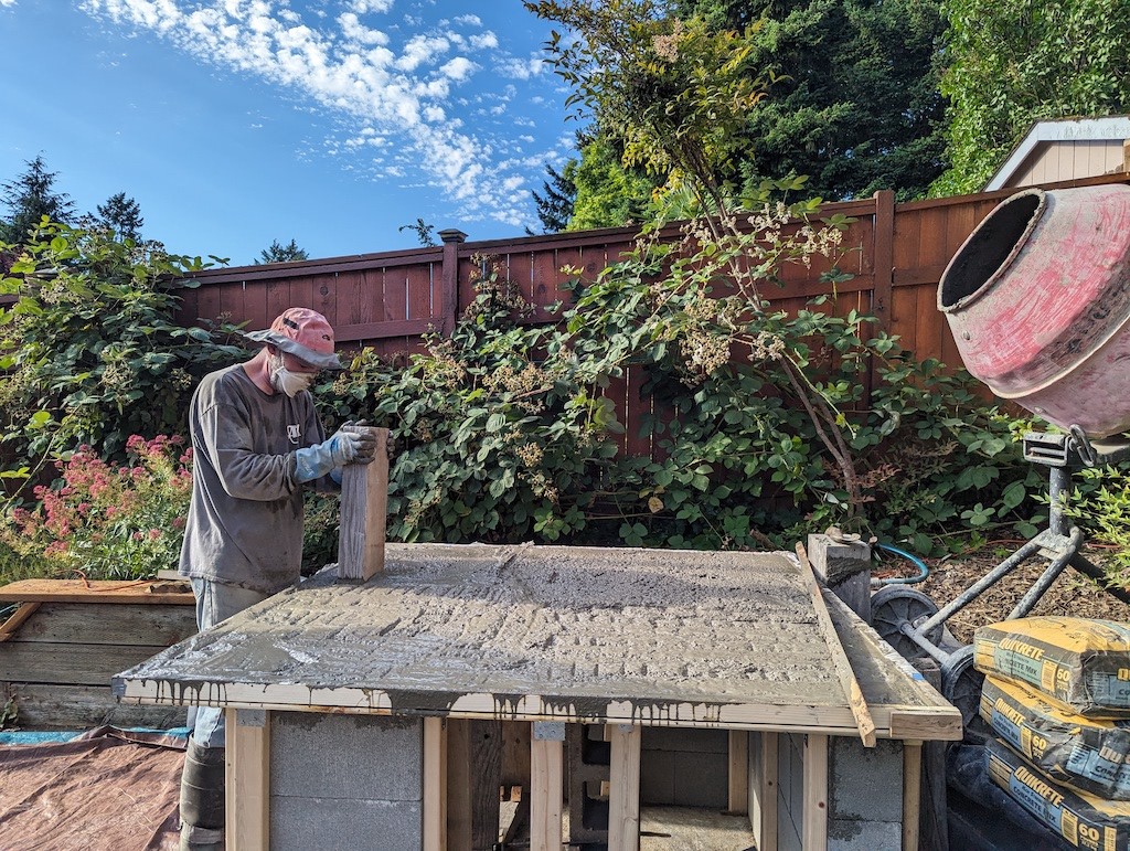

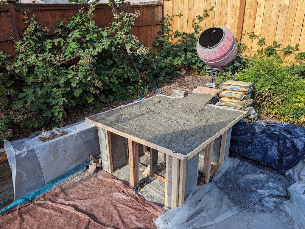

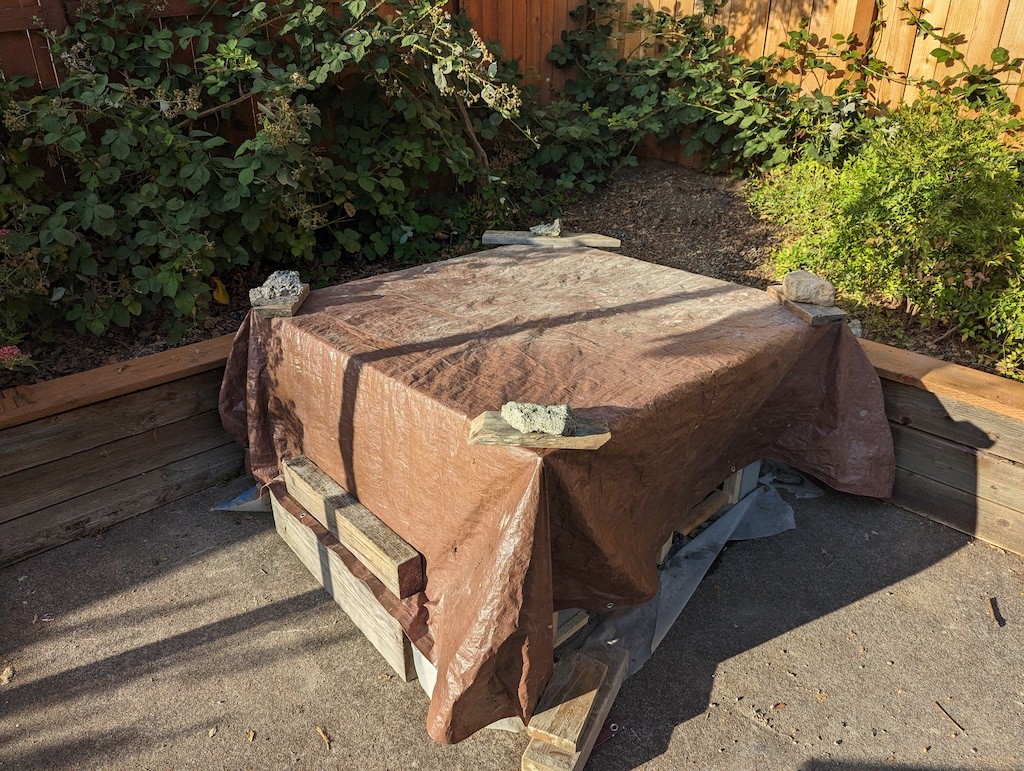

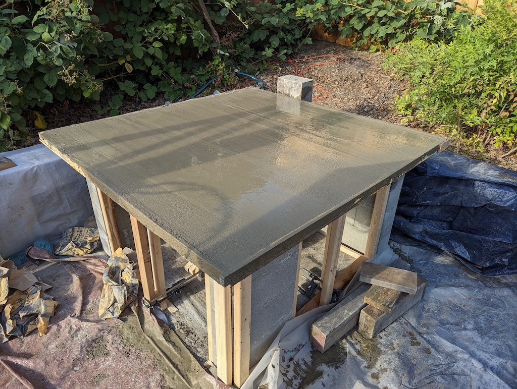

                            Big day today. With the help of a friend, I poured the hearth in near-80F weather under a beating sun. For this reason, I mixed the concrete pretty wet and occasionally misted the ongoing job while I was mixing the next batch (always either two or three 60lb bags at a time). The form/frame design is flush with the concrete walls on the rear and left sides, where the oven is cornered in by two retaining walls, but has a chamfered overhang on the front and right sides. I hope it doesn't chip, crumble, or otherwise fail along the 1.5" thick front edge (it's obviousliy 4" thick everywhere else, as per the standard design). The entire form is lined with plastic except the sloped counter overhangs. I definitely wanted plastic over the concrete walls so the hearth wouldn't bond to the walls, to facilitate eventual deconstruction (the hearth can theoretically be lifted straight off the walls; even the various rebar "pins" protruding from the walls that will anchor the hearth in place are wrapped in thin foam so they won't bond to the hearth, again to enable lifting the hearth off the walls; likewise, the two walls are neither interlocking at the corner nor bonded together in any other way). I chose not to line the counter overhangs with plastic to avoid crease-lines in the concrete, but went ahead and lined the plywood in the middle to insure the rougher-textured plywood wouldn't bond to the concrete; the counter wood is very smooth and less likely to bond, although I confess I didn't oil it or anything. I hope I didn't make a mistake in that regard. I don't have a vibrating tool. I considered using my sander, but instead chose to pack it down with a 4x6 part way through the job. There are five weep holes in the form of 1/2" dowels surrounded by 5/8" thin black irrigation hose (PVC seemed needlessly thick, which would have required a larger concrete void at the outer diameter, and also cost a little bit more). I'll knock out (or drill out, if required) the dowels, leaving the plastic behind.
                            Click image for larger version  Name:	hearthFormWithWeepHoles.jpg Views:	0 Size:	341.5 KB ID:	454404 Click image for larger version  Name:	hearthPourInProgress.jpg Views:	0 Size:	363.3 KB ID:	454398 Click image for larger version  Name:	hearthPourPackingConcrete.jpg Views:	0 Size:	384.4 KB ID:	454400 Click image for larger version  Name:	hearthPourAlmostDone.jpg Views:	0 Size:	360.6 KB ID:	454401 Click image for larger version  Name:	hearthPourDone.jpg Views:	0 Size:	344.0 KB ID:	454403 Click image for larger version  Name:	hearthPourCoveredForCuring.jpg Views:	0 Size:	354.2 KB ID:	454399

                              I'm happy to leave plastic over the curing hearth for the rest of the week. I'm aware of the recommendation to trap the humidity in for several days. But should I take the forms off at some point, or should I just leave everything as is for most of a week before taking anything apart?
                              • #90
                                My slab is cantilevered on all sides with an integrated lintel supporting the front, so I left the forms on for 3 weeks and continued the wet cure for a 4th bc. I had the time plus my slab is a lot thicker than yours. The forms popped off without any problem, but I had oiled them pretty well. If you didn't use a release agent on the wood not covered by plastic, you may not want to wait so long. A lot of the Forum members have tons of concrete experience. There's probably a sweet spot for the time that someone could help you with.
                                If you are worried about the forms sticking, it looks like you could remove just the boards on the edge. You could do that after 2-3 days and leave the bottom supports in place for a while. I wouldn't put a lot of weight on those edges for at least a week.
