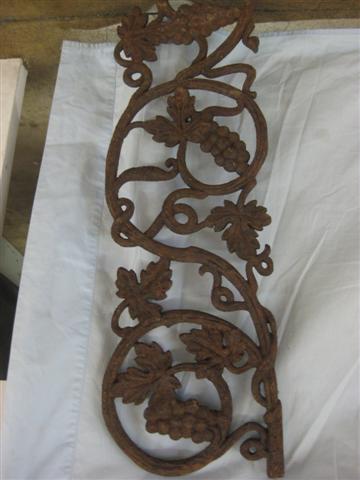

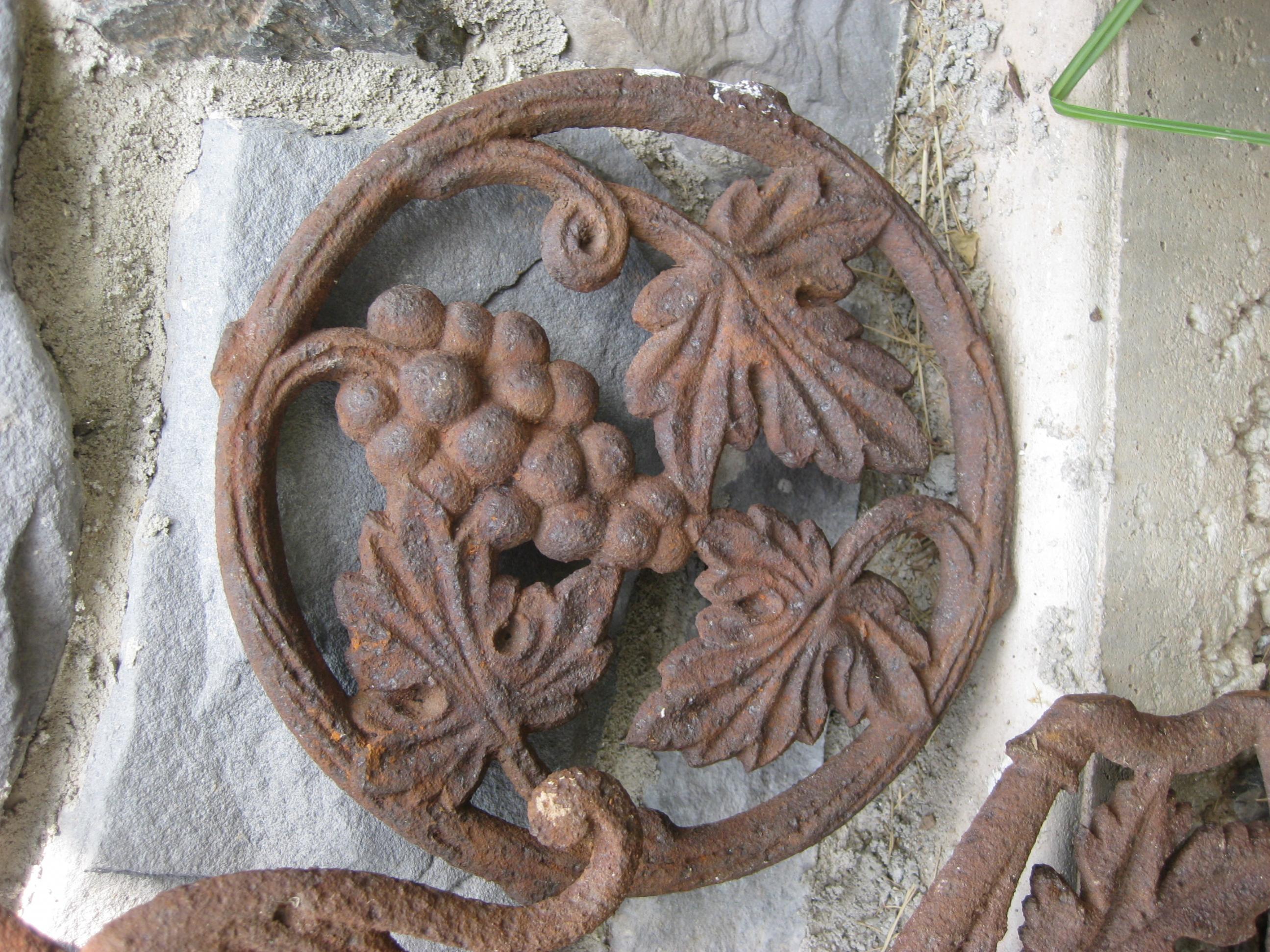

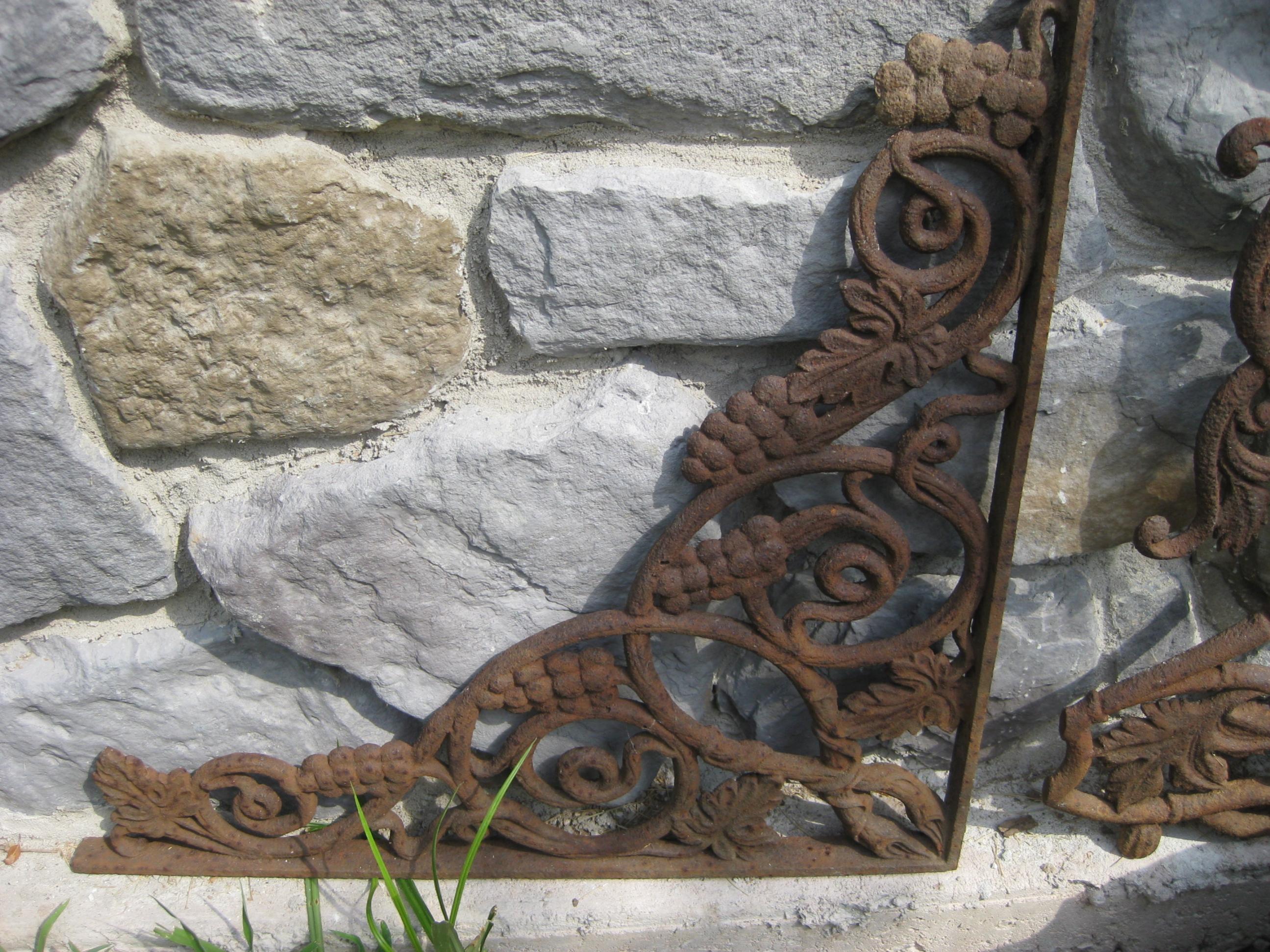

The angle pieces are 22"X22". I don't know why I thought it was 17.
Thanks again! We talked to your friend yesterday (btw-great guy) and are now in the midst of where to locate the pieces on the oven. My wife is in charge of the decorating duties, so it will be her task on which pieces to get and how to use them on the oven.
Since I am coping your cast iron idea it is obvious that I think your build is looking great!

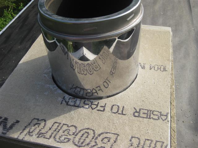

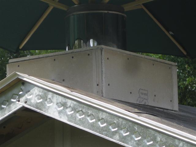

The clay pipe was just temporary so I could start using my oven last year. Both sections of pipe ended up cracking down the middle as I suspected they would. I removed them and installed the Duratech system along with a cast refractory riser that I made. Before I built the enclosure I Insulated the casting and the chimney with Thermafiber and vermicrete to keep the enclosre temp down.
I've been thinking about how to finish off the chimney for some time and decided to box it in with metal studs and durock/stucco which I did this week. I don't have a photo of the stucco yet. I've also measured and ordered a chase cap to seal off the top.

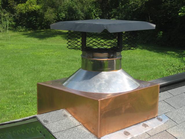

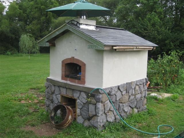

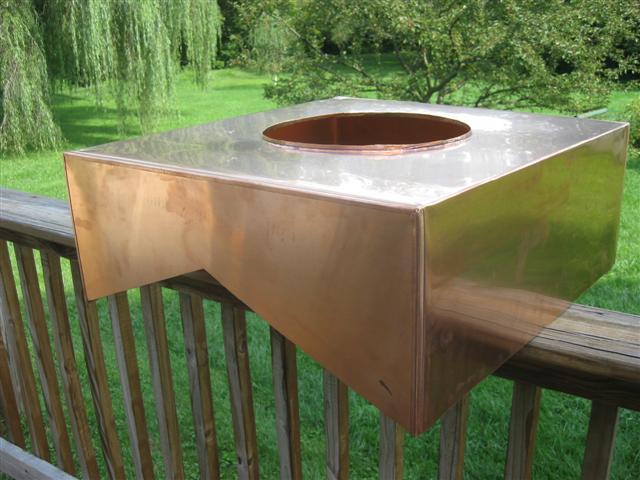

Got a little more work done recently. The roof is on,(shingles) the stucco is done(God I hate doing stucco) and I got the chimney chase cap in place. On to the woodwork!
Ok, I have to ask where did you get the cap made and at what cost? Man that looks great!
A local metal fab. shop made it for me. 38.50 for the copper, 42 for labor, + tax = $85
I didn't like the look of the flashing with all the sealant, and never having done flashing before, I didn't really trust my work not to leak. The cap covers everything. No more worries.
