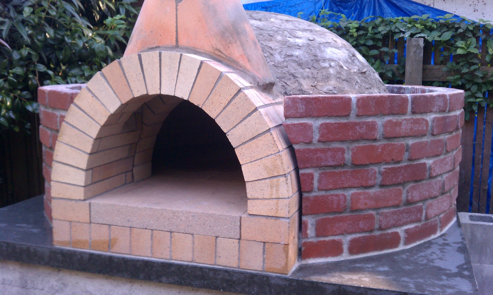

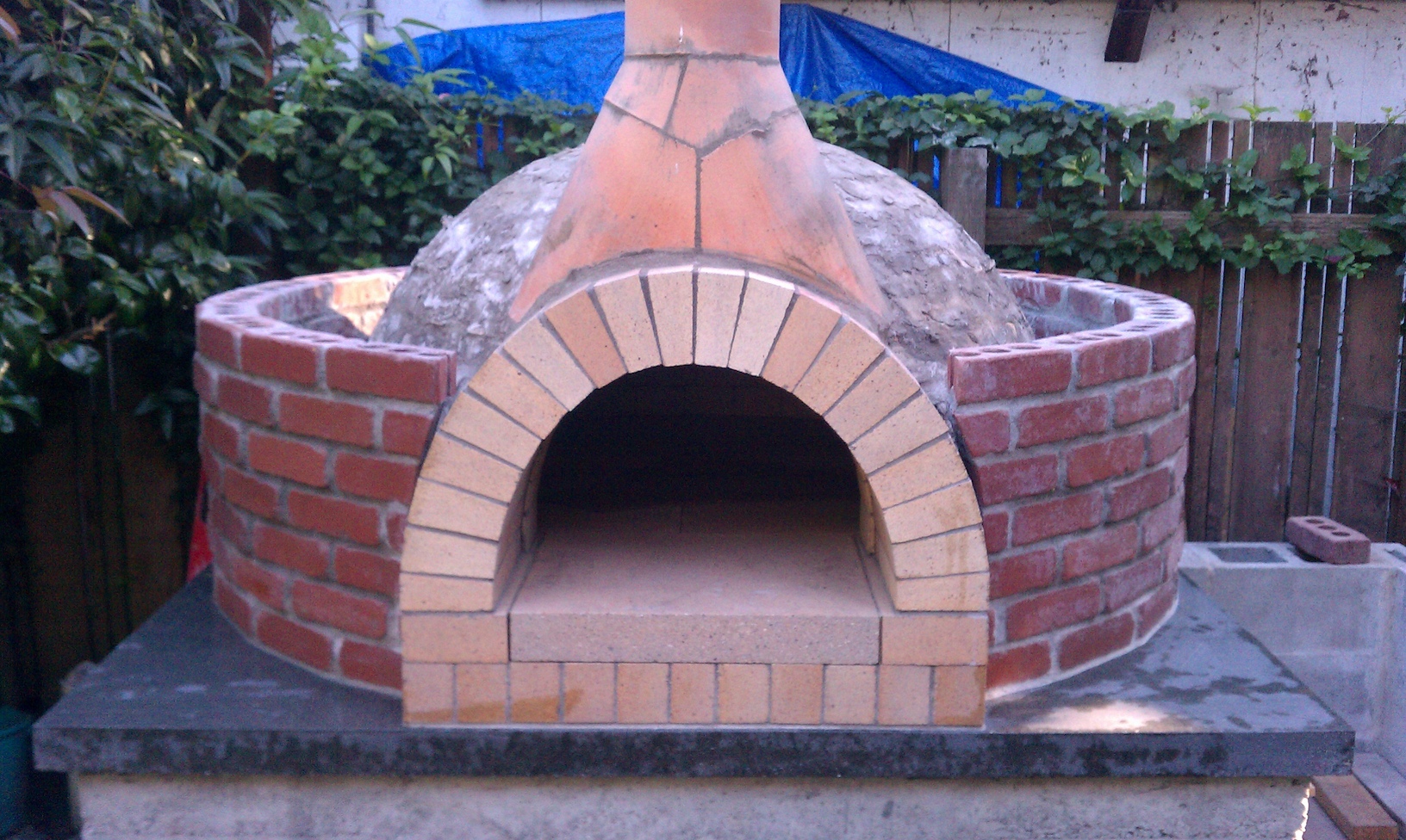

                -Here are a couple of pics of my progress (I feel like I'm building another oven)
                Mike

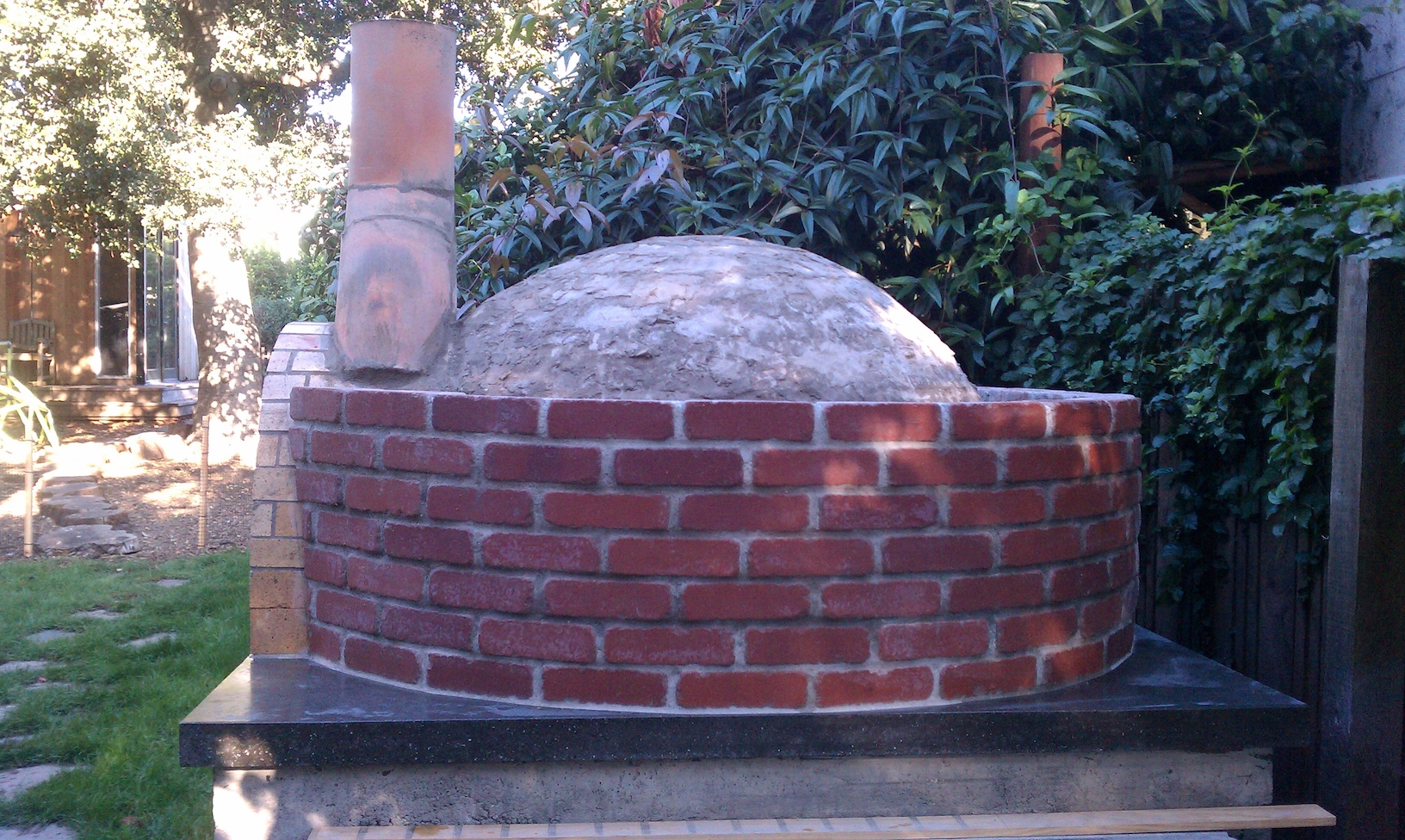

                      Finished the the round brick! I think I am crazy. I had to cut the back corner off of every brick. Now I need to let is cure for a bit put the SBC on the inside and then put on the insulation.
                      Here are some pics
                      Mike

                        #221
                        Re: Round shape
                        I've applied SBC over irregular surfaces using my hand as a trowel and smoothing over with a wet sponge. Applying on the inside of the brick housing shouldn't be difficult at all.
                        George
                        My 34" WFO build
                        • Mike D
                          • Oct 2010
                          • 342
                          #222
                          Re: Round shape
                          FXPOSE, do you think it will help at all? Am I crazy for thinking I need it? As in is it necessary?
                          • fxpose
                            • Jul 2009
                            • 942
                            #223
                            Re: Round shape
                            Mike, on second thought I personally would not use it on the inside of the brick enclosure as it will prevent moisture from escaping should there be any moisture buildup inside.
                            BTW, your build is looking great! I love that brick enclosure.
