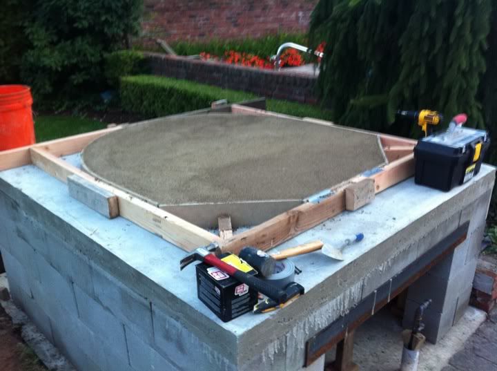

Today I did the rebar grid, poured the slab and in the evening formed and poured the vermiculite. My friend is a pool builder so he gave me 16 cubic feet of the fine pool base stuff. I poured a 4" slab and a 4" vermiculite layer.
