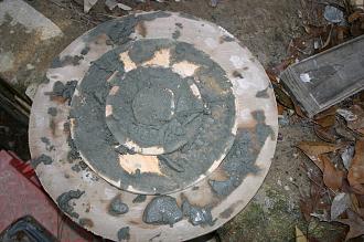

    I'll try and catch up a little on with the build thread. I've been working on the dome with what little time off I have had:
    I knew that big ole HF wet saw box would come in handy

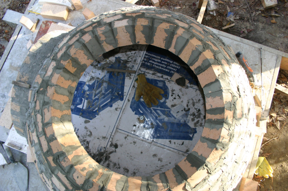

      As I neared the top courses where it gets really steep I started running into some problems. It was taking too long for the bricks to set and to many support sticks to keep moving around the course. This was mostly because of my impatience and probably not mixing the mortor to match the cool damp conditions. The bricks were kept dry and the build is covered but, we have high humidity even in cool weather down here in South MS.
      At that point I ditched the dome guage and tried a row using a method which I saw in a couple of builds on this site. That being using a jack to support a scaffold inside the dome.
      EDIT: I learned about this method on Karangi Dude's build.
      I have done a lot of reading on this site and absorbed a lot of information and who's builds that I did not give credit too originally. Please bare with me as I go back and give credit where credit is due.

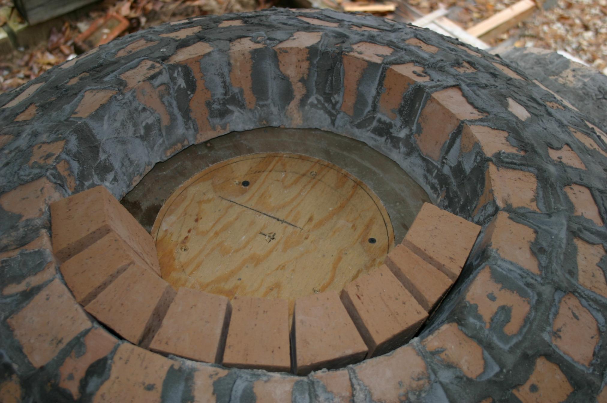

      Sorry that I did not get pics of that first couple of rows with this method but, here is what I did. I set three bricks in a triangle pattern from each other using the dome guage and stick supports. While these three bricks were setting I measured and cut a 3/4" piece of plywood in a circle that would just catch the inside edge of each brick. Supported by the jack, this platform would be my guage for the remainder of the row. This method and my time constraints meant dropping the platform and cleaning that row before continuing on to the next.
      Three rows and a keystone left to go
      Click image for larger version  Name:	003.JPG Views:	1 Size:	250.3 KB ID:	402514

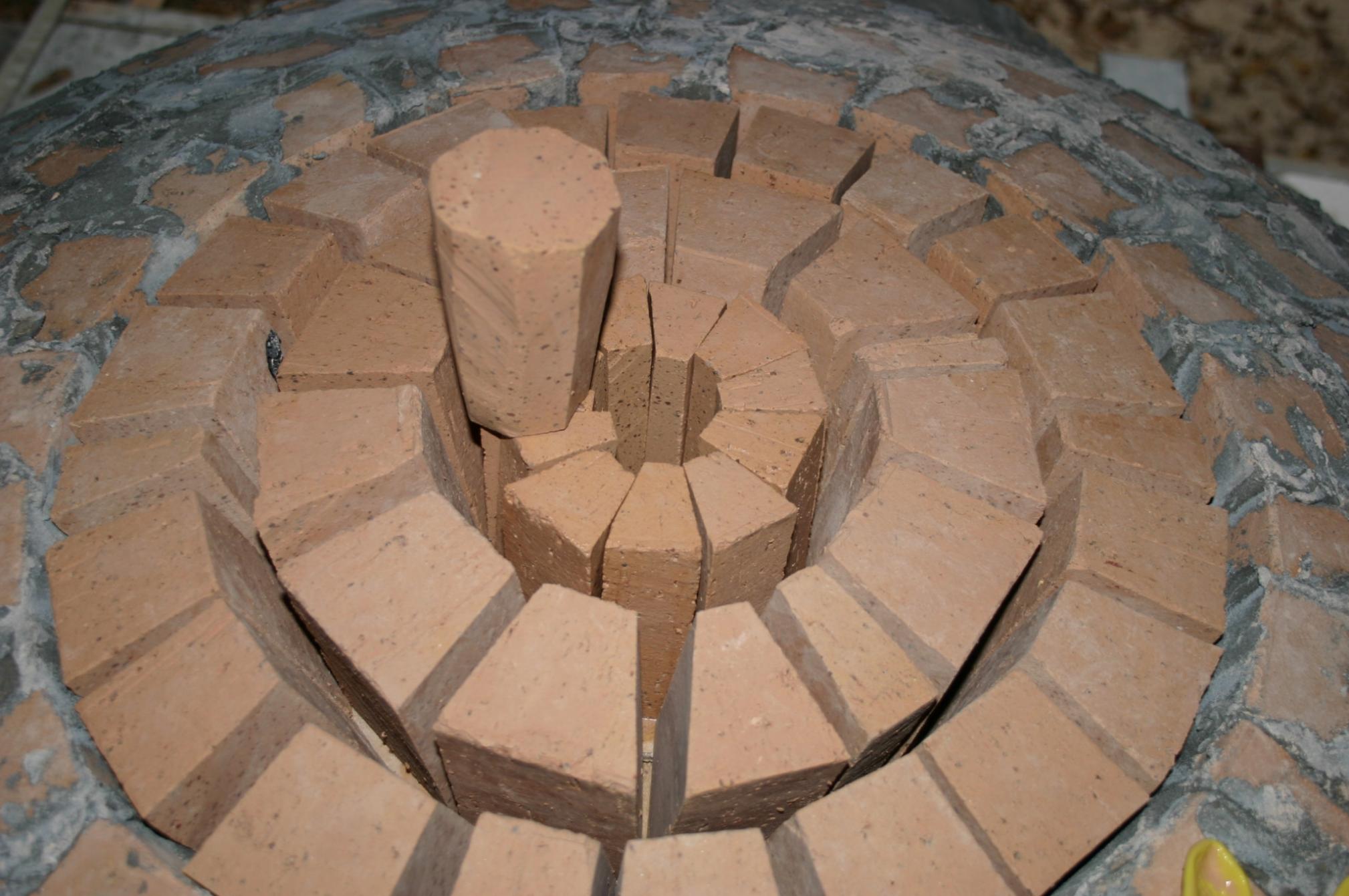

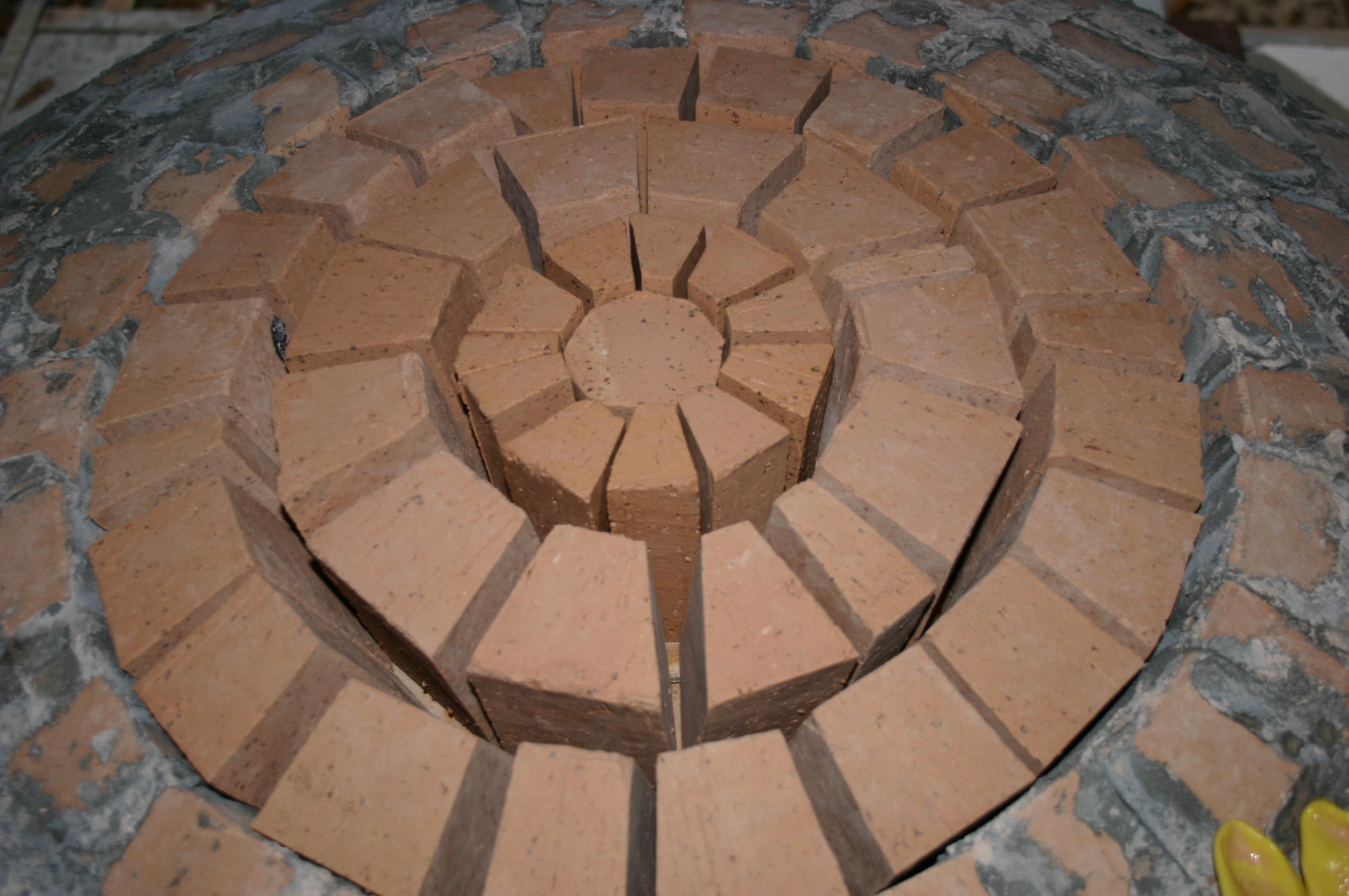

      Using the plywood platform the previous row. I precut the the brick including the keystone. My last row was apexing at the very center of the dome, so I cut them in half to allow for a proper keystone.
      Click image for larger version  Name:	008.JPG Views:	1 Size:	243.1 KB ID:	402515

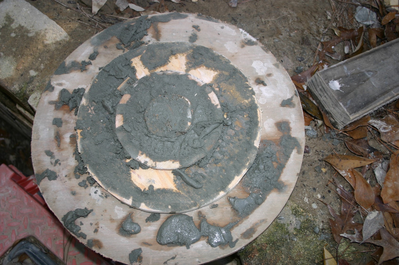

        Hopefully, this pic will explain the platform more clearly. For the last 3 rows I installed another circle of plywood to hold the each row at the proper tilt. They were cut from 3/16th plywood.

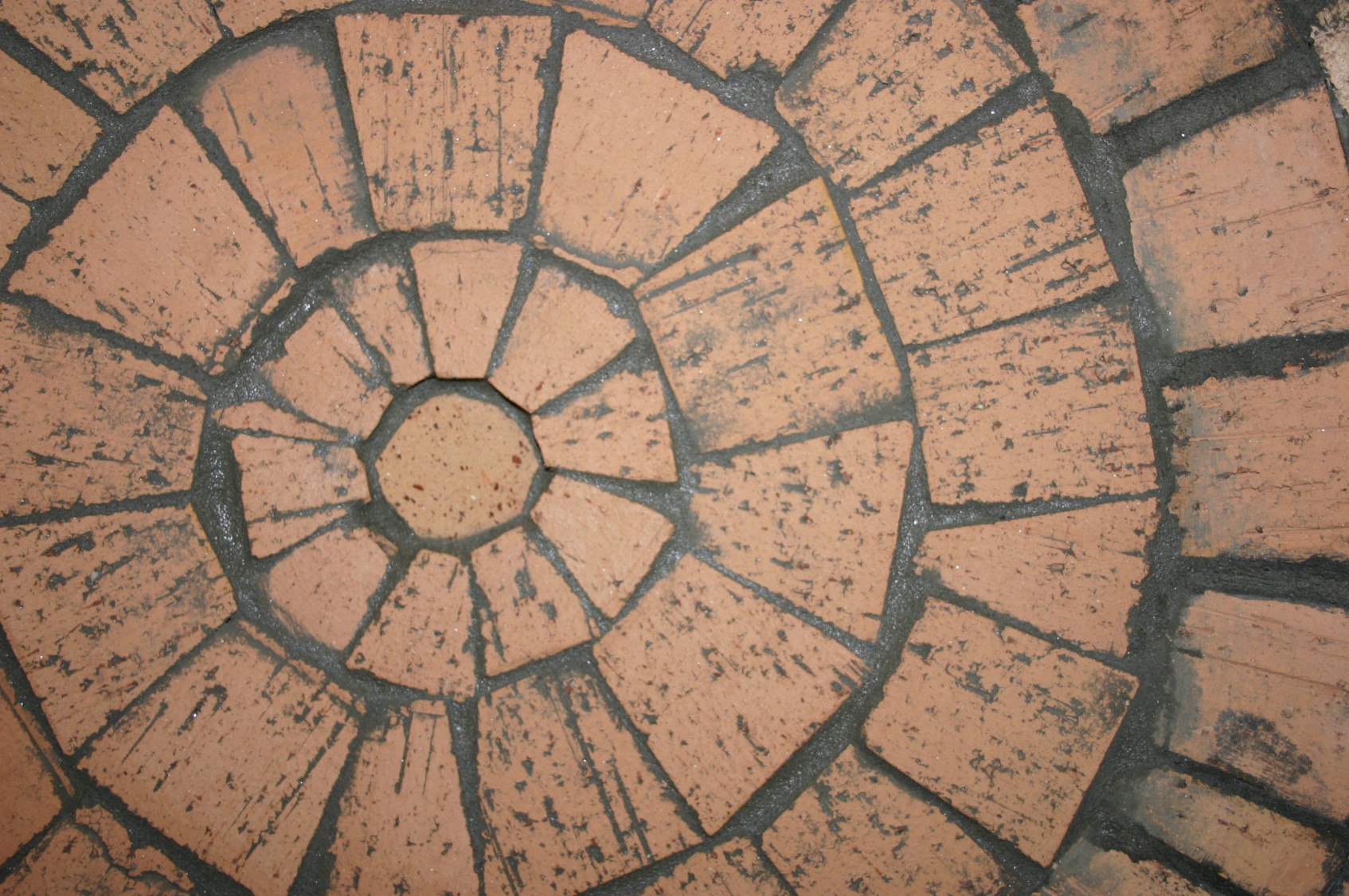

          To bring me up to date. I now have a finnished dome for Christmas I laid the keystone about 3:00 pm CST on Christmas eve.

            As a final note for anyone using this method: Drill a large hole in the center of the last plywood circle all the way through the underlying platforms. This is to allow the mortar for the keystone an escape route. As I was pressing mine in to place it came to an abrupt stop about 1/4" from the gauge disc. This can be see in my inside pic above of the finished dome which shows up as a shadow between the last row and the keystone.
