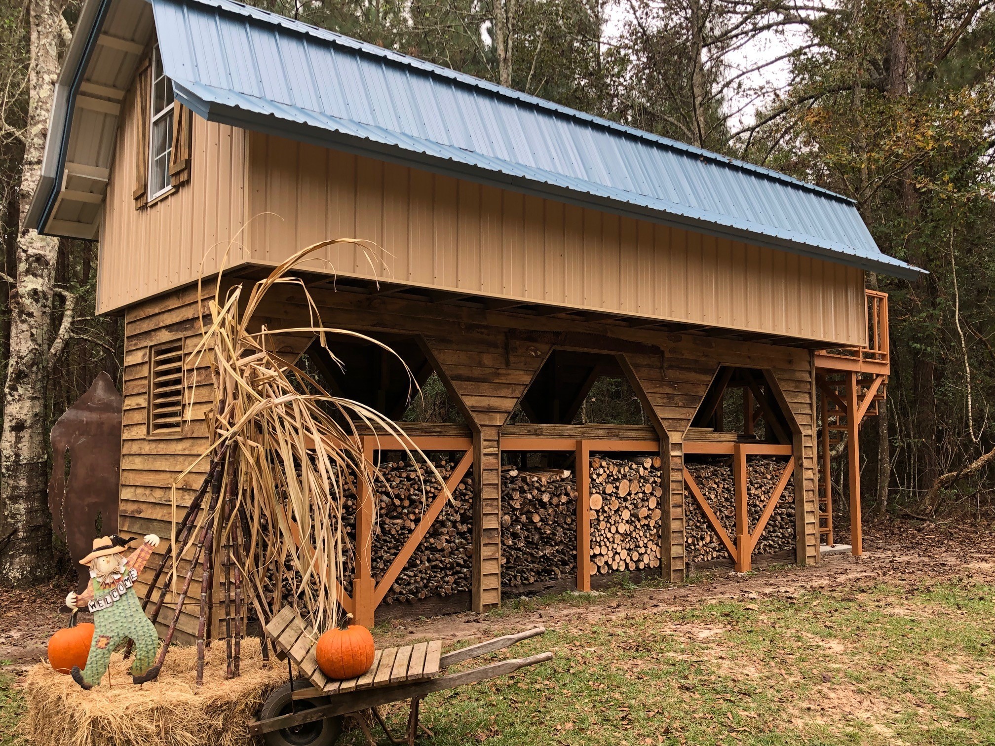

    replied
    Our new "Multipurpose Barn". We had 16 hardwood trees cut his past spring that had over grown and were a threat to our home. For cost savings, we were left with the cleanup of all the small limbs. We needed a place to dry them. We are also in the process of a total remodel of our home that we want to add wrap around porches and a complete interior overhaul. Lumber prices at the time which I started this project were outrageous! They still are!
    We had to buy some treated posts but the bulk of this project was scrounged materials. The lumber was rough cut. The pine lap siding you see was cut from my place the year before hurricane Katrina. They were infested with the southern pine beetle. Thankfully, the logger that cut the uninfested trees cut and hauled them to a small sawmill for me. From there, I hauled the cut lumber to be treated. They have been hanging around aging while I was searching for a good purpose for them. With the price of lumber nowadays, I may have to cut some more of my pines to finish the project.
    The metal is all salvaged. The tan was salvaged from a roof that was installed improperly and the blue was unused that has been precut for a customer who abandoned the order with the roofing company holding the bag. I got it for cost a few years ago.
    We have a 4.5 chord capacity wood storage underneath a 24' lumber drying rack/storage
    With the remodel we will need plenty of storage. We have a 25' X 10' storage unit on top of it all.
    This cantilevered barn design helped me to get most of what we need under one roof

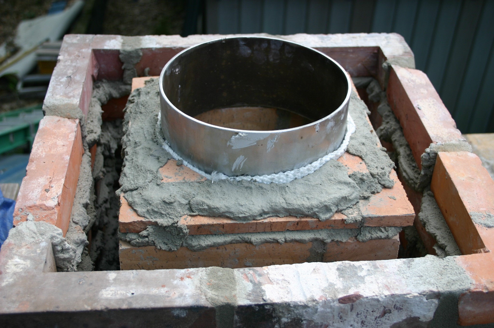

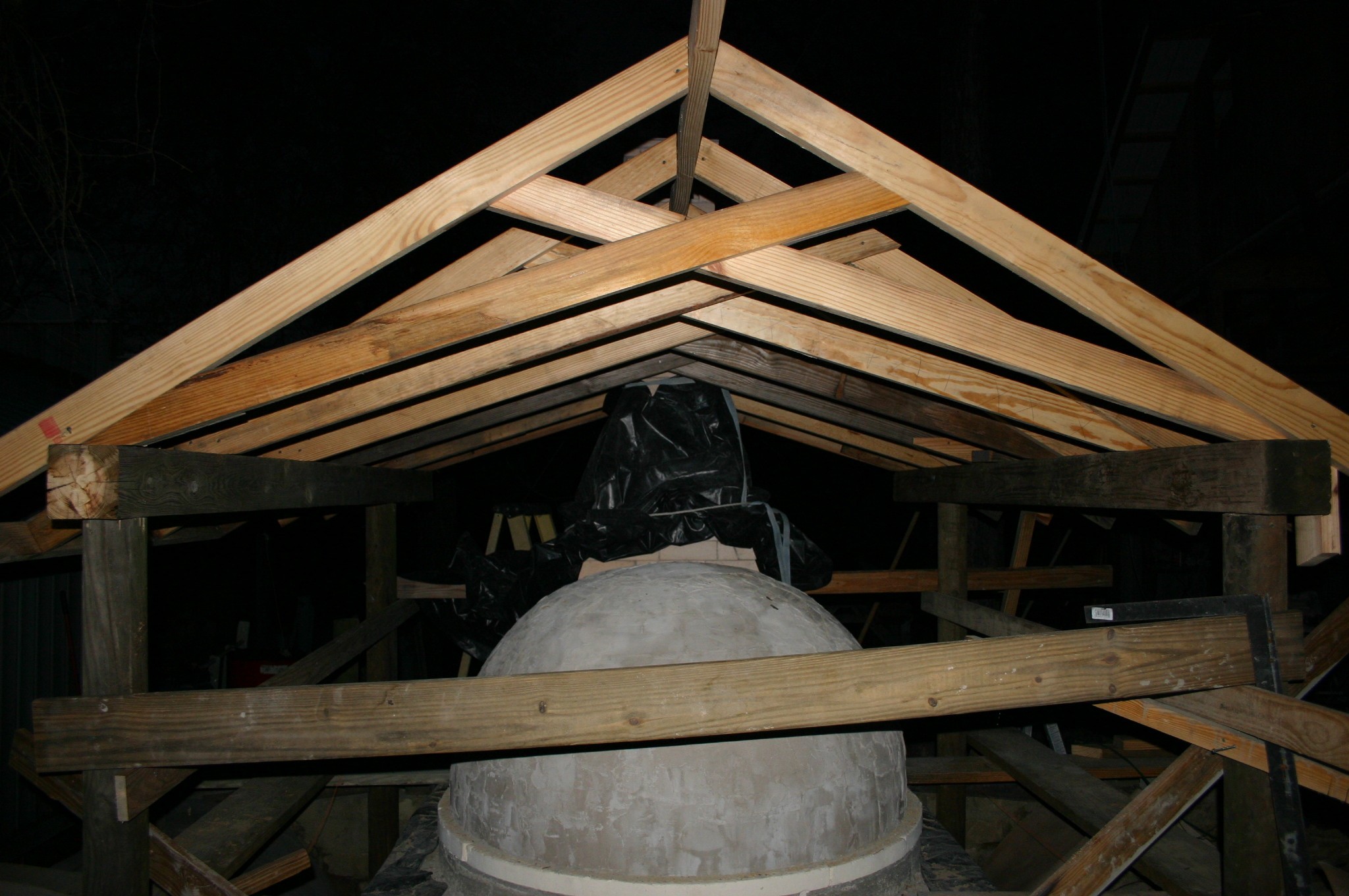

    It wasn't done to retain heat in the oven. My roof over the oven is wood framed. Wood framing was thought to be sort of "taboo" at the time of my build. But wood construction is what I'm most comfortable with. The code was for 8" of masonry for a chimney. I wanted to narrow that down to save weight and dimensions. I cut it down to 6" by cutting the outer face brick down to 2" and then filling with vcrete. That was an overall savings of 4 " diameter of heavy masonry. More work and time on my part but the IF thermometer readings and the moss growing on the side of my chimney says that it's efficient

    Gulf,
    That SS sleeve is quite thick at 1/8" it will have enormous power when it heats up faster than its surrounding brickwork and could fracture your brick courses. Or is that ceramic blanket you have surrounded it with, pre-empting the problem? I cracked castable refractory on two ovens a few years ago using SS at 1.2 mm thick and casting directly up to it. They both cracked in the same place.The vermicrete is ok because it has some elasticity.
    Dave
    Hi Gulf,
    As I am about to finish the chimney, I would like to ask you behind the reason for insulating around the flue chimney when it is completely separated from the dome. The Chimney chamber doesn't have any thermal bridge connected to the dome. So why the insulation? Thanks
