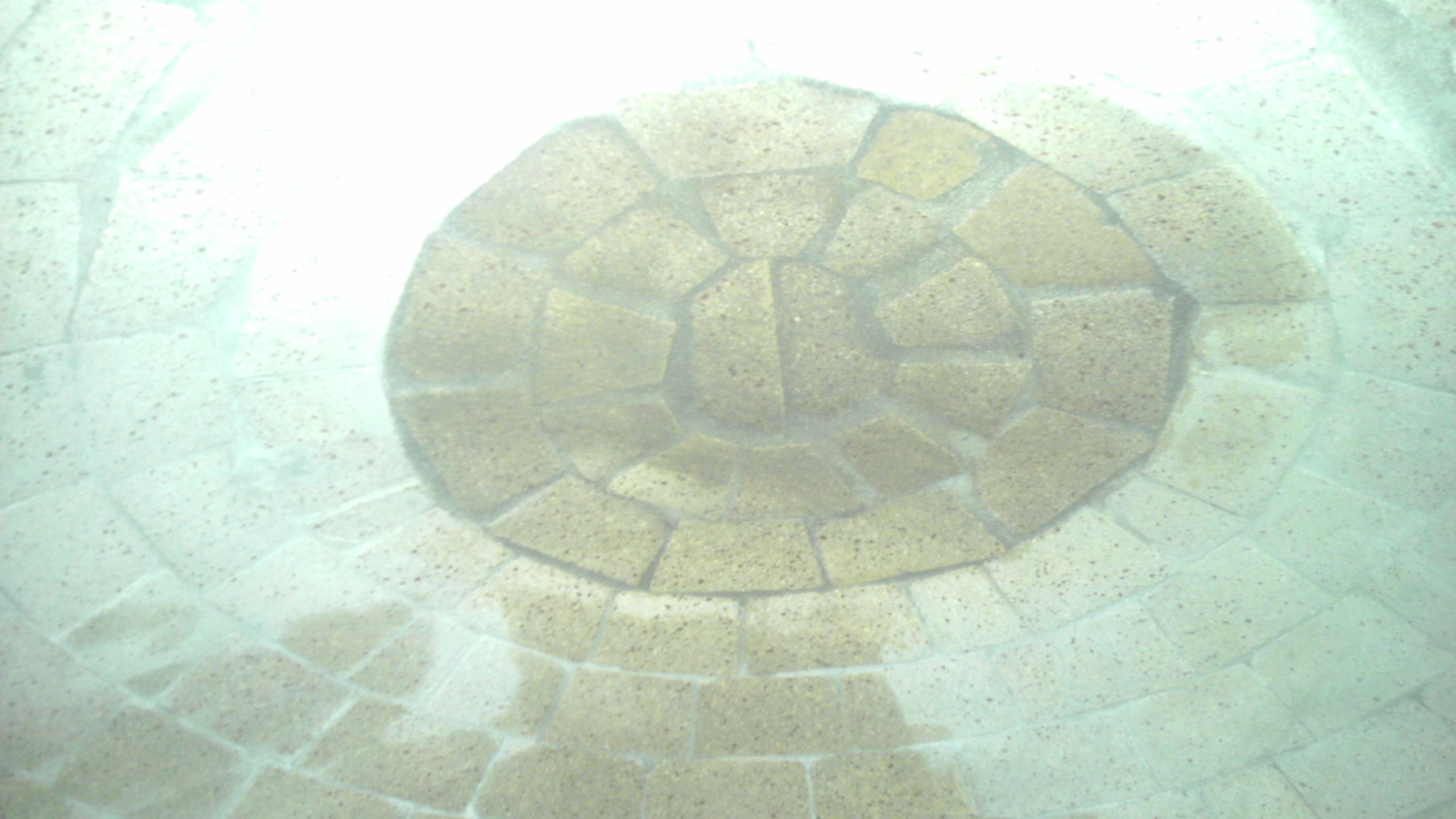

Completed the last 3 courses, these were real hard as the angles/bevel were extreme, center piece end up being 5" in diameter, so I just used 2 pieces cut from 2 full bricks. I made a form for the last piece, so that suggested somewhere, really helped.
Pretty happy with the way everything came out, its not the prettiest girl on the block, but she is my girl! Really liked the duravent, real easy to install, sure I went over board, embedded it in mortar, tap con it down, then topped sides with full bricks mortared again.
Will start facade for front/chimney next month. Glad to have the week break to let this dry out before curing, I'm really beat! All in all I have 3 months build time (thanks to my wife schedule as teacher, and mine as a firefighter), otherwise it would be more like 5 or 6 months. Really enjoyed the process, what a great site, feel blessed to have the mentors showing me the ropes, especially Russell!

It was a fairly quick process to slowly drag the face of each brick across the rim of the diamond blade to leave a concave surface not only top-to-bottom, but also side-to-side. This effectively removed any upper-brick hanging over the adjoining bricks below. The concave radius got progressively smaller with each successively-higher course.I think Gianni (Octoforno) towards the top rounded his bricks to get an almost perfect joint. Cutting the bricks smaller also reduces it.
