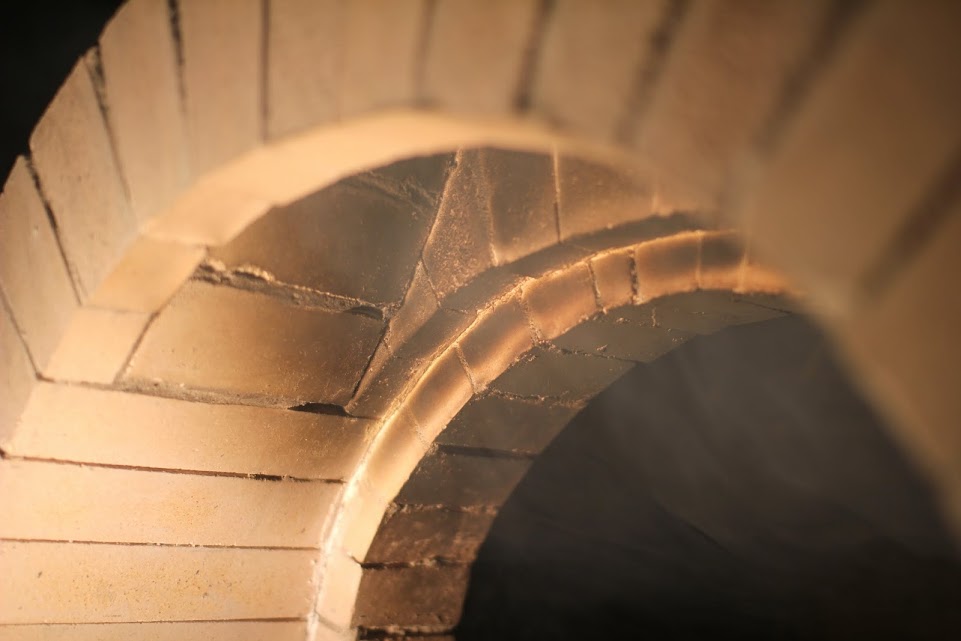

    Well, I started curing fires this week. Started off Tuesday by burning newspaper, and slowly worked my way up through twigs, branches and logs over the next few evenings. Last night I had a couple of logs burning off and on for about 4 hours, and had the floor and walls hovering around 300 most of the time.
    This morning I put the InsWool insulating blanket on and tied it down with rebar wire. At least 3" all around, with 4" in most places and 5" at the top. This was perhaps a bit pre-mature, as towards the end of todays fire (going for around 3 hours as I write this) I saw loads of steam rising off the dome. Probably would have been better to do that without the insulation in the way, but oh well.
    Today's fire got a little out of control at one point, but as far as I can tell there's still no cracks. The load of firewood that we got delivered on Friday turned out to be pretty wet, so I was drying a couple logs at a time in the oven on the side away from the fire. The inevitable happened at one point, and the whole thing burst into flames, with flames licking up the vent. Broke up the fire a bit and let it die down, and eventually got it steady at around 500-550, with the dome clearing a bit at the top. Outside registered about 50 degrees, roughly ambient temperature (lovely weather for December in DC).
