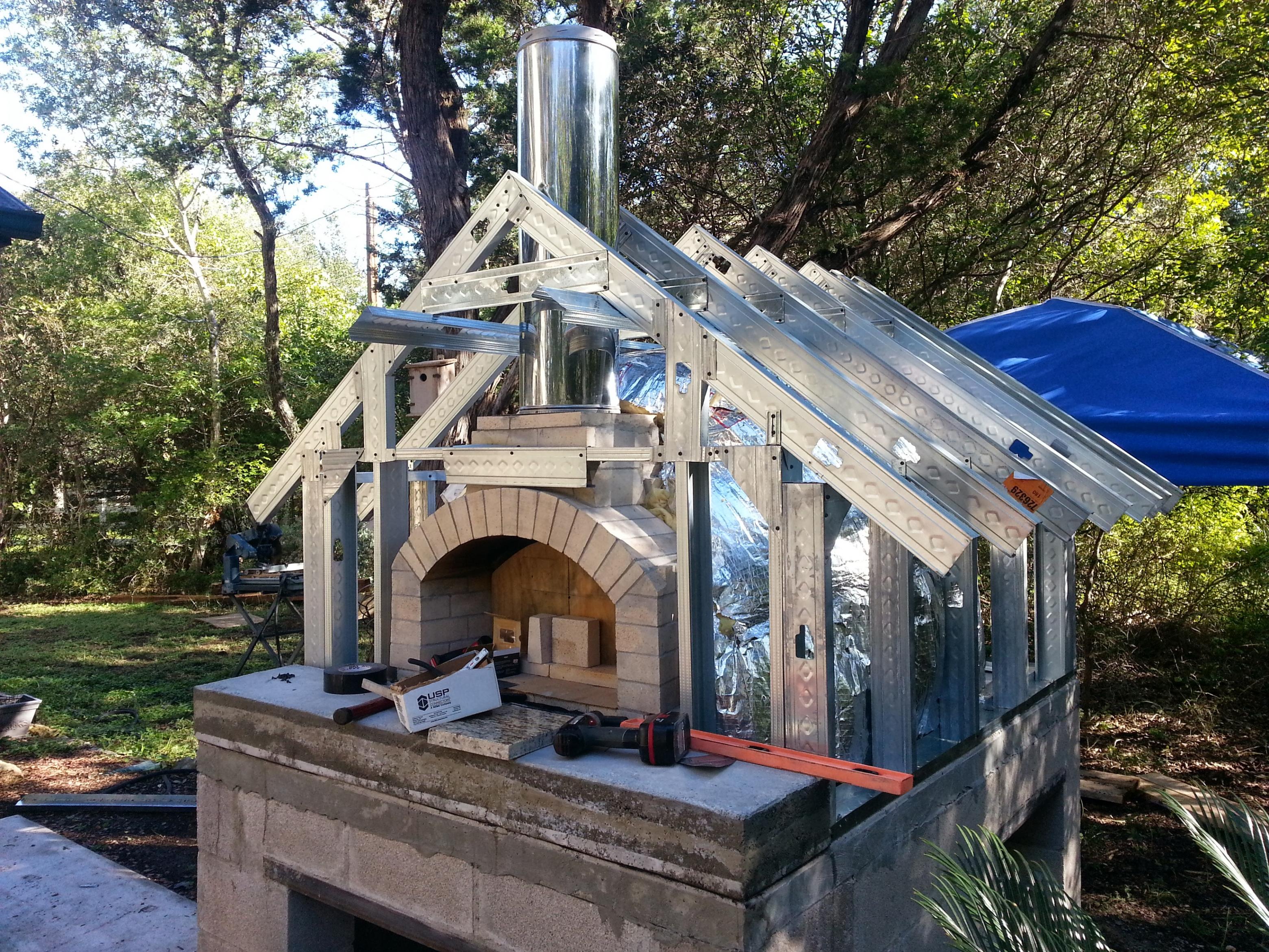

Are you going to have an overhang on the roof? Useful for lighting in the eaves, IMHO.
Originally posted by deejayoh View PostLooking good. You've made really quick progress on that oven.
Are you going to have an overhang on the roof? Useful for lighting in the eaves, IMHO.My build documentary page:

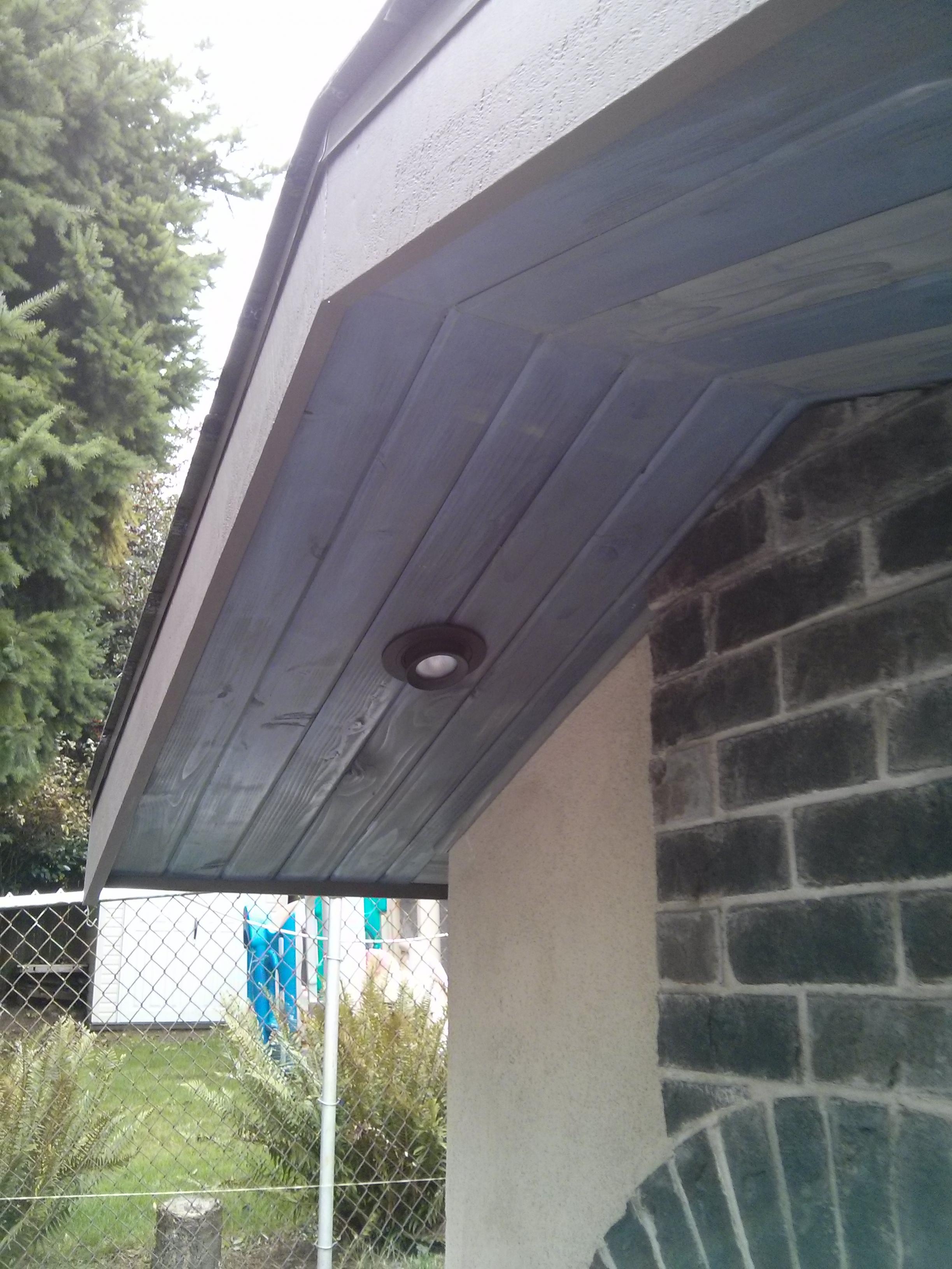

You might want to allow for more room in the front for the lights. They're typically 5" or so for the housing even if you use the small down lights. With trim and fascia and so forth, at 8" you will run out of space pretty quickly. Plus the lights will be right next to the front of your oven housing, so you will end up with wall washers, not task lighting.
I went with a much deeper eave @ 18" because we get so much rain here - but I'd say 12" is minimum. I also used some lights that I could aim/rotate - which is a nice feature.
for reference, here's a picture of the lights installed in mine

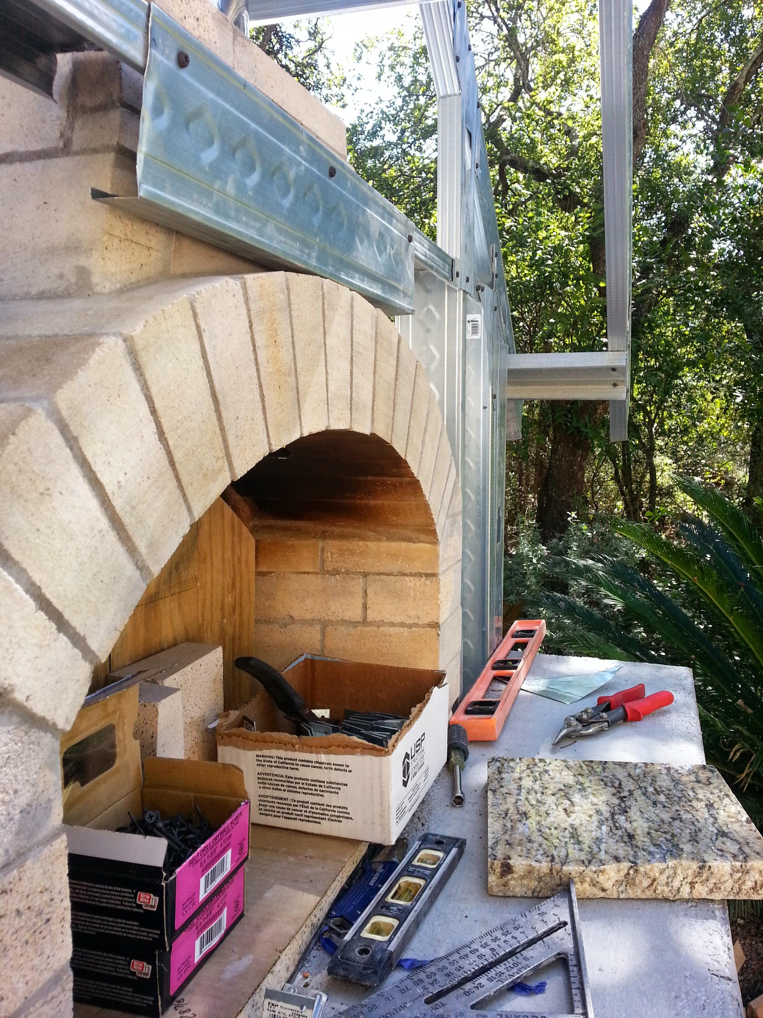

Ah yes - the head banger! I forget, but I had to work around that too and ended up making my roof higher/flatter because I wanted to have head clearance at the corners.
You can probably come out as far as your counter top without any issues.

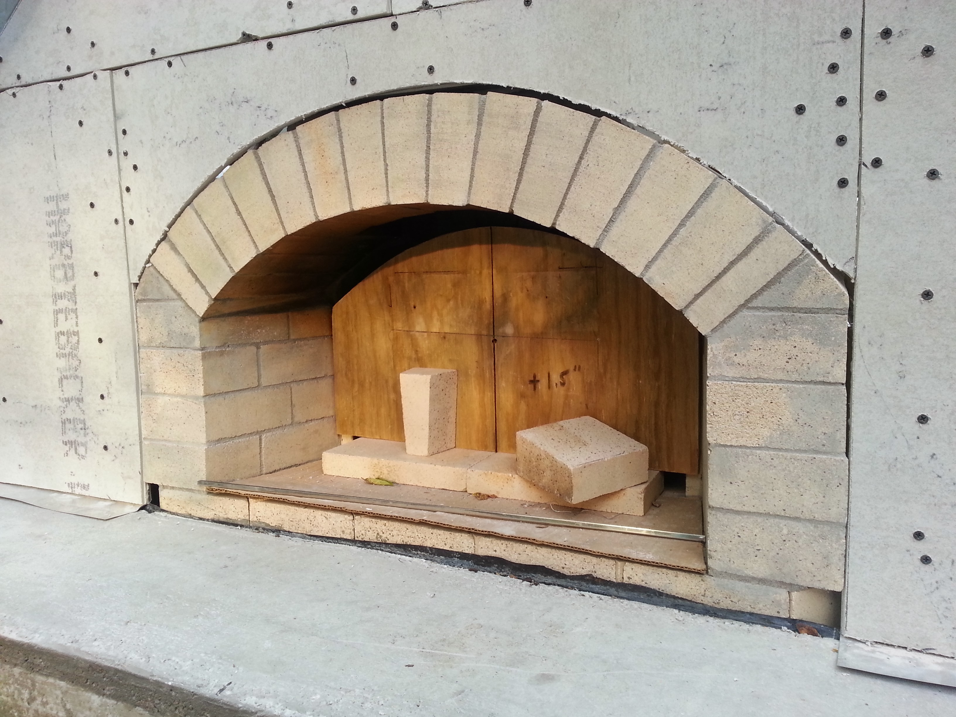

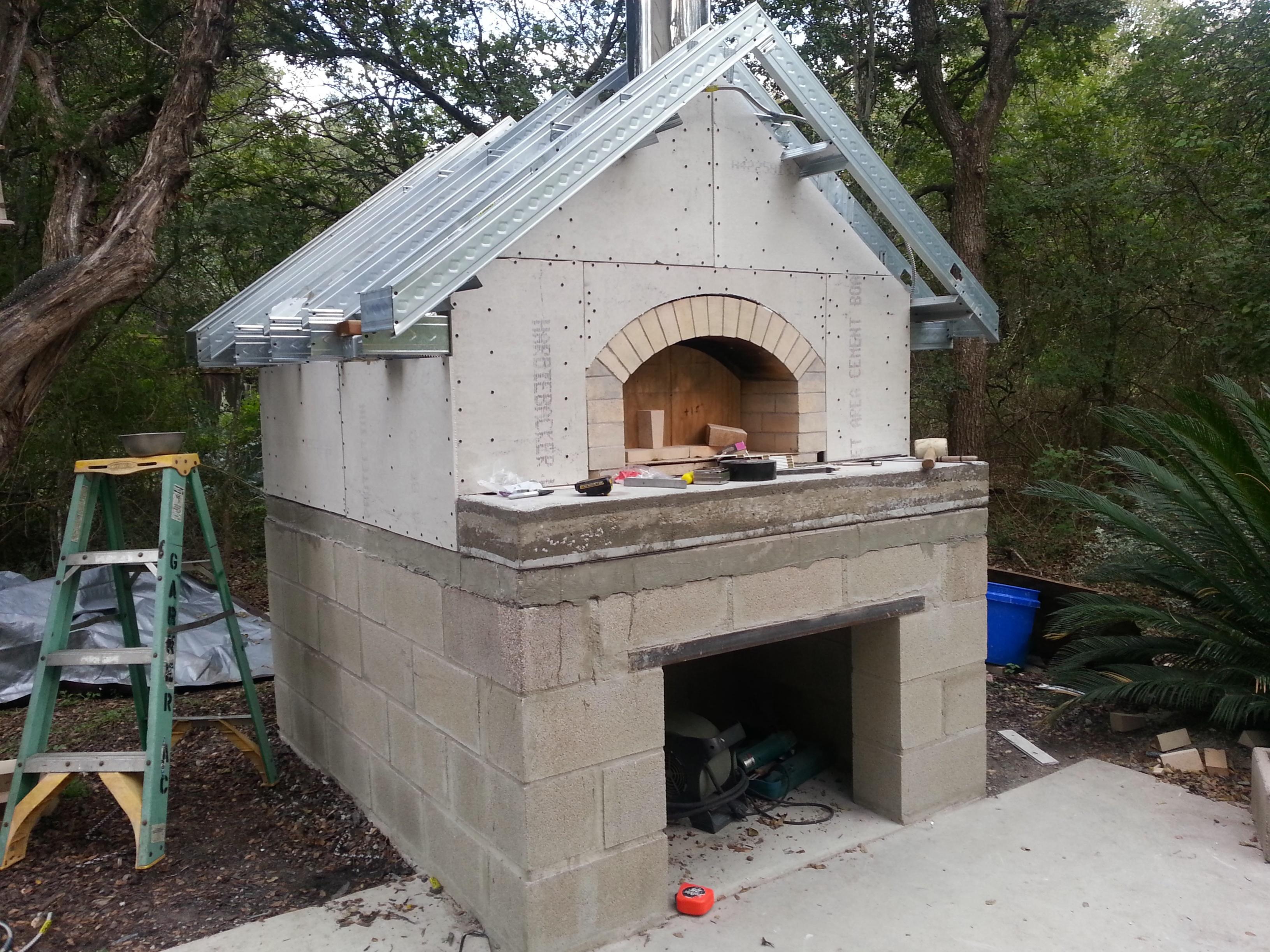

Bit the bullet and purchased tools this morning. My short Peels arent going to cut it anymore!Last edited by GarnerAC; 11-27-2013, 03:54 PM.My build documentary page:

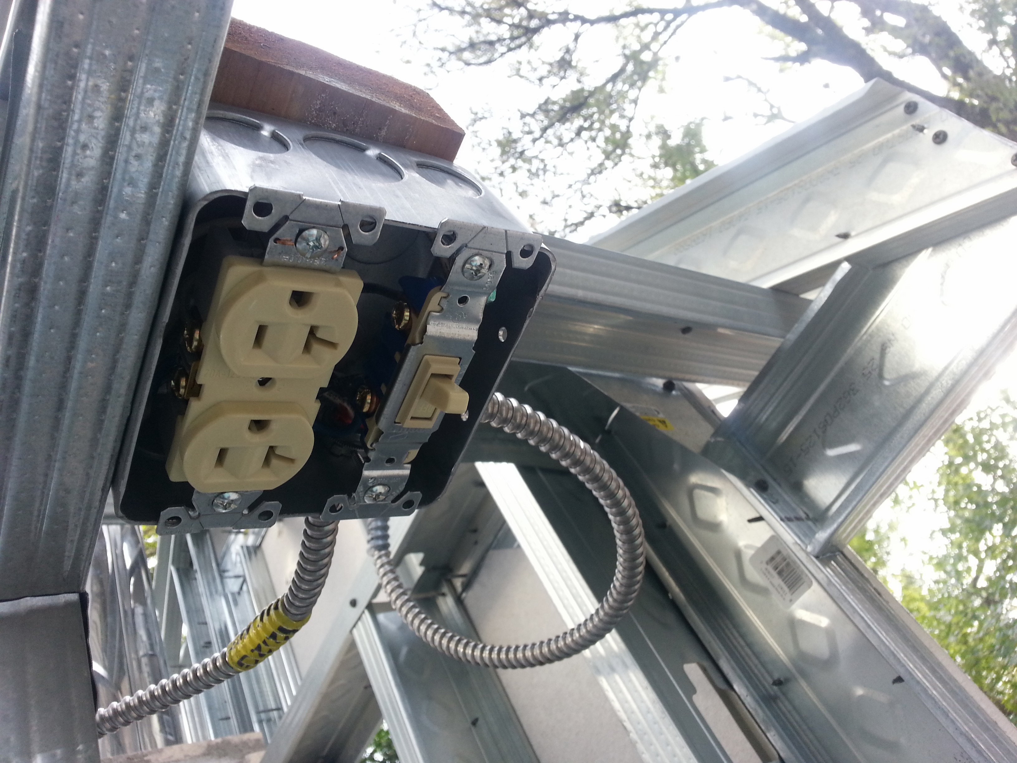

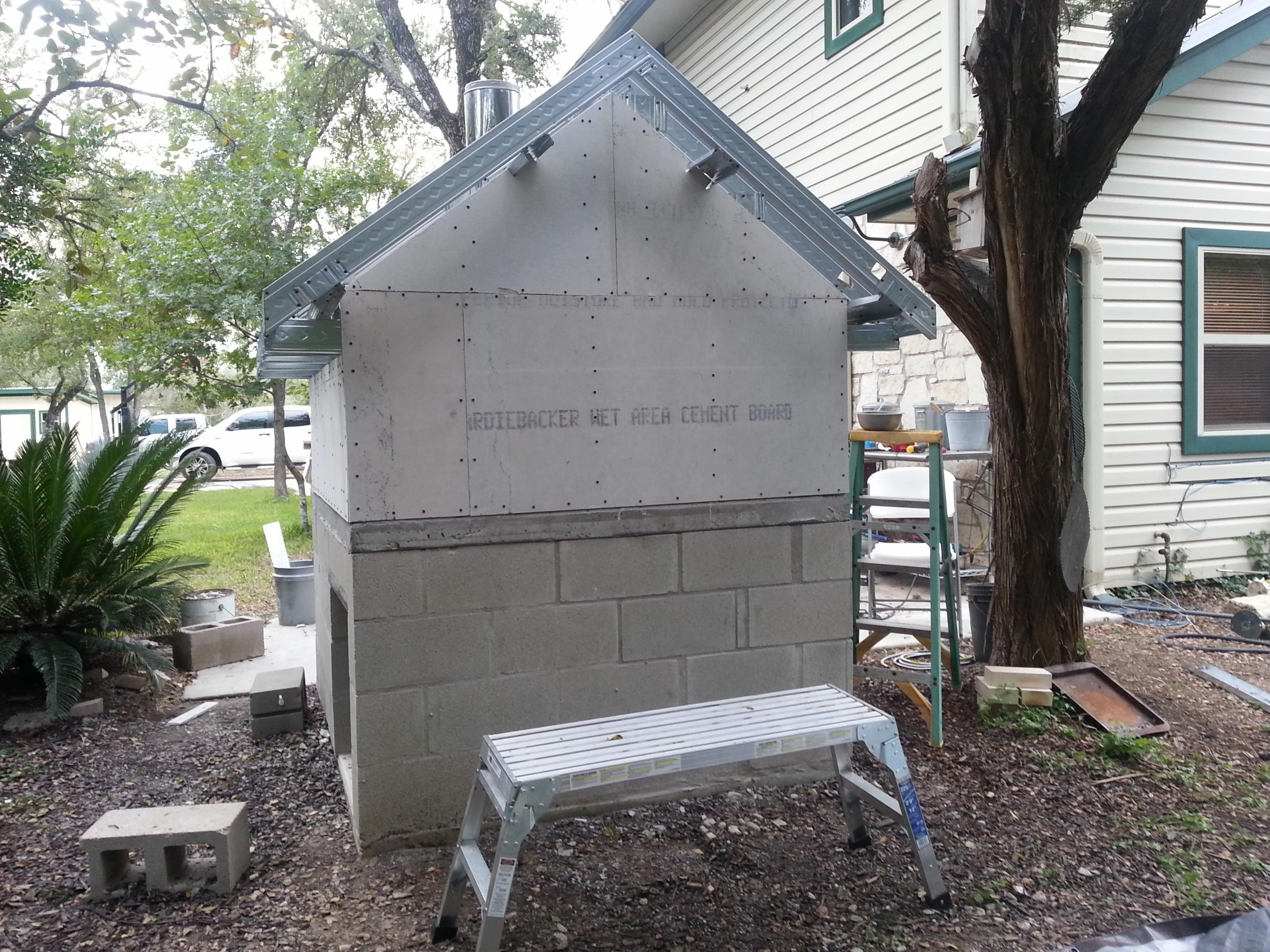

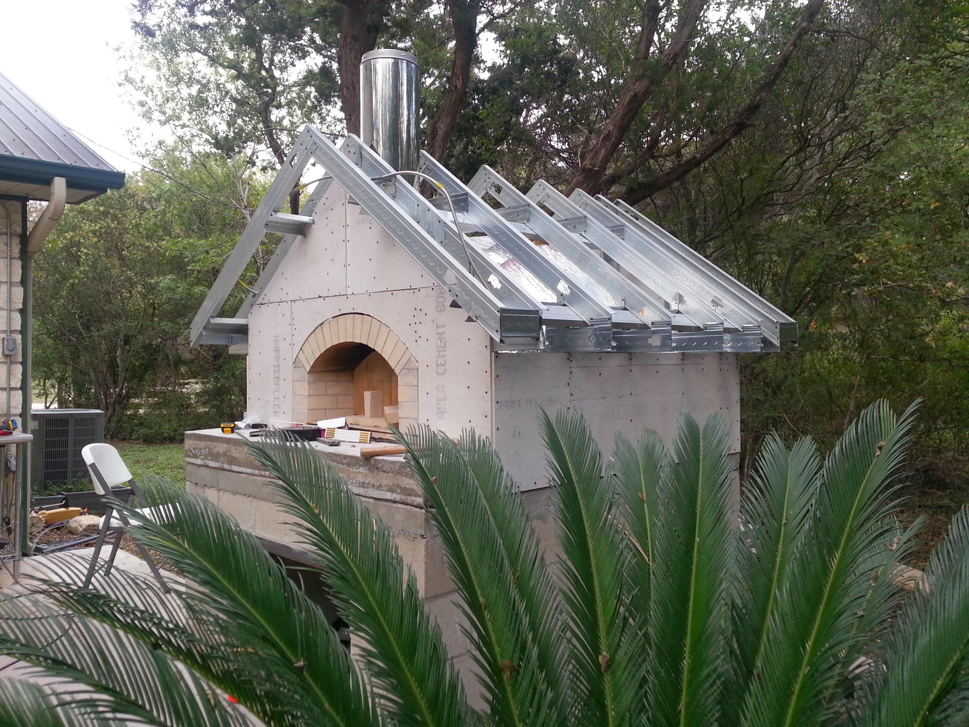

Made some progress today. Got the Hardi Backer complete as well as the Electrical. I'll be using a Brick Veneer over the Hardi and Block. Havent decided on roof yet. Looking at Copper and Tile but not sure I have enough support for Tile. Im looking for an old-world Italian look. Open to suggestions. Our Home is White Limestone with Metal roof but didnt want to try to match that. Would rather have a contrast to the existing look.
5 PhotosMy build documentary page:
Originally posted by GarnerAC View PostMade some progress today. Got the Hardi Backer complete as well as the Electrical. I'll be using a Brick Veneer over the Hardi and Block. Havent decided on roof yet. Looking at Copper and Tile but not sure I have enough support for Tile. Im looking for an old-world Italian look. Open to suggestions. Our Home is White Limestone with Metal roof but didnt want to try to match that. Would rather have a contrast to the existing look.Old World Stone & Garden
