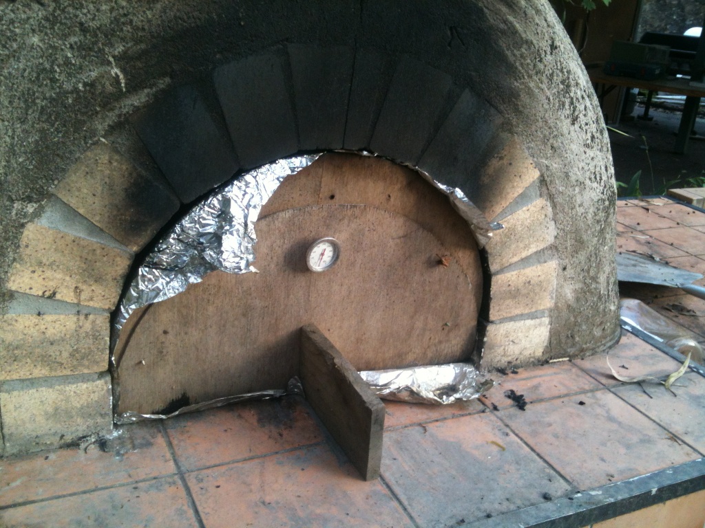

    Wrap you temporary door in aluminium foil. It goes a long way to protecting from the heat. If it gets tacky and falls off ....how cares its a temporary door, it just has to work once to be useful
    regards Dave

      I think thats what I'll do Dave, wrap the crap out of a piece of CFB and my plywood template w HD foil.
      I just drew out plans for what I want to do w the door and it will take me a while. Im going to use a Rutland gasket around the outside. I know its not "food rated" but Ive used these on my BGE for years with good luck.
              regards Dave
              [ATTACH]40176[/ATTACH]
              Dave,
              That's a lot of heavy soot on your outer arch, are you overloading your chamber or is your flue inadequate?
              • Re: 42" build in Central Texas
                Originally posted by david s View Post
                Dave,
                That is the inner arch. The flue arch is not there yet no place else for the smoke to go. Just my observation.
                Chip

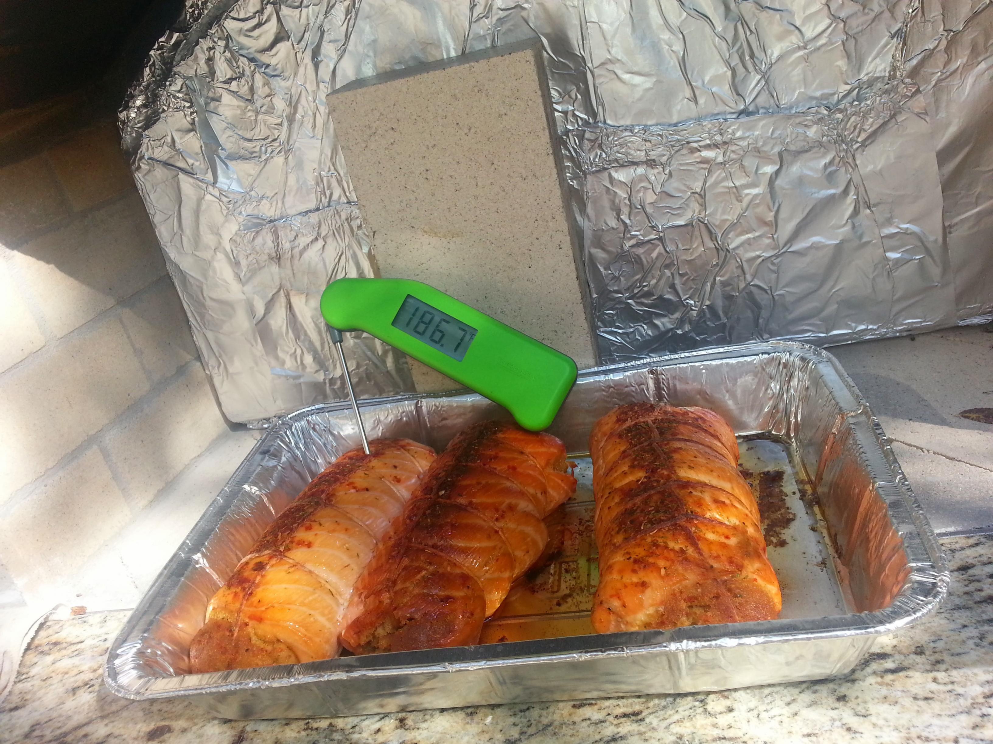

                            Yeah I saw him workin the dough busy-busy, i didnt bother him but watched their cook flow and they can really knock them out. Great business model! Their dough is very good but a little strange, lots of almost carbonized (black) bubbles with lighter more properly cooked areas between.
                            Never heard of Bufalina, will investigate.
                            Temp info so far:
                            Morning after Pizza- 490 degrees
                            24 hours after-400 "on the nose"
                            36 hours (This morning)- 370
                            40 hours later (this afternoon) 350 (cooked some stuffed Salmon)
                            Crazy heat retention but this thing is insulated to the hilt/
