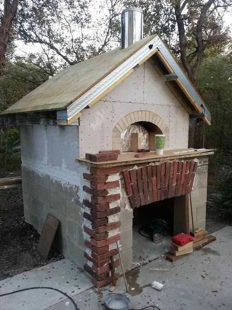

        Sorry I missed you, I got there right after you left. Here is a the jack arch, 4J is the style I would recommend. One full and one 1/2 should give you enough to cover the full 17" over the angle. Hold one pair up there and establish the skew to fit. I would also recommend cutting the top and bottom parallel to angle iron once you have the skew set.

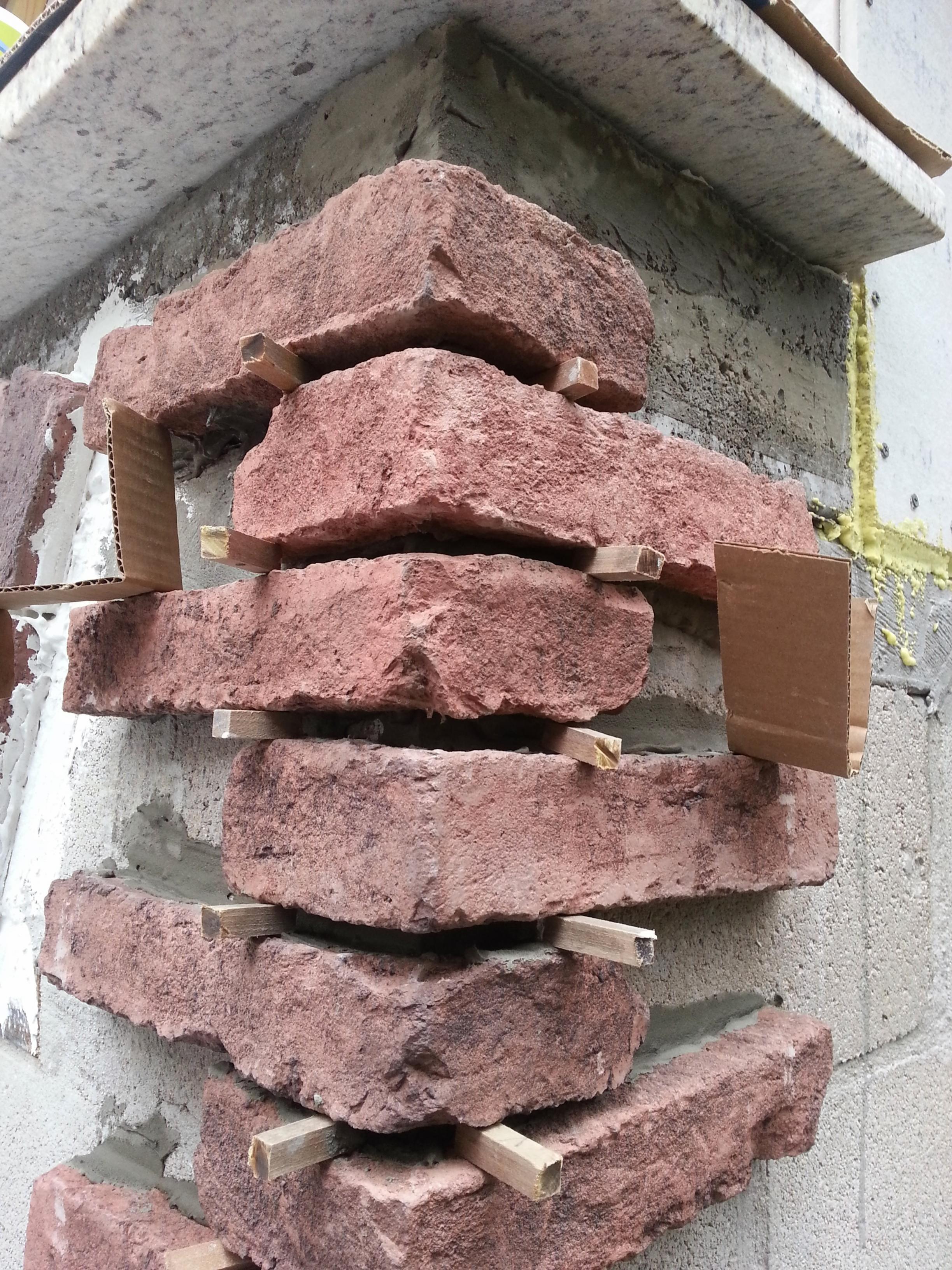

          Progress report:
          Started the brick veneer yesterday and worked off and on today. This is a great product, easy to install and looks beautiful. It's made by Eldorado.
          With Tom's help with design on the Jack Arch, it will add and interesting element. If I can keep a straight line the rest should go smoothly. Although I am a little nervous about grouting it. That could make or break the look Im going for. I'll start that in the back!
          The reason for the white thinset is because thats all HD had at the time and I didnt think it would matter, BUT, if you get any on the face of brick it wont come off so I went back and got gray this morning. Also, I started out spreading it like thinset usually is spread, with a notch trowel, until it was pointed out that I can just butter the brick and stick!

          • Re: 42" build in Central Texas
            I really like that look Garner. If it was mine I would tuck it with lime mortar or white Type N mortar, then rake it back about 3/16" and finally brush finish. That would replicate old joint work nicely.
            Your pointing mix should not be as loose as your thin set. It should stay together when you squeeze it in your hand...a bit like dry clay.
            If you use a loose mix and slob it all over those nice brick with a grout bag, I'm putting you on my ignore list.
              I wouldn't use a bag at all. 95% of it is horizontal and it is faster and neater to tuck it off a hawk. If you need to borrow a hawk and some tuckpointers, let me know. If it isn't raining tomorrow, I will stop by and show you the technique.
              It looks real nice, but I disagree with raking the joints, those old raggedy brick want filled and smeared joints. Are you going with white, grey or colored? I have an ivory colored masonry cement that looks like the old Alamo cement, if you know what that looks like.
