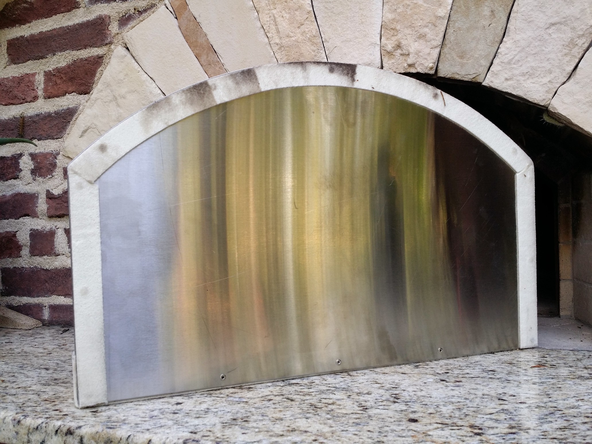

    One more of the oven facing side:

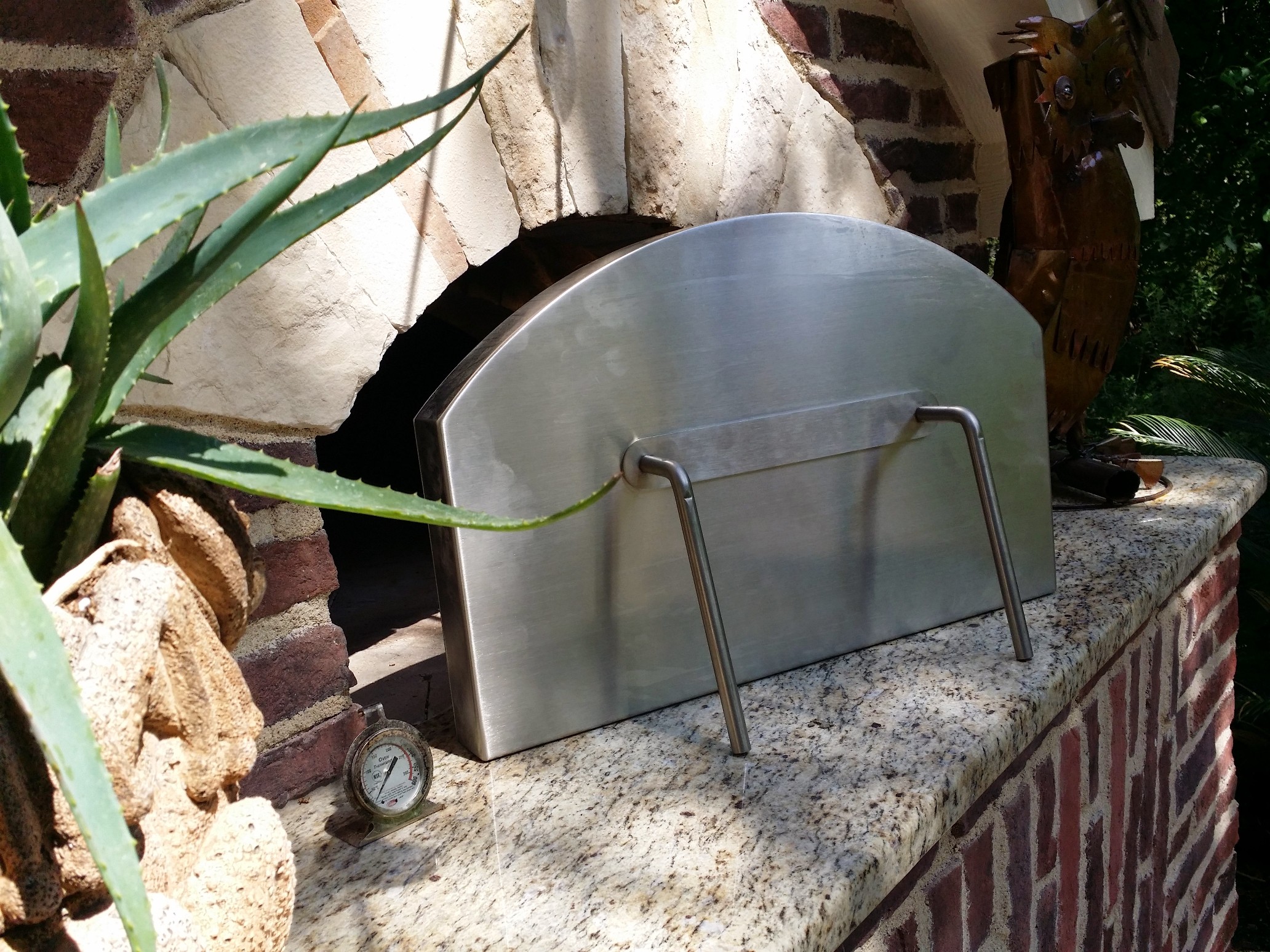

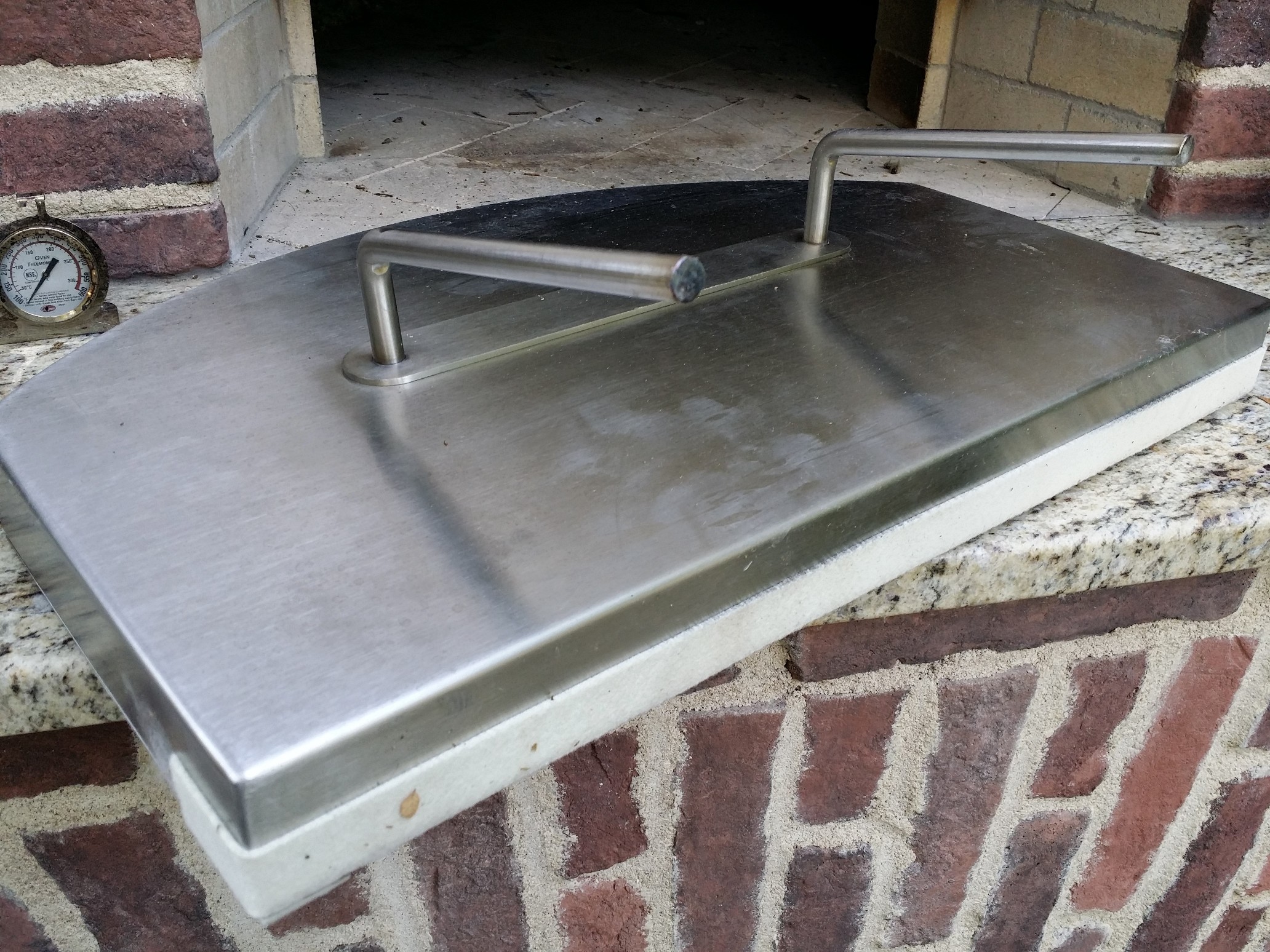

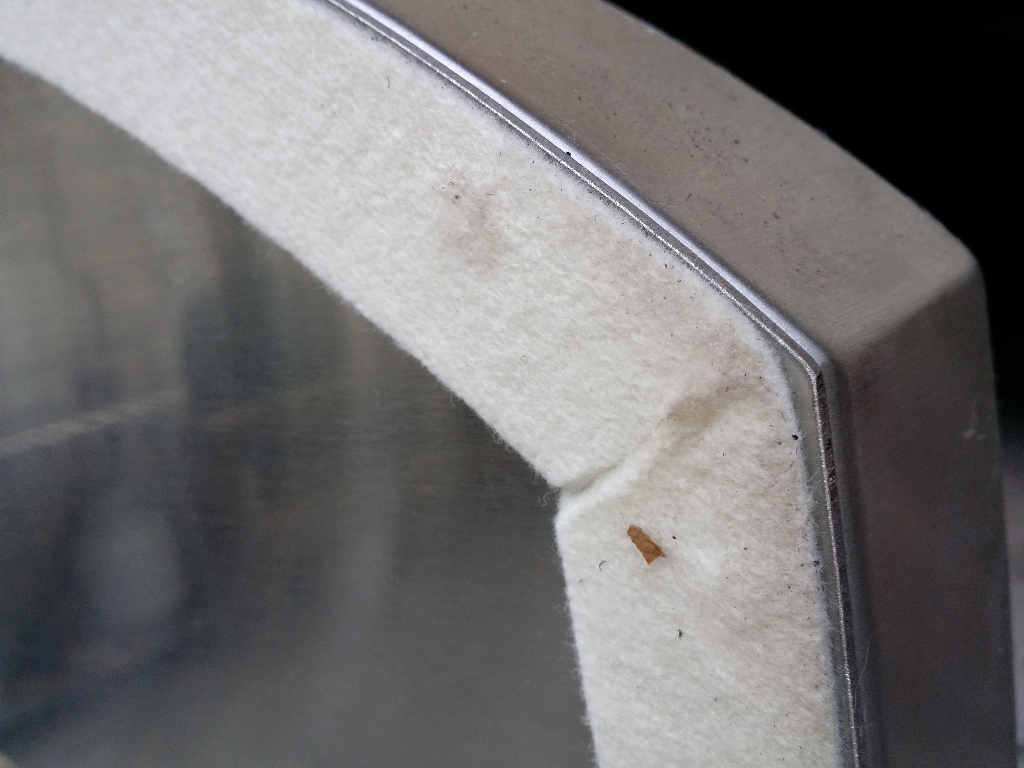

    Finally got my door! SS, 2" filled with CFB, pieces like a puzzle staggered to a snug fit. The SS doesn't necessarily fit the look I was going for but I wanted a quality piece that fit like a glove above all. It did, after some grinding on the handles. I used Nomex gasket material that Ive used on my Big Green Eggs. We'll see how that goes. Not using the oven much lately but will fire it next week.
