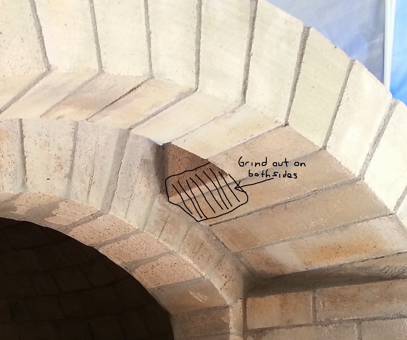

Yeah, I recall you telling me this before Gulf and I think I just forgot to do it. Ive only fired it 4 times beleive it or not... I did however break out the grinder today. I gave it a little taper on either side. I made a dumb mistake while doing it, not realizing exactly where ALL of my blade was at all times. Trying to cut square with a round wheel, I dug into my reveal a bitOriginally posted by Gulf View PostGarner,

Garner,Originally posted by stonecutter View PostI would grind it too, that throat looks small for a 42"...it certainly won't hurt anything. Try the flue preheat too, you might be surprised
The preheat works! I've seen it work many times over the years in fireplaces. In more recent years, my oven. Masonry chimneys can cool down over a few days. In the south, where we live, it is not uncommon to have temps in the 30's at night and 70's by afternoon. The masonry inside your chimney wont warm up as fast as the ambient air. The cooler air inside your chimney will naturally fall out of the entrance of your oven. That is the reverse of what you want. I would do as Stonecutter advises before breaking out the grinder. Preheating cures a lot of problems

Well, no I havent tried it since I installed the 8" extension/flashing. The Cap has a spark arrestor screen and seems to drag my airflow down. I think I'll grind it anyway.Originally posted by stonecutter View PostHave you tried a lit roll of twisted newspaper in the throat opening before you light your kindling? That metal transition and flue will heat up fast and it may be all you need to stop the blow-by.

What you are proposing will not compromise the arch integrity at all. Grind away.

I use split Post Oak or Live Oak and stagger logs with smaller kindling underneath using a blowtorch (Pear burner) to ignite. It's smoky until it get it really hot. The majority of the thick smoke draws right out but 10-20% will come out front until oven is HOT. Im just thinking that if I provide a bit more taper that maybe only 5-10% will come out front on startup. My main concern is structural if I carve out that one split brick. A smoke stained front is not the end of the world for me, its a WFO! and WFO's make smoke. Just my nature to tweak I guess!Originally posted by stonecutter View PostIt may help a little, but I'm not sure it will stop the problem completely. What is your heat up sequence?

You'll never get the soot marks off the bricks, but if you tile the front of the arch using glossy tiles, they come clean easily with some damp newspaper. If your oven were mine, I'd also be attacking it with the angle grinder as you suggest.
New or wet ovens are notorious for being smoky, your problem may go away when the oven is really dry.

Starting to get some smoke on my outer (deco) arch. Do you think that now that now that I have that cap on it's slowing down my draft? i think it is and I think maybe I went a tad small on my draft opening. Thinking about getting the diamond blade out for some tweaking (see pic). Thoughts??? (That is pic #190 in my Picasa album if you want to see contextual photos)
