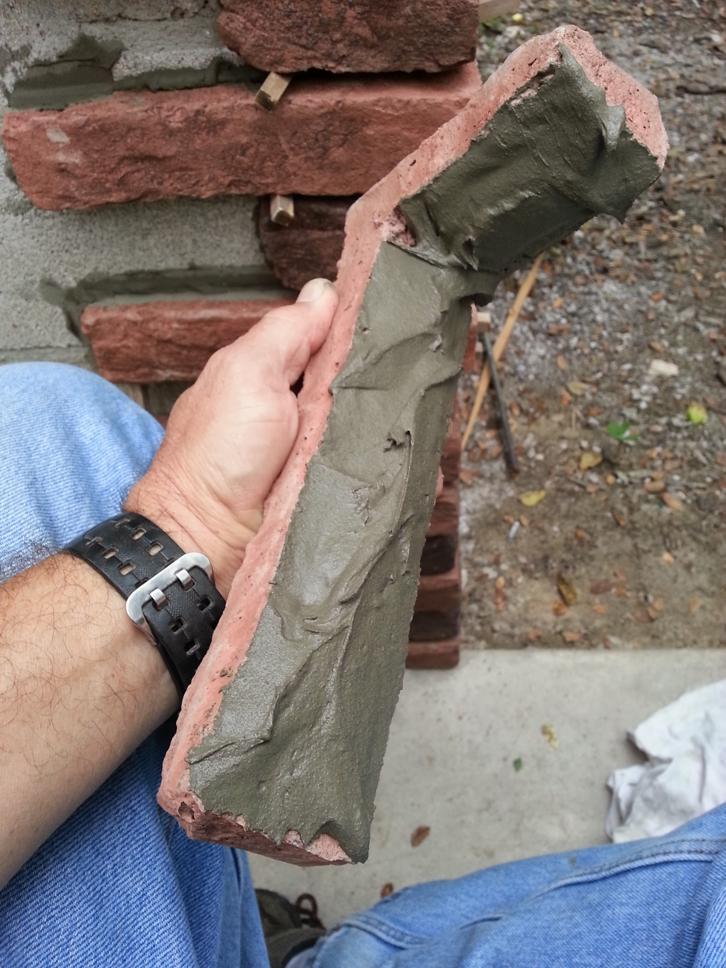

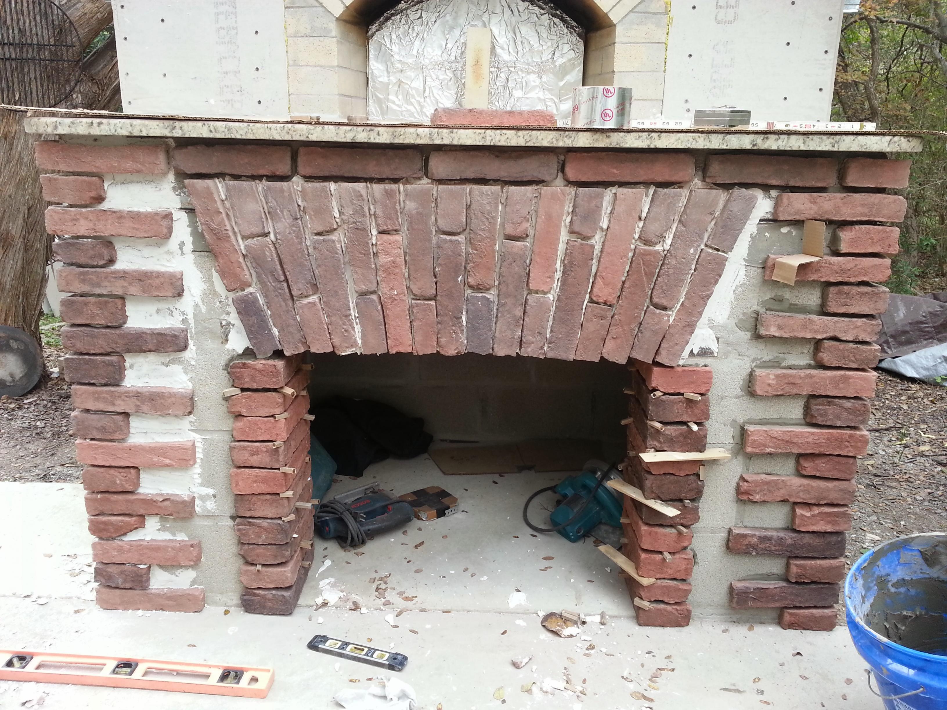

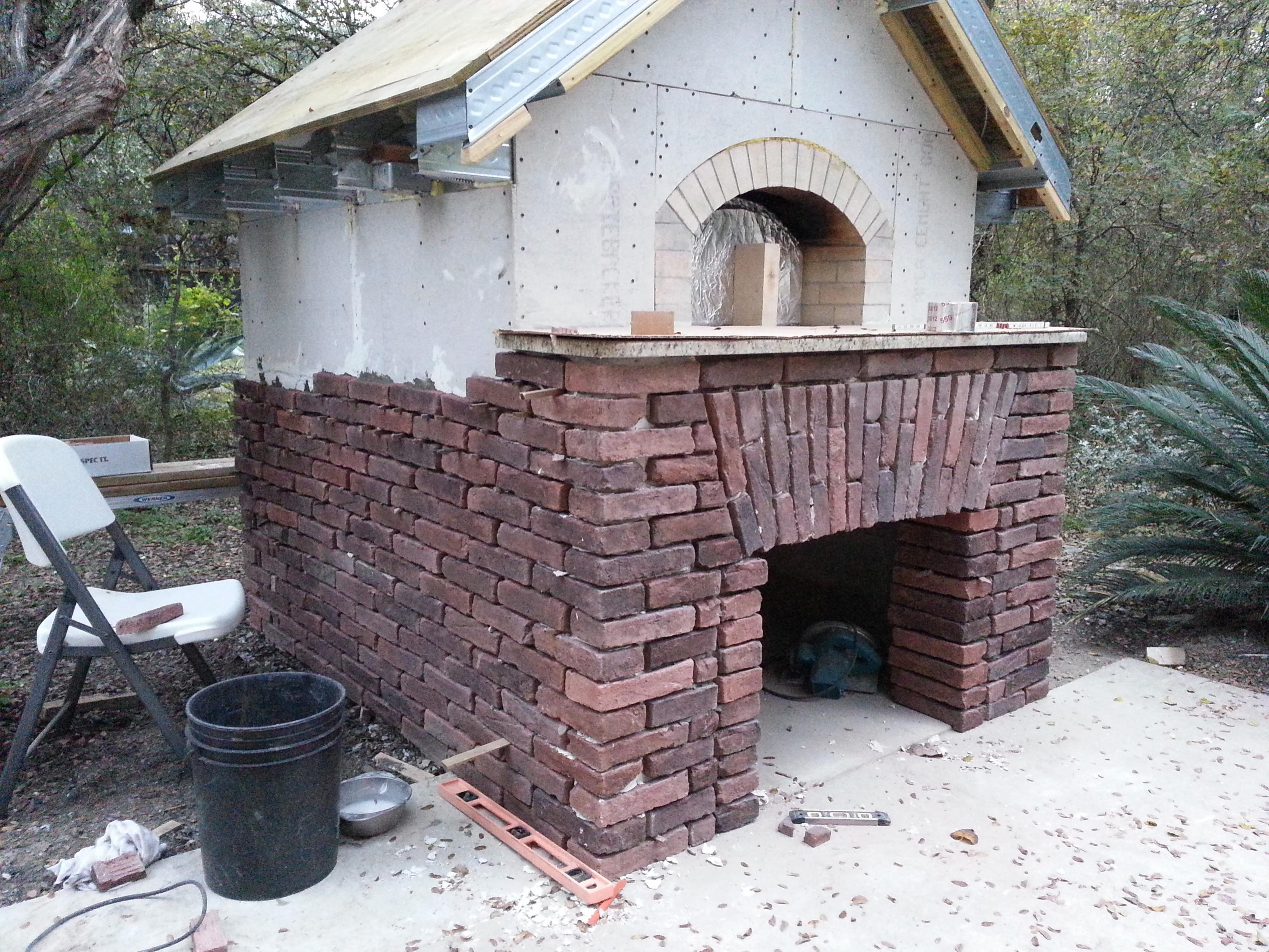

    Progress report:
    Started the brick veneer yesterday and worked off and on today. This is a great product, easy to install and looks beautiful. It's made by Eldorado.
    With Tom's help with design on the Jack Arch, it will add and interesting element. If I can keep a straight line the rest should go smoothly. Although I am a little nervous about grouting it. That could make or break the look Im going for. I'll start that in the back!
    The reason for the white thinset is because thats all HD had at the time and I didnt think it would matter, BUT, if you get any on the face of brick it wont come off so I went back and got gray this morning. Also, I started out spreading it like thinset usually is spread, with a notch trowel, until it was pointed out that I can just butter the brick and stick!

  • Tscarborough
    replied
    Sorry I missed you, I got there right after you left. Here is a the jack arch, 4J is the style I would recommend. One full and one 1/2 should give you enough to cover the full 17" over the angle. Hold one pair up there and establish the skew to fit. I would also recommend cutting the top and bottom parallel to angle iron once you have the skew set.
    edit-- The link would help:
