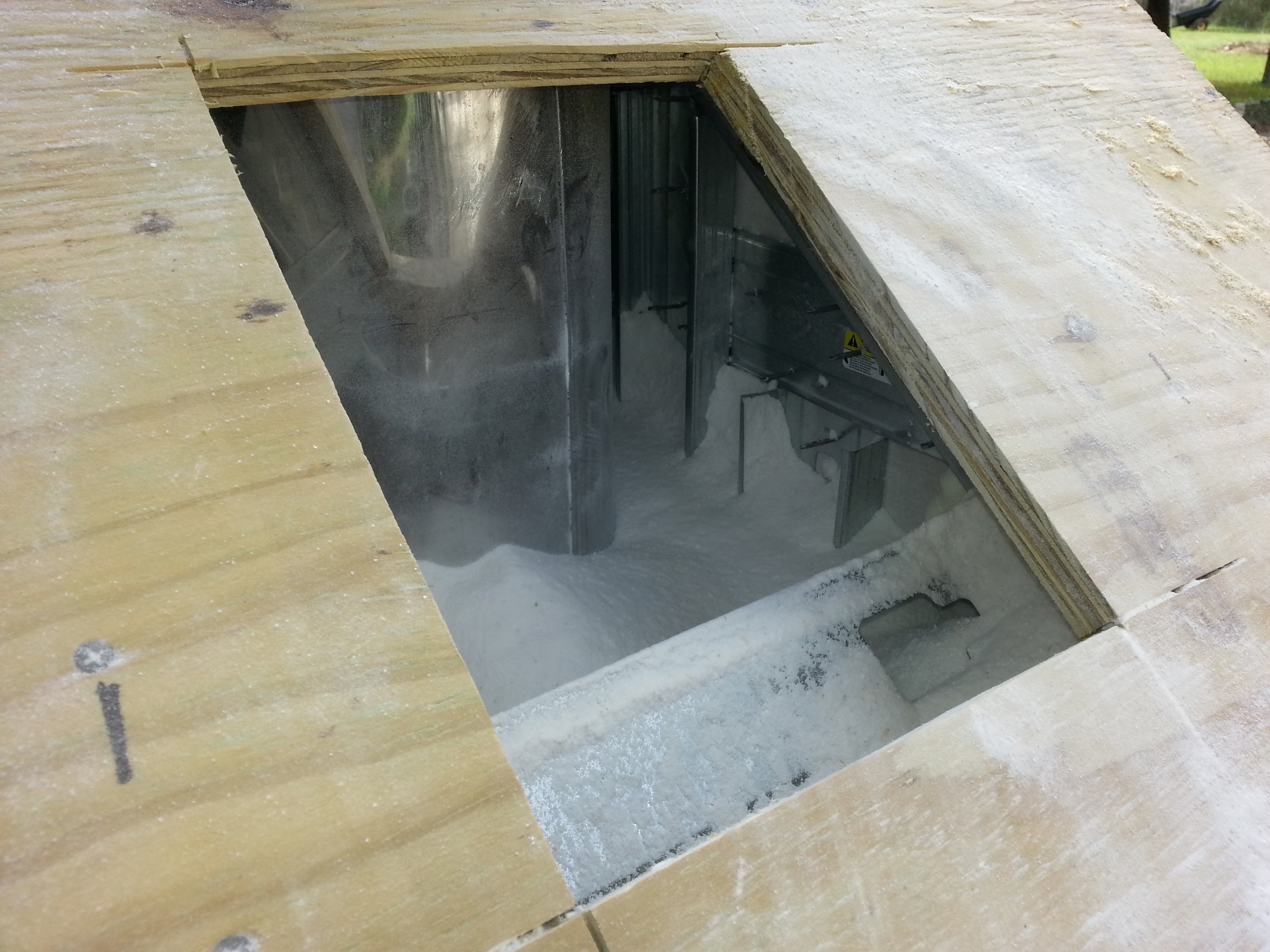

It took 12 big bags of Perlite to fill up the structure. Also got the Granite mounted today. It was a bit of a challenge to get the SS channel in and an 1/8" slope but it came out perfect!
Brick and roof are about all thats lefts. Thinking about what I want to do on a door. I still have several sheets of 1" ceramic board. Going to do Pizza for my guys this Friday. I havent gotten it up past 600 yet,,, nervous nelly
