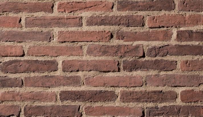

Once it is dry and theres no north wind I'll resume. Im only at about 50% with the brick and I may end up removing a few pieces and improving a section Im not happy with. I have some 1/4 and 1/8 bricks in a section that I want to get rid of by trimming a few full length pieces back. I may leave a couple but there is one section that has about 6, its near the back but.... I'll see them.Originally posted by stonecutter View PostAs long as the rain or drizzle is not soaking the brick, cool, grey and misty days are the best for tuck pointing...if you are so inclined.
Are you building your outer arch with a type sandstone ( or limestone)? I see what appears to be a couple pieces of it your table.
On the arch I think Im going to use some longer randomly shaped 10-12" limestone cream/lite-reddish/brown colored flags that should tie in with my home stone. My current plan is to cut them close enough together so that I wont have to tuck them. And,,, I want them to go down and hide my Fire Brick outer arch.

I like the Ivory Cream too. Part of me likes the Mexican Mud but i like the look of these bricks and it hides too much of them. Something close to that will be fine.
Can you bring the mortar this afternoon?? I was just across from the south store this morning, at one of my supply houses,, they had about 4 trucks getting loaded
Leave a comment:
Ivory cream matches the old Alamo (before they built a new plant and quarries) pretty well. It was the most common cement in Central Texas for 100 years, so I have to match it a lot.
Leave a comment:

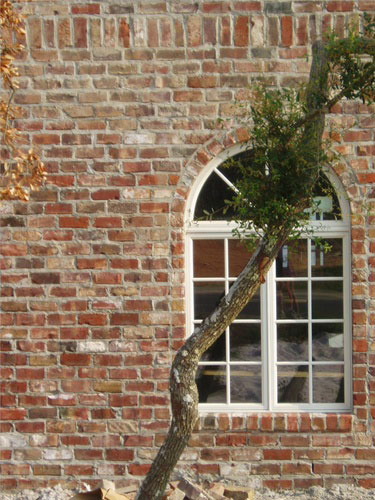

Pretty close T, though IMO, a tooled look is too formal for his brick. It's hard to tell, but the joints in the second pic look they were finished with a slicker, rather than raked back. I see a small thin ridge of mortar along the edge of some of the brick and what looks like an indented center.
What I was visualizing was more like a cross between that and the last pic, except the joint isn't flushed out to the edge. It produces a weathered look when brushed...I did it with my antique brick corners. It replicates old weathered joints you see on historic buildings, which used those type of brick. The finish in the last pic would look great as well ( flushed ) with irregular joint spaces. It looks like a brush finish to me.
The color of the mortar in the last pic would look dynamite with the brick too. One vote ( from the peanut gallery) for ivory cream

The first is full joints with white mud, the second is smeared with Mexican mud of unknown type, the third is the raked joints I think Stone cutter was talking about and the forth is ivory cream cement.4 Photos

This is what Eldorado shows as a sample. I think my brick is considerably darker brown than shown here and with more black.
Here are a couple that I like, Are these considered White? Ivory? Grey?
