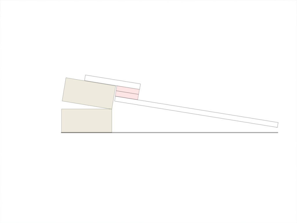

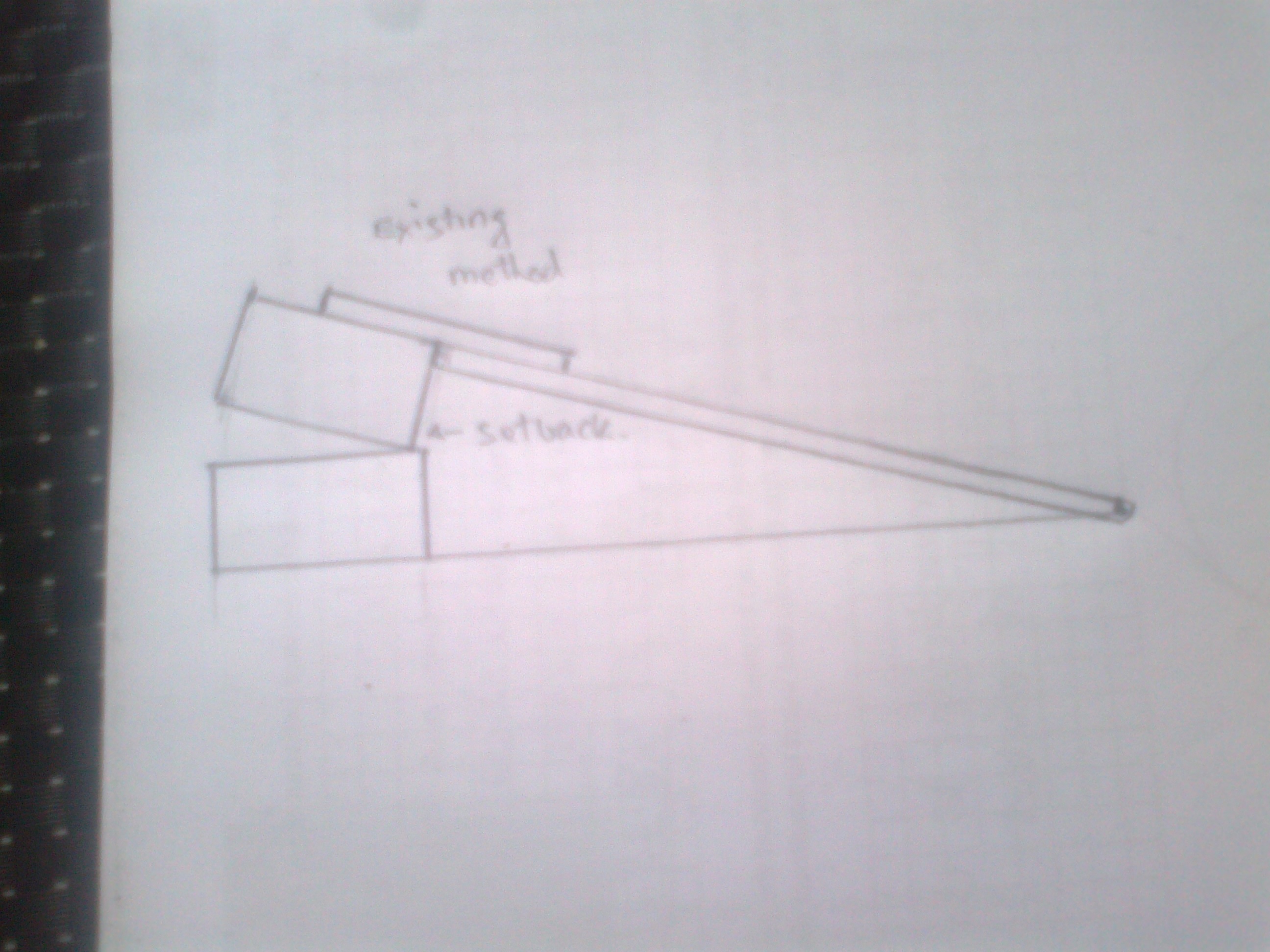

      • deejayoh
        • Jul 2010
        • 1893
        Re: How high to start curve of entry arch?
        On the IT - here's a picture of the problem I see
        And the solution
        Pictures gratuitously stolen from other threads and posters
        My build progress
        My WFO Journal on Facebook

              • deejayoh
                • Jul 2010
                • 1893
                Originally posted by jimkramer
                Deejayoh-
                You can't see it in the other picture I posted, but the second piece of wood slides on top of the lower piece to make it adjustable, and then there's a metal bracket at the end, to hold the brick. I think you can see it better in this pic. I'll check again, but I'm pretty sure the center of the brick is in line with the pivot point. Please check this pic to see if it looks okay, as I'm very glad to have many second sets of eyes out there.
                Ah, I could not see that bracket - looks great. I've seen a few of the other types of IT so just commented to be on the safe side.
                My build progress
