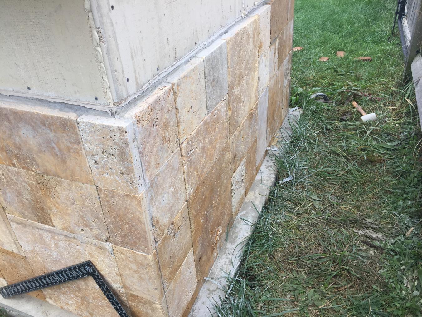

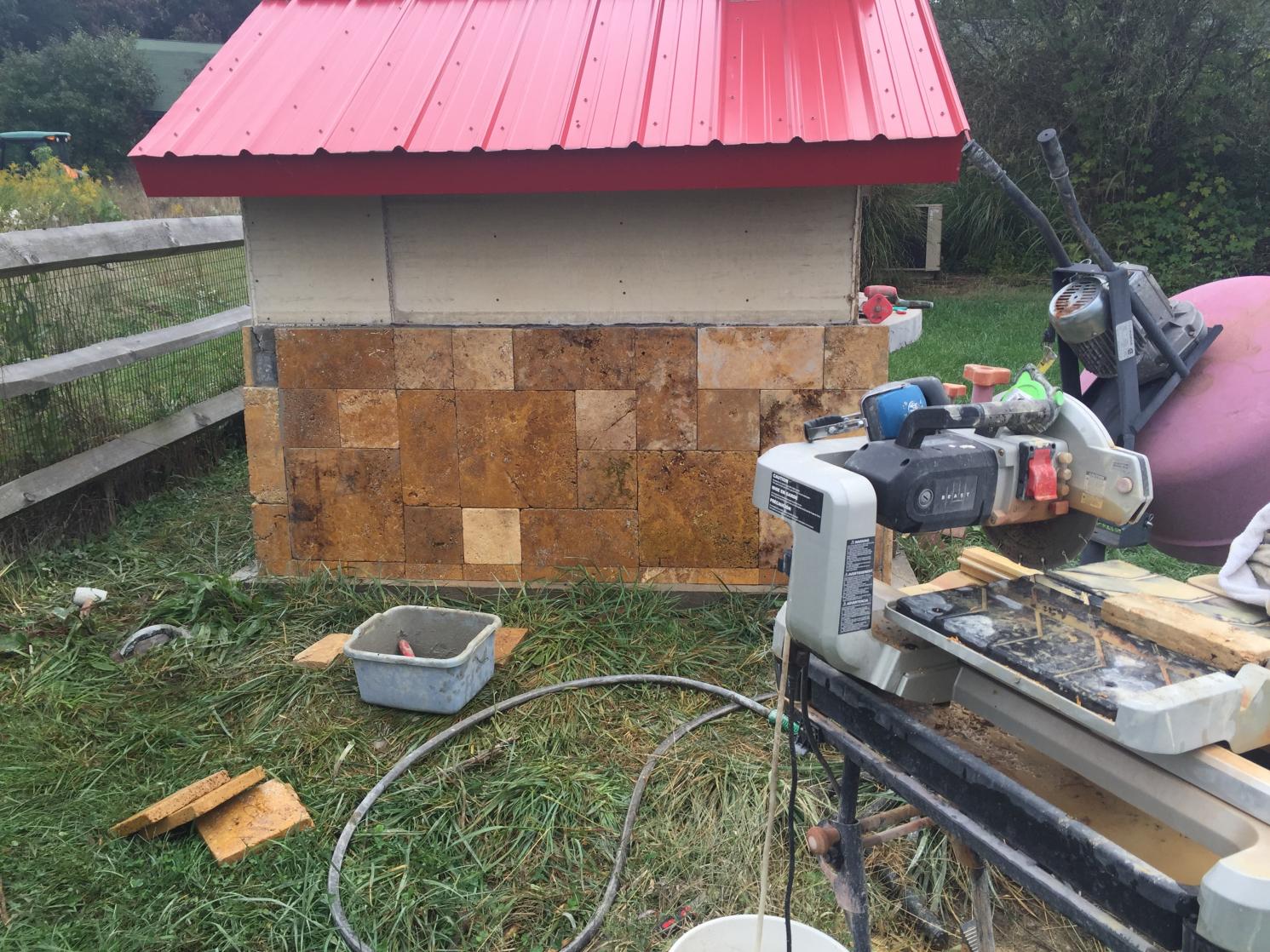

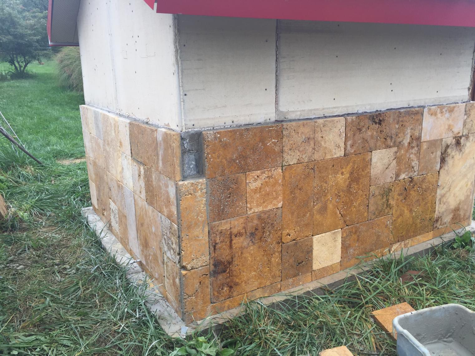

[ATTACH=CONFIG]n381540[/ATTACH] Finished mortaring the travertine base on the WFO (wood fired oven) today, except for the front, as I need to complete the brick arch over the wood storage area first. Next is the stucco above and the brick arch on the front. I'm sore but I love travertine!
