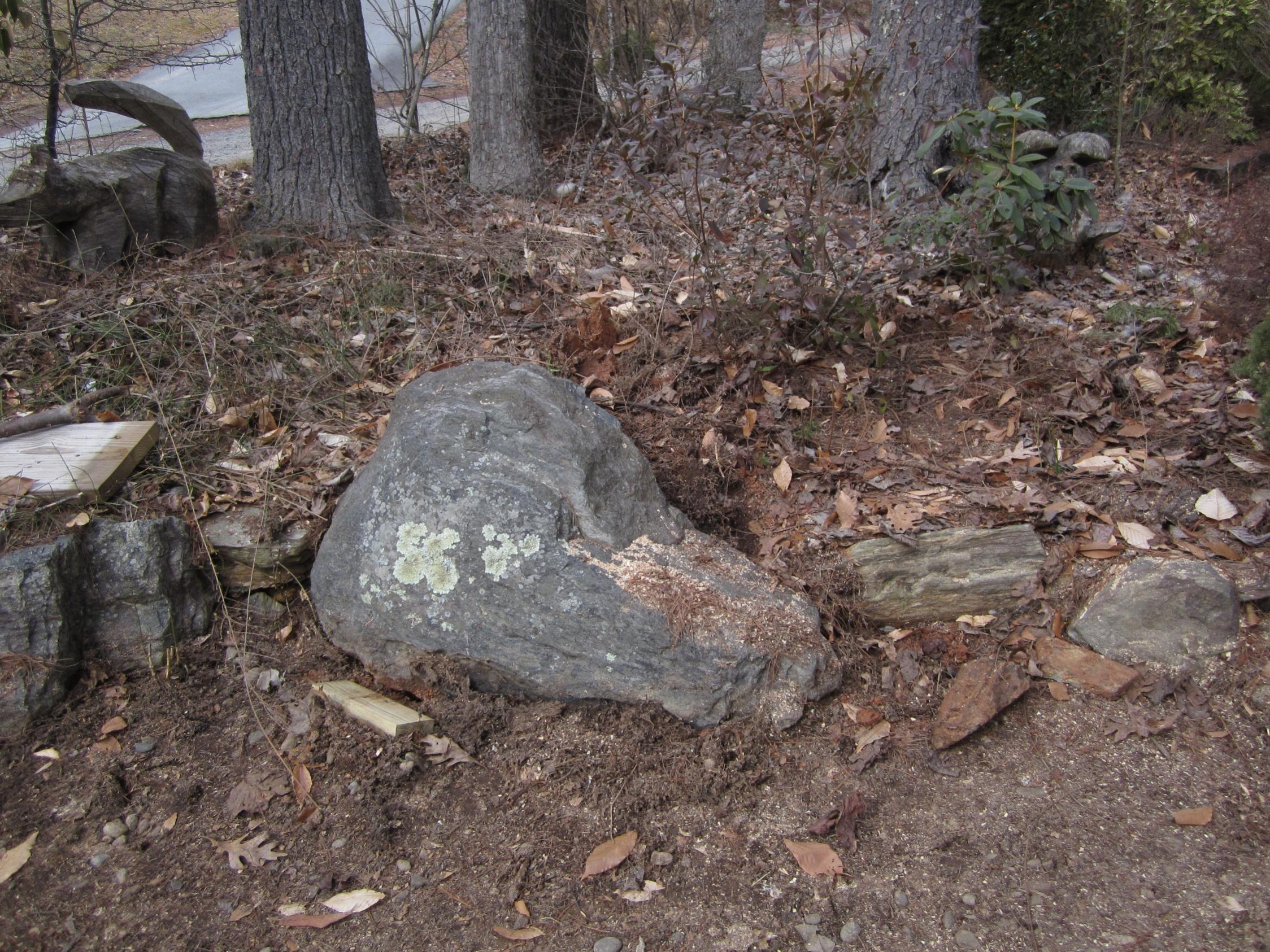

ID:	320332Had a nice weekend weather wise, so I went out and started scratching around at the build site. First on my agenda is moving this rock, then I have some digging to do.

    Gudday
    I was going to suggest just rolling down the slope behind .... Then I noticed the carved squirrel in the way....Oooops!

      Hey Dave,
      That'd be one way, but I guess the camera angle is funny. It's actually quite uphill. The carved squirrel, Mountain Dan, is watching over the project and will be the first to let me know when he thinks I'm nuts.

        Re: Starting my WFO in N. Carolina
        Call me lazy, but that would be an integral part of the oven right where it lays.
            Hey Lazy, err.....Tscarborough,
            I honestly haven't even thought of that. Now ya got my gears a spinnin'. I like the way you think. It is at "about" the front left corner of the (future) foundation location right where she sits. Hmmm......time for a conference w/Mountain Dan.
              I think I will indeed make it a part of the project, but still temporarily scoot it out of the way. But not far.
