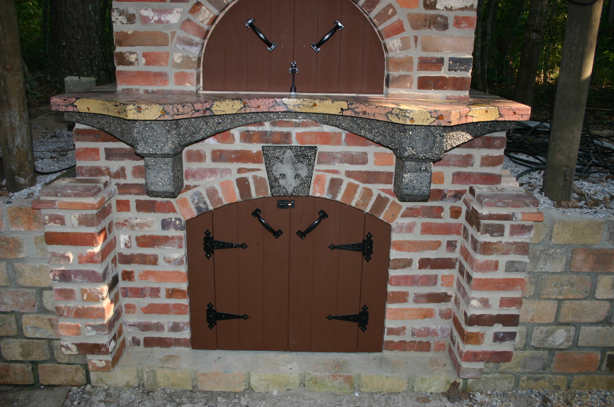

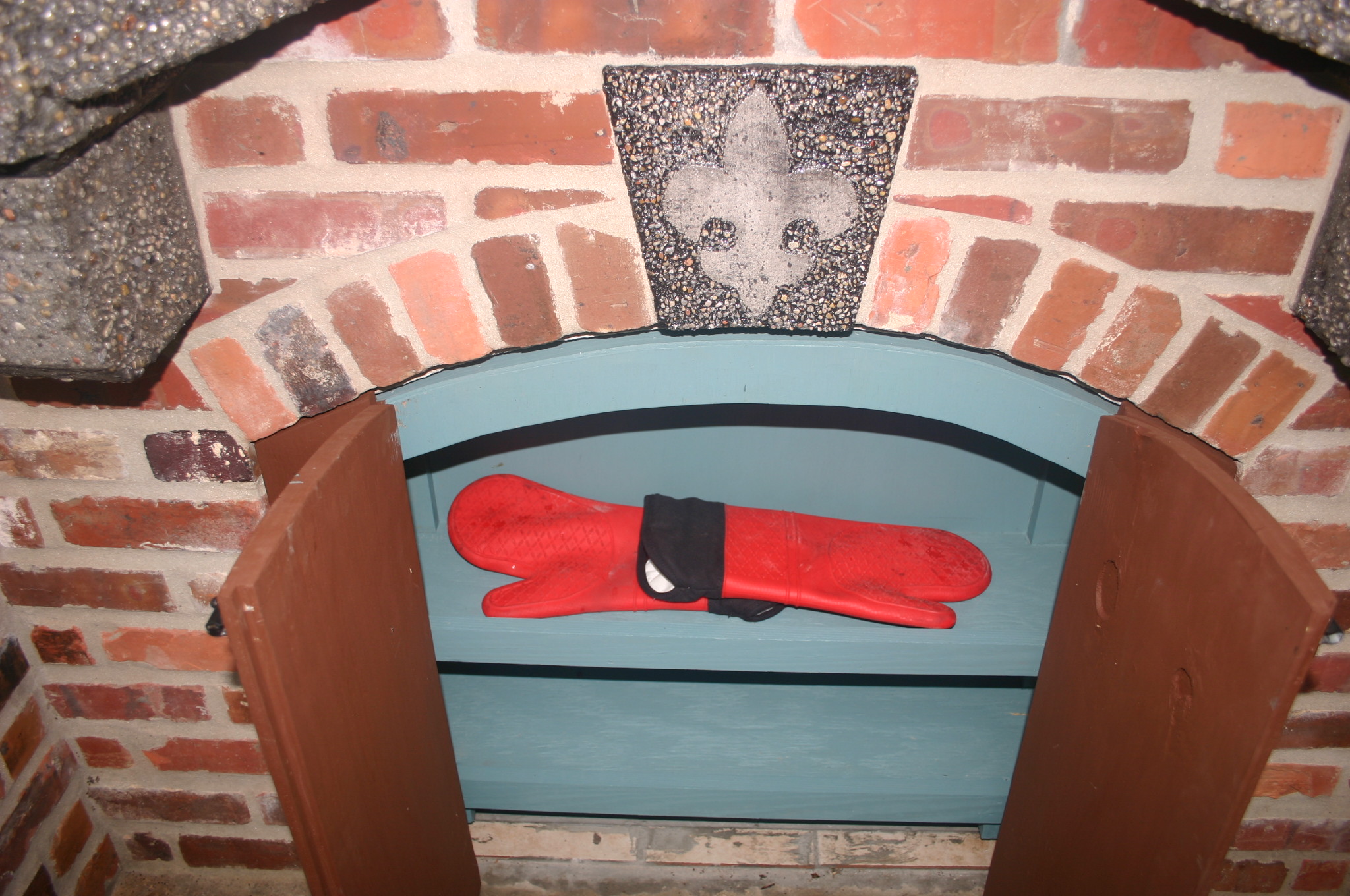

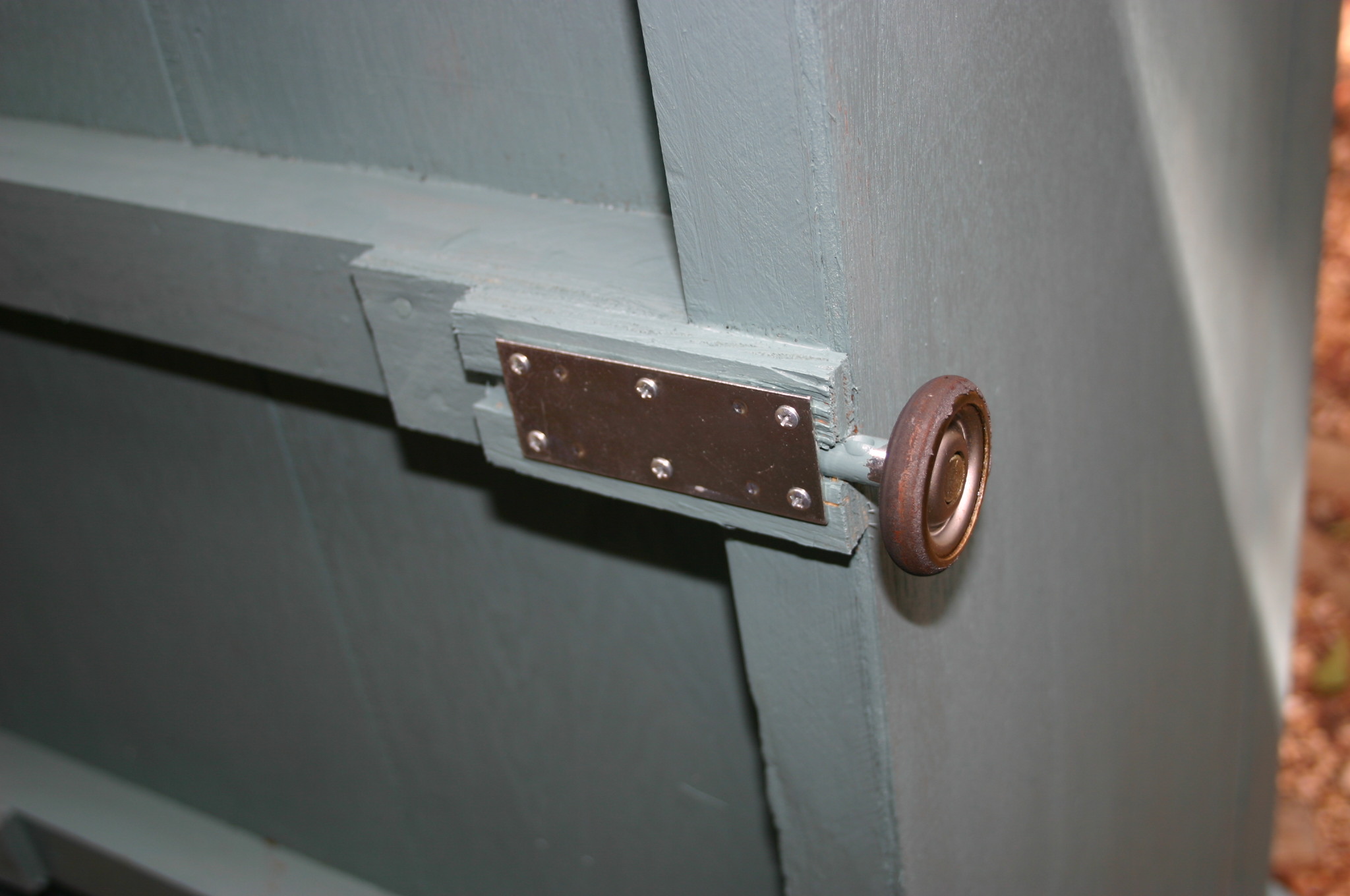

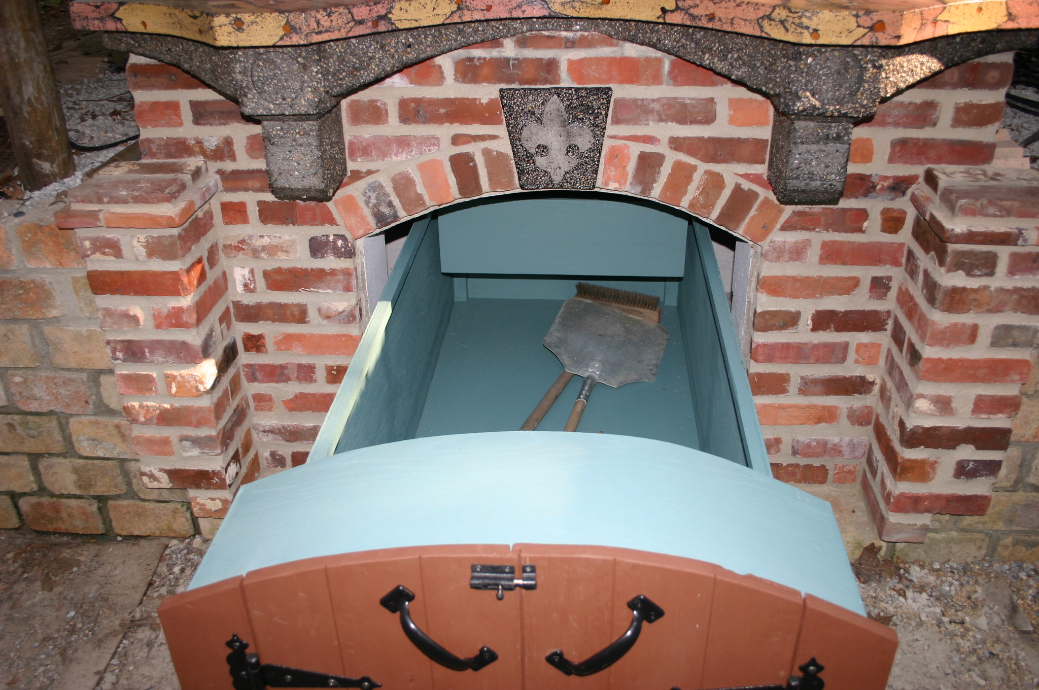

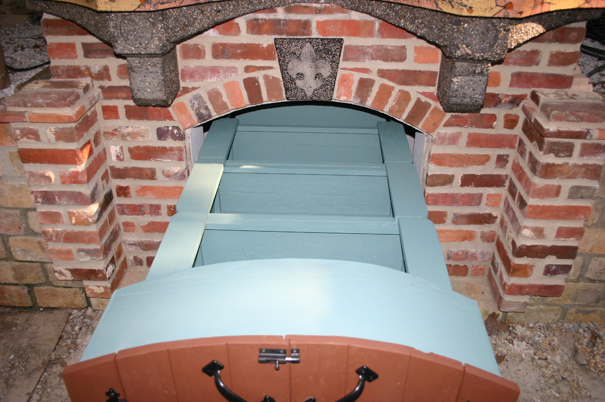

      Here are some pics I took of the drawer and the garage door hardware. To handle the weight of the drawer when it is pulled out, I anchored the track anchor screws in concrete. There are five pairs of rollers attached to the bottom of the drawer. Every thing is really easy to get to.

        Very impressive. I like it. Thanks for sharing. Pics are great to explain it all. Now I understand pretty clearly what you did. Very cool.

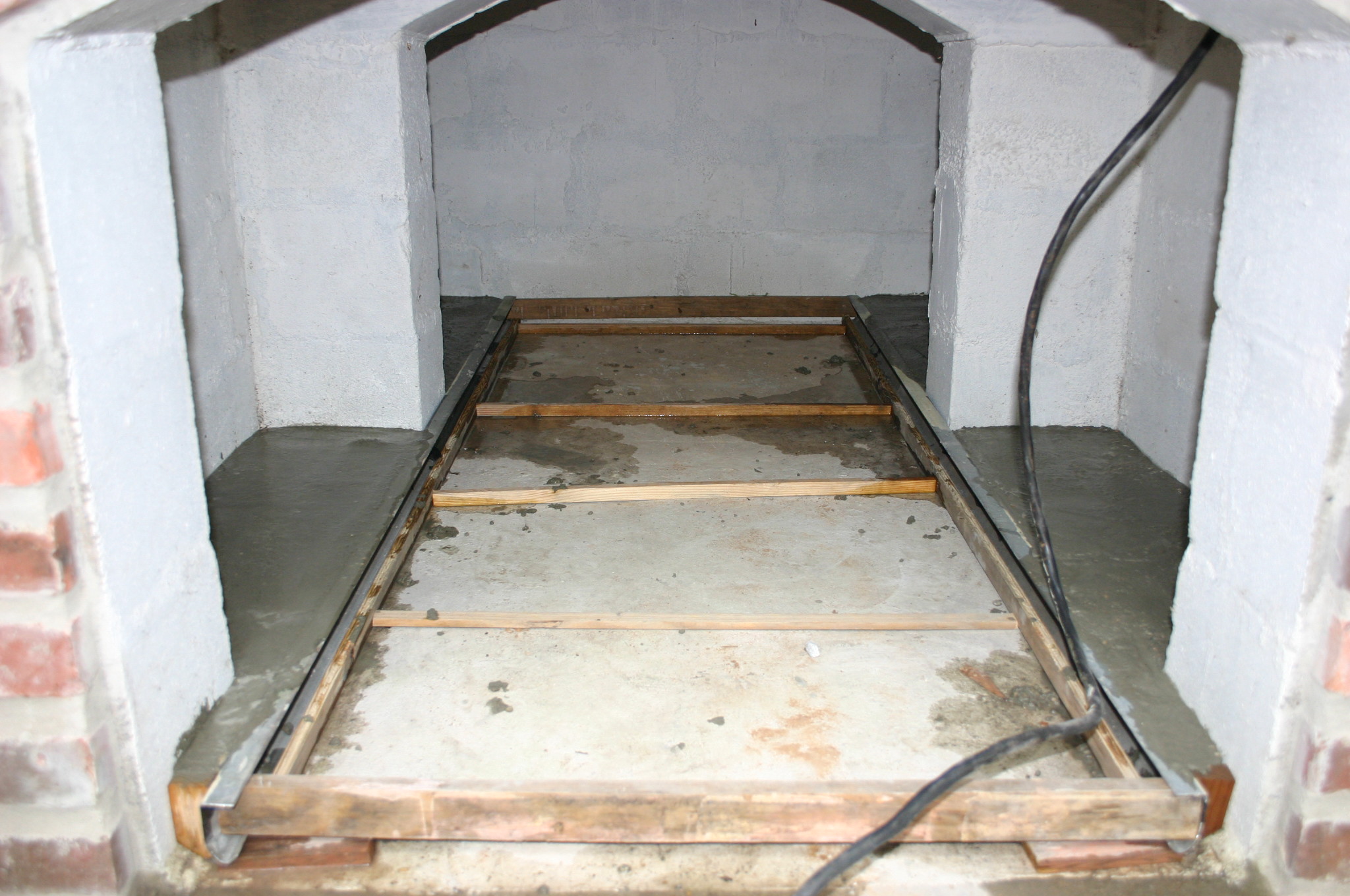

                              Re: Starting my WFO in N. Carolina
                              I forgot I had taken some photos of the foundation before I blocked it all up. I did this the first day, then the next day I filled it all in and capped it off. Any way, this shows what the actual perimeter foundation looked like before it got filled in. Hope to get to doing some of the form work soon for the hearth slab.
